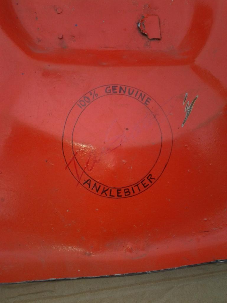

Awesome, Autograph is welcome. I'll do my best to keep it whole. I PM'd my number, just call and let's work out the details.
Clark
Thanks again....here is the autograph.

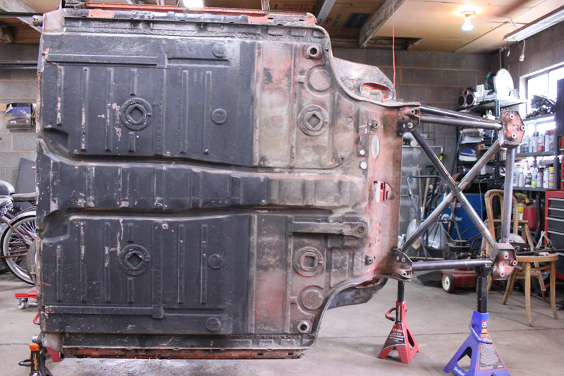

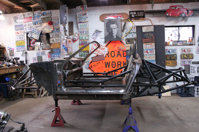

Today I broke down the car into its bare tub and rear chassis. I was surprised it only took a couple hours to pull the suspension, brake the car in half, and pull the engine.
With the extra time I gained I started stripping the remaining stock paint off of the tub in preparation for a couple coats of chassis primer and paint.
I like having a project you can lift onto jackstands with one hand...

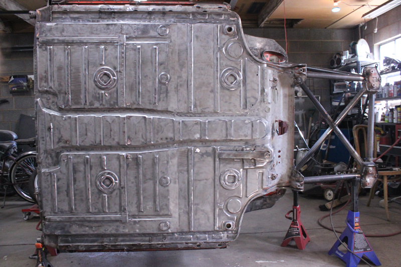

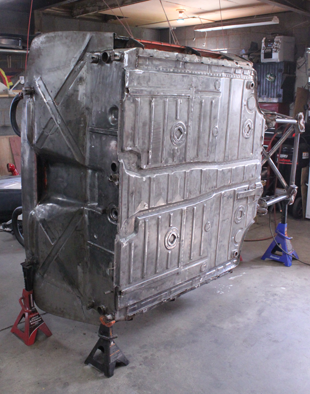

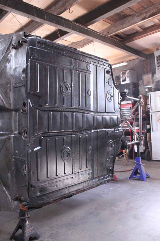

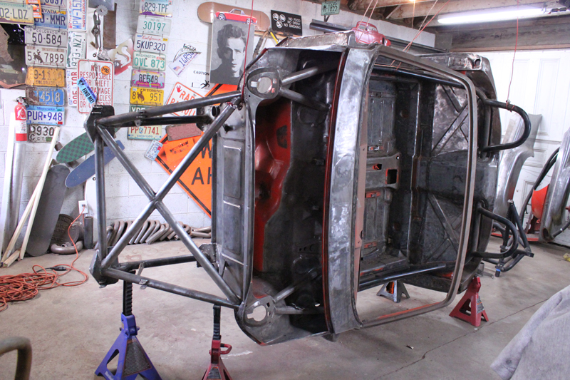

This morning I tackled the under side of the tub. Using every jack, jackstand, and a system of levers and pulleys I got the tub resting on its side with minimal "sketchiness".
To lower the murphie's law factor I anchored the tub to the I-Beams holding up the rafters. It is actually pretty solid and makes working on the belly of the car really nice.
I started out by stripping off all of the old paint, then welded up the forty or so holes I had drilled in the floor to mount the old water lines and after market rockers.
Finally I sprayed on the first coat of primer. I am using the Eastwood chassis black paint system, I used it on a couple cars when I worked at Renegade, it is tough as nails and looks pretty good too. After this first coat I will apply a second coat of primer, then 2 finish coats of satin black.

I think you should make a mold of that tub as is in preparation for making copies out of carbon fiber...hmmmmmm.....just saying.
Nice work Dana...Sure isn't the same car I rode in nearly 7 years ago.

QUOTE(plymouth37 @ Jul 9 2012, 04:11 PM) *
I started out by stripping off all of the old paint...
That alone is a weekend for most people! How do you do it?
Did you clone yourself? I am fairly certain that if anyone on this board could, it would be you (IMG:style_emoticons/default/beerchug.gif)

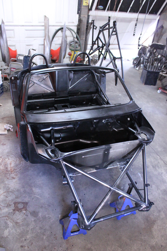

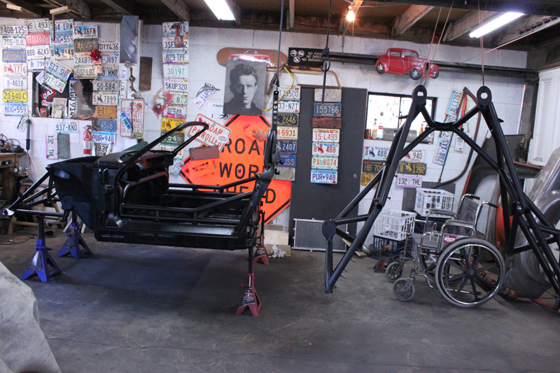

plymouth37
post Jul 10 2012, 07:01 PM
Post #978
Posts: 1,825
Joined: 24-May 05
From: Snoqualmie, WA
Member No.: 4,138

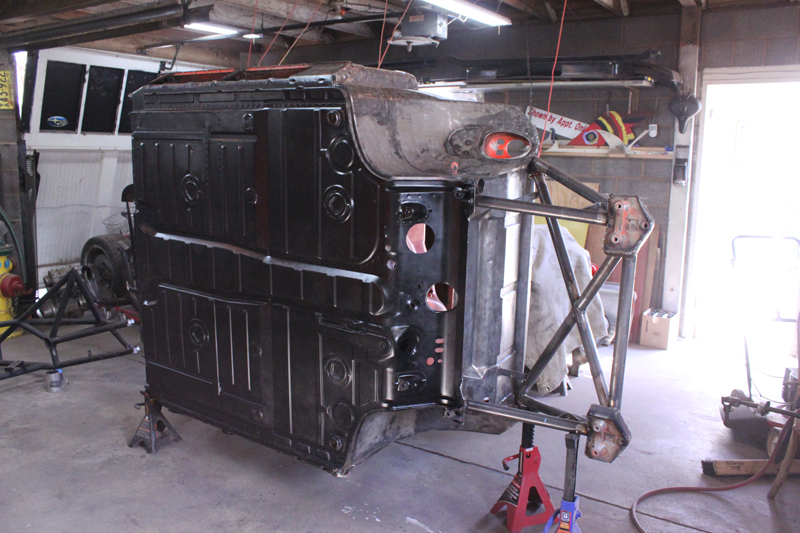

I prepped and primed the tub and the rear tube frame today. Paint goes on tomorrow!
