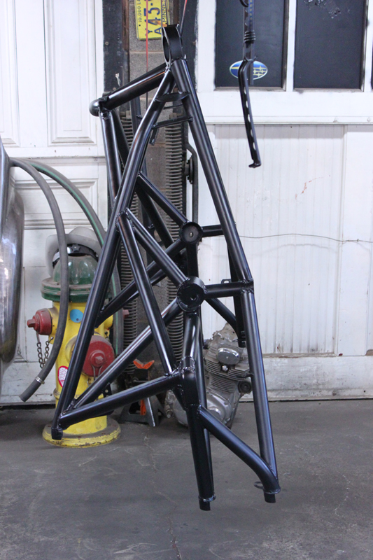

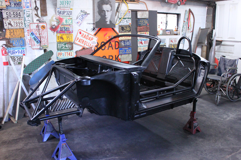

Satin black chassis paint is on! I found it sprays the best reduced by about 20%, I put on 2 light coats and got the coverage I was looking for.
I turned the heater in the garage up as far as it goes and will leave it to bake overnight.

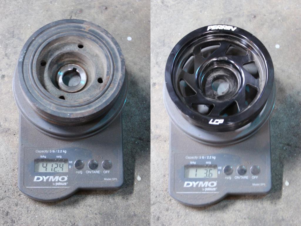

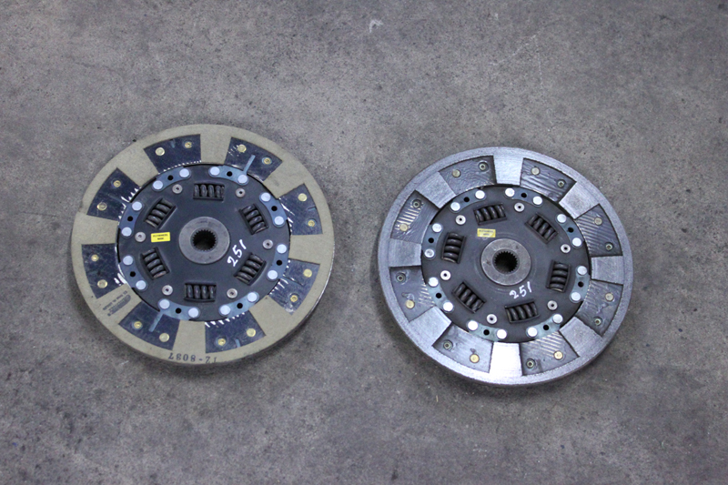

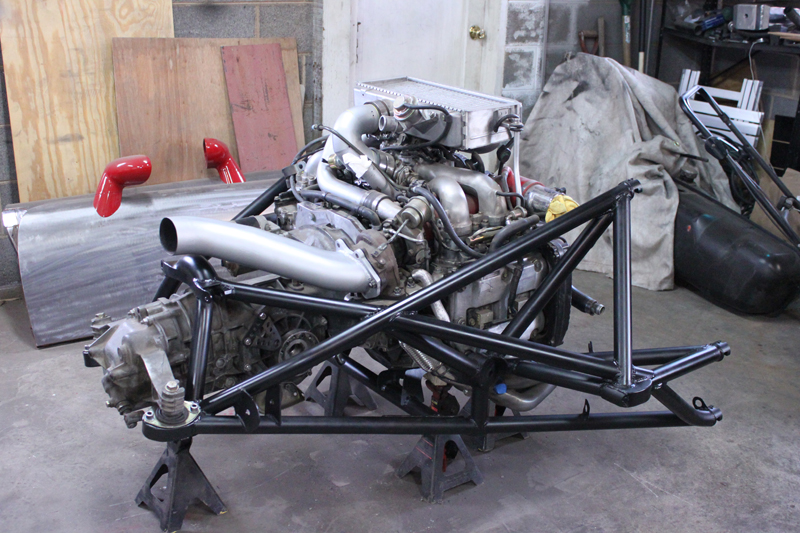

I did a bunch of little tasks to get the engine ready to install.
First I replaced my thoroughly melted clutch and reinstalled my freshly turned flywheel.
Then I installed a new Perrin light weight pulley, this took 3lbs 8.8oz off of the rotating mass of my engine, that aught to change it's revving characteristics!

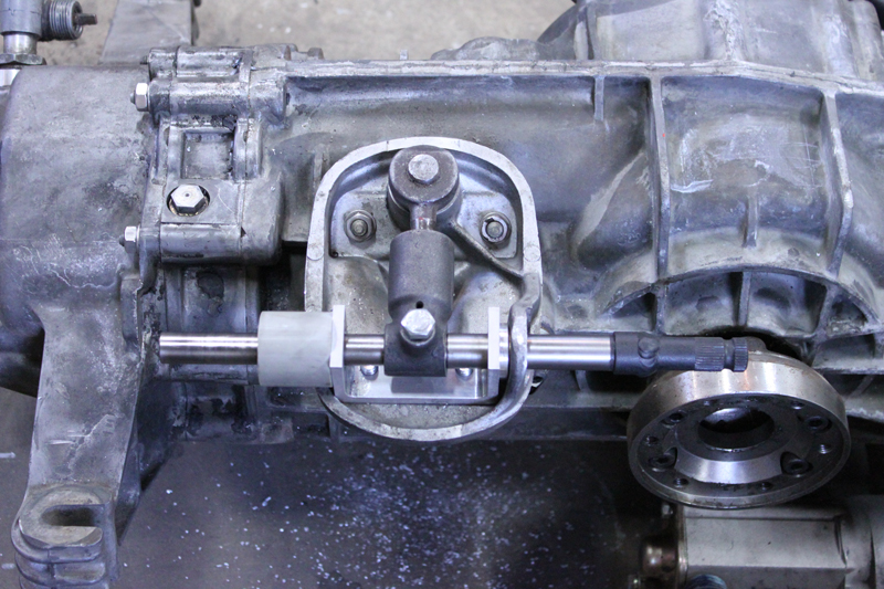

Next I installed the rear piece to the JWest shift linkage.
Finally I mounted the rear tube chassis to the drivetrain. I even miraculously avoided scratching the new paint!
Being a Suby guy I would keep the factory one on it works as a great harmonic balancer, for the little differance you feel from the Perrin it's not worth the relaibility issue's you "WILL" have. Even with a B & B engine I still think the factory one is the best option. I know it's really easy way to drop some weight especially on a rotating mass but sometimes weight can be a benefit.

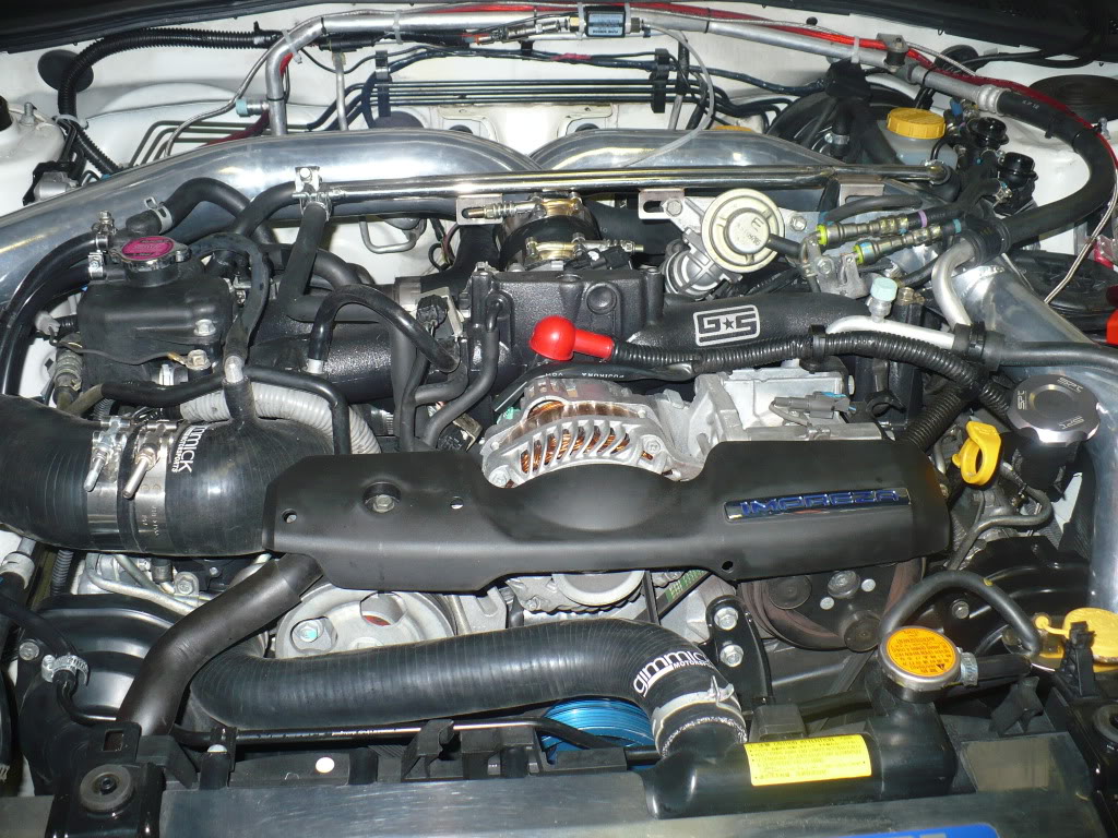

Might putting something like this in my Teener was in my 07 Ltd STi. Built short block, TVG deleats, meth injection, AP2 engine managment, 380 WHP (IMG:style_emoticons/default/evilgrin.gif)
Yeah, I have read the thousands of arguments on nasioc.com Here is a good one regarding the aftermarket pulleys, some guys (myself included) are of the opinion that they are safe to use, some guys think the engine will grenade if you remove the stock one. I have a couple friends with over 50k miles on their pulleys without experiencing problems, hopefully I will be as lucky as they have been. I figure I will try this one out and if I am not happy with it I can always swap back, thanks for the advice!

Less rotating mass is cool to a point. My rotary setup has a lightened flywheel. It gets a little "jumpy" at low speed low throttle driving. A heavier flywheel would help prevent this but would make the wind up slower.
There are pros and cons to rotating mass, especially when our cars are so light...

I think this is one of the components that I will just have to wait until the R&D portion of the build to see if I like it.
Right now I am sticking to the theory that lighter is better, if my driving experience starts to tell me otherwise I will reevaluate.

You will know real quick if its causing a balance issue and it will only grenade if you then choose to ignore it. IMHO

I beg to differ about the pulley. I have a lighweight COBB Performance pulley on my '73 914/2003 WRX conversion with 25k on it (the engine has 58k now). No problems and it hasn't been pampered in terms of how I run it.

It's not the longetivity of the pulley that is the question. The oil pump is right behind the pulley. The balancer is there to smooth out the revolutions. ATI, check out their faqs. Most suby beginners crater a motor from many different things, mostly thinking the oil level is good between changes because it aways was in the na honda they dogged before the wrx they moved on to. Subys are a different motor entirely and were originally meant for under 7k operation in the snow but the engineers didn't cut the cost of the motor by using a solid light weight pulley, wonder why? Most hard hotrodded subys don't make it far enough to find out if the lightweight pully helped cause the destruction. Some people even have cel issues from lightweight flywheels at idle.
Unabomber only writes what he reads, he is not a engine builder or a mechanic. All you need to do is look at a suby stock balancer and you will see the rubber and metal parts of a balancer built to try and smooth hormonics out, but like most oem stuff it's really only designed to smooth it out where the normal guy uses the motor, not at the rpms a high reving hotrodder uses. Thats why nascar uses ATI balancers. You think they aren't looking for every hp they can find?
I guess light pulleys do look better than a stock hormonic balancer though.

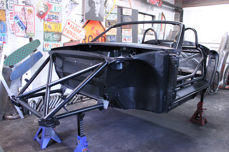

Like I stated earlier, I have made my decision and am sticking with it, I have done my research and based on what I know I feel comfortable running a light weight pulley.
Thank you for your input but I am sticking with what I have learned from my experiences within the Subaru community.
If I blow my engine because of this I will let you say I told you so (IMG:style_emoticons/default/biggrin.gif).
Here is a pretty picture to get everyone back on topic...

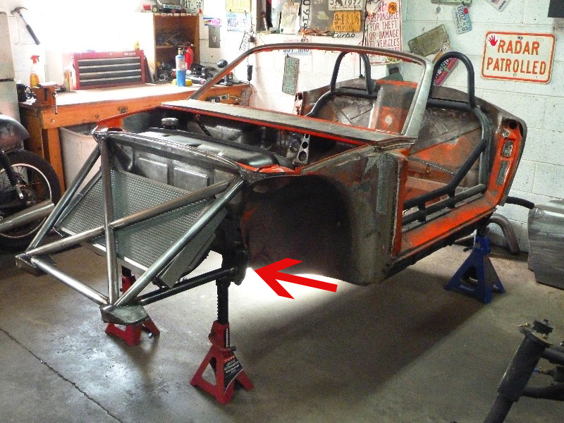

Without going back on your entire thread what did you do in the highlighed area to beef up the area where the lower tube ties into the remaining uni-body? I see that plate that drops down .. just wondering whats behind it. Is it tied into another tube or boxed in? The angle of the pic's gets my brain wandering.
