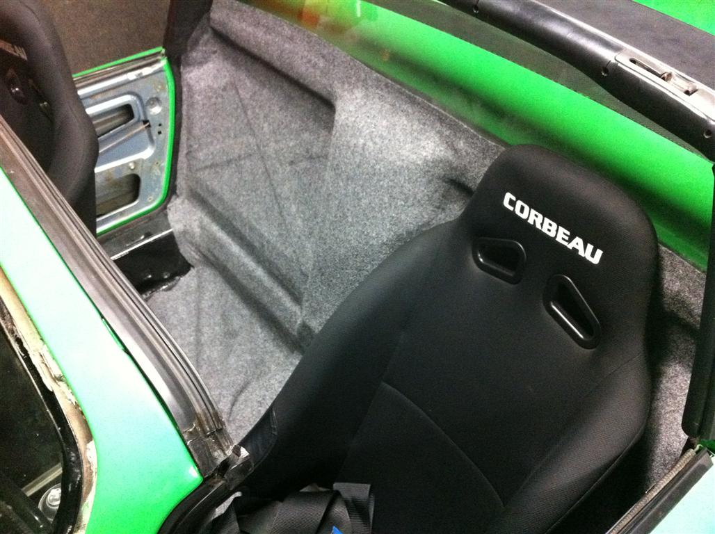

1) I started to add carpet to the inside...

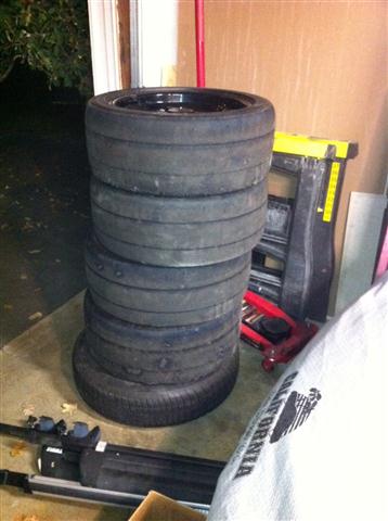

3) I made the decision to go with a 5-lug setup after I came up on a great deal on some original 16x7 fuchs wheels with a black powder-coat and some used tires.
details: http://www.914world.com/bbs2/index.php?showtopic=157331
- So, I read through the 5-lug thread in the Classic Thread Section, and have a basic understanding of what needs to be done, but I am interested in your guys' opinions and experiences with the various strut/caliper combinations. For the fronts, I just want to do struts/calipers/rotors. I also stopped by Parts Heaven just to see what they had, and they had a setup out of a '85 or '86 Carrera for $1400. Let me know what you think.
-peter

Carpet install looks great!

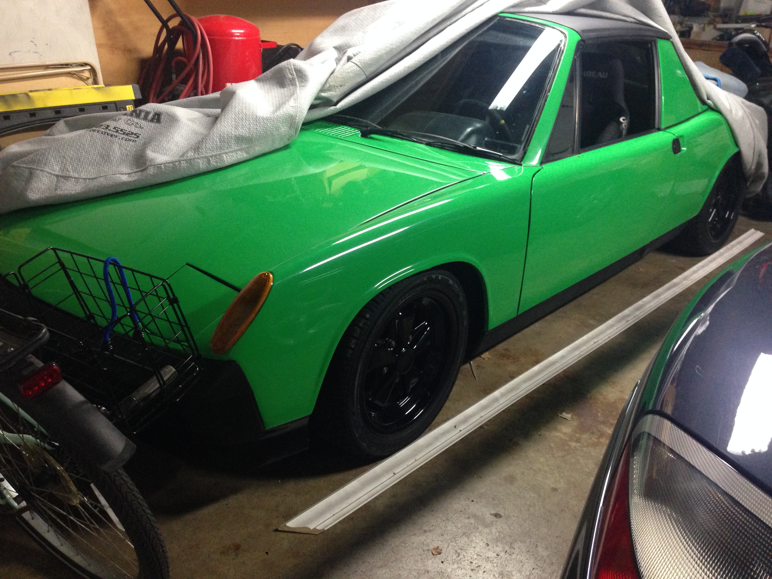

Well, I've decided to revive this 8-year-old thread to document the next iteration of my 1974 Subaru conversion.
The last 8 years...
I drove the car a lot for the first 4-5 years or so. Drove all the way down the coast to LA, several trips to Tahoe and used it as a semi-daily driver during the summers. Unfortunately, it has mostly sat the last few years only getting driven a few miles every couple months.
I have a little more time right now, and just sold my other 'project' car (Audi B7 S4 Avant). So, I figured it was a good time to get this car back on the road with some upgrades....

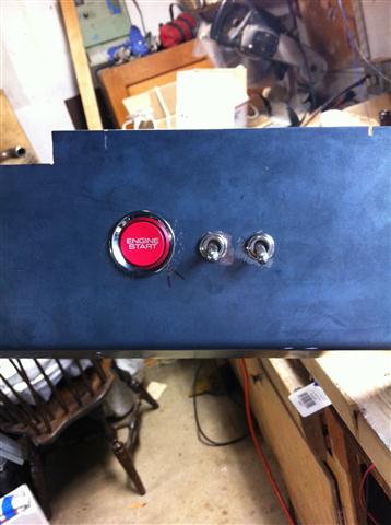

2. Interior Upgrade
- fix cracked dash
- flock dash
- new layout of switches/start button, radio delete, etc.

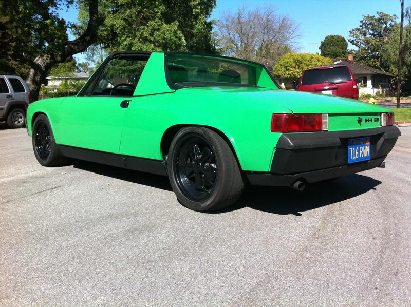

Had a few of these over the years..
(IMG:http://www.914world.com/bbs2/uploads_offsite/i.imgur.com-5674-1583110583.3.jpg)

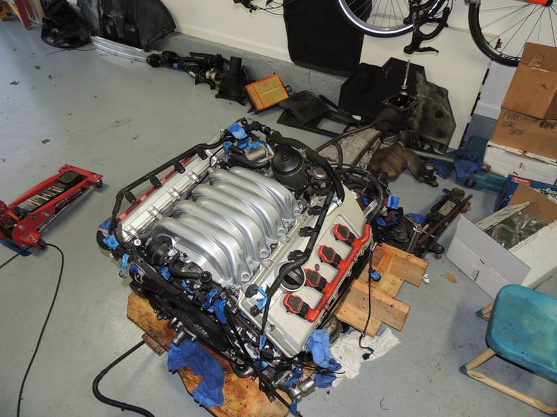

And just for fun.. this was my other project. 4.2L V8 After completing the timing chain/guide service:
(IMG:http://www.914world.com/bbs2/uploads_offsite/i.imgur.com-5674-1583110583.5.jpg)

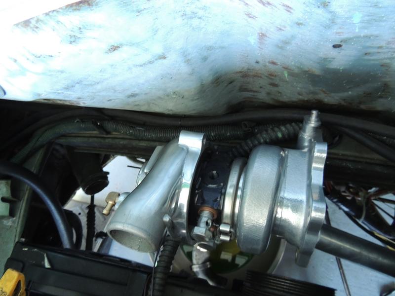

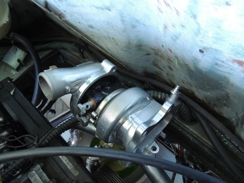

So here is my first mockup of the turbo parts.
I got the header and turbo from jRust. Super nice, un-installed, still shiny parts from outfront. Everything fits (with some minor adjustments) except for the turbo blow-off valve. It hits the firewall and will need to be offset..

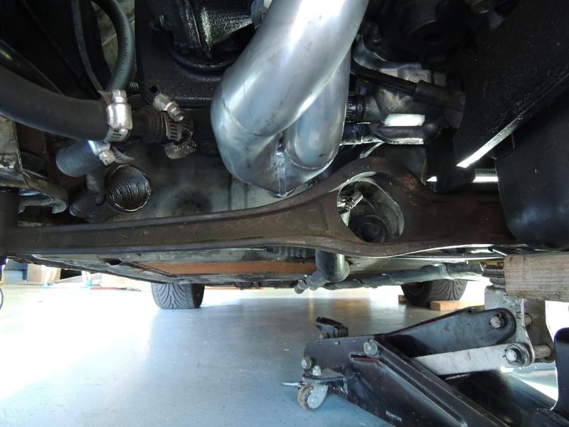

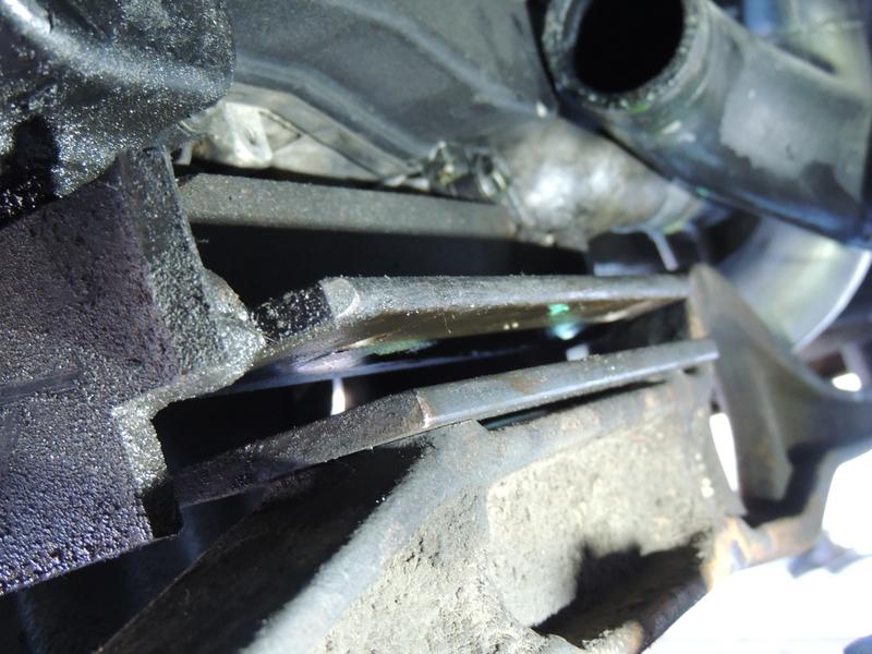

Issues that will need to be corrected to fit the new header/turbo setup:
- general re-arrangement of wiring, no biggie.
- space the engine up another 1/2" so exhaust will clear engine mount bar
- find straight thermostat housing (I think the 3.0L subie has this) to clear the exhaust
- offset blow-off valve. if anyone has any suggestions on this, I would love to hear it.
- my current thought is to just space the valve off to the right with cylinder spacers and longer bolts, then re-thread/bend the arm to fit. thoughts?

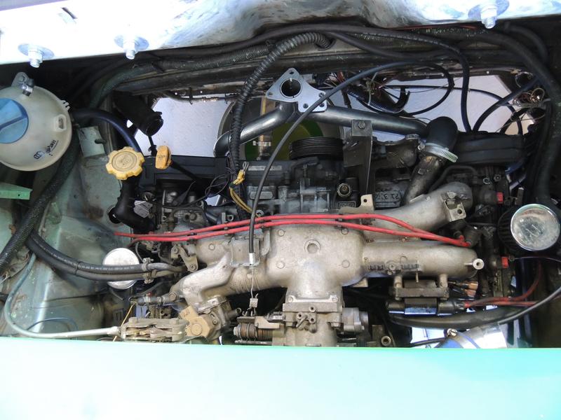

Birds-eye view of engine bay with header installed:
(IMG:http://www.914world.com/bbs2/uploads_offsite/i.imgur.com-5674-1583111520.1.jpg)
Close-up:
(IMG:http://www.914world.com/bbs2/uploads_offsite/i.imgur.com-5674-1583111521.2.jpg)
Turbo set in place:
(IMG:http://www.914world.com/bbs2/uploads_offsite/i.imgur.com-5674-1583111521.3.jpg)
(IMG:http://www.914world.com/bbs2/uploads_offsite/i.imgur.com-5674-1583111521.4.jpg)

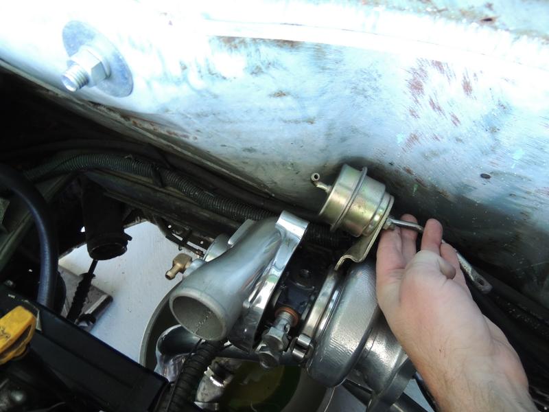

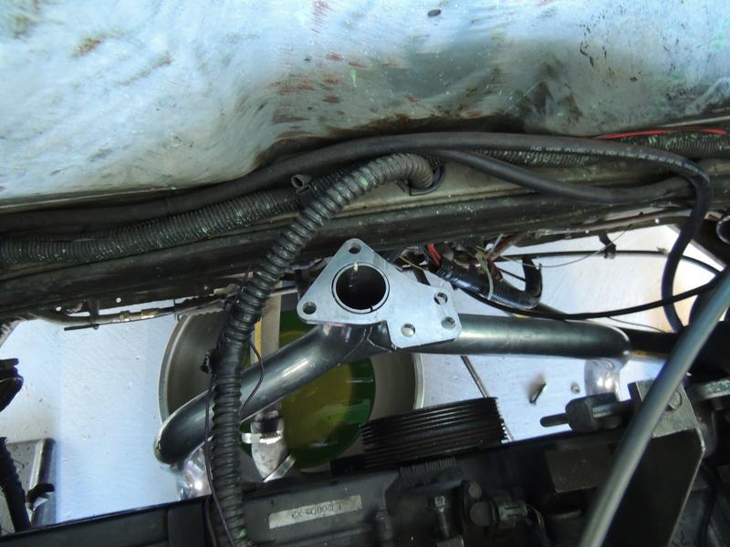

Clearance issue with bov. Should be flush against the turbo to the left
(IMG:http://www.914world.com/bbs2/uploads_offsite/i.imgur.com-5674-1583111521.5.jpg)

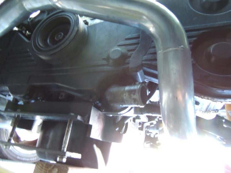

Thermostat housing inlet pipe interference with exhaust:
(IMG:http://www.914world.com/bbs2/uploads_offsite/i.imgur.com-5674-1583111522.6.jpg)
Exhaust just clearing engine bar:
(IMG:http://www.914world.com/bbs2/uploads_offsite/i.imgur.com-5674-1583111523.7.jpg)
Additional spacing required to achieve exhaust clearance: (engine is on a jack right now for mockup)
(IMG:http://www.914world.com/bbs2/uploads_offsite/i.imgur.com-5674-1583111524.8.jpg)
So the big thing is the blow-off valve. The rest of the items are pretty minor adjustments. Overall, I think this is going to be a really clean way to run the turbo.
Let me know what you think and what issues I may be missing.
Peter

Paint looks nice *Cough* (IMG:style_emoticons/default/tongue.gif)
Seriously this'll be a fun project to watch!!! Cant wait to see it!
Your clearance issue is with the wastegate actuator, BOV is another part.
You might need to go external wastegate.
Intercooler?
Intercooler?
Thanks, Andrew! yes, the paint is still holding up very nicely for almost 10 years! In case everyone hasn't figured it out, Andrew painted my car (IMG:style_emoticons/default/smile.gif)
And thanks for clarifying - my turbo knowledge is still limited. yes, it is the wastegate actuator that is hitting the firewall.
My plan is to go with no intercooler. I've read the info on outfront's website, and with this setup, as long as I stay ~7psi boost, it isn't needed. What do you think?
