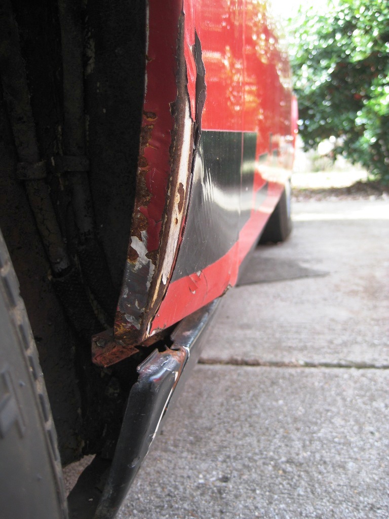

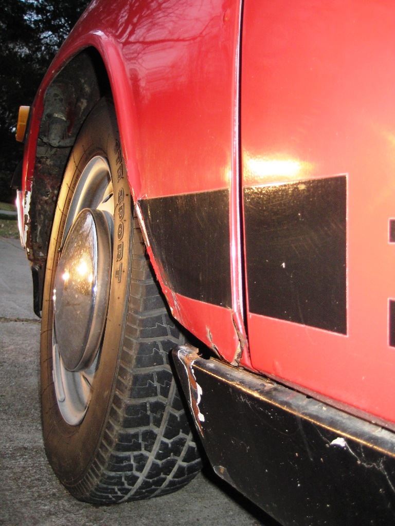

I won't say exactly how this happened, but suffice to say that someone was being negligent. I need to figure out how to fix my front driver side fender and rocker panel. Point me toward some crash-course bodywork info?

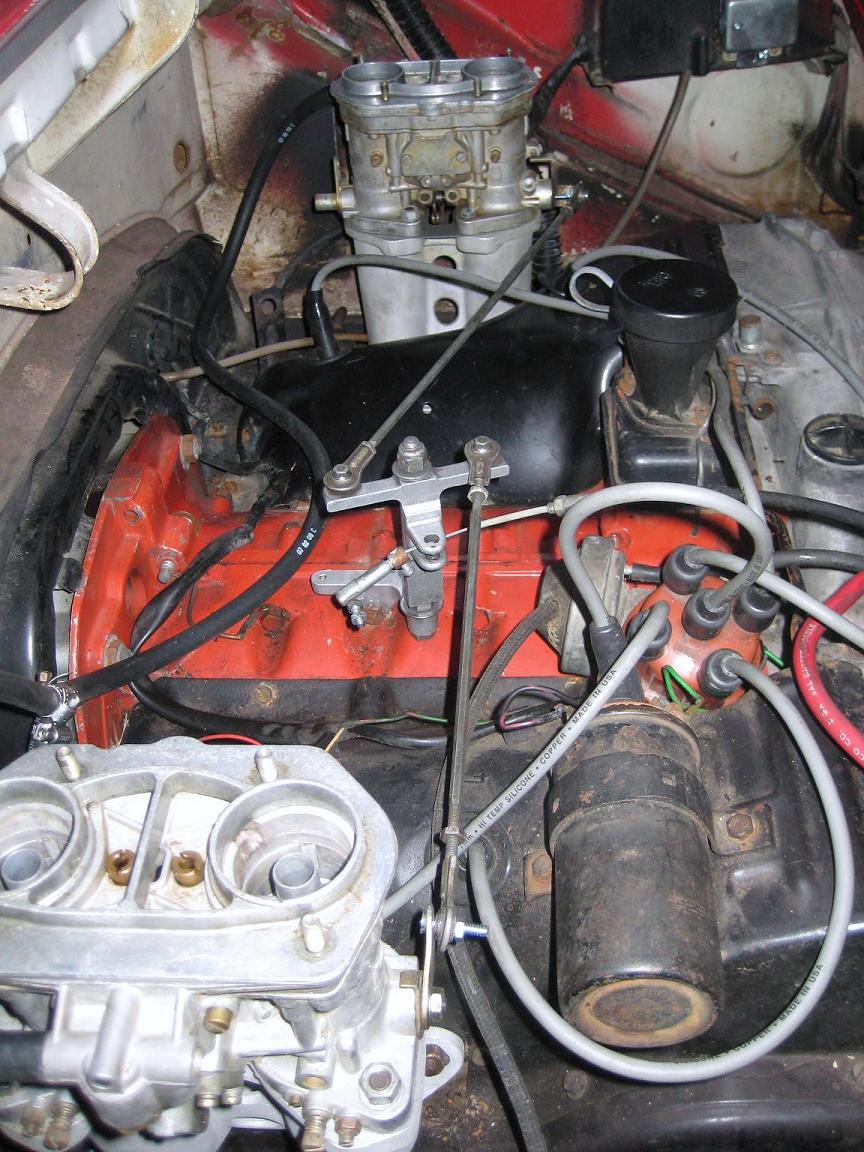

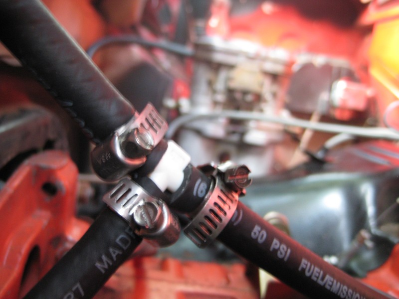

My latest focus has been on removing the Weber progressive 32/36, and hooking up the Weber 40's. As of today, I finally have them in there, but am second-guessing the gas line hookup. I'm also not to clear on the necessity of some of the other lines. Finally, I'll need to figure out how to hook up the linkage and throttle cable bracket. Pics are related.
Engine bay looking different with the dual Webers
/bootleg/ fuel tee

Lose that plastic tee. Plastic bakes and cracks then you burn your car down.

I guess I should get something more like this ?

Yup.
Metal is good.

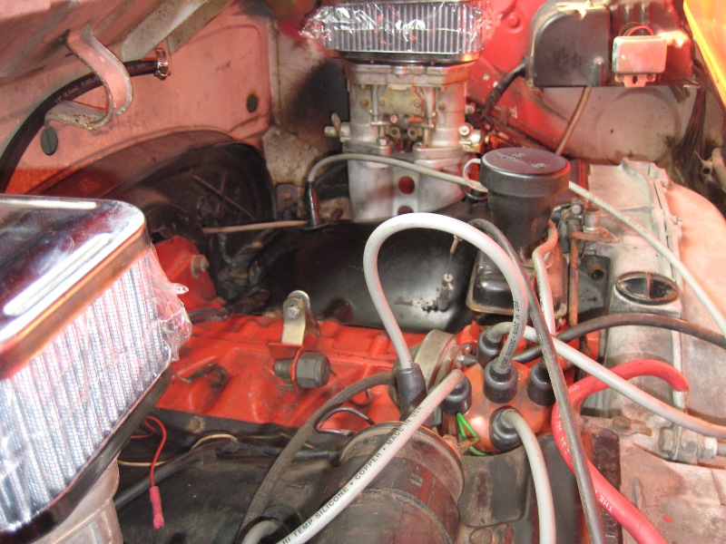

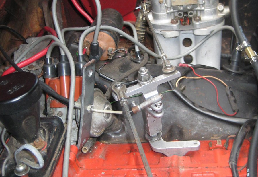

Plastic tee replaced with better metal tee. Also have the throttle cable linkage stuff in. Everything I've read here that said tweaking it is a headache is right on. I'm afraid it is gonna be a headache.
You guys think this looks right?

Not the linkage I have in my car, so I can't tell. The two basic things to test are if you've got the carbs opening at the same time (turn the linkage just a tiny bit in the middle, verify that carbs open at the same time) and if they're the same at wide open, which is a pretty obvious test
if those two are ok you're probably fine, but it wouldn't hurt to check that the plates are open the same in the middle of the range.

think everything is in place. only problem now is the gas pedal not wanting to return. i'll fiddle with things more this weekend; i don't think my throttle cable is quite right.

QUOTE(schreiber @ Aug 28 2009, 10:52 AM) *
(IMG:style_emoticons/default/smash.gif)
Your linkage is all f'ed up, the arms should be 90 degrees from the throttle shaft.
In this pic you're getting closer than the first pic but still not quite right. Flip your arms in the center see if that helps. The cable must be straight and true, any kinks and it won't work right. You will need a light spring on the center pull.

QUOTE(Mark Henry @ Sep 1 2009, 03:23 PM) *
Man that center looks bent.....and how it bolts to the case is cheesy.....
(IMG:style_emoticons/default/agree.gif) That center pivot mount is a pending disaster. You need to make one that mounts on two bolts or it will just tip over. The flat bar cable mount will flex and the hiem joint linkage is crossed up. Also the bolt sticking up on the end of that cable is going to hook onto the heim linkage as it passes over the cable end and hold the throttle open.

Many thanks to pilothyer, he came over this weekend and helped me work on the car. Got the linkage correct, got it running, and even drove it around a bit.
