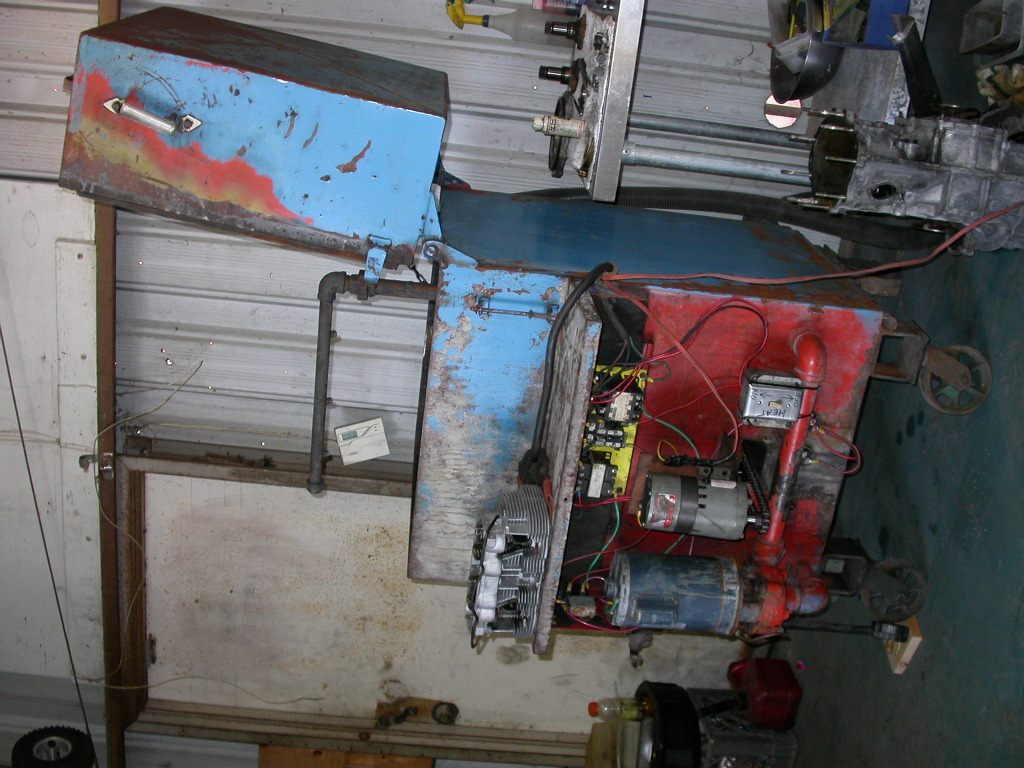

home made hot jet wash cabinet. 170 deg water, 200psi spray thru 50+ jets spraying top, side and bottom
damn near eveything came out of the trash the surplus store or HD racing.
turntable can hold 1000 lbs, spins 10 rpm, chain driven, gear reduction motor. the chain was the most expensive part bought from mc master carr about $50 for the cogs and chain. motor drive w reduction $10 K-surplus
pump was thrown away from Croc center community pool filter that failed (they thought) I re-bushed it and re-packed the shaft gland, added pump cooling line(HD racing $5)
relays were from the trash outside the recycling center
thermal couple and time sw were on some machine at the dump...I dont know what
HD racing heater elements 2ea 220v 4000w
220v 40 amp plug was on some machine thing at the metal scap yard
220 to 110 transformer was in the back of the scap mans truck
I bought the steel cabinet in irvine. I be its 50 yrs old

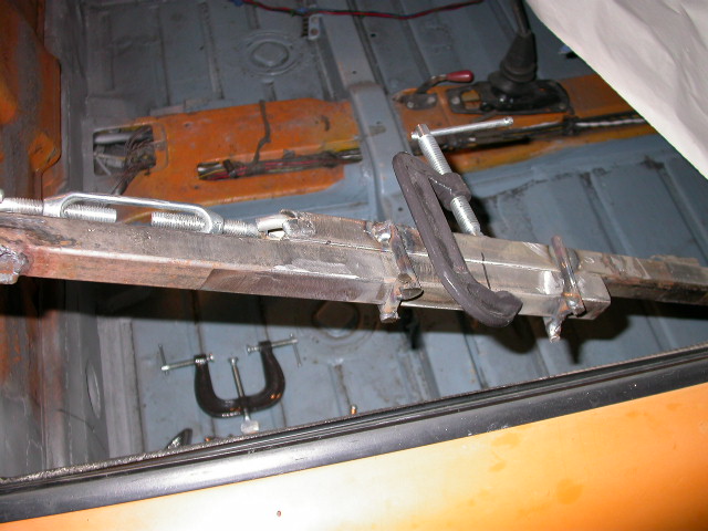

adjustable door bars . they slide in and out. the clamp is just to provide extra hold because the turn buckles are weak

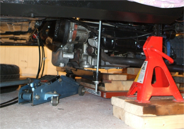

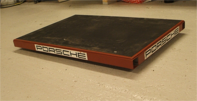

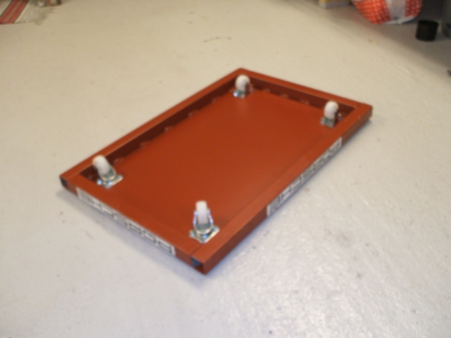

Low profile (2") engine trolley with swing wheels. I use it for engine drop/lift with threaded bars in the front (for security and engine guidance) and a jack in the front and one jack at the rear.
/Lars S
(IMG:http://www.914world.com/bbs2/uploads_offsite/www.lsmteknik.se-10787-1288091603.1.jpg)
(IMG:http://www.914world.com/bbs2/uploads_offsite/www.lsmteknik.se-10787-1288091606.2.jpg)
(IMG:http://www.914world.com/bbs2/uploads_offsite/www.lsmteknik.se-10787-1288091609.3.jpg)

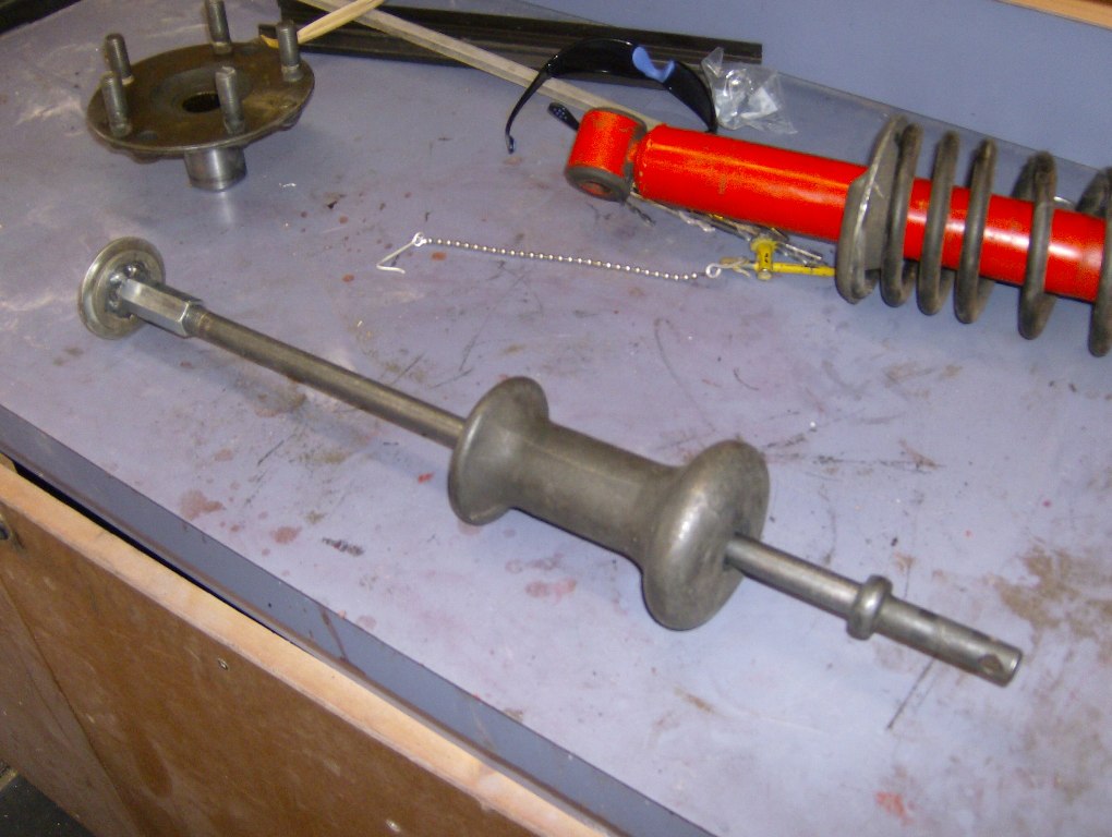

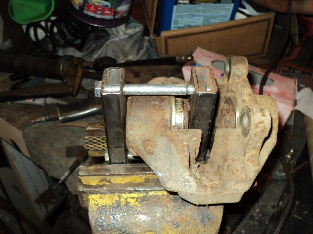

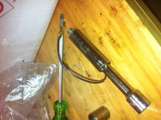

I made this slide hammer to drive out rear bearings.

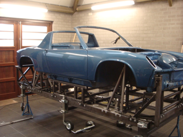

Member No.: 12,210
Region Association: Europe
Does this contraption qualify as a home made tool for the 914? (IMG:style_emoticons/default/biggrin.gif) (IMG:style_emoticons/default/biggrin.gif)

QUOTE(Hontec @ Mar 4 2011, 12:11 PM) *
I think that this contraption shows that you are in the making of a 914 manufaturing plant.. you are getting close... let the world know if you need extra help.
Nice piece of equipment (IMG:style_emoticons/default/aktion035.gif)
majkos
post Mar 4 2011, 11:20 AM
Post #111
Posts: 1,370
Joined: 29-February 04
From: Mile High 914
Member No.: 1,729
sorry, Hontec, you'are way overqualify
and your "Home made" contraption was built by over100 engineers
working all together at once.
Hell yes! this count! (IMG:style_emoticons/default/beerchug.gif)
Can I borrow it when you're done? (IMG:style_emoticons/default/welder.gif)

QUOTE(smontanaro @ Mar 4 2011, 07:48 PM) *
QUOTE(Hontec @ Mar 4 2011, 11:11 AM) *
What is it, a homemade Celette+914 fixtures?
S
jep, that's it....

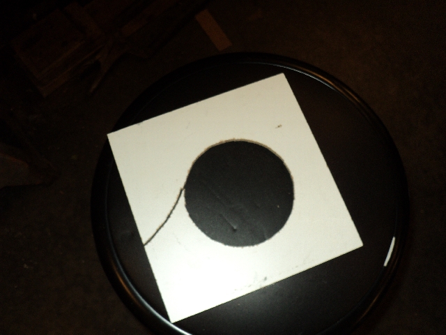

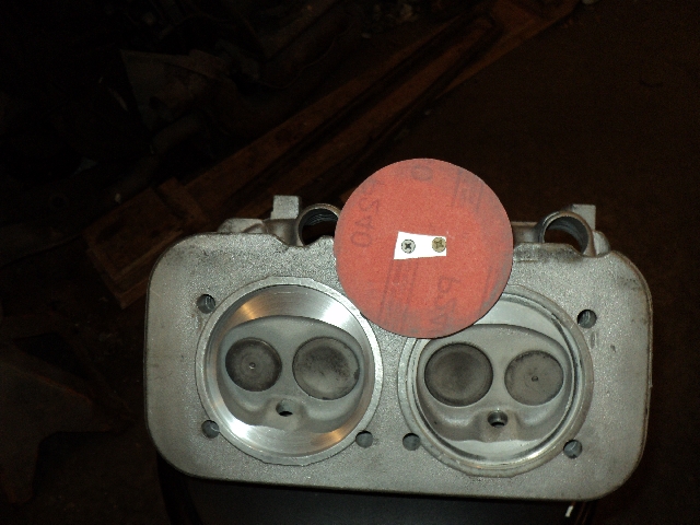

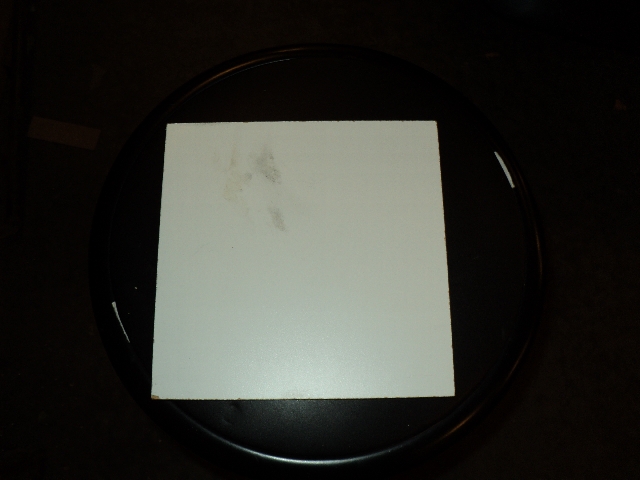

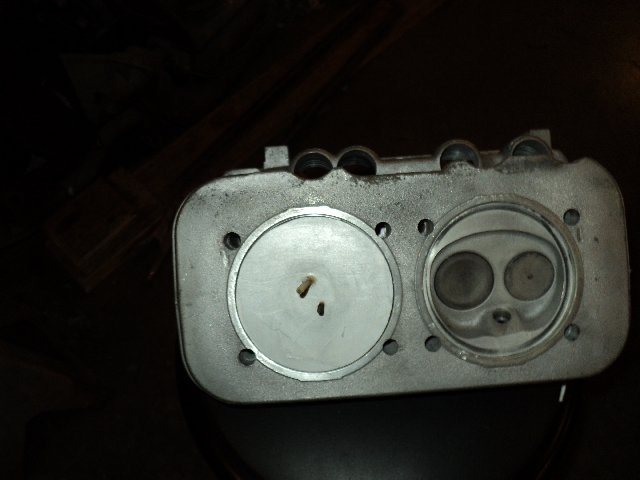

I had the chevy guys install new valve guides in this set of otherwise perfect 2.0 heads. Let's face it. Any shop that has ever worked on a set of aluminum heads which are very common now can preform basic head work. Some shops charge more for the mystery of machine work.
They couldn't fly cut them though. They didn't have the machine for it. Hey their chevy guys and know their limit. I looked closely at these heads and it appeared they were more stained than had any real issue that would require machine work.
So I thought about it for a while and decided to try to dress these myself. I took a piece of melamine and cut out a circle. The stuff is very flat.

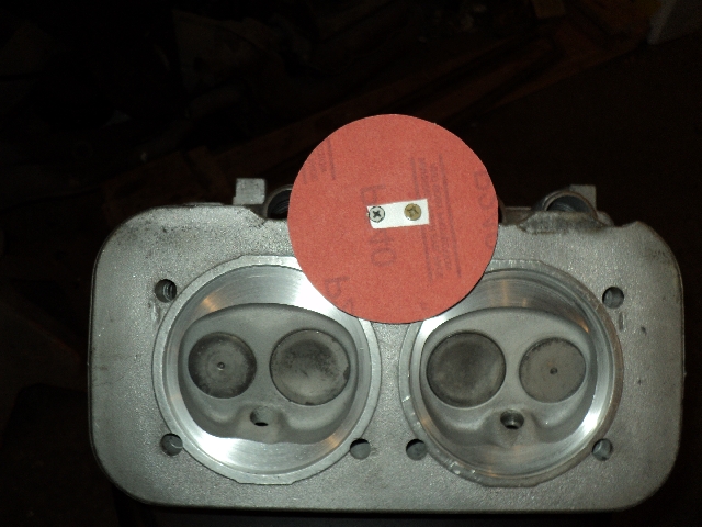

rick 918-S
post Mar 6 2011, 10:37 AM
Post #116
Hey nice rack! -Celette
Posts: 21,363
From: Now in Superior WI
Member No.: 43
I ran a couple of screws through it to use as a twisting handle. I used 240 grit sand paper.
rick 918-S
post Mar 6 2011, 10:41 AM
Post #117
Posts: 21,363
Member No.: 43

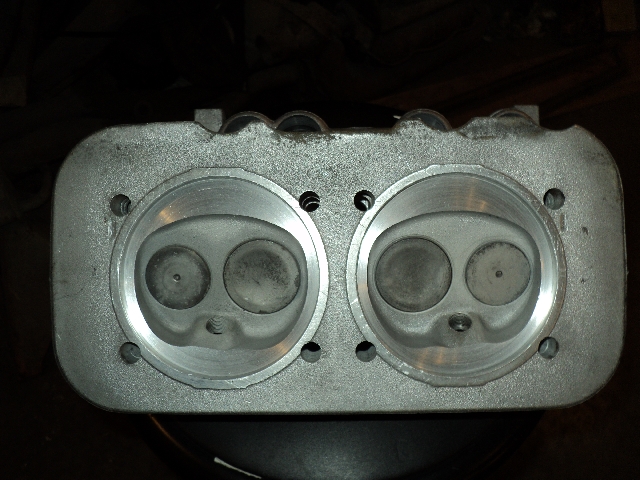

This is after a few minutes of work. I used a twisting motion holding pressure on the disc. Seriously, it took me longer to resize the photos and make this post than to dress this head. This most likely isn't Jake and Len approved but I knew there was no good reason to cut a bunch of material off these heads.
