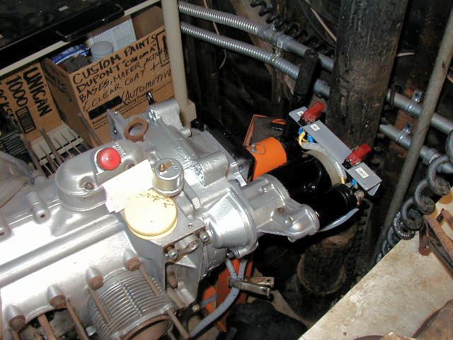

Here's a 911 engine run stand I built back in the 70's. Bus transaxle bell housing and a hefty V-8 stand (as others here have also done)
... and another run stand I started building a few years ago ... and still need to finish

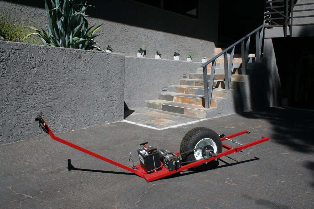

This one is home made, just not for the car. I got tired of falling on my old medicare ass pulling the airplane out of the hangar. Powered tugs are $2000 to $6000, so I made this one for $250. I bought a 12 volt hoist from Shanghai Tool Supply, (Harbor Freight) removed the cable and cable drum, welded on a sprocket. Bought the wheel, tire and hardware and welded it out of 1 inch square tubing. (IMG:style_emoticons/default/welder.gif) It moved the car OK but I haven't actually tried it with the plane yet. Hope the damn thing works.

Andyrew
post Aug 27 2011, 05:25 PM
Post #129
Spooling.... Please wait
Posts: 13,381
Joined: 20-January 03
From: Riverbank, Ca
Member No.: 172
Thats pretty darn cool!!

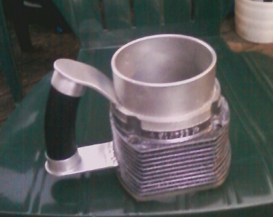

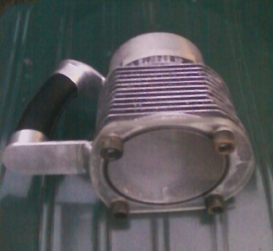

Upon completion of a job well done--- Here is an essential tool------The Jug Mug (IMG:style_emoticons/default/beer.gif)

QUOTE(sixnotfour @ Aug 27 2011, 08:17 PM) *
That thing is sick!

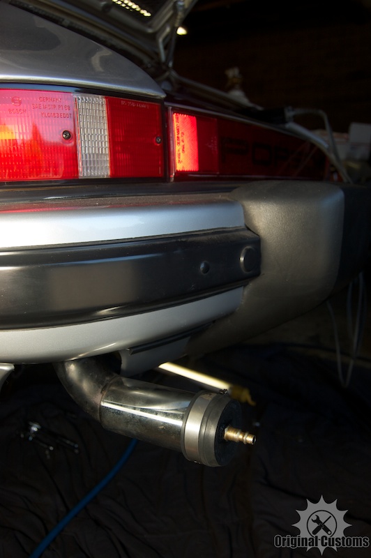

Exhaust 'leakdown' tester. I grabbed a Jim-Cap from the hardware store, drilled and tapped a piece of scrap metal, and threaded in the air connector. You have to pull the rockers so all valves are closed, but you can really lock down any exhaust leaks with this setup.
BTW, this pic is a 912E which has our same Type4 engine.

QUOTE(McMark @ Aug 28 2011, 10:20 AM) *
Cool. BTW, they're Gem Caps.
This one is badass! Let me know if this ever goes into production mode!

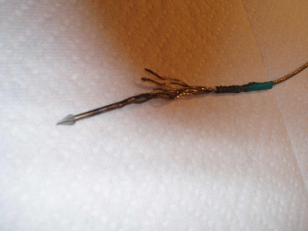

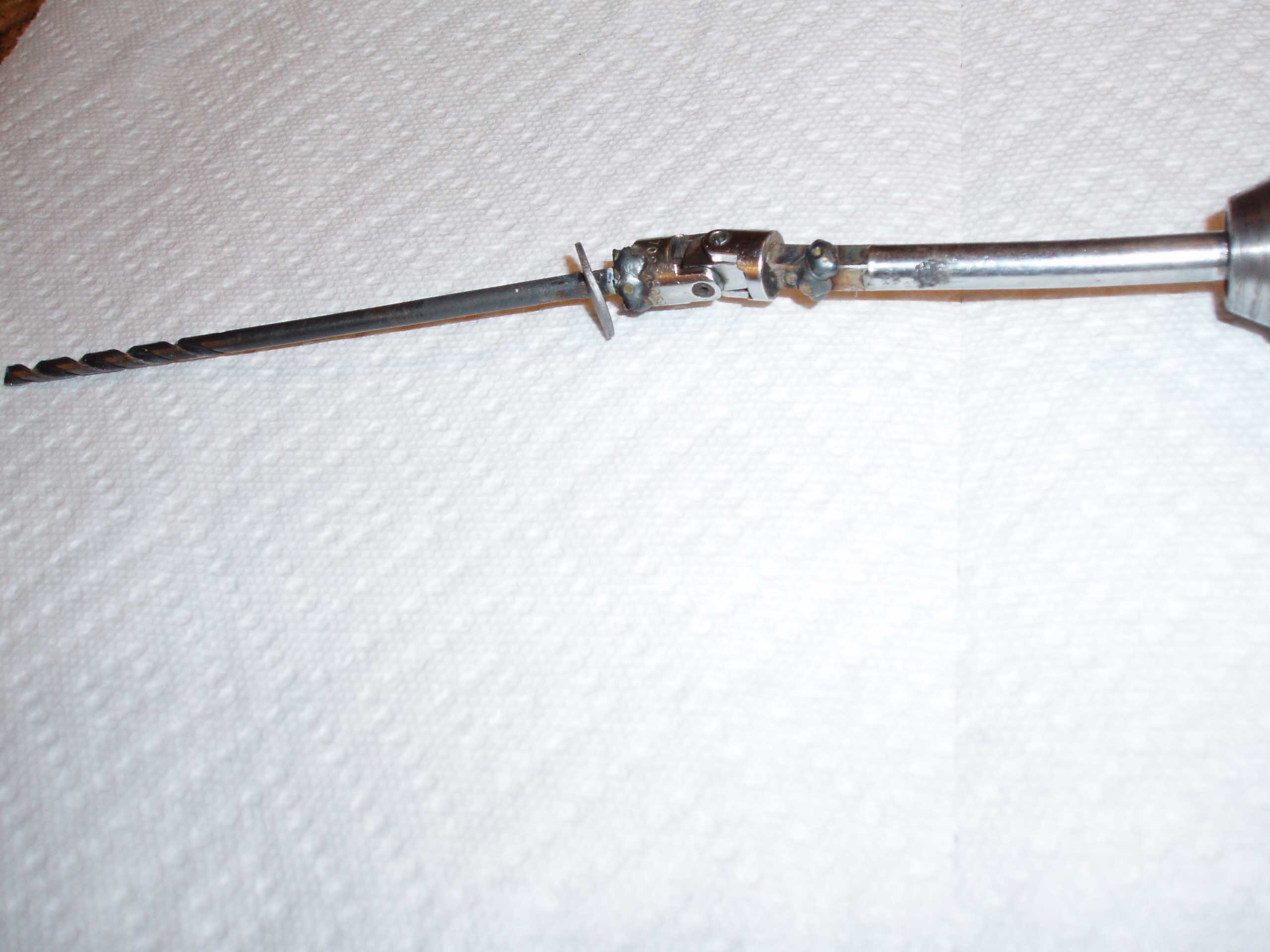

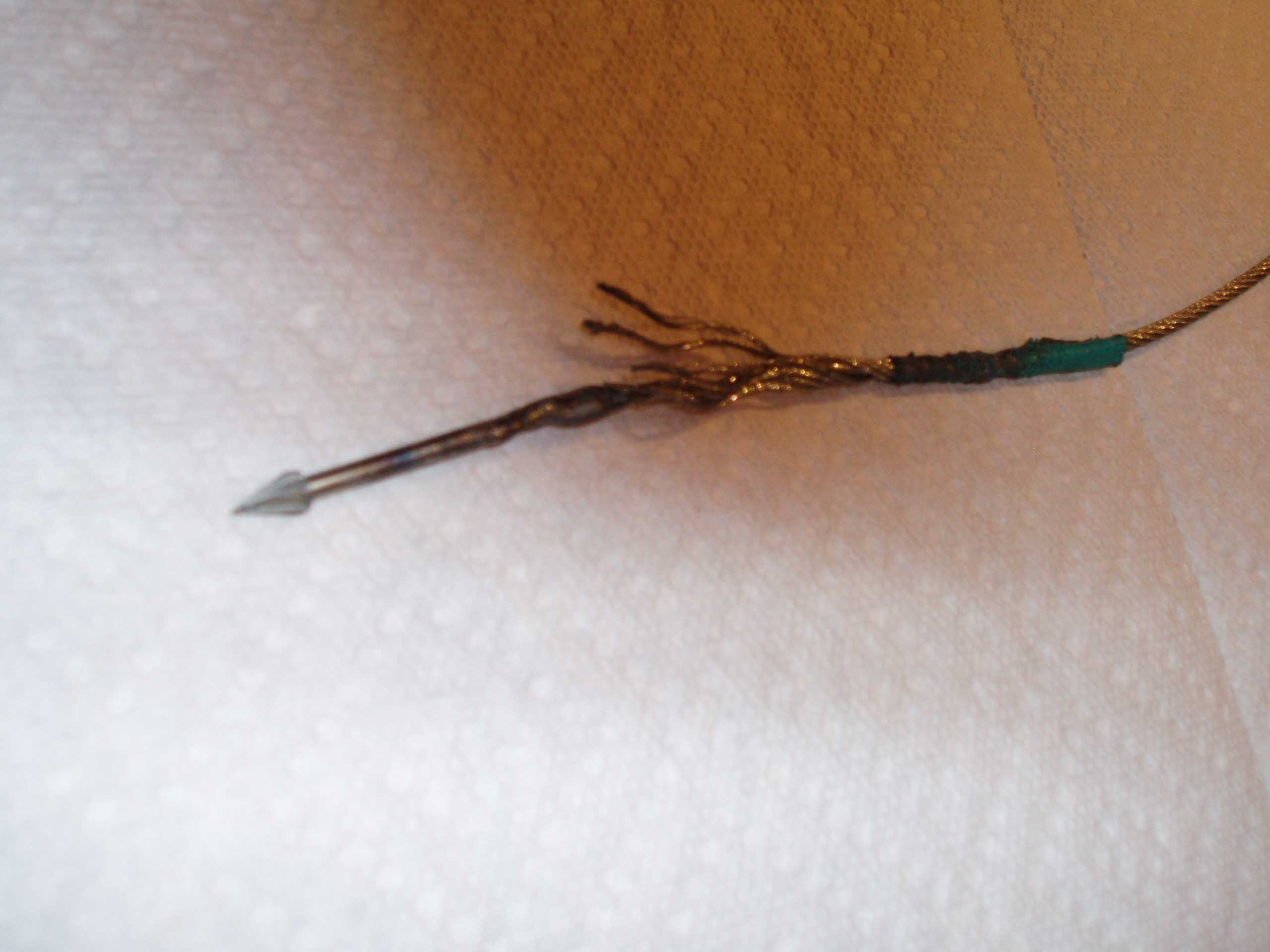

Had to make a new tool today!!
My accelerator cable was sticking at about 7" into the back of the tube and I couldn't get the new cable through. After 10-15 different attempts to unblock the tube with stuff welded onto cables I came up with this!
It took about 30 seconds and now the cable slides in!! (IMG:style_emoticons/default/piratenanner.gif)

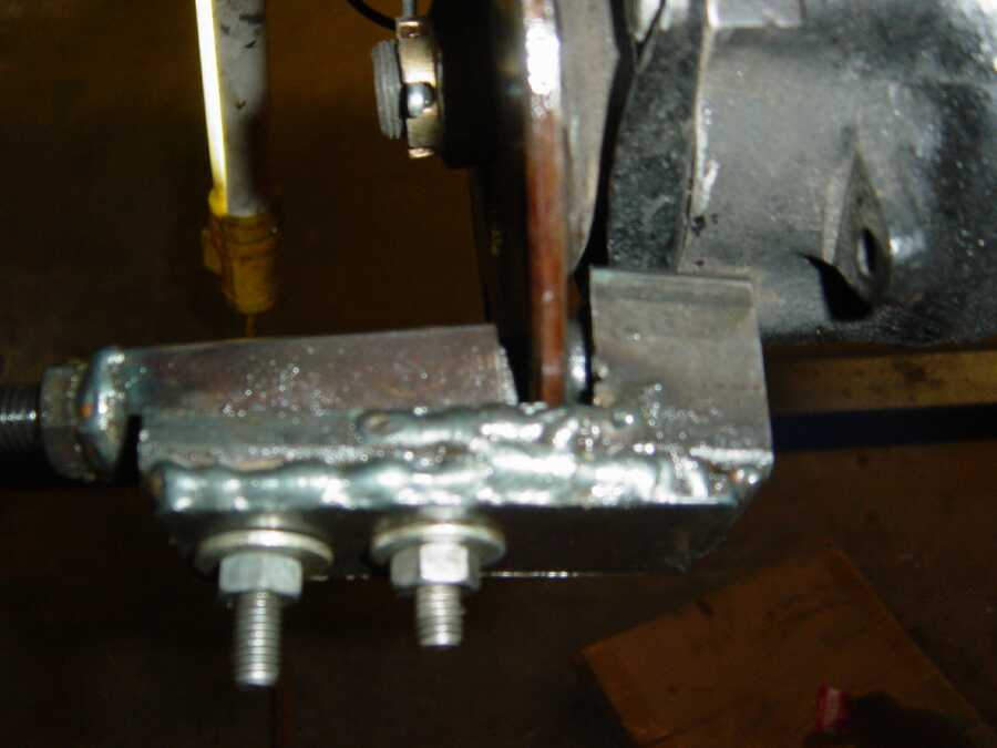

I had to remove some 66mm wheel studs so i could install 100mm studs.
the hex head screw pushed the stud out of the back of the hub with out removing the hub! I had to keep welding more reinforcement because it was bending.Attached Image
and the new 100mm stud installed
