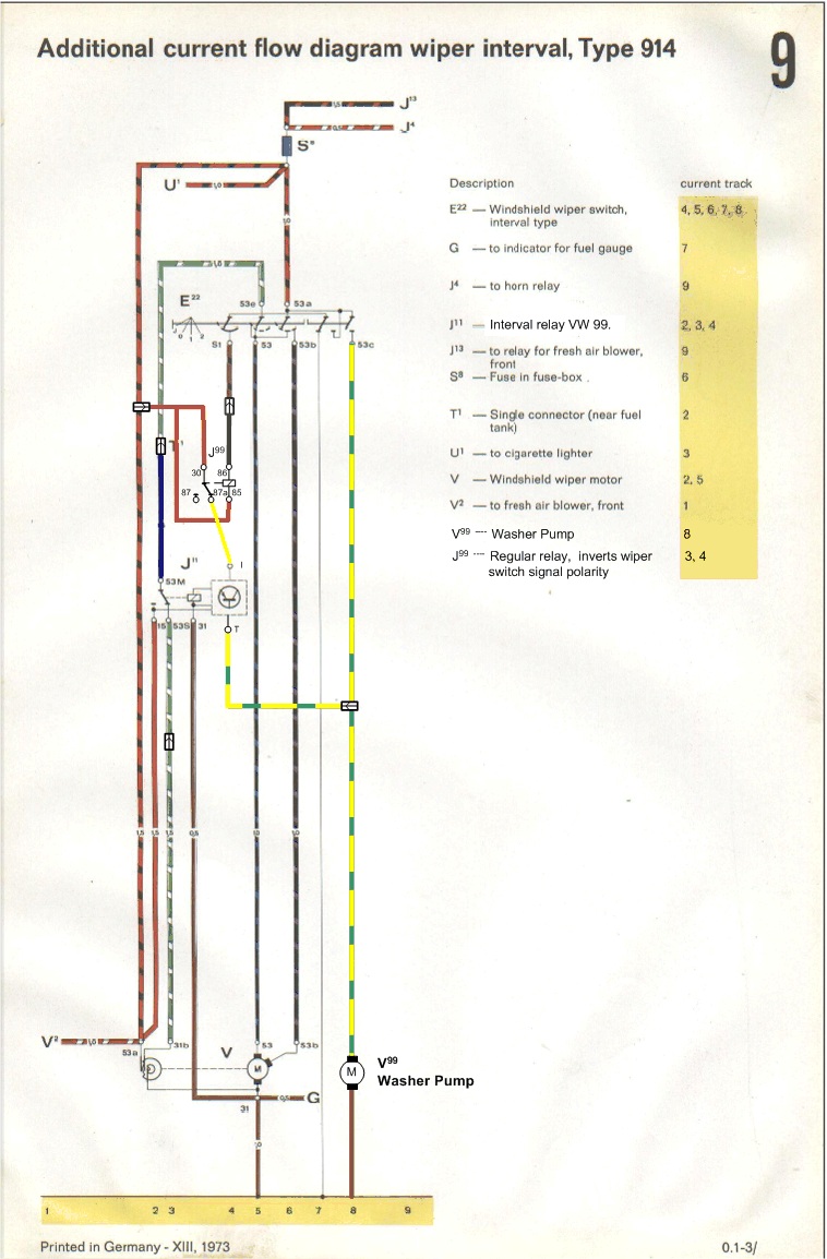

Hey! Does that mean it can have an intermitent relay wired in for the delay wiper feature also? That's be cool!

Yes, it has both pneumatic and electric pump. The electric pump activation will also trigger the wipers as it should (you don't have that with just an add-on switch ).
I also recommended that if you want to add a relay, you add the VW 99 relay that can be programed from the same wiper switch...The wiring loom for the relay is different but you need to build it any way..search my past posts for all the info. I can't do it from my phone now.

Addedum-slightly confused....so I would add a regular relay AND the interval relay from a 99VW?
