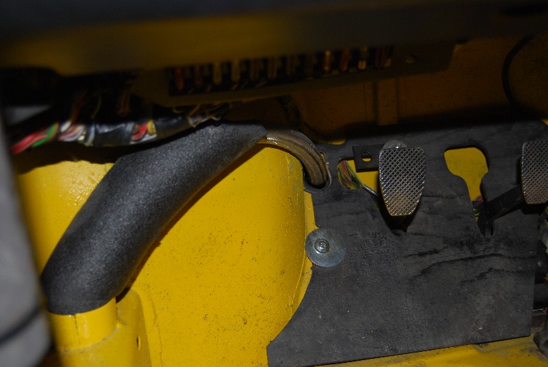

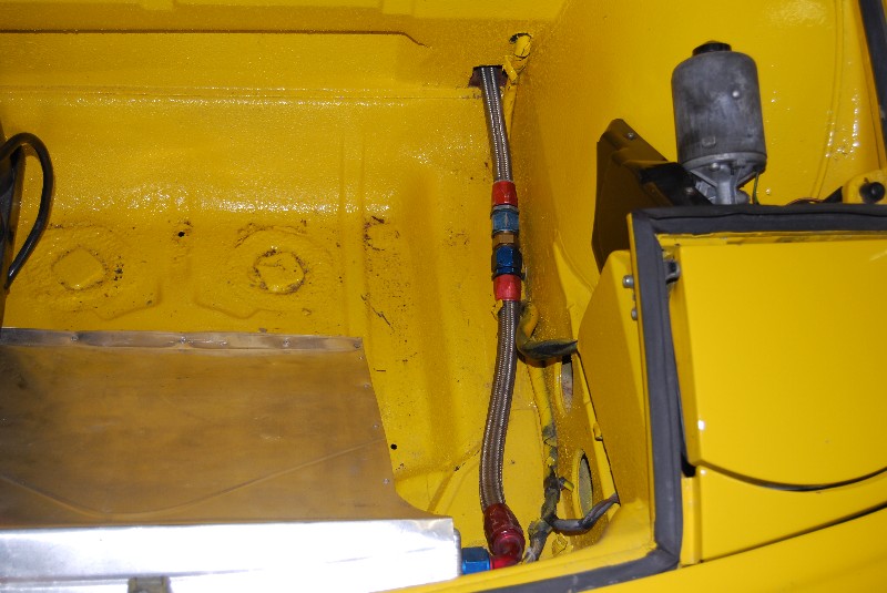

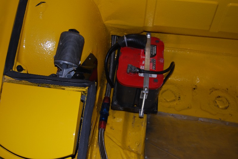

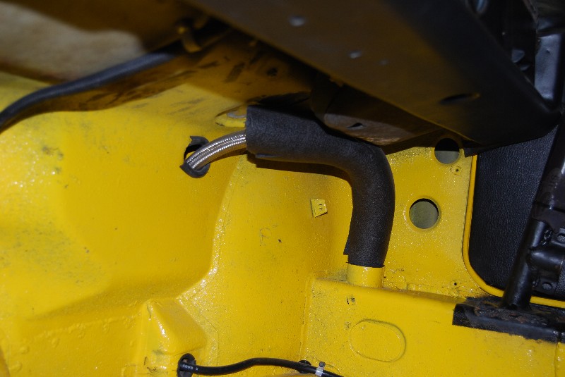

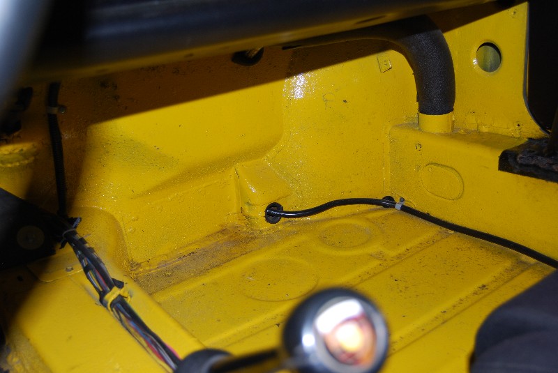

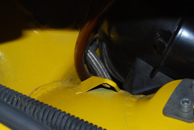

There are probably just as many ways and ideas on how to run oil lines as there are conversions out there!
Here's what I did; follow the pictures - there is a channel under the gas tank that you can run the oil lines through, and you don't need to remove the tank. You need to cut holes in the lower corners of the front trunk area, and in the foot wells. You can then run them into the heater ducts in the rockers then back all the way to the engine (no pics of this, but you get the idea).
On the passengers side, I chose to run the oil line up higher so it wasn't on the floor for fee to hit - so I had to remove the tank. But in my race car, the lines go all the way through onto the bottom - where I currently have the power line that you see.
naro914

Here you can see where it's under the gas tank, and where it WOULD come out if you just ran it all the way through the channel on the passengers side - down where the power line is.

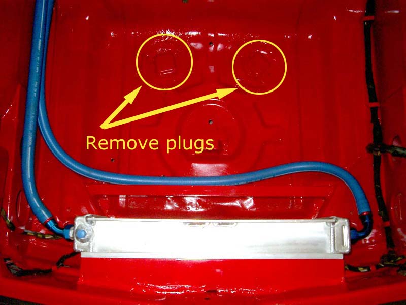

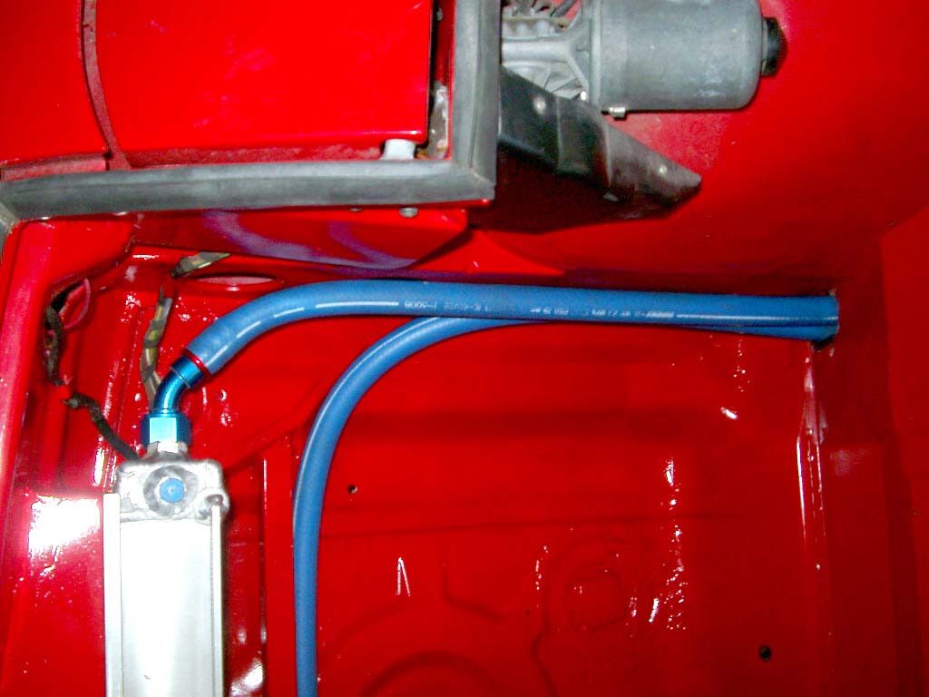

Couple of things ...
1. Running under the tank is easy, there's already a boxed section that will fit two oil lines nicely. See Pics below.
2. Venting through fender wells works, but will significantly heat up your brakes and tires. Probably not a problem for a street car, but for a track car, that's a no no ...
I'm currently venting mine out the bottom using the two large holes in the front trunk that are plugged by the factory with those round metal caps. Works well enough but eventually, i will make a shroud to vent up and out the hood.
3. Running oil lines inside the long. Works but you will have to make a pretty tight bend getting out of the long in the front, either on top of on the side.
Either way, you'll have a hard time not to kink the lines and restrict oil flow.
I just ran the lines on the inside next to the pass. long. Straight shot to the rear and i added a thermostat inside the rear firewall, close to the engine.

more pix here:
http://www.914world.com/bbs2/index.php?showtopic=94924

Just to add....on the pass side, if you want to follow the holes that Andy did (I recommend it so you don't have to remove the tank), you can also run the lines into the rockers by removing the plug right where he has it run up against the inner rocker - just below the vent tube hole.
