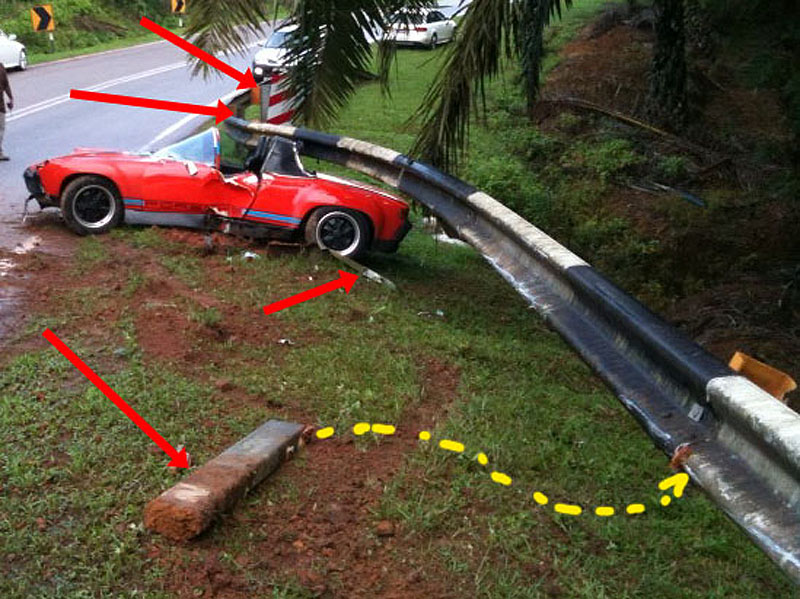

Here is my "crash investigation" with the limited picture I have.
Click to view attachmentThe
RED lines indicate that car had rotated and the rear/front crossed.

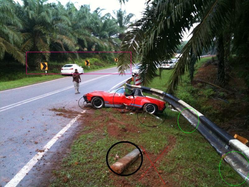

The
LIME green indicate 'possible' contact damage with the guard rail
(I believe the guard rail to be in that design and NOT shoved into the weird bow due to impact)
The
BLACK represent what I believe to have caused the damage to the car or what contacted. With more pictures I could tell you what it hit. But I believe it to be a sign post or some sort of turn warning. There are TWO posts in the picture. Look by the left rear tire. The post definitely hit the long or something low such as that post or it's concrete base. The post fell and struck the windscreen and passenger ooops, driver door.
Right handed drive car...
LEFT DOOR obviously was struck. I would bet the post with the sign (by left rear tire) struck the upper part of the door and the windscreen/support.
THE PINK BOX. Here lies the WTF? question. How did this guy lose it BEFORE the turn. The red lines and dirt spray indicate the direction he is traveling. The driver lost this BEFORE getting to the APEX of the turn. So something happened such as getting a tire into the dirt or............................
A LOCK TIRE ALWAYS LEADS. This is why removing the proportioning valve is a BAD thing. When you pull the Parking Brake on a car is spins right? Well, the laws of physics cause that. A locked tire will always come around and lead! ALWAYS. I would bet the right side of the tires have scrub on the sidewalls. The vehicle rotated clockwise. So the driver had some sort of input.......
MY CONCLUSION: The driver was driving hard and fast. He comes down a straight with heavy right foot. He does his braking BEFORE the turn as required. But his heavy right foot touches the brakes too hard and with the removal of the proportioning valve the rear tires lock. The vehicle rotates and then the driver is just along for the CIRCUS RIDE. A 914 spins so quick anyway.
