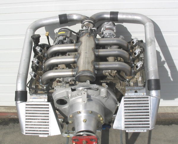

Here's two DYI's on making a good plenum:
http://www.sdsefi.com/techinta.htmhttp://www.sdsefi.com/air12.html
Mark Henry
Nov 11 2010, 09:50 PM
Nice

I guess I can powder coat now that I think about it. The fuel will be introduced at the head so it will only be air in the plenum. Duh. WIth the carb, the fuel eats away paint over time and then I am back to square one. Yet another reason my CIS is a better deal.
Dr Evil
Nov 11 2010, 09:52 PM
QUOTE(Mark Henry @ Nov 11 2010, 10:50 PM)
Nice
that......is....SEXY!!!!
Mark Henry
Nov 11 2010, 09:55 PM
QUOTE(Dr Evil @ Nov 11 2010, 10:51 PM)
Yep
yep
Mark Henry
Nov 11 2010, 09:57 PM
Bottom looks nice as well
Dr Evil
Nov 11 2010, 10:00 PM
Ooooh, I need a wet nap
