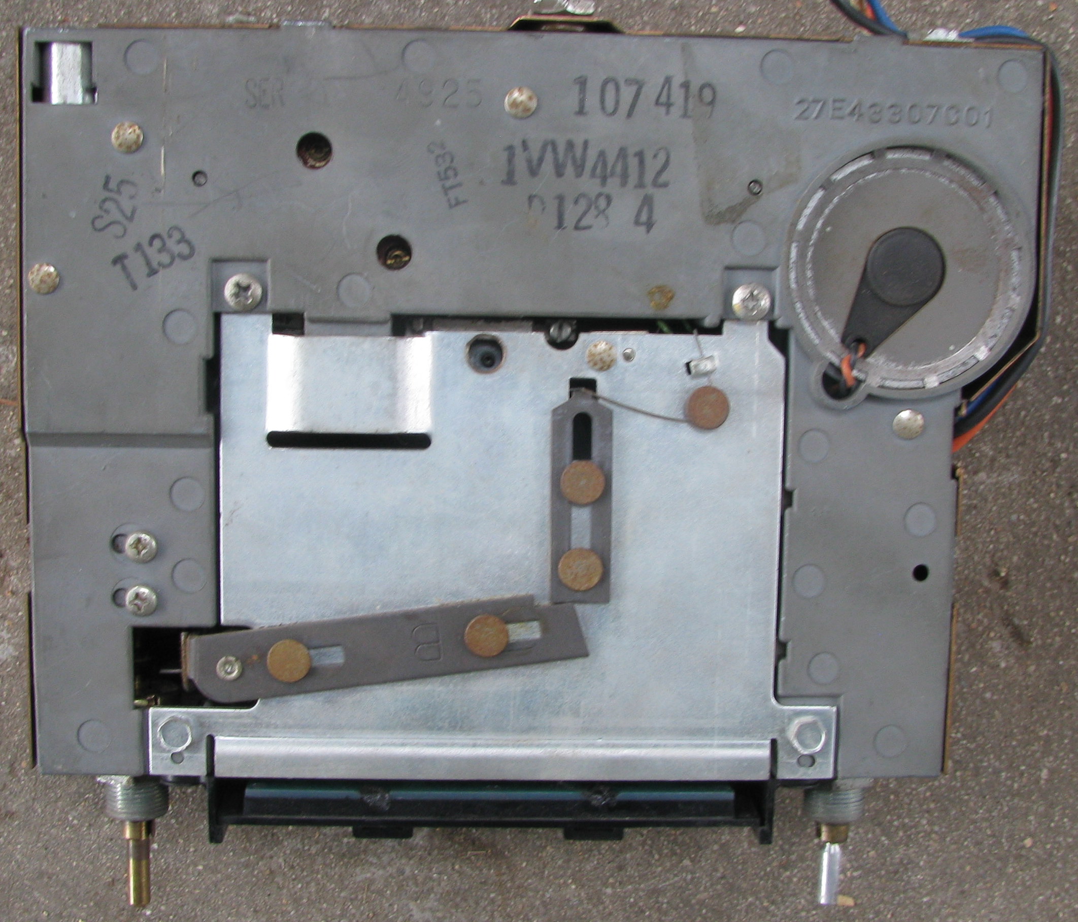

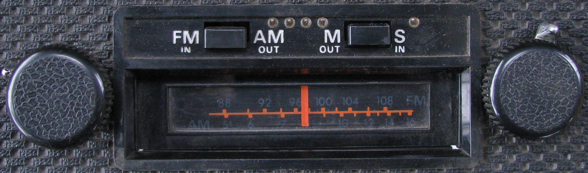

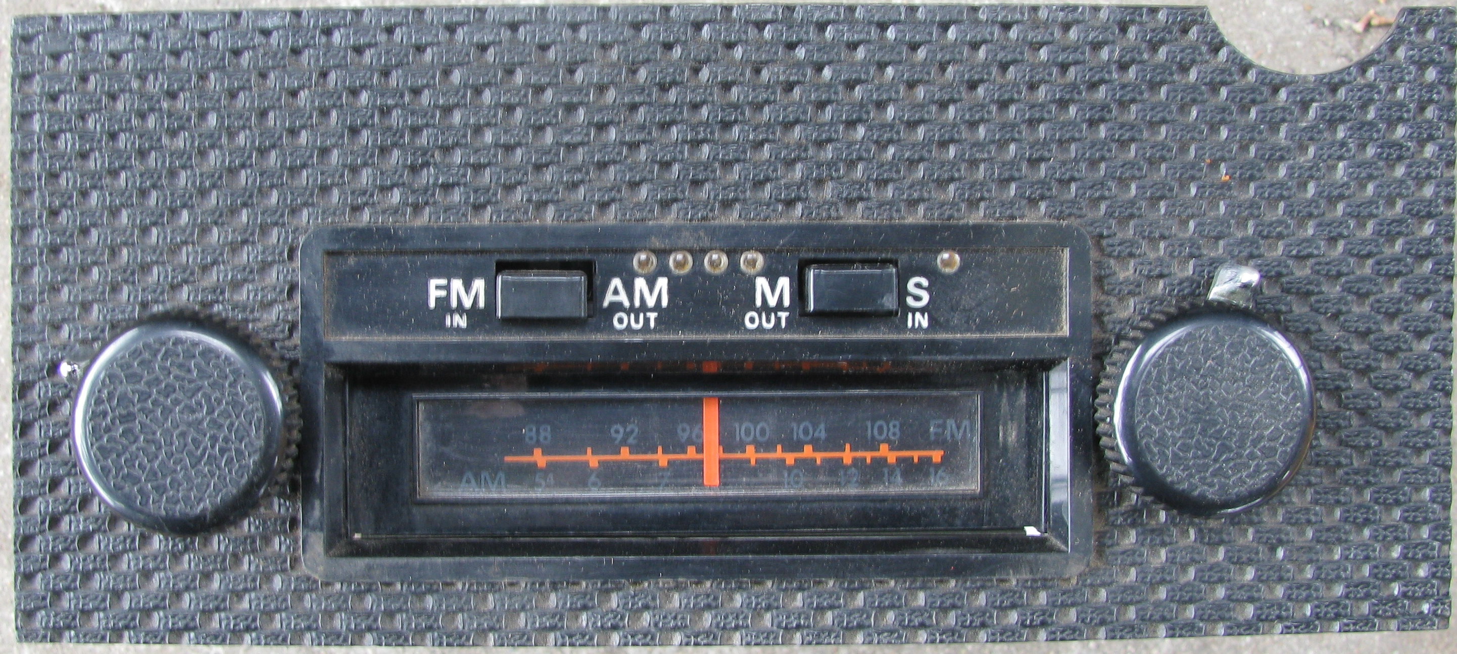

BTW - Motorola made radios for both Porsche/Porsche+Audi & VW of America (VoA's VPC div.) for installation by dealers in their cars here. Not bad radios in fact, and in some cases better than some Blau's.
I have the original Motorola made AM/FM/8-Track for mine, which will go back into mine with my resto....
Click to view attachmentClick to view attachmentClick to view attachmentSo your Motorola could be originally installed by the dealer at the time of purchase, even if not factory installed. IMHO that IS original (sorry Pat).

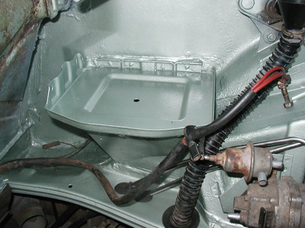

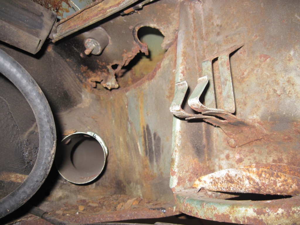

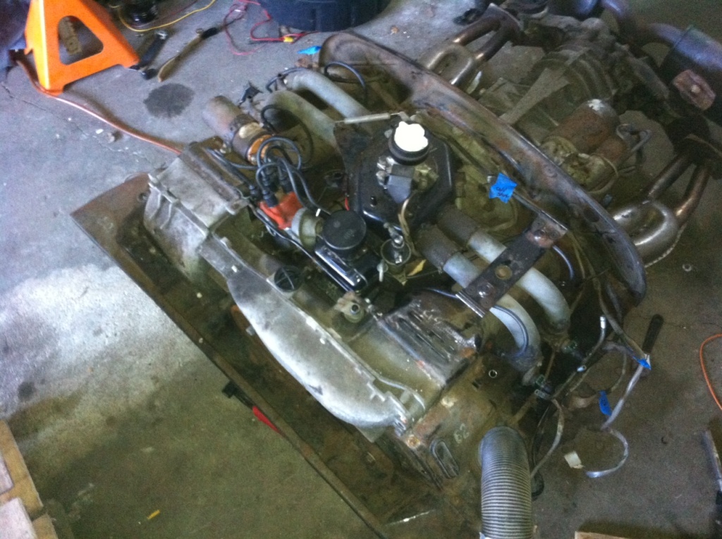

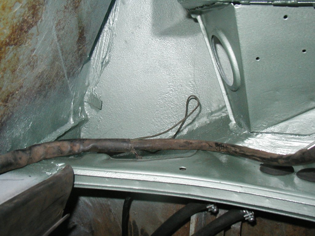

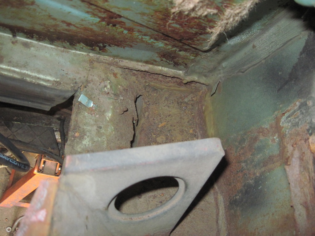

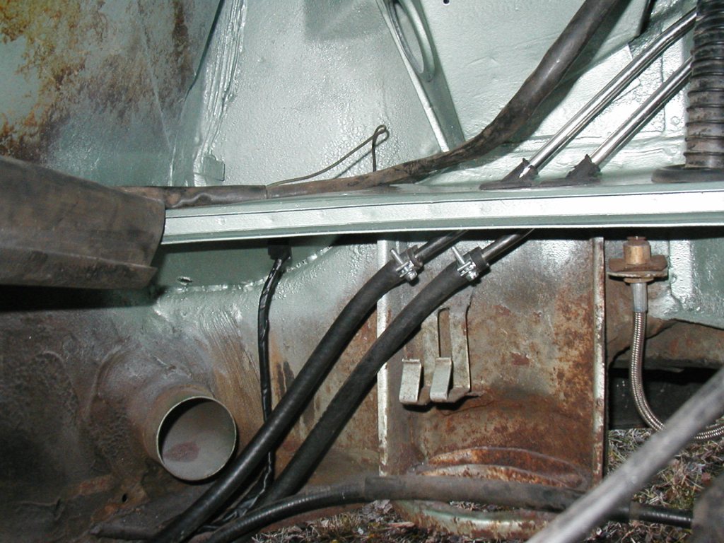

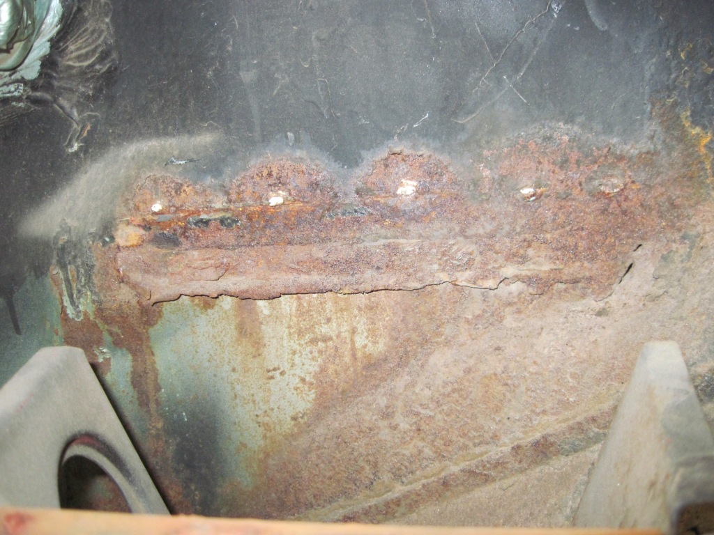

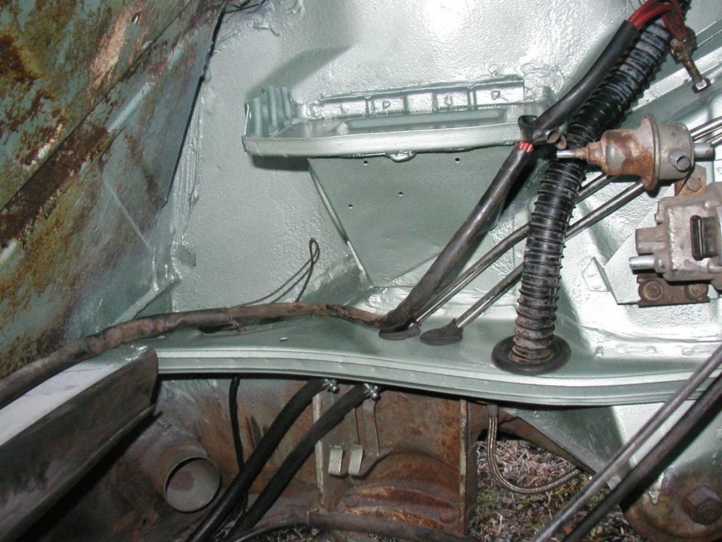

Been a while since the last update. MUSR was a blast, and the drive there and back from Lafayette went well. Towards the end of the drive back the clutch started acting a little funny, which leads me to the current state.
I pulled the engine to replace the clutch, and found a spot more rust in the hell hole than the previous owner had admitted to. It looked far better with the engine in. I shipped the car off to Brad Mayeur and had him put in a new right engine shelf and generally clean up the area.
Before:
Click to view attachmentClick to view attachmentClick to view attachmentClick to view attachmentAfter:
Click to view attachmentClick to view attachmentClick to view attachmentClick to view attachmentClick to view attachment

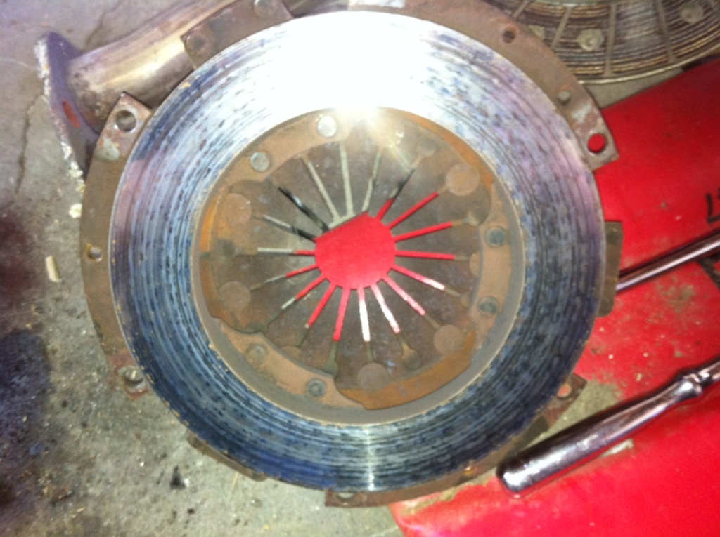

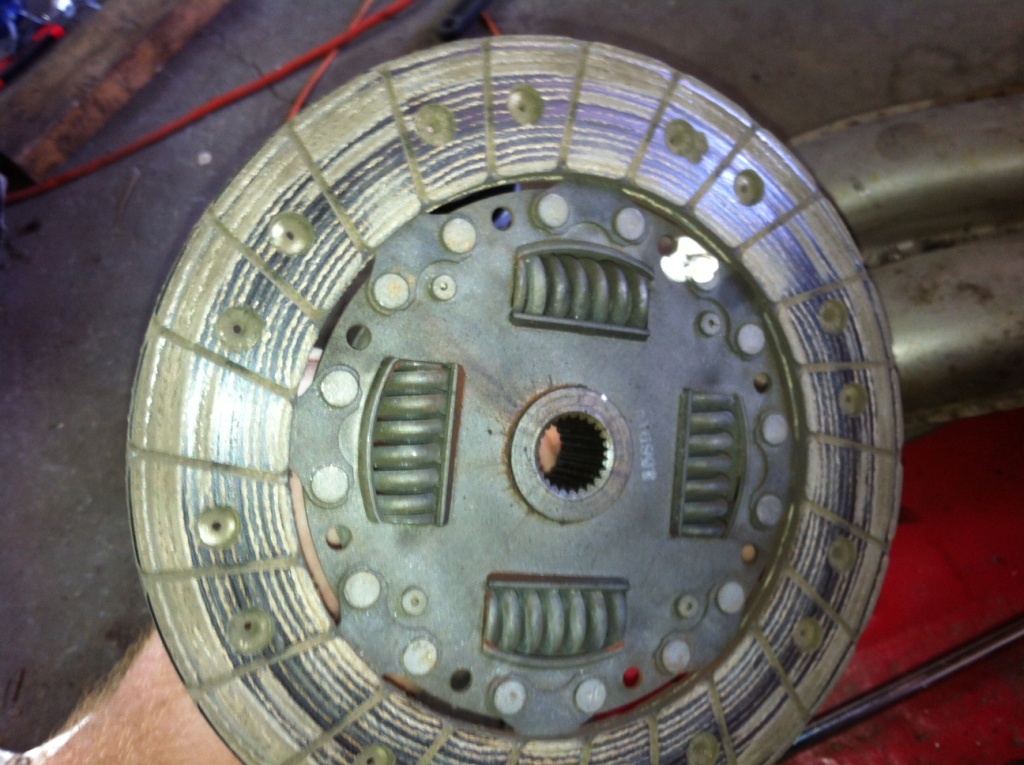

I then turned my attention to the clutch. The previous owner told me when I bought it that it had recently had the clutch done, so I was confused by apparent failure of the clutch. When I took it apart there was deep grooving on the flywheel and little/no wear on the clutch. It was apparent that whoever replaced the clutch did not wish to machine the flywheel back to spec. Also, the pressure plate splines were badly worn from pushing the clutch so far. Fortunately I have a spare pressure plate in my leftover parts bin and will be replacing the clutch with new.
Click to view attachmentClick to view attachmentClick to view attachmentI also ordered a new rear main seal "while I'm there"

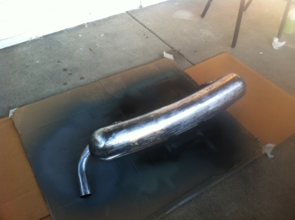

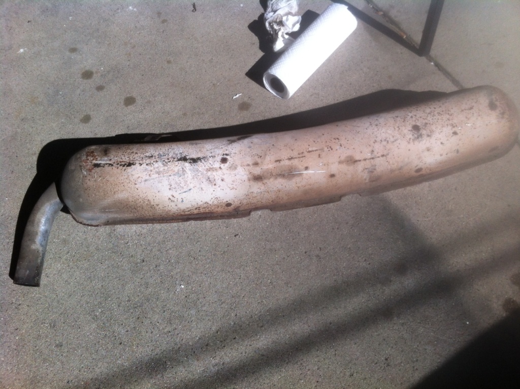

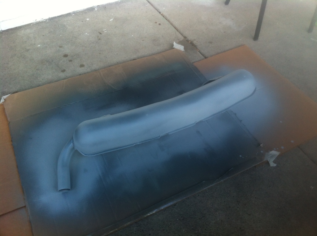

I also picked up an original 2.0L Leistritz banana muffler, which I wire brushed down and hit with a coat of zinc paint. Looking pretty sharp now.
Click to view attachmentClick to view attachmentClick to view attachmentI am also refreshing the engine bay tins and some other engine parts. Here are some before pictures, after pictures should come within the next two weeks.

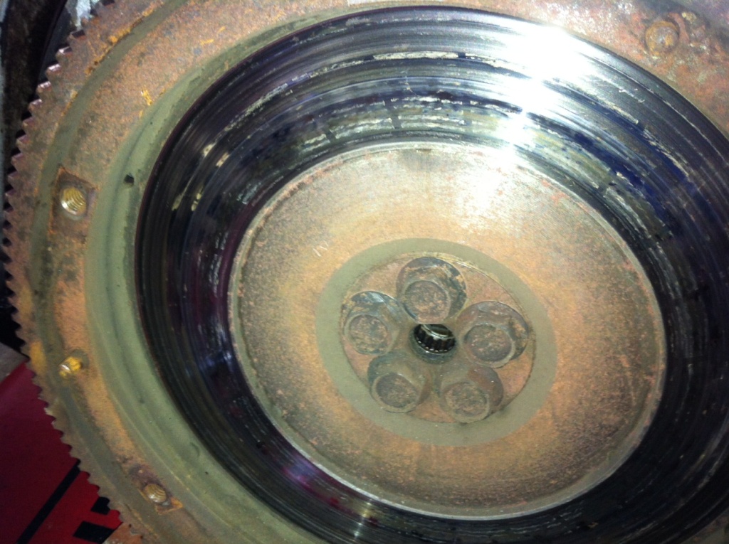

rnellums
May 17 2012, 01:39 PM
New used pressure plate (the old one was really warped!) and cleaned up engine:

Engine ready to go back in!

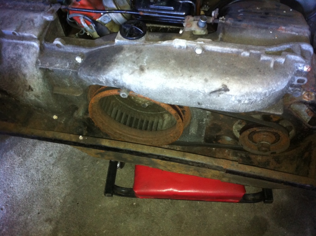

I ended up putting the original transmission mounts back in, they looked like they weren't broken, but they are MUCH more pliable than the 911 motor mounts I have on my other transmission. Should I swap the 911 mounts in for the old stock mounts? The car seems to drive and shift fine.
Pictures are of the stock mounts.
