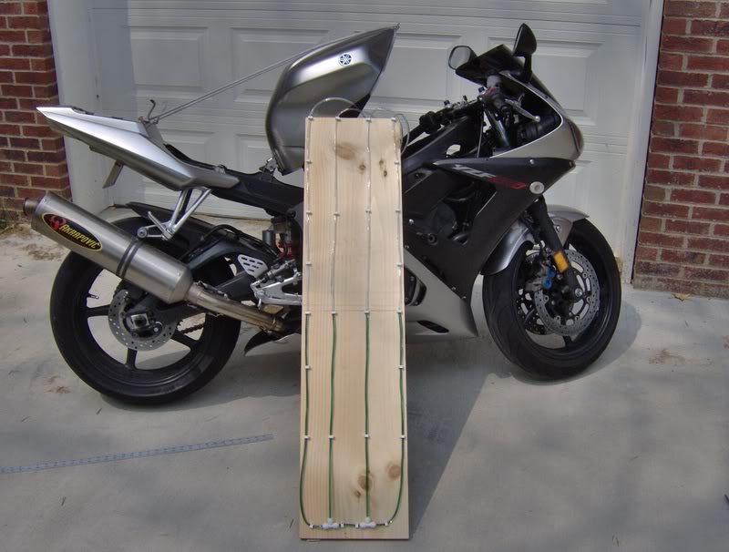

I used Mercury Sticks to balance my Motor cycle carbs works great.. it's only about 24" long
