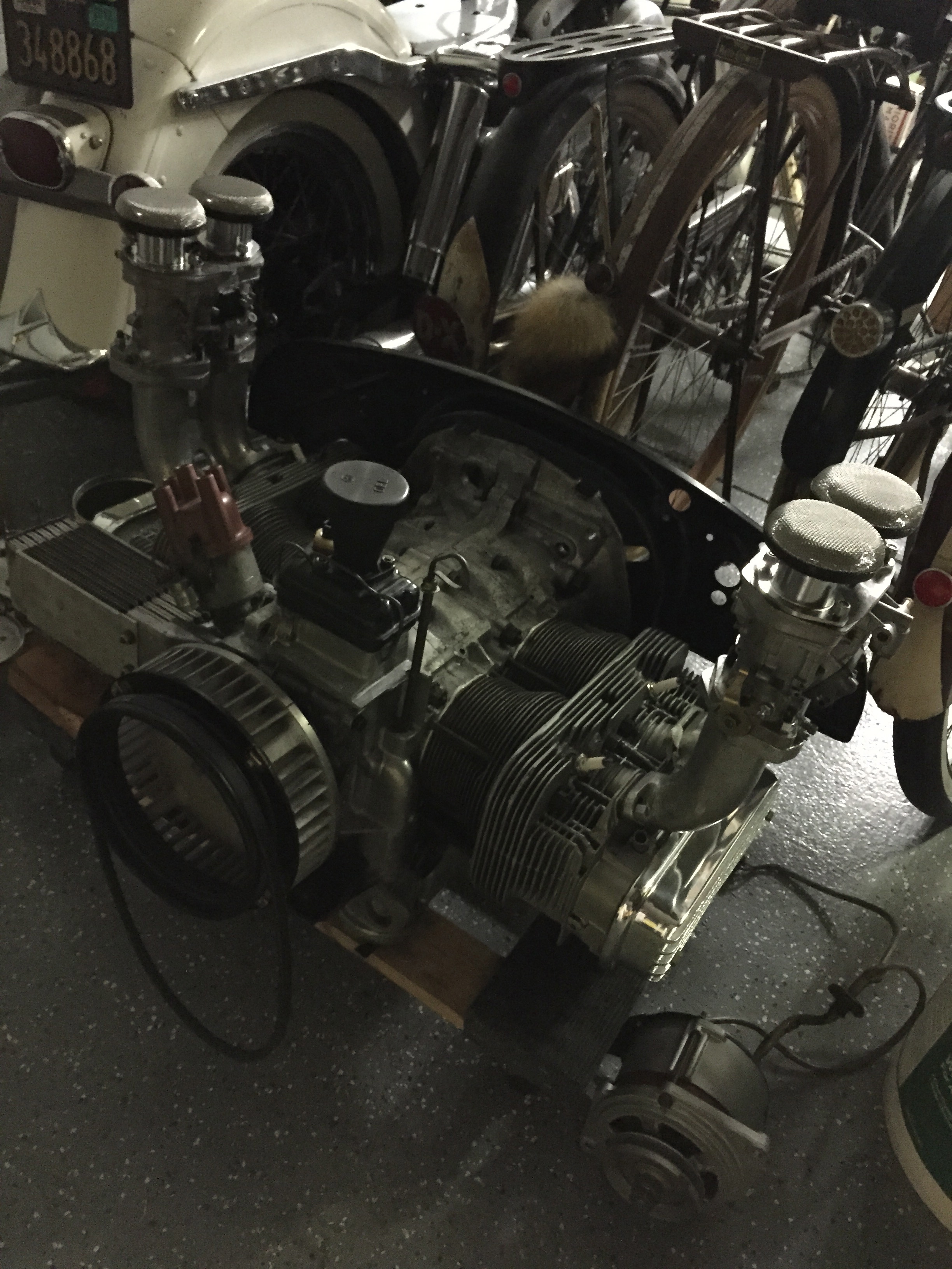

Building a new engine…...Click to view attachment

Cool, You'll like it from what you were running before. I did a 2056 in my 72 with 44 webers aktion035.gif

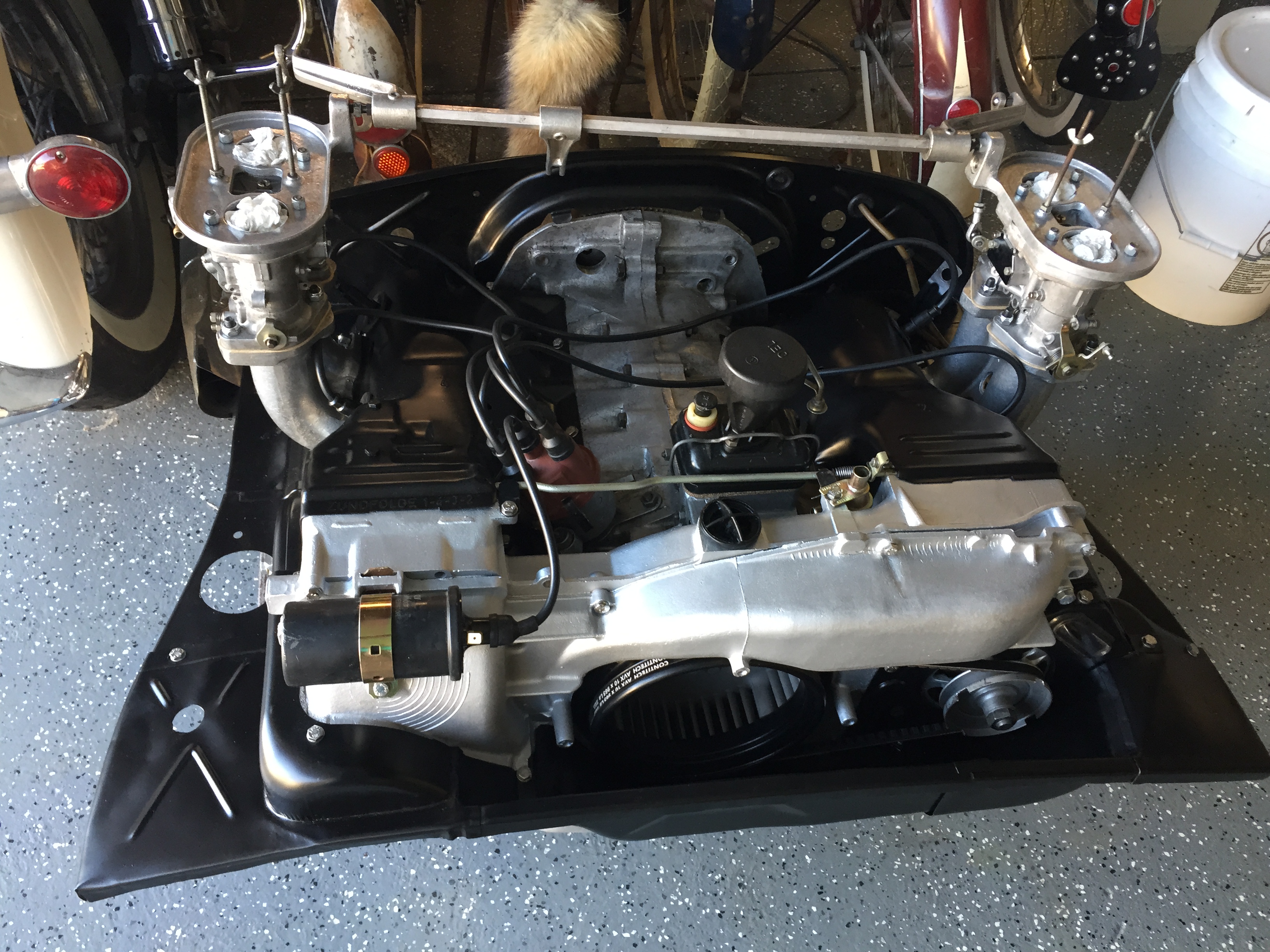

Constructed my engine and put the tin on and……
Larmo63
I think I have it figured out now…..

Did you get the oil cooler support on without taking the tin back off?
--DD
euro911
Larmo63
Left side tin came back off. Bracket on.
Why doesn't my back tin fit down snugly on the bell housing? Are there two different styles? The two clips that are supposed to "clip" onto it are sitting proud of it now. Weird.
What do people use for a too short thermostat wire? Anybody got one for me?
I'm not running heat, does anybody make block-off tin plates for the heater hose openings?
euro911
The rear tin just fit that way dry.gif ... You just have to get it to fit the best you can.
I use some rubber tubing caps if not running heater hoses.
