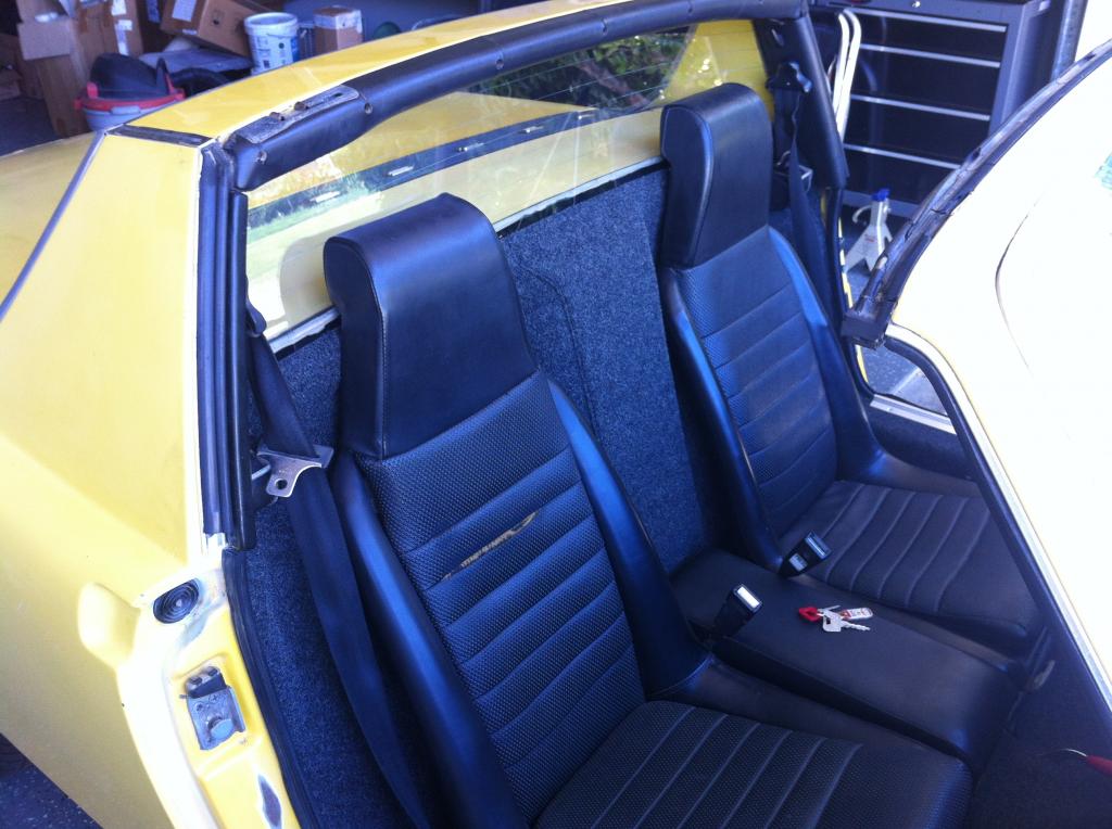

The carpet installation is like a puzzle. The piece behind the pedals, (pull the pedal board,) is first. Center tunnel and dead pedal next. Passenger foot board next, then the longs last. Take both seats and seat adjusters out, outside seat belt anchors, pull the e-brake, etc, just loose and out of the way. (This is a good time to clean and lube the e-brake center post) You should probably pull the back pad completely out too, but I left mine in. I'm doing Perlon behind the seats eventually. Take your time, I went pretty (too) fast. 3M #90 spray glue on both sides; car surfaces, and the backside of the carpet, (make sure, and double check it's the BACK side,) to ensure a good bond. I didn't cut out for the floor buttons, but I used heavy duty Velcro squares to keep the "floor mat" part of the carpet in place. Make sure you vacuum really well after the install, all kinds of stuff flies all over when you rustle things up in there! Good luck.

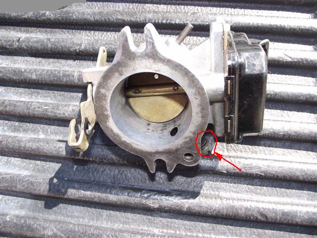

I can't see any screw that looks like an adjustment screw. The idle is at about 2K RPM and it only idles that high with the new airbox and the vacuum hose hooked up. What am I missing? Duh.
euro911
May 4 2014, 01:25 AM
Larmo63
May 4 2014, 12:21 PM
That screw is all but impossible to reach with the air box on and the air box is what makes it idle high. Any ideas?
euro911
May 4 2014, 02:11 PM
You just have to thread your arm and hand back down in there. It can be done unless you have arms like Popeye

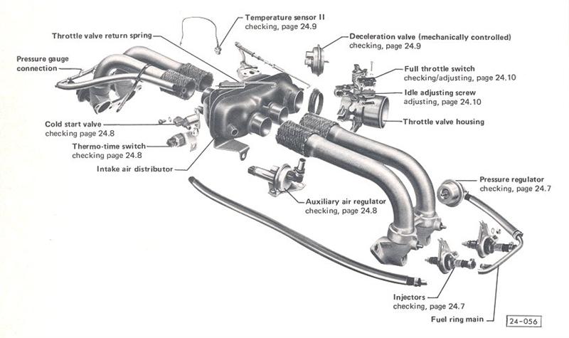

Idle at 2k is quite high even for the adjustment. Likely there is a vacuum leak somewhere.
Check the AAR valve (see it on the diagram on previous page). It lets air in when the engine is cold to keep the idle up and slowly closes as the engine warms. They are notorious for sticking open. Pull the hose from the air intake plenum and plug with your finger. It should drop the idle to 850 RPM.

That IS the hose I have plugged (for now) and the car idles right. Isn't it supposed to go into the top portion of the air cleaner/box? When I attach it there, the car runs much better, just idles too high. Even when warm.

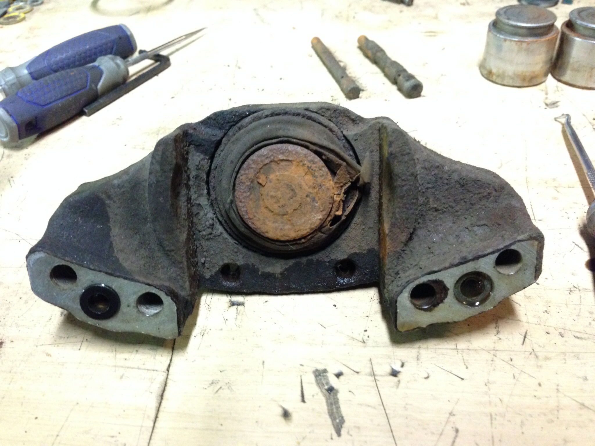

Did you get caliper rebuild kits and going to DIY?
Larmo63
May 6 2014, 11:40 PM
I'm talking to Eric about the calipers, etc....
Sounds like your AAR is stuck open. With it open, the engine will idle high all the time. You need to fix the AAR or get a new one. Make sure the AAR wire is connected.

Hi. Whatever you do, rebuild your calipers...The previous owner of my 914 bought new front calipers and rotors(I tried to install them for him) and the passenger side caliper would not fit(tried quite a few) Turned out that he had a driver's side spindle on the passenger side(would have never thunk it). Two years later he found a caliper and had to modify the body so it would fit over the rotor(mr. dremel) The rotors were too large(still have them don't know what they go to). While you are at it, REPLACE ALL BRAKE LINES AND HOSES. Took me 2 months to do this after the calipers rotors were installed. Running the steel lines thru that shift tunnel(got scarred knuckles for my trouble) is a mother.

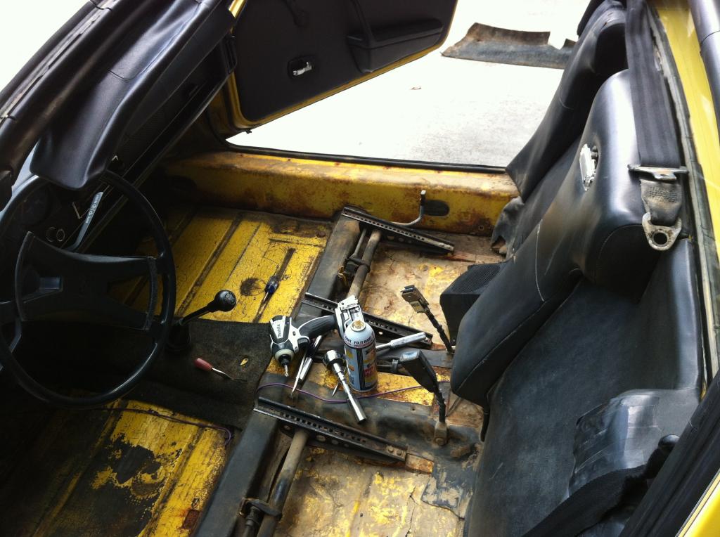

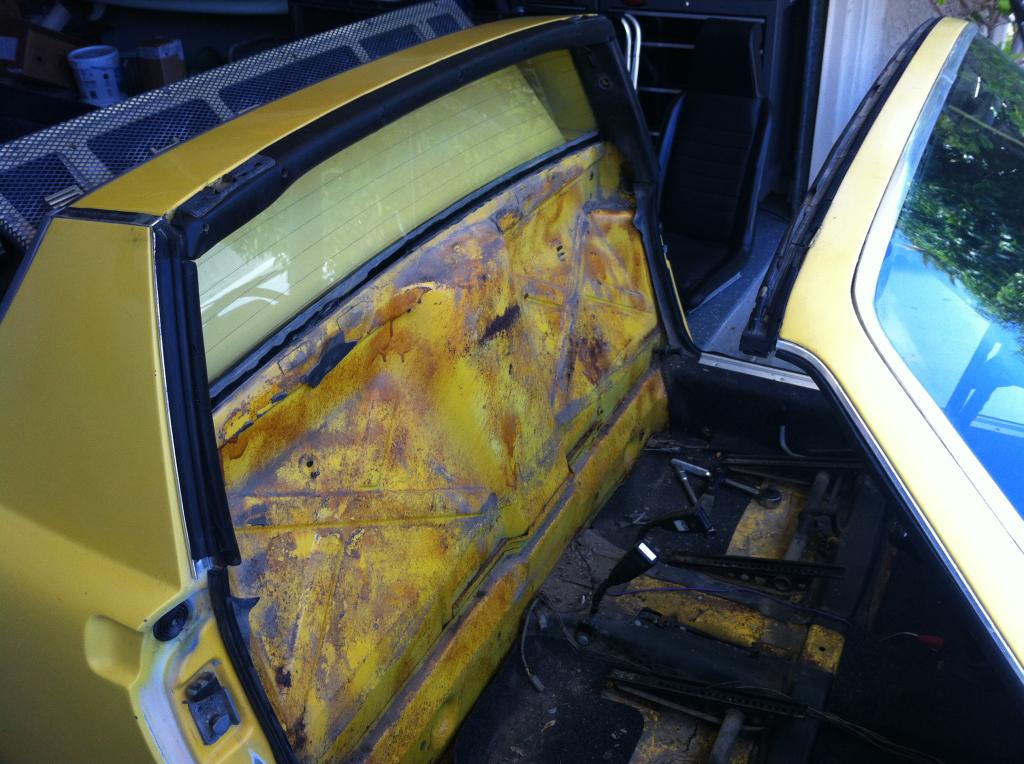

I decided that this car is not going to ever be a concours car or really original, so I'm thinking more GT style. I had a crappy back pad that should have come out when I did the carpet kit, but I was too chicken to go all the way at that point. I forgot too, that it's MY car. (And I can do whatever I want to it) Anyway, I've seen a few cars done with the Perlon on the firewall so I decided to do it today. (Carpet is an eBay item, Rennspeed) Here are some pics of the install:
Tear out old POS worn out, taped up, sun cracked back pad and rubber mat. These pieces weigh a ton.....
Scrape, clean, and vacuum...

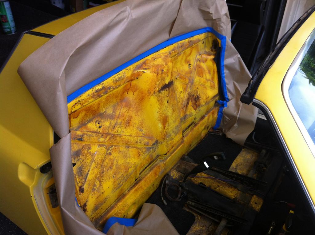

Mask areas that you don't want contact glue to get on...I use 3M #90 in a spray can for these installations.....

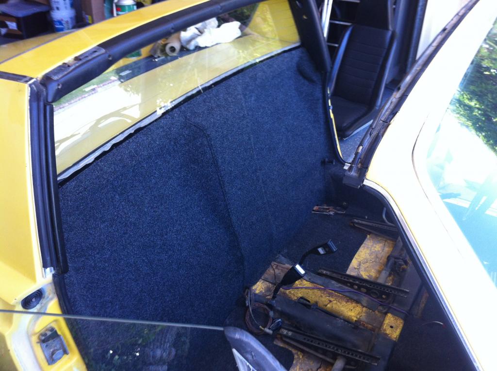

Next, when I have pre-fit it and made some marks to line up and mental notes on fitment, I start carefully with the spray glue, obviously on the middle hump to center it. I spray the firewall AND the carpet, and it adheres like a champ. I worked my way out to the door edges. TAKE YOUR TIME!!!! (I always work too fast, I need to go de-caf next install...geez....)
This is a good time to detail all the parts that have to come out such as seat belts, B pillars, etc...I just got a good used set of pillar covers from Bruce yesterday, and I detail everything as it goes back in the car. My seatbelts work WAY better after cleaning and PB Blasting, carefully. Final product:

Awesome. Looks like maybe you had to make a couple of cuts in the middle? ... or is the center portion another piece you cut and glued in afterward?
I tried fitting up some tan perlon carpet last year and couldn't get it to cooperate
... (I didn't cut anything though).
Larmo63
May 29 2014, 10:15 PM
Carpet came from Rennspeed in Duarte, Ca....eBay purchase.
It comes already sewn to fit the hump and the corners...........

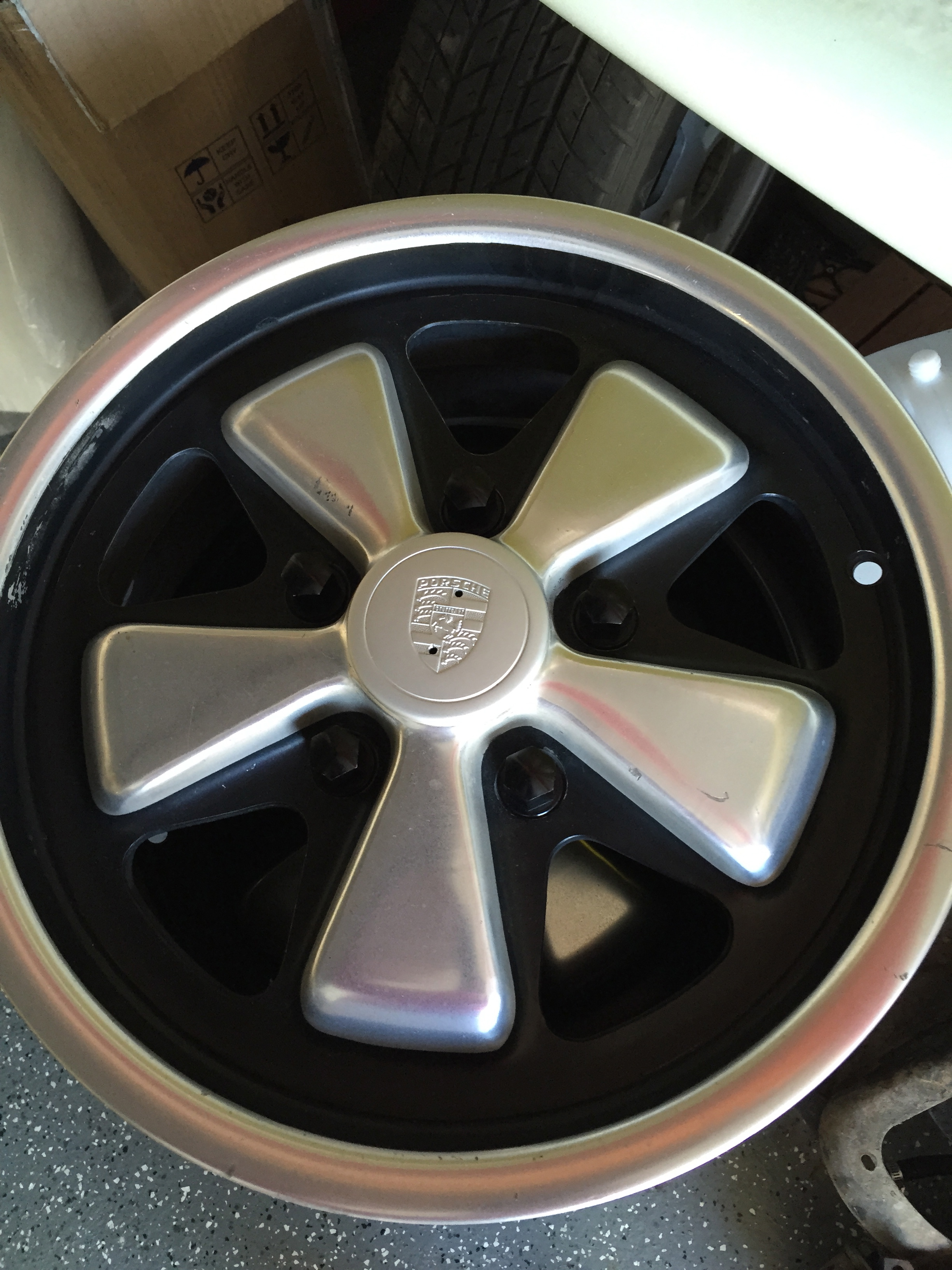

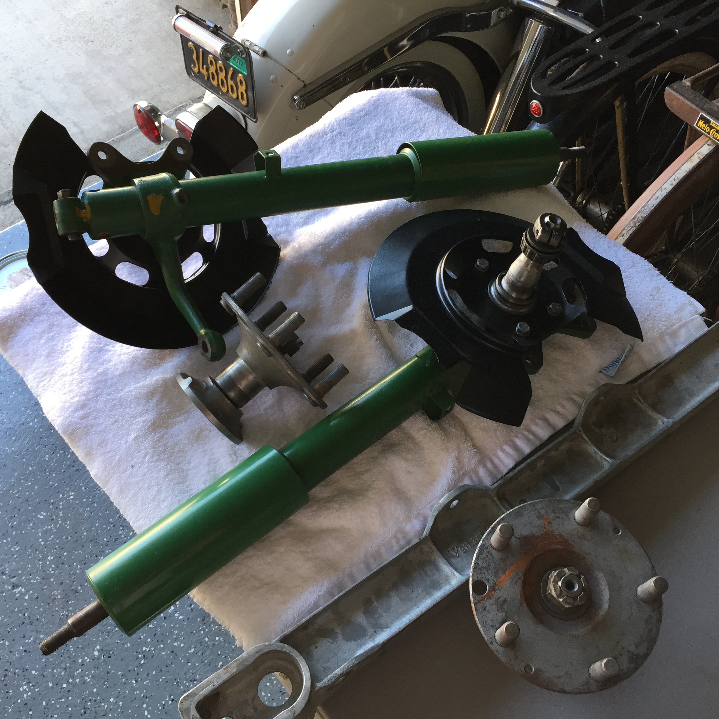

Yes, there has been a lot of buying going on. 6 x 15 Fuchs, 914-6 rear hubs/stubs, PC trailing arms, all front 911 suspension, 2056 engine built...
Click to view attachment Click to view attachment
