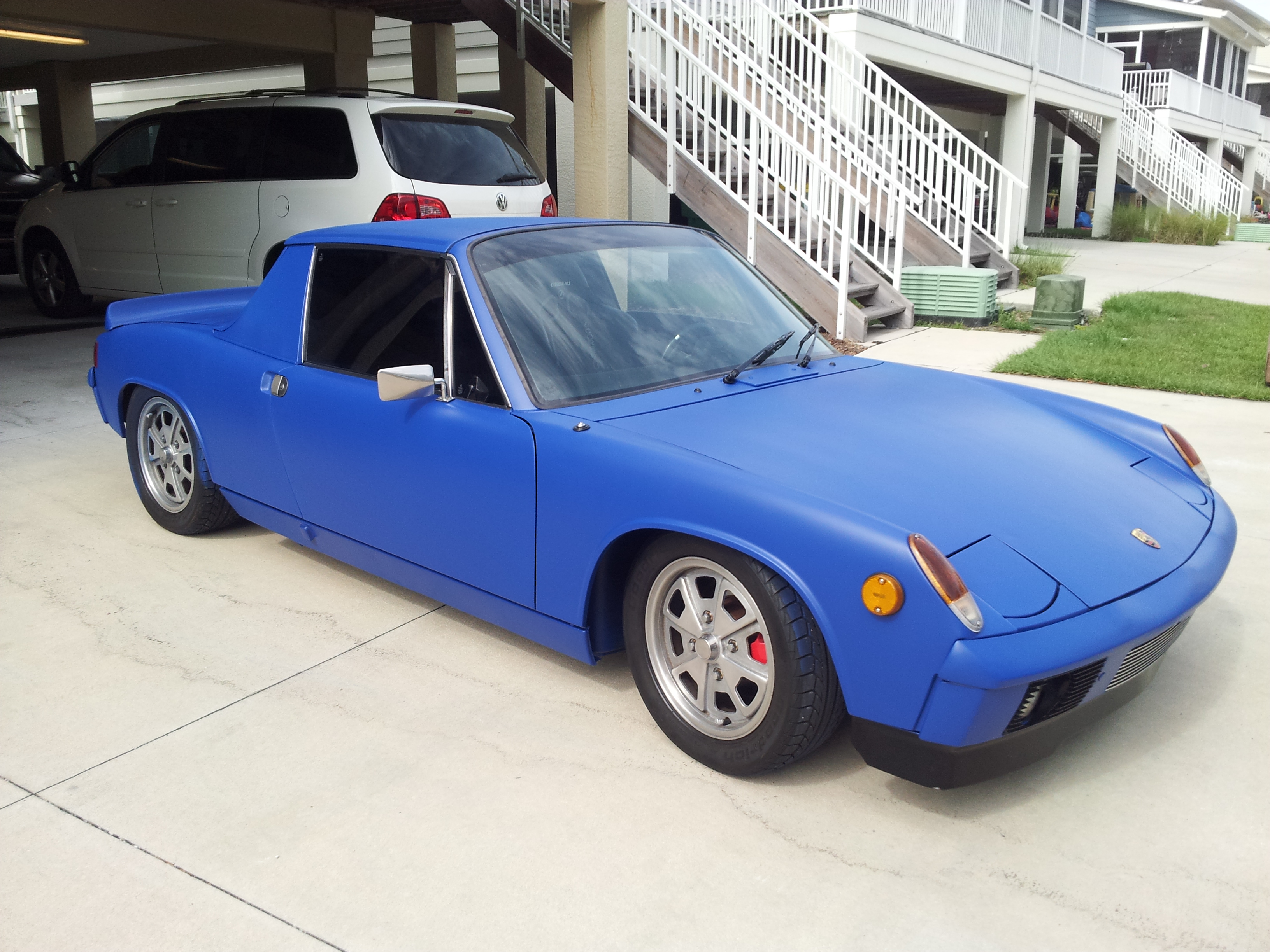

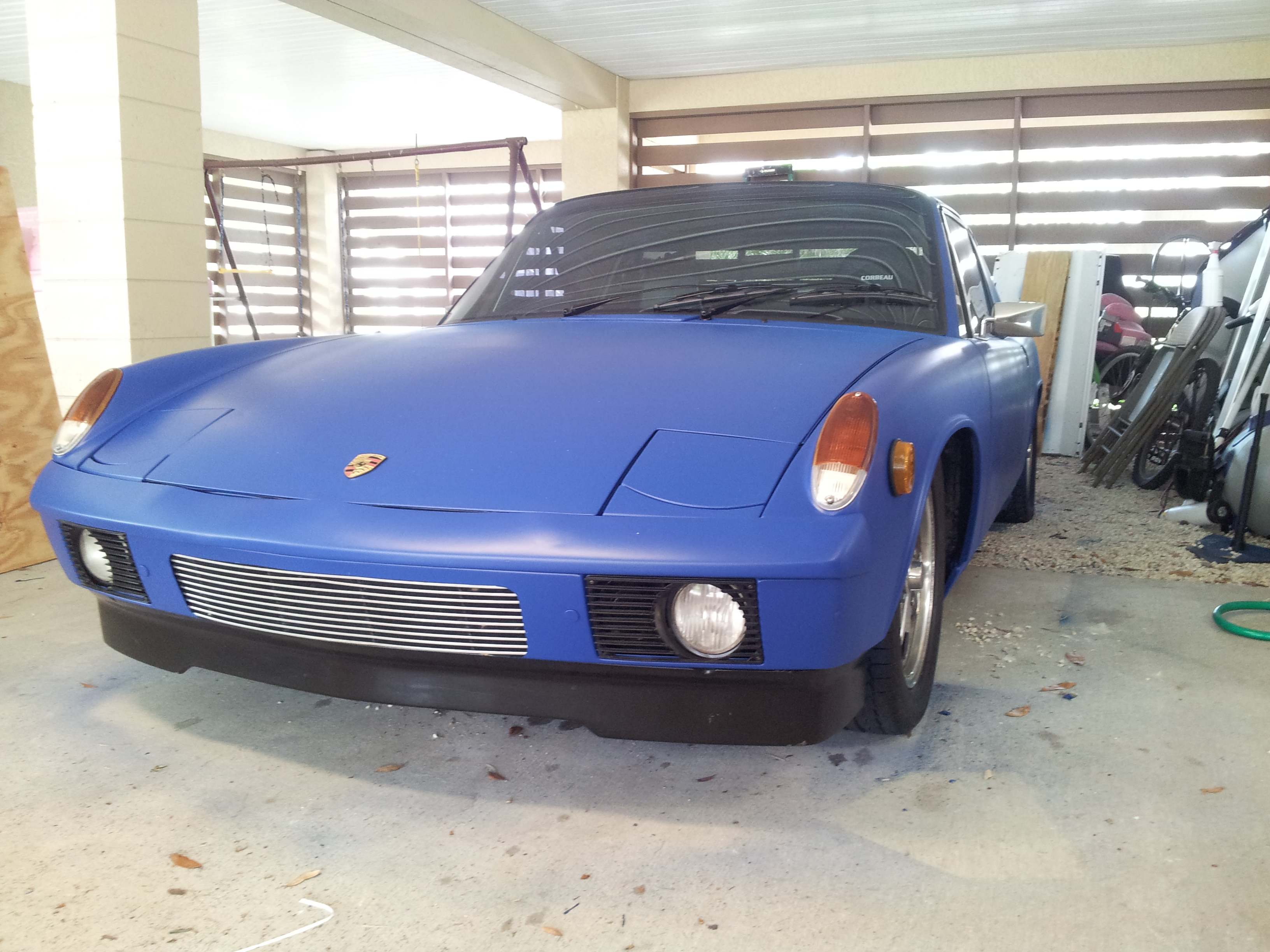

I just dipped mine last weekend. Flex Blue from dipyourcar.com turned out pretty good and was pretty easy to spray.

I bought three gallons and the sprayer, and ended up only using two gallons. I could have used more, but felt I had enough product on the car.

Most of the dips are $60/gallon sprayer was $150 I think. You can use a wagner sprayer from home depot, but I guess the wagner sprayer gets hot after prolonged use and will start making the plastidip spray out partially dry and give unwanted texture. So dip your car designed their own sprayer which stays cooler. At least that is what the guy told me when I stopped by their store in Coral Springs FL.

PUT 3-4 MORE COATS THAN YOU THINK YOU NEED! If it's too thin PlastiDip is a royal pain to remove. It comes off in 1" pieces. If you put 6-8 coats on, you can damn-near remove a whole car in one sheet. I did the hood on my land-rover in flat-black to cut the glare (which it did) but I did it too thin, so when I went to remove it, I gave up after an hour. Now it looks like shit.
CptTripps
May 15 2014, 11:28 AM
QUOTE(r_towle @ May 14 2014, 10:47 AM)
Stuff peals right off and it looks like there are a lot of artistic people trying all sorts of cool techniques with pearls and gloss and metal flakes.
Plus, you can change your mind every few years for a lot less money.
It DOES look cool
QUOTE(rdomeck @ May 14 2014, 07:18 AM)
...when/if you remove this stuff it will take half the paint off...
Not a chance. I've used in a lot on car doors, rims, and hoods. No paint loss at all., If anything, it pulled "deep down" dirt ourt of scratches and swirly. The best wax job my car ever had was after I pulled the Plasti-Dip off.
Lots of great examples here:
https://www.dipyourcar.com/examples.htmlHere's the color I'm doing my disco in:
click here.
