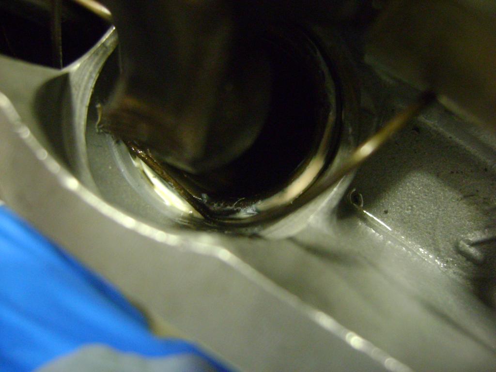

The slight pop you feel is the o-ring going over the raised lip you can see in the picture.
If you cant get the tube retainer springs in, then they are not in far enough.

Note: When installing the springs, there is a right way (pic I posted first), and a wrong way.
This is wrong:
IPB Image
Install them like this pic, then reach in there and grab that square end of the loop with a dental pick or allen wrench and pull out.
The spring will click over the puchrod tube.
(Do them all of course).

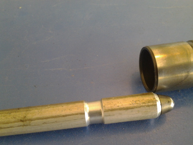

If you miss that step, next time the pushrods are removed they will look like this:
IPB Image
