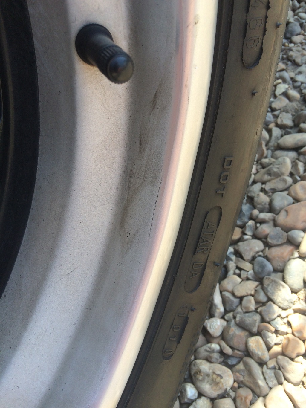

A word of caution buying used original Fuchs wheels. With todays tire technology and highly modified engines, original Fuchs forged wheels can be put under stress levels way beyond their original design specifications. Hairline cracks can and do form and, in some cases cause catastrophic failures. This usually occurs under race conditions rather than street driving. There are several articles relating to this subject. Make sure you know the history of usage (street or track) and inspect closely. Just because they're the real deal doesn't guarantee that they are road (or track) worthy. The metal does fatigue over time with hard track driving.
Dave
23e Heure
Dave's words are wise ones.
I just had a crack appear in one of my 15x8s:
IPB Image
And also found cracks in a pair of late 70s dated 15x7s that I had bought with a plan to refurb.
The simple fact is, buy a used pair of these wheels and they are 30 to 45 years old by now. Who knows what a life they led in the past? I guess you take your chances (as I have clearly done!)

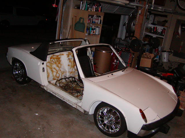

IPB Image
Better choices in wheels than when I did this 8 years ago.

The picture I used was the failure of a fake FUCH, not a real one. I've never seen a real one fail like that. As far as driving a 356, I drove mine all day Saturday.
First, it's FUCHS. The "S" is part of the name, not a way to make it plural. (It's German for "Fox", hence the fox-head logo. You wouldn't say a single fox was a fok, would you?)
Second, I've seen the real ones fail like that. One of them happened to a friend of mine, though the wheel in question had been (professionally) converted to a three-piece wheel. Cracked right between the lug holes, came apart, and damaged the car. He was thankful that it happened on the way to a DE and not at the DE.
I know of several more instances where real ones have failed in similar fashions, even without having been turned into three-piece wheels.
They're old, and it is very difficult to tell how hard they were used before you got them. You can Zyglow them for cracks, you can X-ray them, you can just decide the odds against it are really steep, or you can buy brand-new wheels.
For my car, at least so far, I'm choosing to ignore the problem and use my old wheels.

I'm sure some real FUCHS have cracked like that, but the repro I showed was fairly new if my info was correct, so it should not have cracked like a decades old wheel, it's like the new flywheels from China that hand grenade quickly. Repro stuff is fine for cosmetic stuff, but I never trust it with hard components, not if the real stuff is available.

New or Old Wheels can crack! Stresses from Track Use & Grippier Rubber put forces on wheels that they sometimes can't overcome. Remember the Fuchs that were on our cars were never intended for slicks or downforce.
The Picture from unobtainable can happen to Real or Fakes, but most I have seen are Fakes. This is because the "Casted" area around the Lugs is not Thick enough or Strong enough! Many Multiples of Impact Guns can worsen that area.
If I'm tracking a Car, I have more faith in an INSPECTED 40 year Forged Wheel than I would have on a New or Used replica Cast Wheel!
