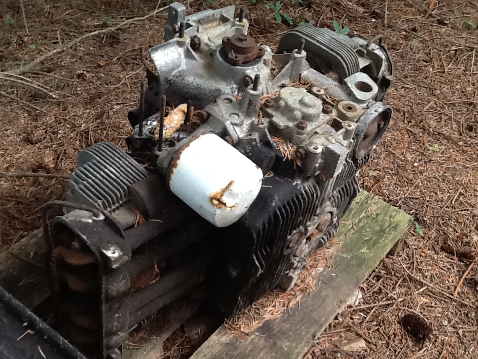

This engine is for my Michigan Build, 2016 Build-Off Challenge. Needed to come to the "Garage" for some help.
Fresh rebuilt on start up, my first oil filter inflated, then leaked at the seal. Second try, filter massive leak blew the seal out. I have a flow probem. Looking for help. I must be building pressure, just won't leave the filter.
Garland
Filter off
Mark Henry
First thought is you have a seized oil control piston.
That much pressure you may have also blown out the cooler seals.
Did you modify the oil control? heavy spring? do you have the correct piston, not one out of a T1?
At any rate you have to remove the oil control piston and make sure it's moving smoothly.
I've also seen cheap FLAPS filters do that.

Can't get the slotted cover to move, any tricks?
Here is a file photo, not my engine.
Mark Henry
Big screwdriver, hold it at an angle and to one side of the slot so it will go CCW and then hit it with a hammer.
rgalla9146
I'd go with a hand impact.
About a $20 tool at Sears , get the right bit too.
One hit with a hammer...done.
Use to reinstall too.

Garland
It's moving, 1/4 turn so far. I had to cut two, more slots and hit away. Done this procedure before, just this thing did not want to move, and the softness of the brass didn't , and did help.

Mark Henry
I expect that from an engine that was used for a boat anchor.
Surprised that it's still not turning easy, once you crack it the first bit it usually turns right out. blink.gif

Garland
Me to, here it is!
Used a home made slide hammer, after taping the piston. Washed out and Cleaned up the passage , and going to replace the piston, spring and cap.

Mark, I have a boat anchor motor, been sitting just as you see it behind the barn for 10 years. Pulled from a rusted out car, when pulled the intakes were off and valves rusted.
So down to the barn, 2 hits, spin it out by hand, and need to pull the piston. 3 minutes!

Garland
It is a,
1.7 balanced, 260 x 396 cam .006
96mm B/B kit. Looks like the heads were cleaned up, There also 1.7
I took a closer look and can't find any other "crap" in the engine. Strainer is clean. Oil changed after lots of rotations, looks clean. I parley cleaned up the surface of the block were the plug goes, but no real damage. Fished around with the bore scope, and things look ok.
The plug had no markings at all when I started. I don't think it was removed when the rebuild was done. This may be why it was so hard to remove, and all the crud only there?? If the case was washed, with the plug left in?
With piston still in.
Piston removed, before cleanup, notice the shine at the top of the bore.
After cleanup, piston surface looks ok,
This is what I have added to the block, over the last 10 years.
Mallory unlimited distributor, Ordered from Jake.
Weber 40 DCNF air jet 1.80, main 1.25 rebuilt, and set up, true old carb guy.
2.0 SS exchangers
2.0 Triad exhaust
I've started it 3 times, each time for 5 seconds. Twice with out oil flow, except from the filter gasket!
So, I think I'm ok to start the breakin, break-in!

Garland
Everything buttoned up and ran for 30 minutes at around 2000 rpm. All good. No leaks, and sounding strong. Doing an oil change, and carb adjust I'll be ready to install in the "build " car. Here the link to Michigan Build / Build-Off Challenge 2015/16
