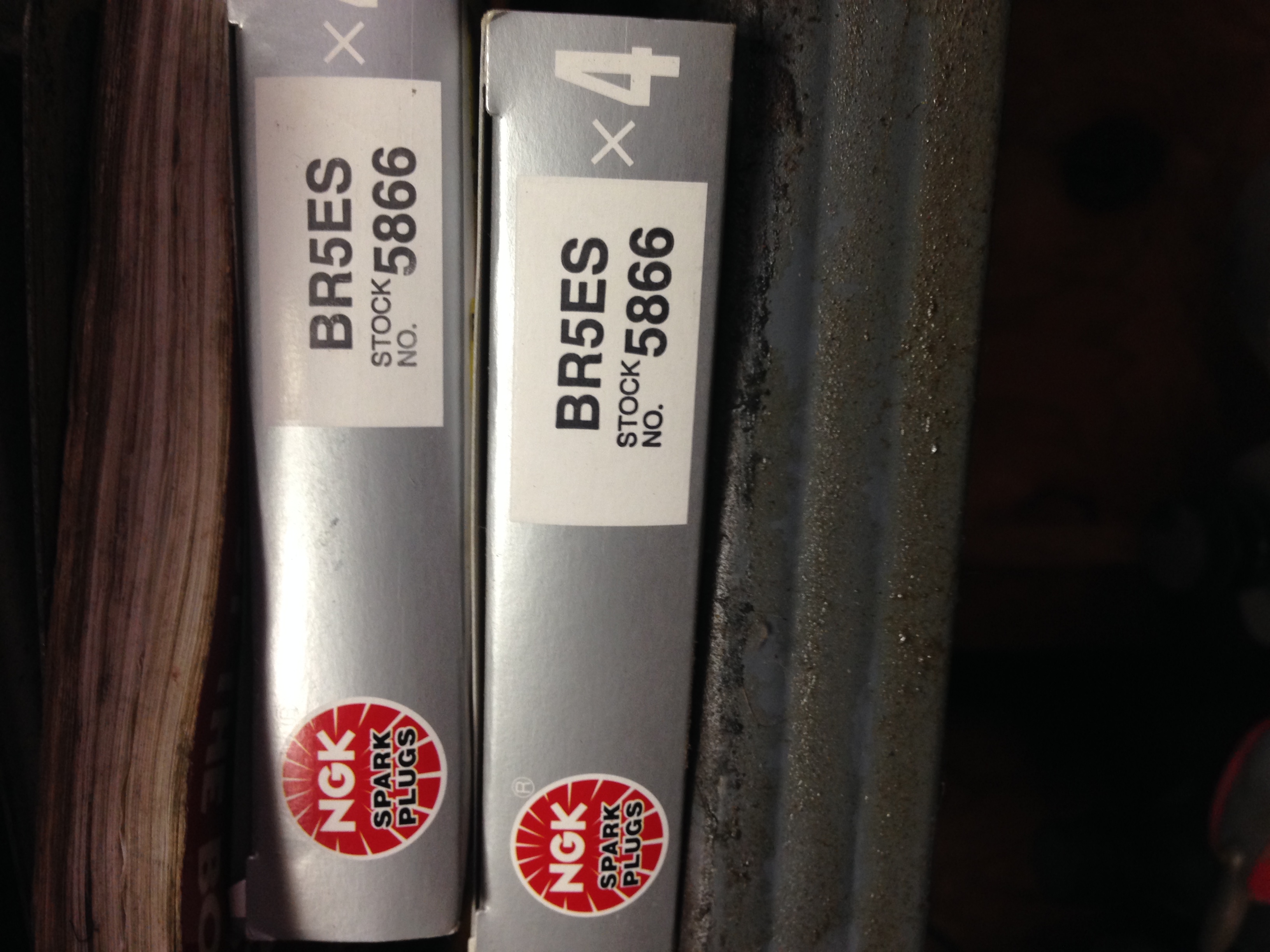

I'm going to throw this out there. I just had almost the exact thing happen to me. Ran good. Then bad and fouled plugs. Ended up being the points or condenser. Changed both so unsure. I suspect the condenser which oddly enough was new. (Empi crap). As far as the compression. I only have 90psi on all four of my tired cylinders and I do not blow smoke.
Localboy808
Sep 21 2016, 02:19 PM
Also I've found in the past that once plugs foul? I can never get them to run right no matter how much I clean them.
andreic
Sep 21 2016, 03:27 PM
I am not ruling anything out yet, but I have a very strong spark on all 4 spark plugs, so I don't think somehow that the problem is with the points, condenser, or the plugs themselves. After I isolate the main problem I may try to improve on these items too, but I don't believe this to be the problem.

Sep 21 2016, 08:52 PM
Also, I run these plugs in my 914. They run a tad hotter.
