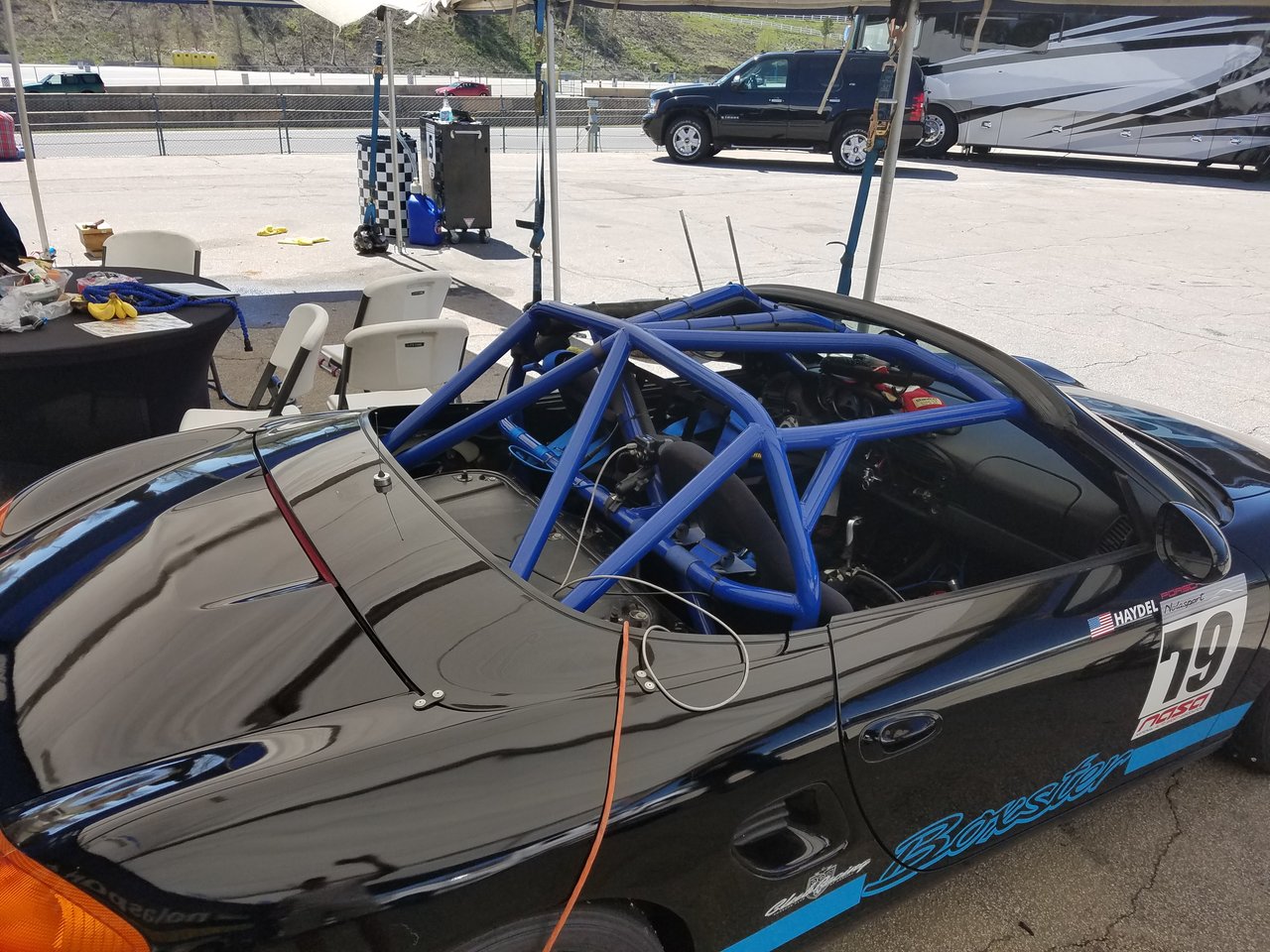

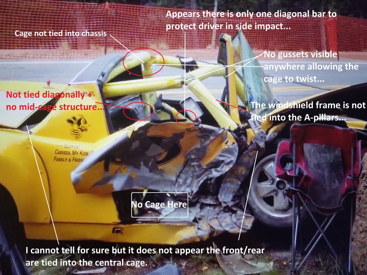

Where do I start? Look at the basic observations...
By comparison sake - I have also attached a picture of a Boxster Spec racer at this Springs PCA Club Race at Road Atlanta. This car is stupid slow and yet super safe (and not potentially flying off cliffs into bolders!) - see the deficiencies now?

Under-Kill
Over-Kill

If you play in slo-mo:
1] at 2 second mark you can see the driver's side of suspension is really loaded and passenger side is way to high.....as if there's no sway bars? idea.gif
2] Easy to see cage is NOT tied to rear tub/suspension chair.gif
3] Easy to see big counter steering effort [which means he probably "lifted" off the throttle] headbang.gif

As far as the crapiness of the cage, I appreciate the expert advice and completely agree with a 2017 brain trust. Likely the cage was pre-2000 by a hobbist, so results may vary. I've seen way crappier. The guy is lucky how it all played out.

As for the cage? Dude hit a rock at XX MPH and got out. If I were him, I'd be singing the praises of my safety equipment for the rest of what's left of my life. blink.gif
That crash likely would have been survivable even without a cage.
The car , in effect, did a right side IIHS "small overlap " ( RE near side swipe ) crash test where there isn't much structure to absorb impact. Remember, any metal that folds outside the passenger compartment is desirable when riding down a crash. Had this taken a hit on the left, the cage would have helped the situation by keeping that side of the passenger compartment intact.
One of the faults I see with the cage install is not adequately tying the main roll bar into the rear window structure ( Upper seat belt mounting point is an easy attaching point ). This allowed the right side of the main hoop to push rearward. Rear facing tubes to the rear shock towers would be the standard way to make a roll cage and much better.
Also, the RF wheel well / rocker / floor crumpled and folded the RF down tube rearward. When caging unit body cars for circle track applications, laying 2" x 3" square tube just inboard of the rockers ( 2" facing up ) then welding the cage to that is standard procedure. If the down legs of a roll cage are not tied together left / right and front rear, they will fold as the floor crumples.
Given the 914 front wheel wells intrude into the foot box, I'd be putting some structure there to protect the drivers feet.
Lastly, this crash was more of a grinding scrape than a solid impact, if the car was a foot more to the right, it would have been much worse.

The cage worked....he walked...I can't imagine an advantage of having it tied to the suspension , from a safety factor...I remember at about 2:30 in the morning during the 24 , a Porsche courage from France went completely airborne and multi.. rolls ....parts ended up in the grandstands....all that was left was a breakway driver safety cell of sorts...nothing else of any substance attached to it....driver walked , albeit wobbly
DM_2000
The cage did nothing to protect the drivers side passenger compartment because the impact was not on that side. If there was someone on the passenger side, would they have walked away?
There are some unknowns, but based on the pics, it looks like they took "roll cage" literally and neglected side / frontal impact protection.
On the passenger side, if the shoulder belts were attached to the cage, the belts would have crushed the passenger against the seat as the cage moved rearward relative to the stock floor. The lap belts were likely attached to stock locations, if the right rocker moved rearward relative to the floor the lap belt would have tightened as well
When caging a car for something like this, it is critical for the passenger compartment to be a tube chassis built inside a stock bodied car. This includes belt and seat mountings being part of the cage not on the stock floor.
As for attaching to suspension points in a unit body car, this is a stronger part of the car than a floor or rocker.
ablesnead
have to disagree on that one ...cars have to fit class rules cages are usually specified as to mounting points..often to suspension is not allowed...you could be right about a hypothetical passenger...but you could be wrong also...only a guess after all...In many classes cages provide rollover protection only unit body crush zones provide the rest, especially front to back....hence roll cage .
