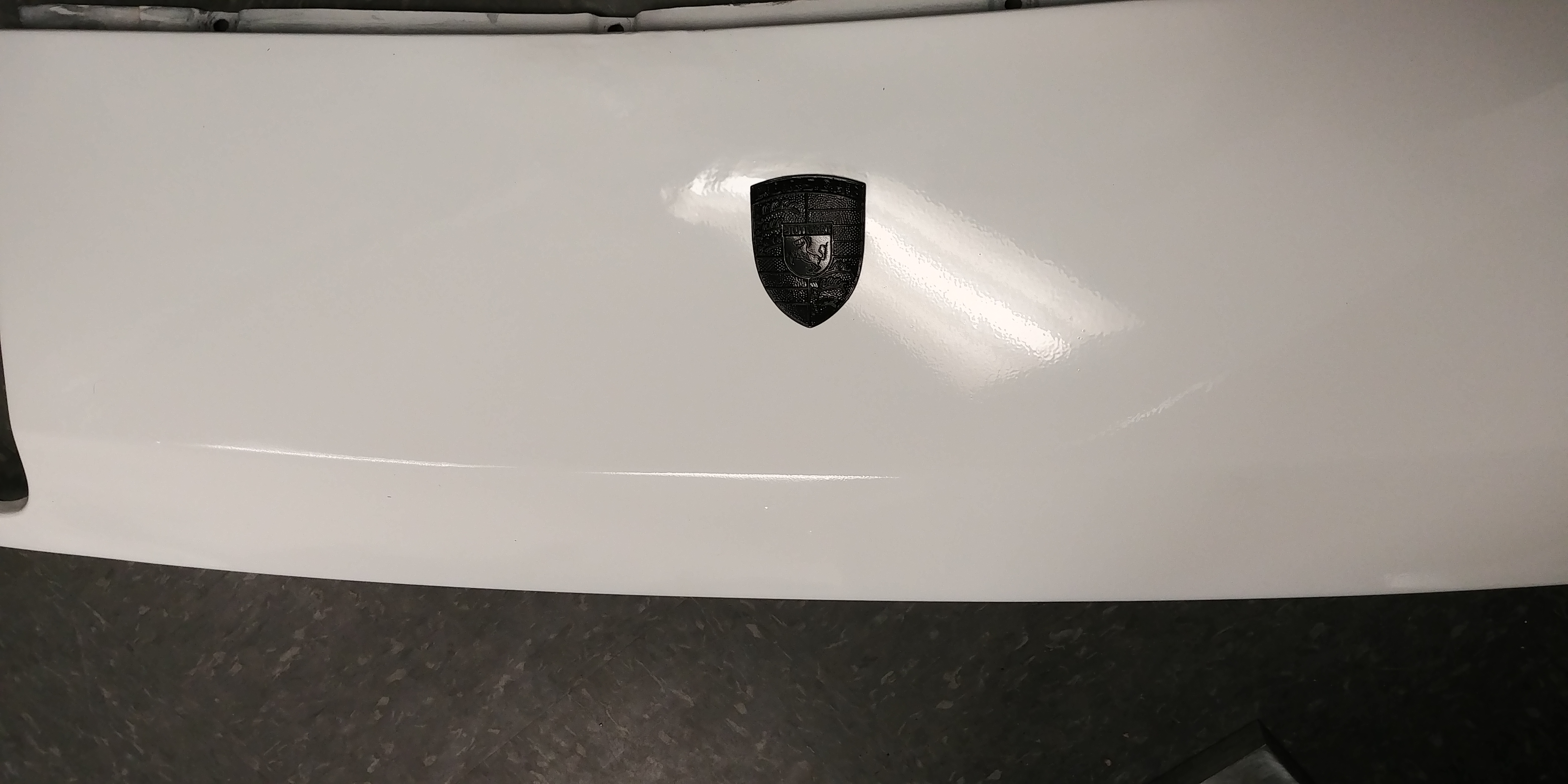

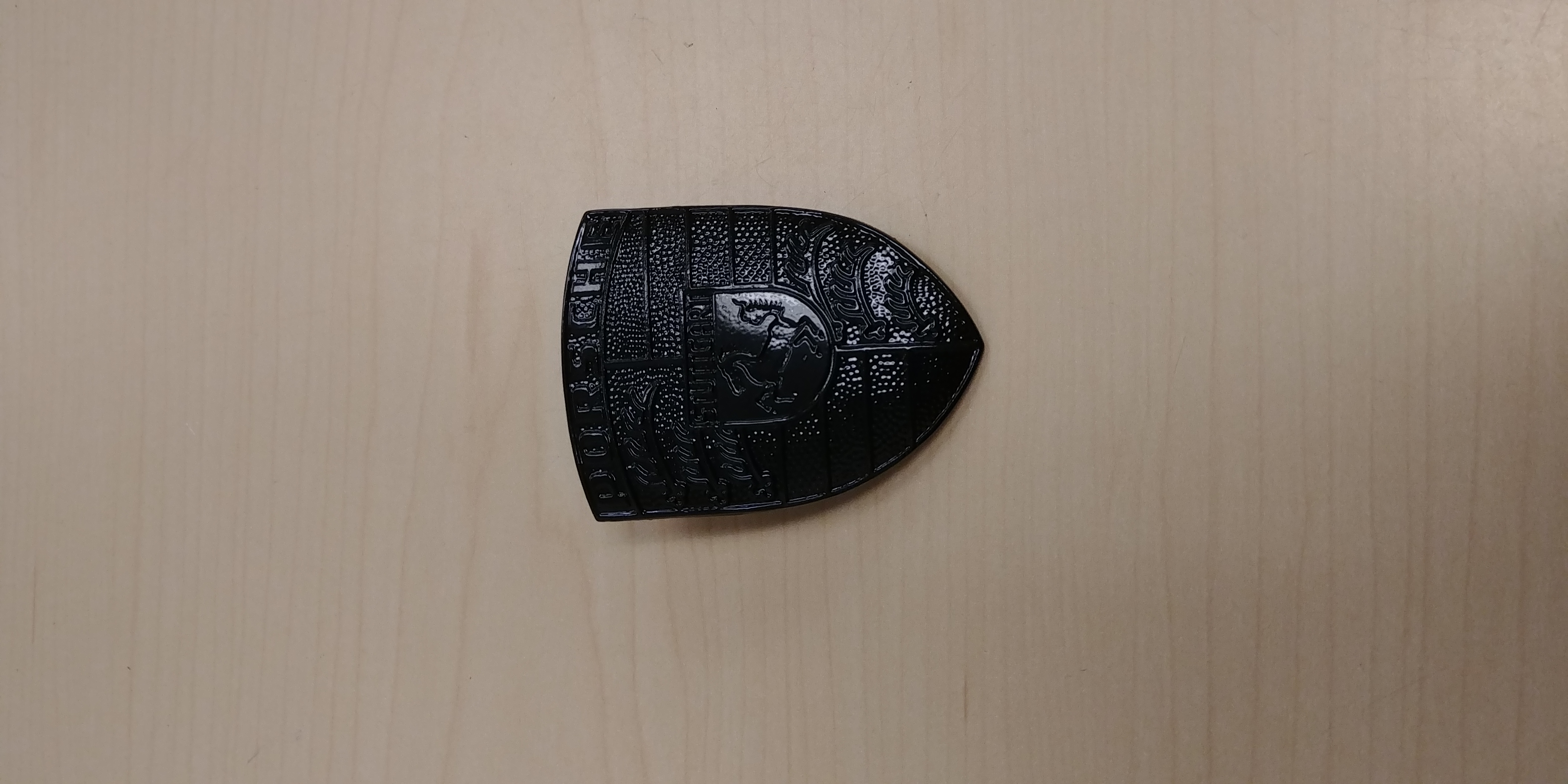

Did a little powdercoat for my son. The badge was junk so didn't hurt a good one. Click to view attachment

Powdercoat this as well.. Inspirational I hope for him
JmuRiz
Mar 20 2018, 12:08 PM
I like that black badge, pretty cool...kind of GTS-like with their blacked out trim.

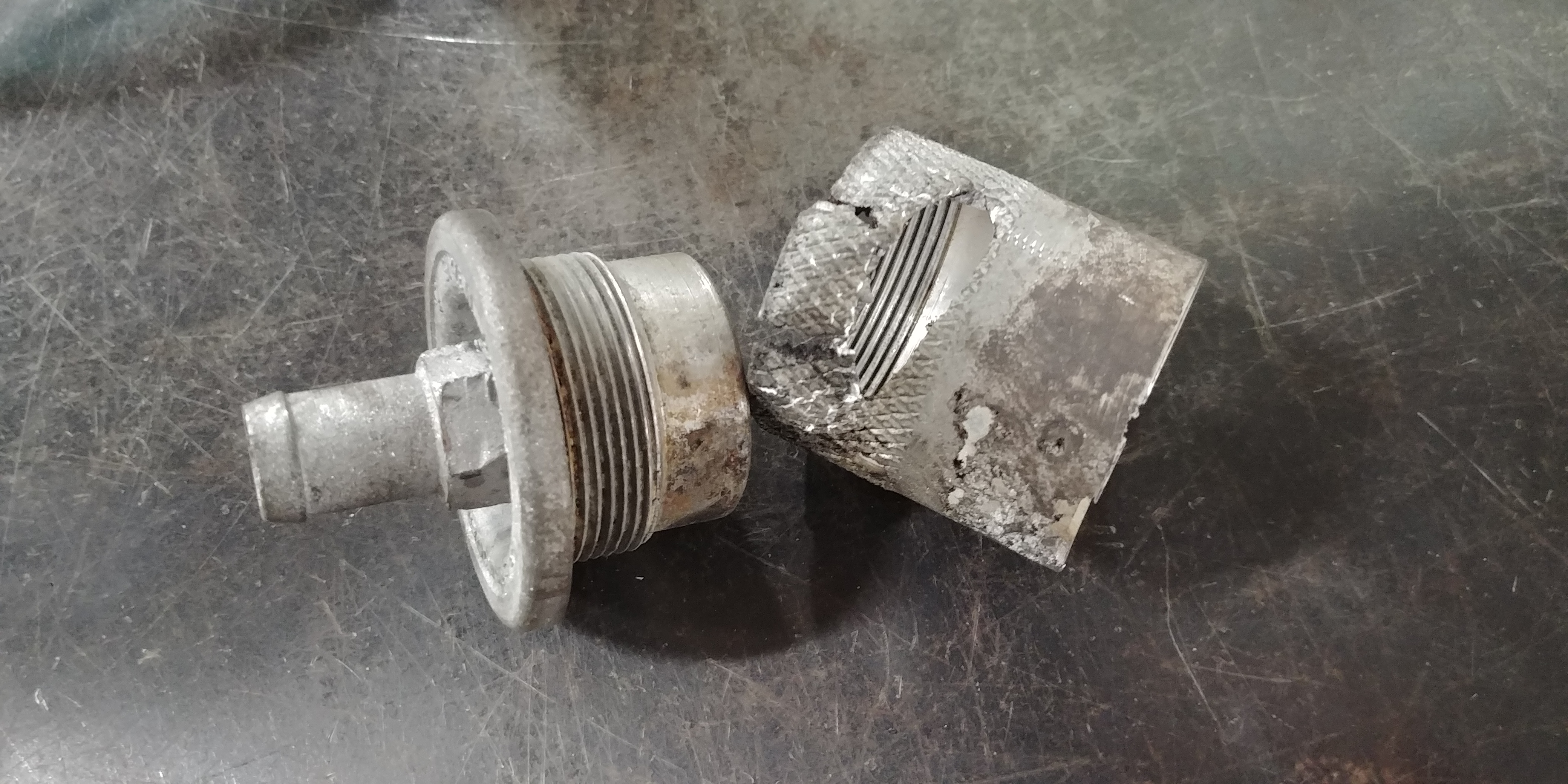

Unfortunately now a bit larger of a problem the ferrul that gets glued into the tank is trashed any ideas without replacing the whole tank?Click to view attachment
jd74914
Mar 21 2018, 10:30 AM
Not sure exactly what I'm looking at, but can you turn a threaded retainer with a wide bond surface and glue it to the tank exterior?
mb911
Mar 21 2018, 11:41 AM
QUOTE(jd74914 @ Mar 21 2018, 08:30 AM)
That may work the part to the right is /was bonded to the inside of the tank. May plans are to have a new part made if I can and glue it to the inside of the tank.. Or find someone whom has that fitting. At this point all options are on the table

You might ask over on the Bird 944 forum. Lots of good info and smart folks. Not as active as World, but you'll get a response. Good luck. Jesse

'88 definitely has the plastic tank (all '85.5 and later). They are not crazy expensive, and not too hard to replace IIRC, especially if the trans is already out.
Take the trans out with the cross member attached - much easier. Good time to replace the center trans hanger, too.. which part I also have. (I haven't forgotten about the speed & ref sensors).
By the way, those fuel tanks are huge for such a small car.. they hold like 22 gals.
