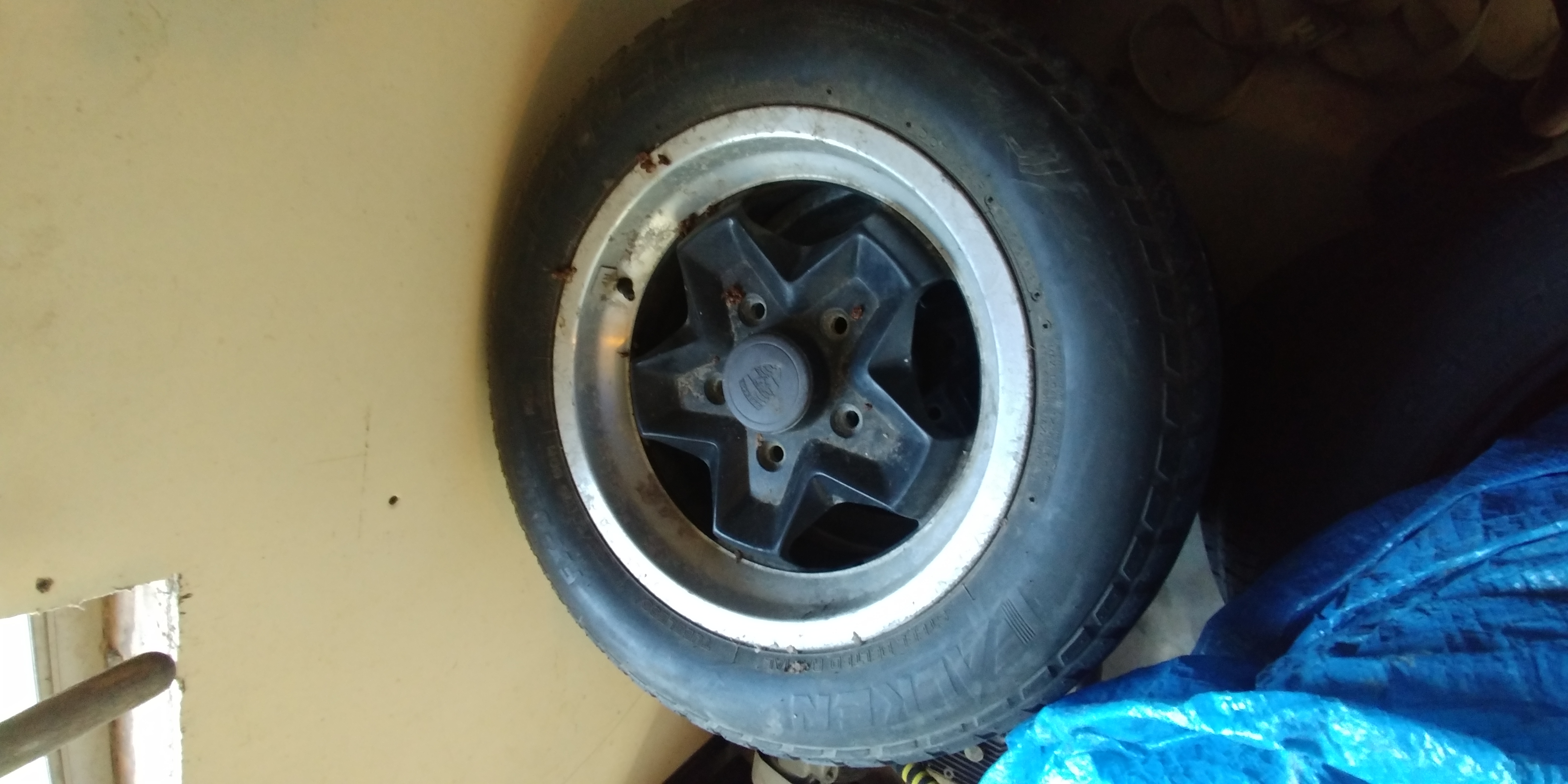

New reference, speed sensors, starter, brake pads, fuel hoses, and a score on an extra set of wheels though we still need 4 tires that actually hold air..
We took it for a short drive down the driveway.. Everything works. So 10 years of sitting it is now alive. Still need to change plugs and wires and bleed the entire brake system and timing belt..
Ps bought the ats cookie cutters for $100 which I couldn't pass up. Both my son and I are excited.. I really do appreciate the build quality of the 944.. Click to view attachment

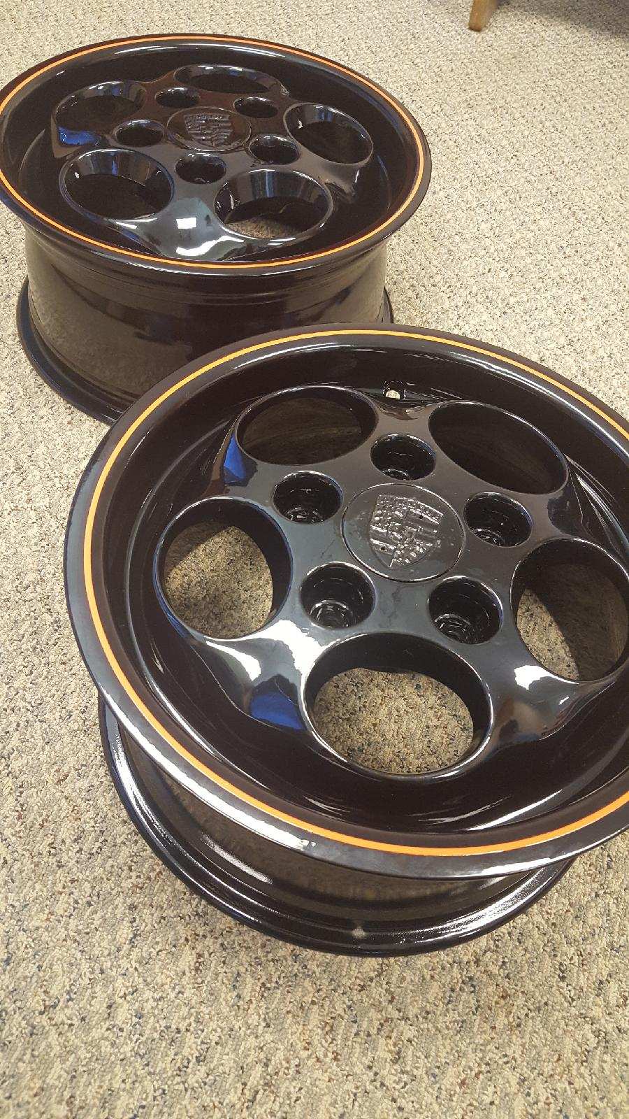

Sand blasted 2 of the wheels this week to prep for powdercoat. We are going to paint the wheels that came with the car black and see how they look..
He wants to be able to drive the car to school this year as a senior..

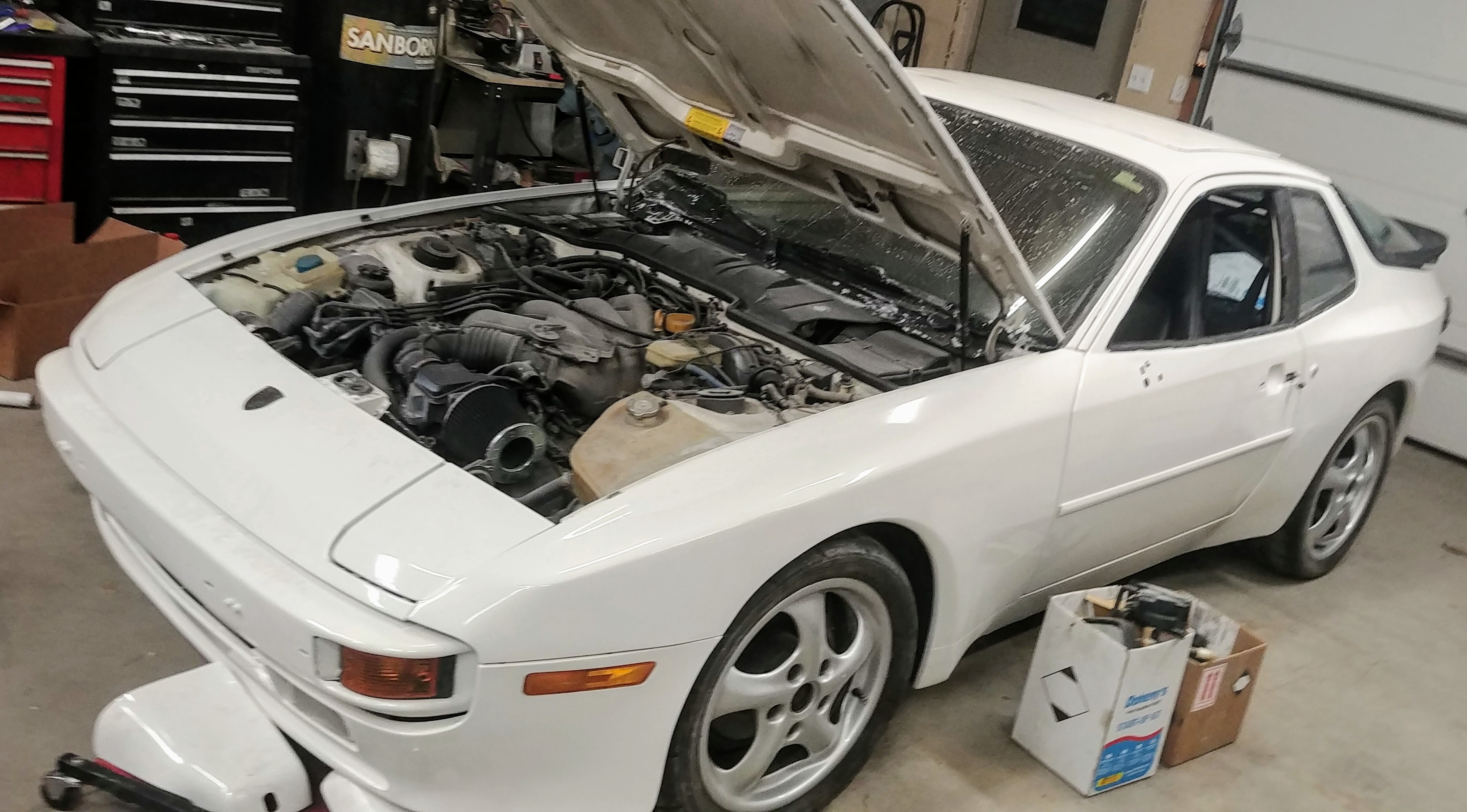

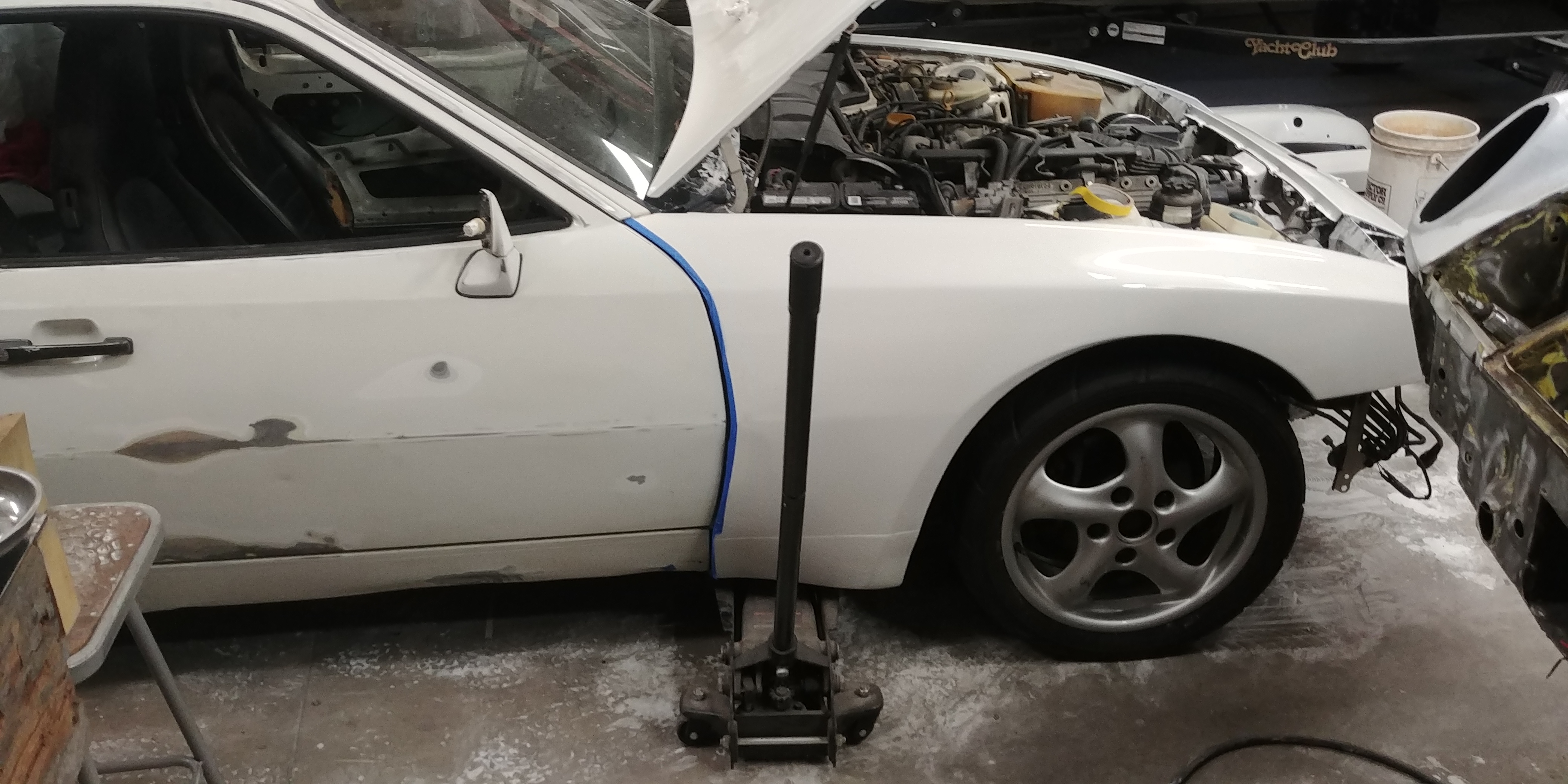

mb911
Wheels done well 2 of them. Working on timing belt now.. Click to view attachment

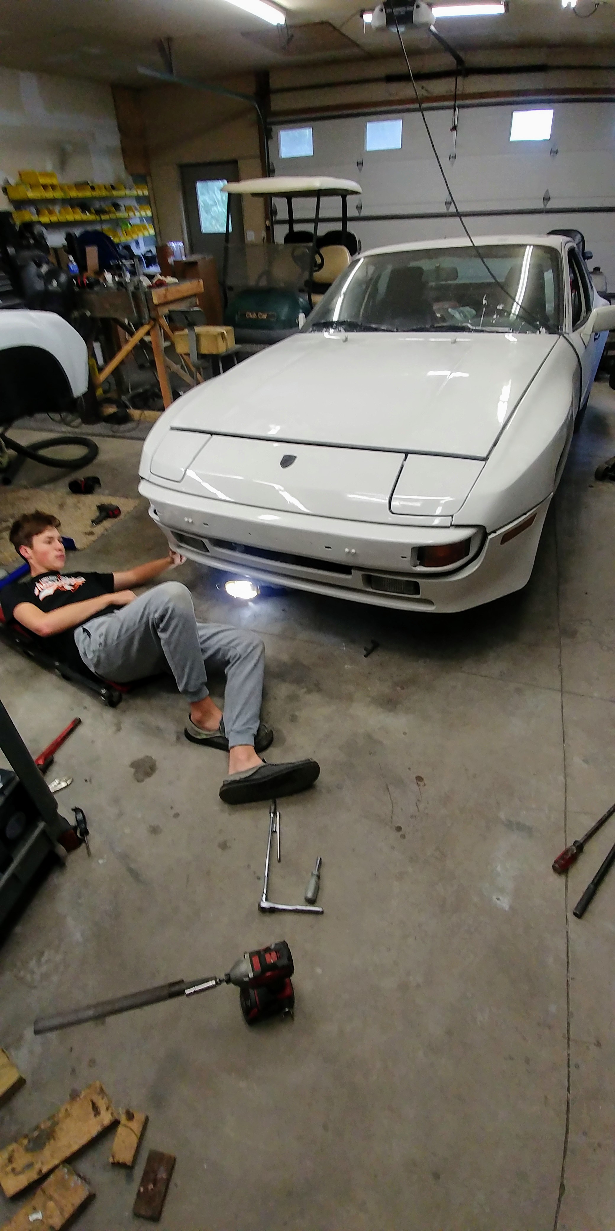

Working on multiple cars today.. I am tired and sore.. Allot done though.Click to view attachment

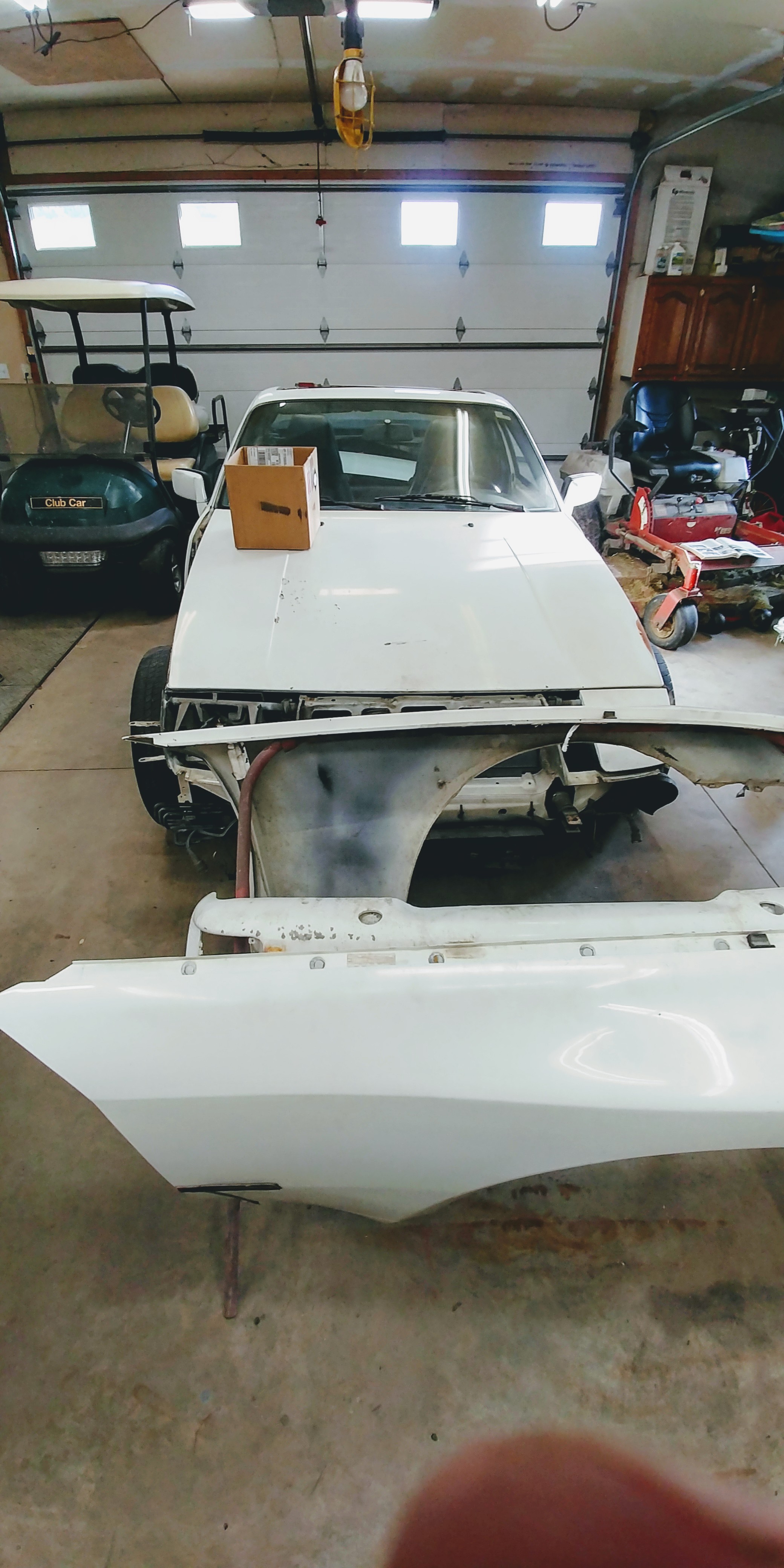

mb911

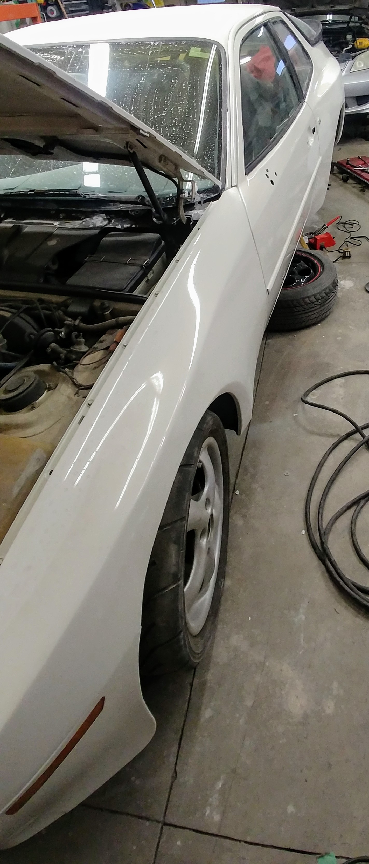

Went to baseball with our younger son and came home to this today.. Guess he is taking apart for paint. biggrin.gif Click to view attachment
mb911

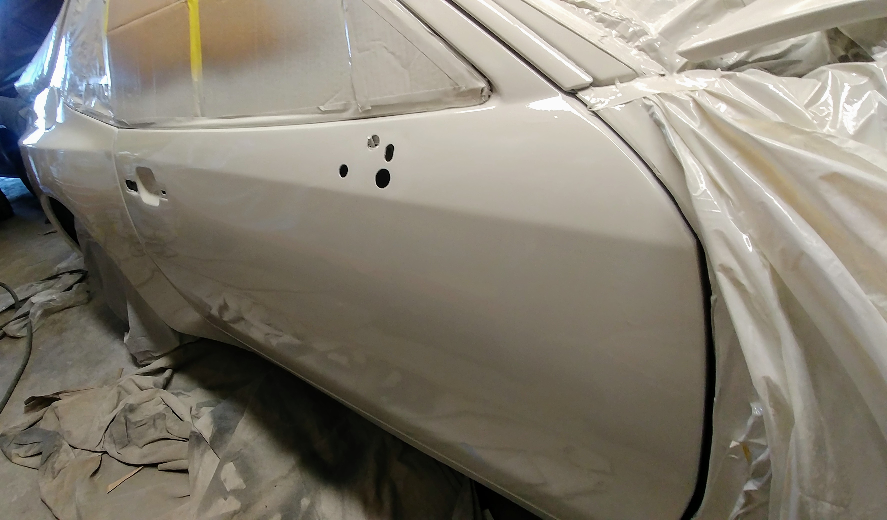

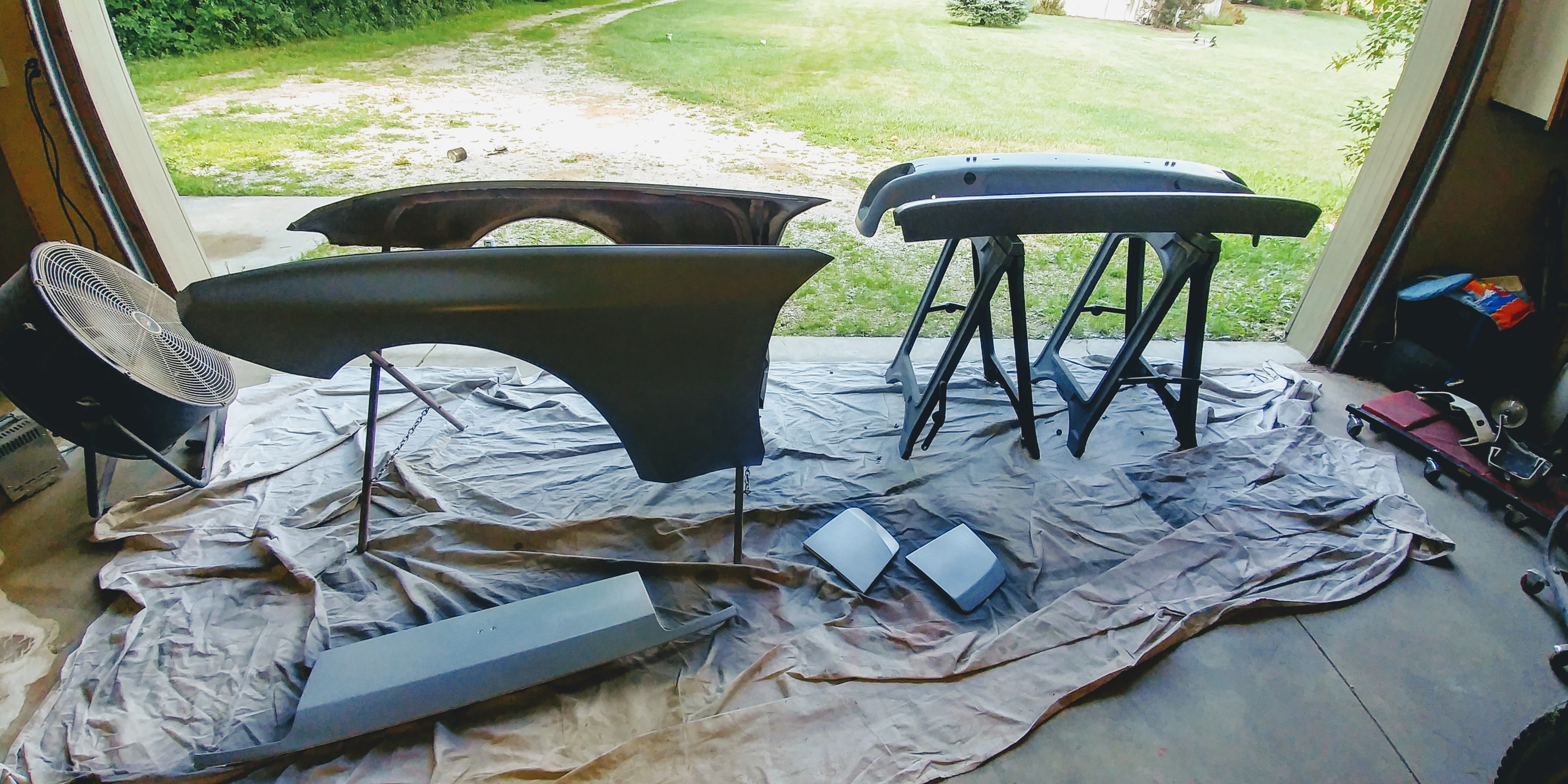

He sanded everything and I showed him today how to prime.. We sprayed some epoxy primer and then I showed him how his sanding impacted the finish.. We will do body work and get these parts ready for paint 1st.. Click to view attachment
mb911
Painted today.. Turned out pretty nice.. Did it outside which is not the norm but didn't want overspray on everything as the 914 is in my "spray booth"Click to view attachment

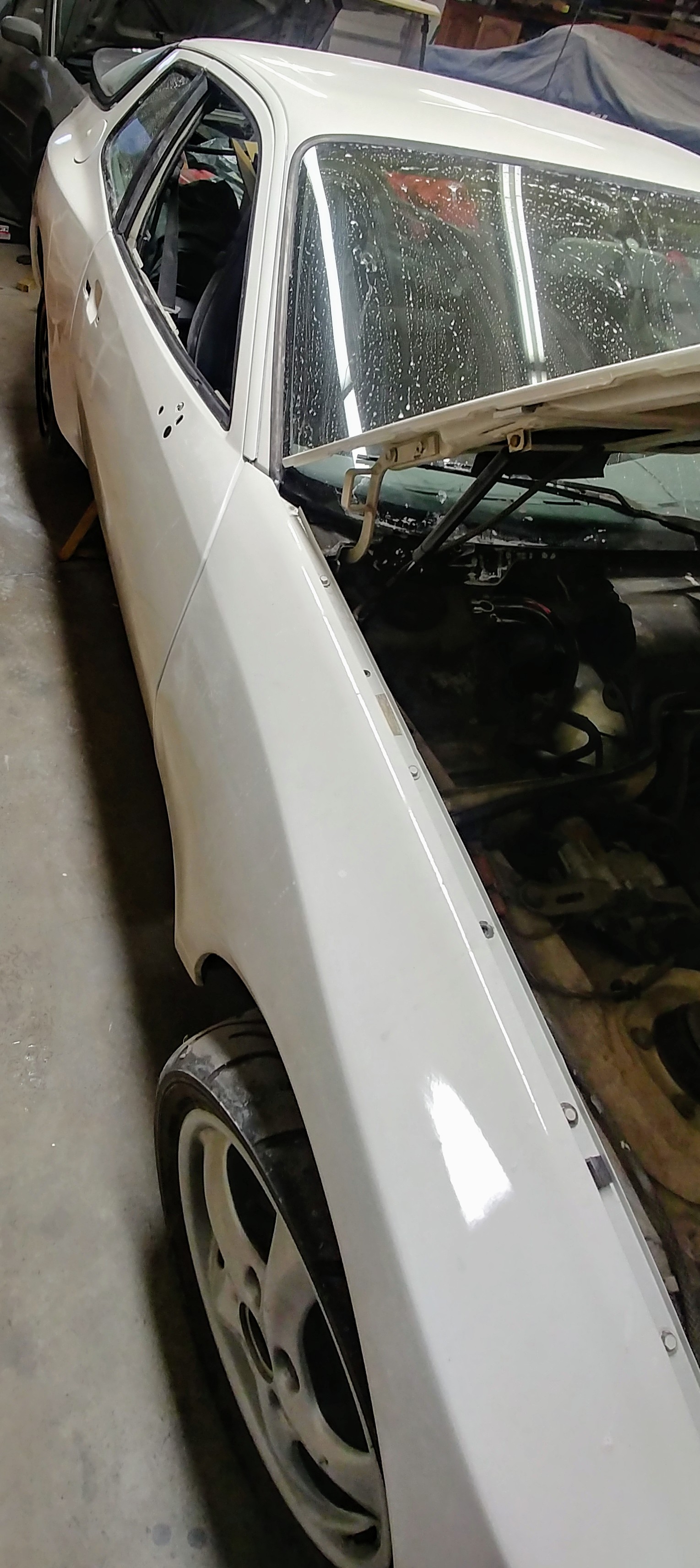

Front half is paintedClick to view attachment

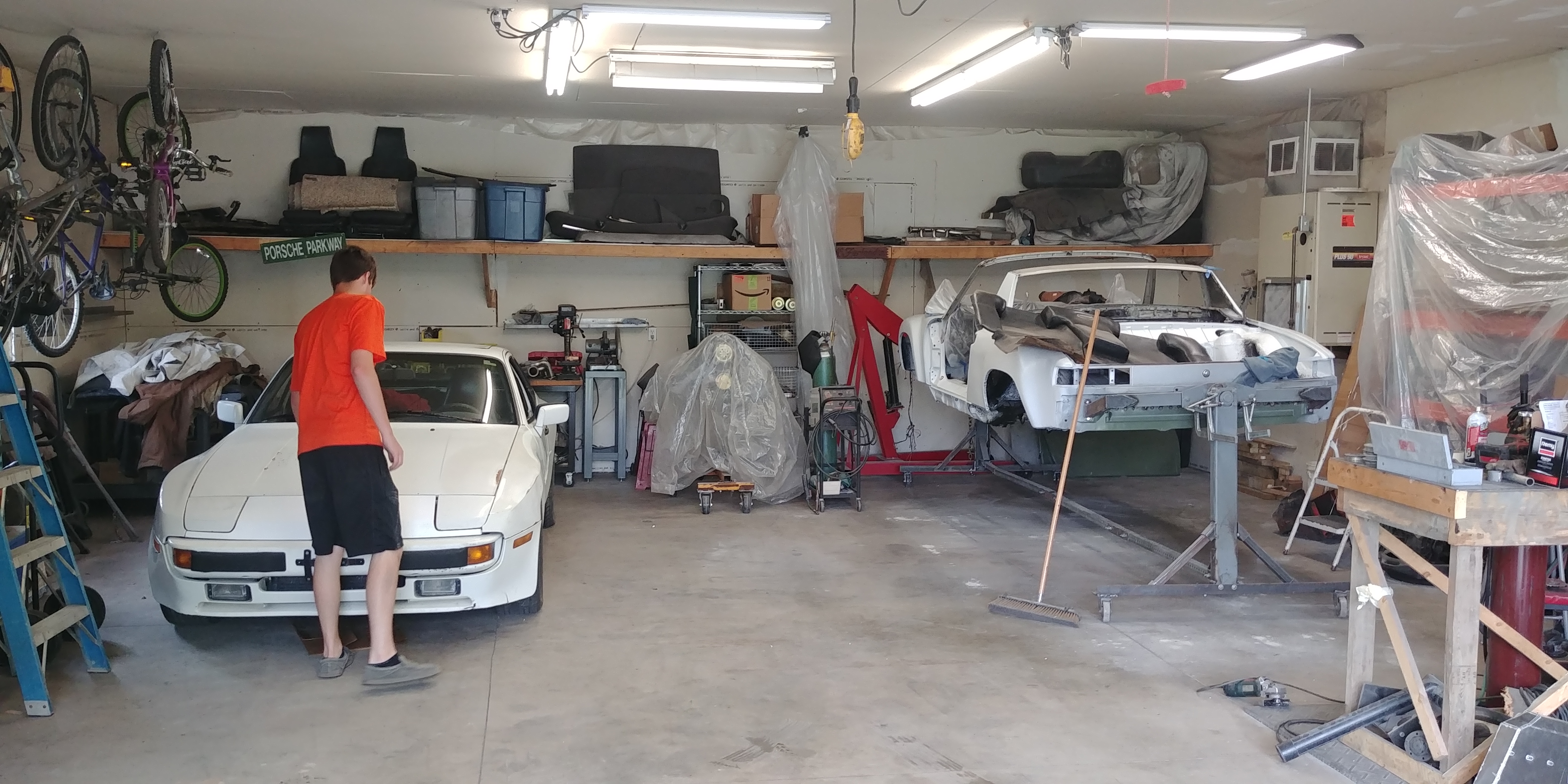

mb911
Finally spent some time on this.. 2 cars torn apart wears on me as parts are everywhere.. I need to get his car mostly back together.. Click to view attachment

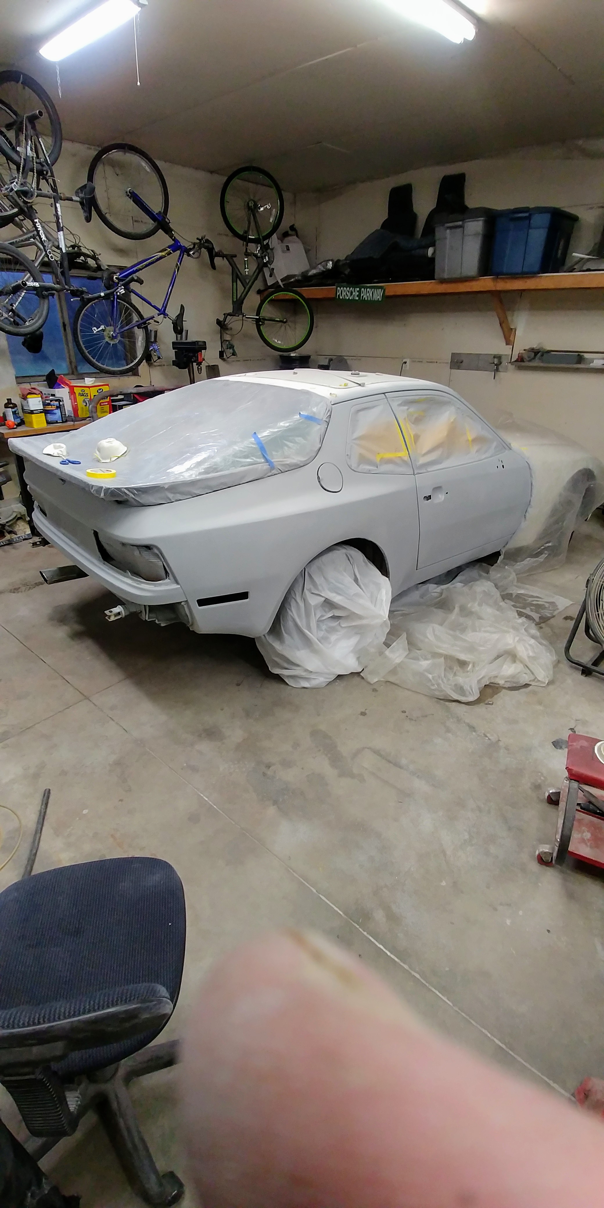

Here are some more money shots.. Now to buff.. Click to view attachment Click to view attachment

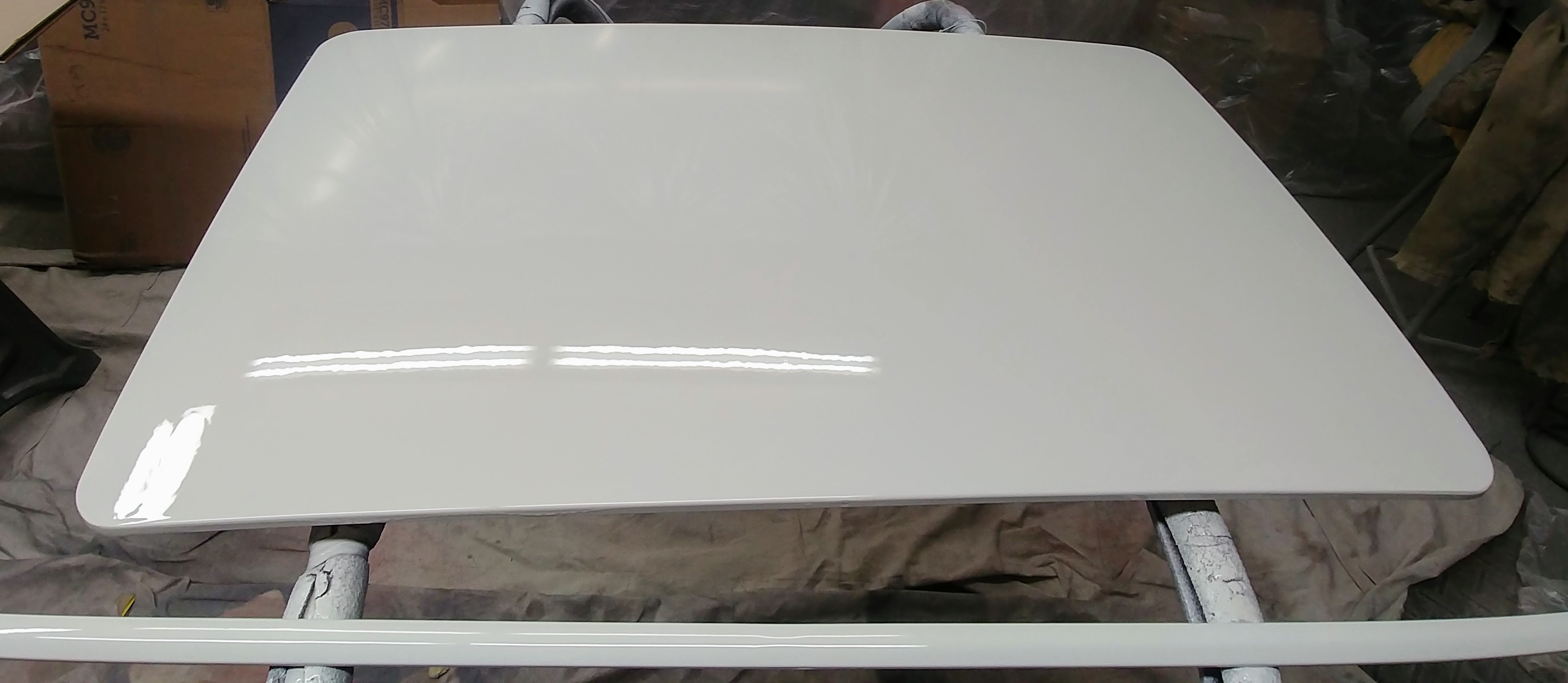

Roof replacement painted this weekend. Click to view attachment

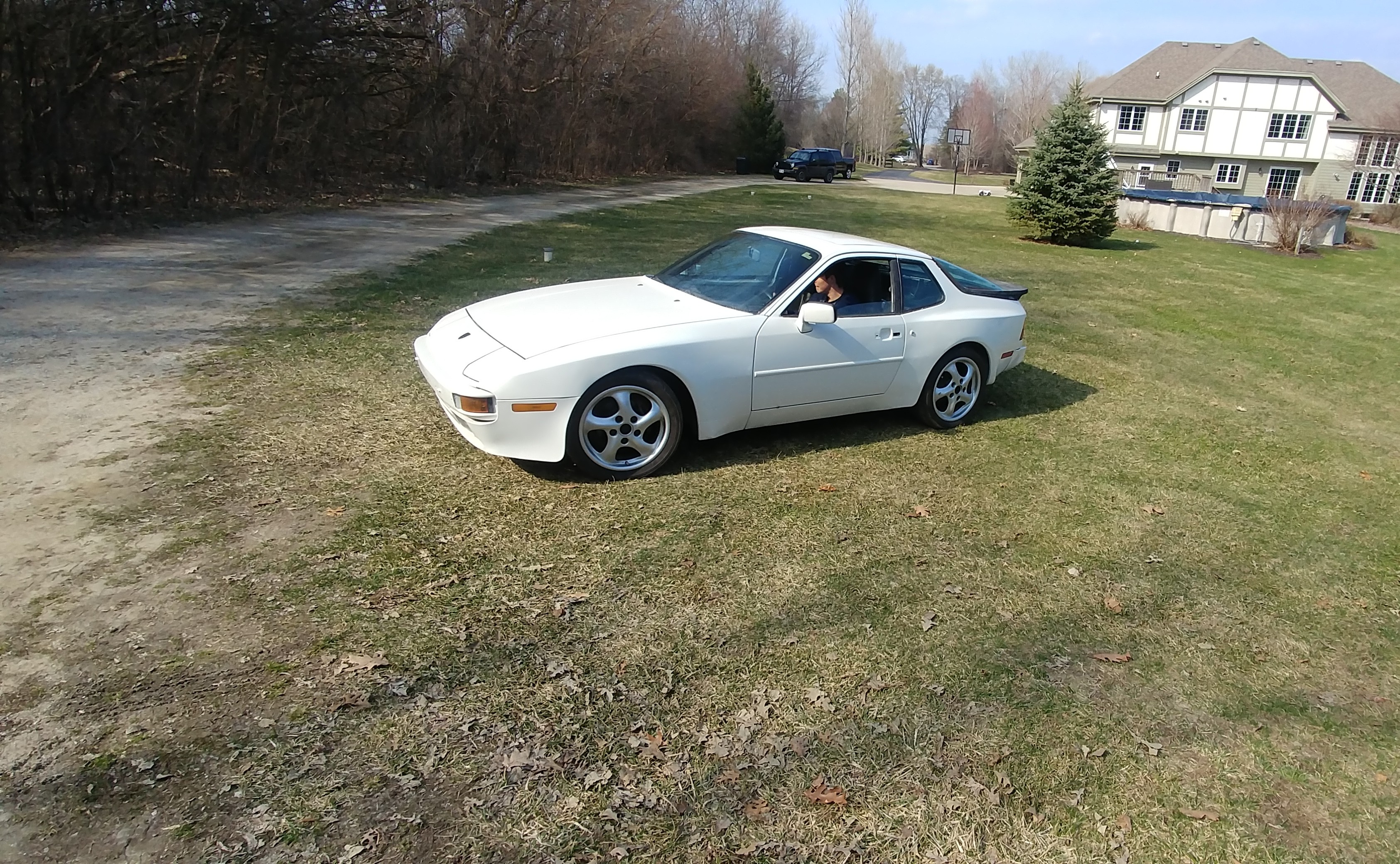

Yesterday was the 1st day on public roads.. Click to view attachment
