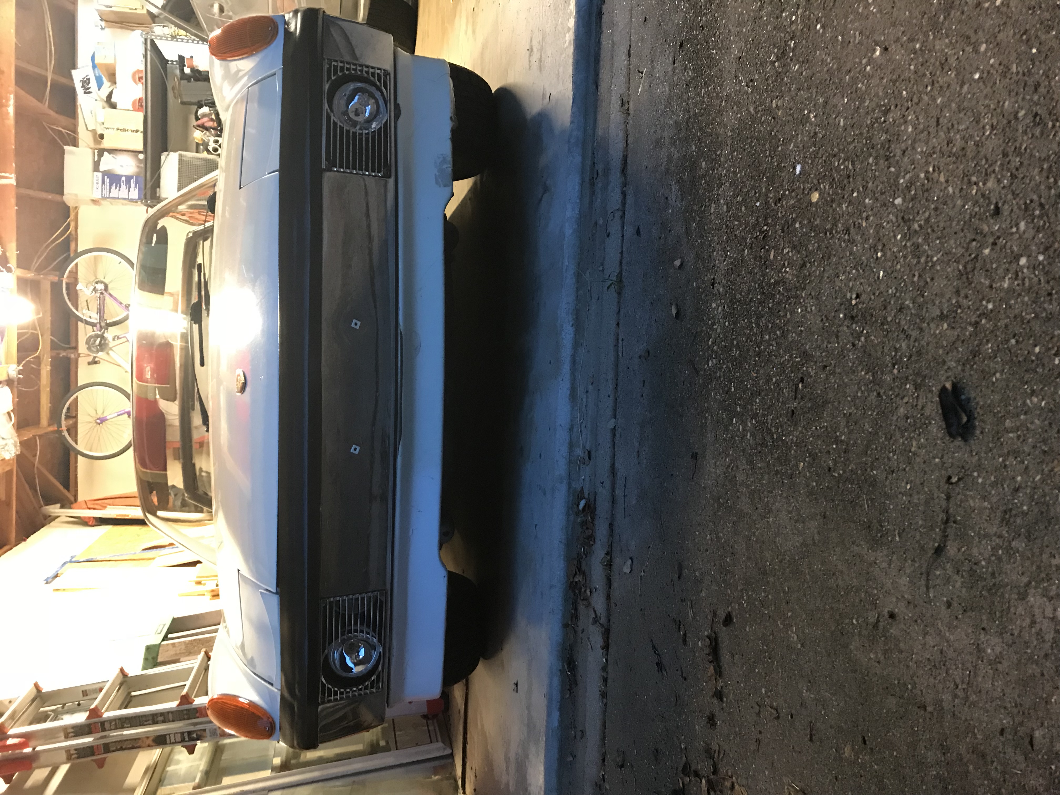

Is my car a good candidate (see pic)?
Mikey914
YES, I'd say you are 1/2 way there. No need to remove the air dam as you have the clearance.

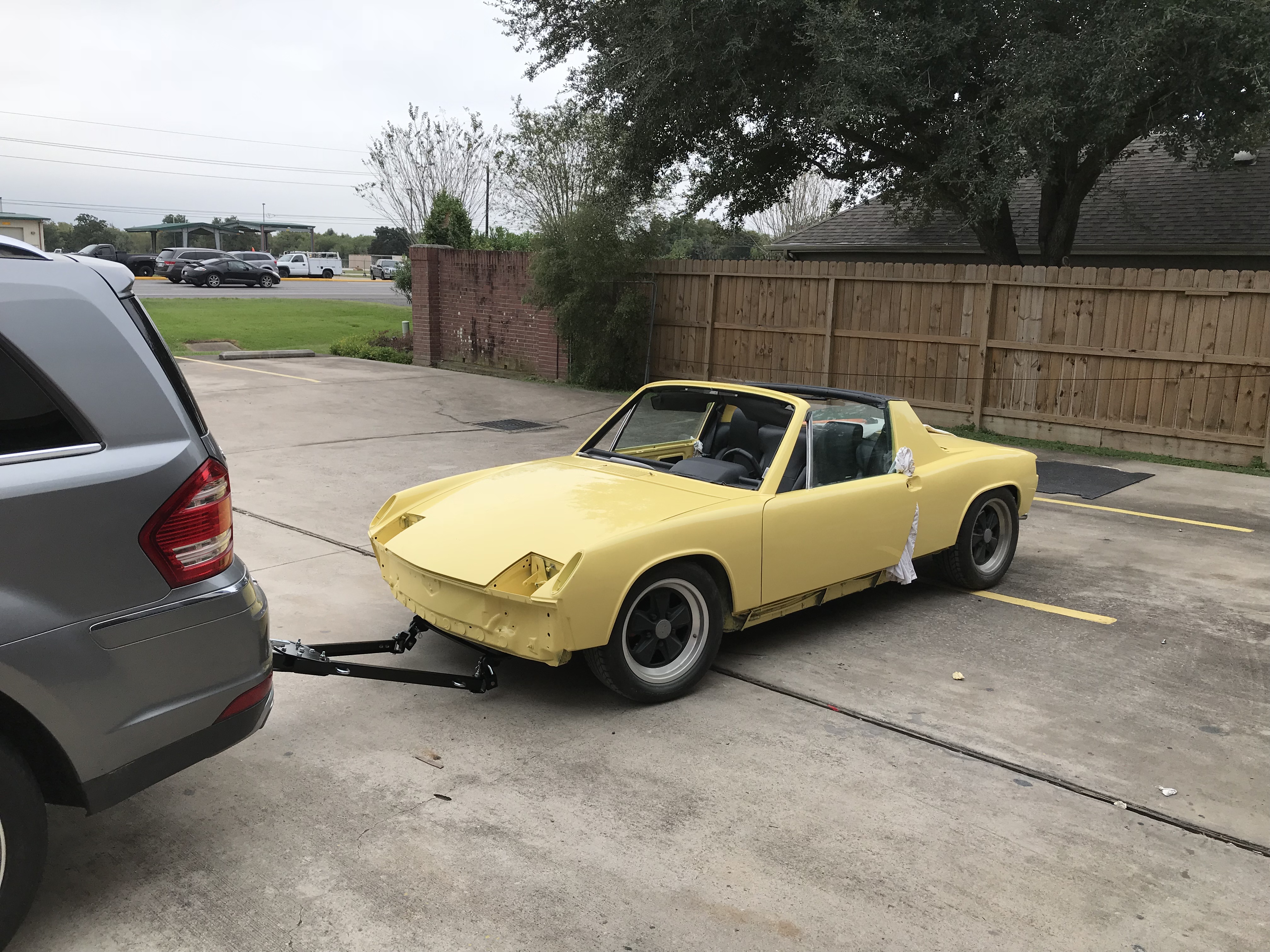

Totally agree.
Most importantly.... it works!!
914werke
blink.gif hard to tell from that shot but it looks like its attached kinda crooked?
Chris914n6
Looks like your adapters were welded wrong. That's a double pivot and not the way to do it.

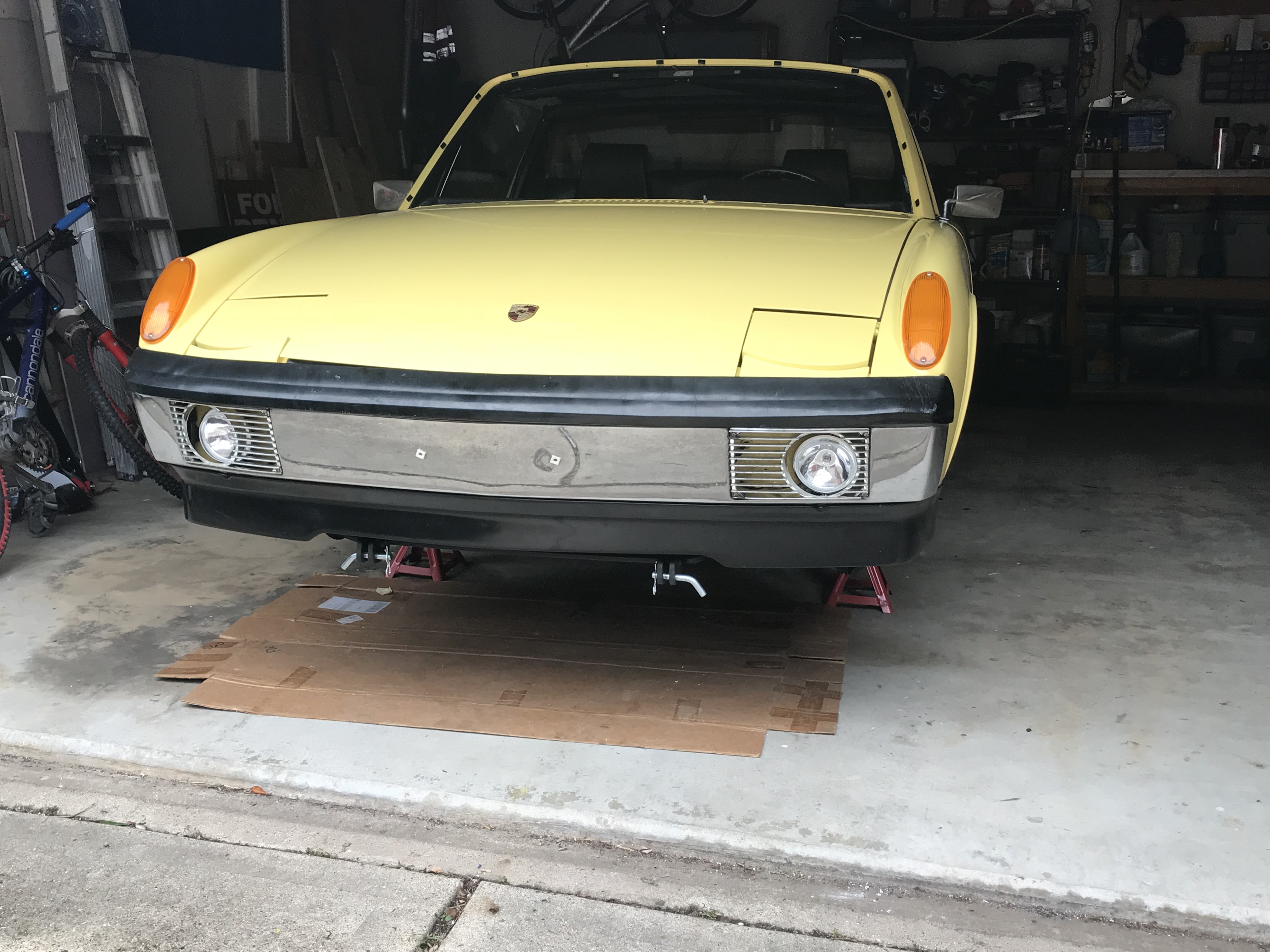

HansJan
Installed the LE airdam today. Looks good.
And received the new adapters for the towbar.
All seems good (will test later this week).

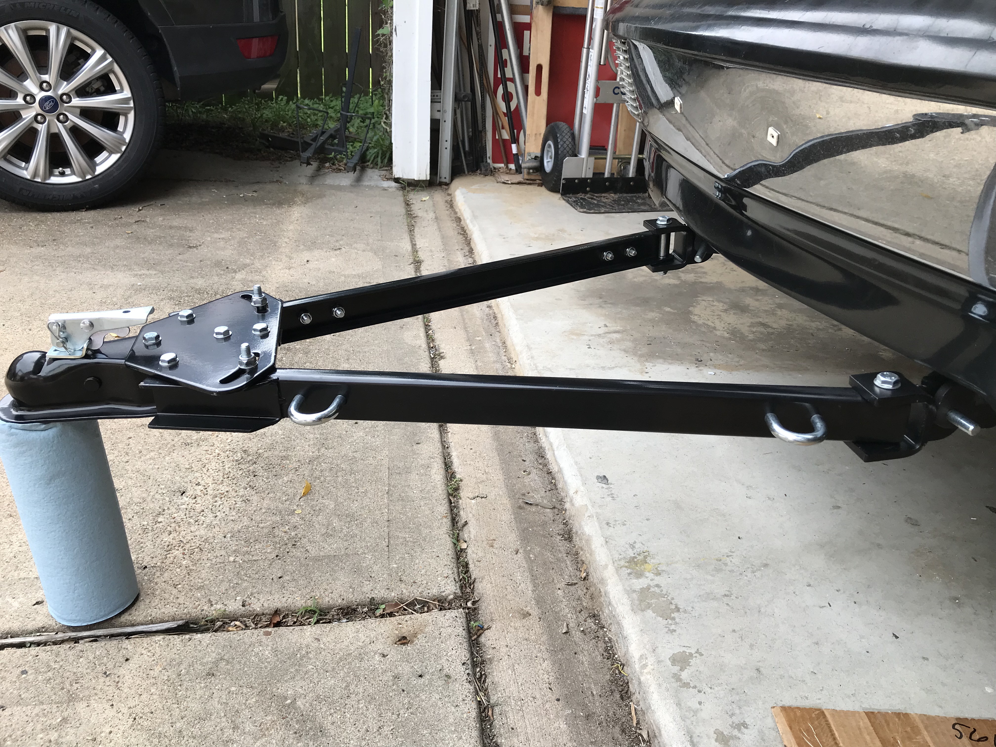

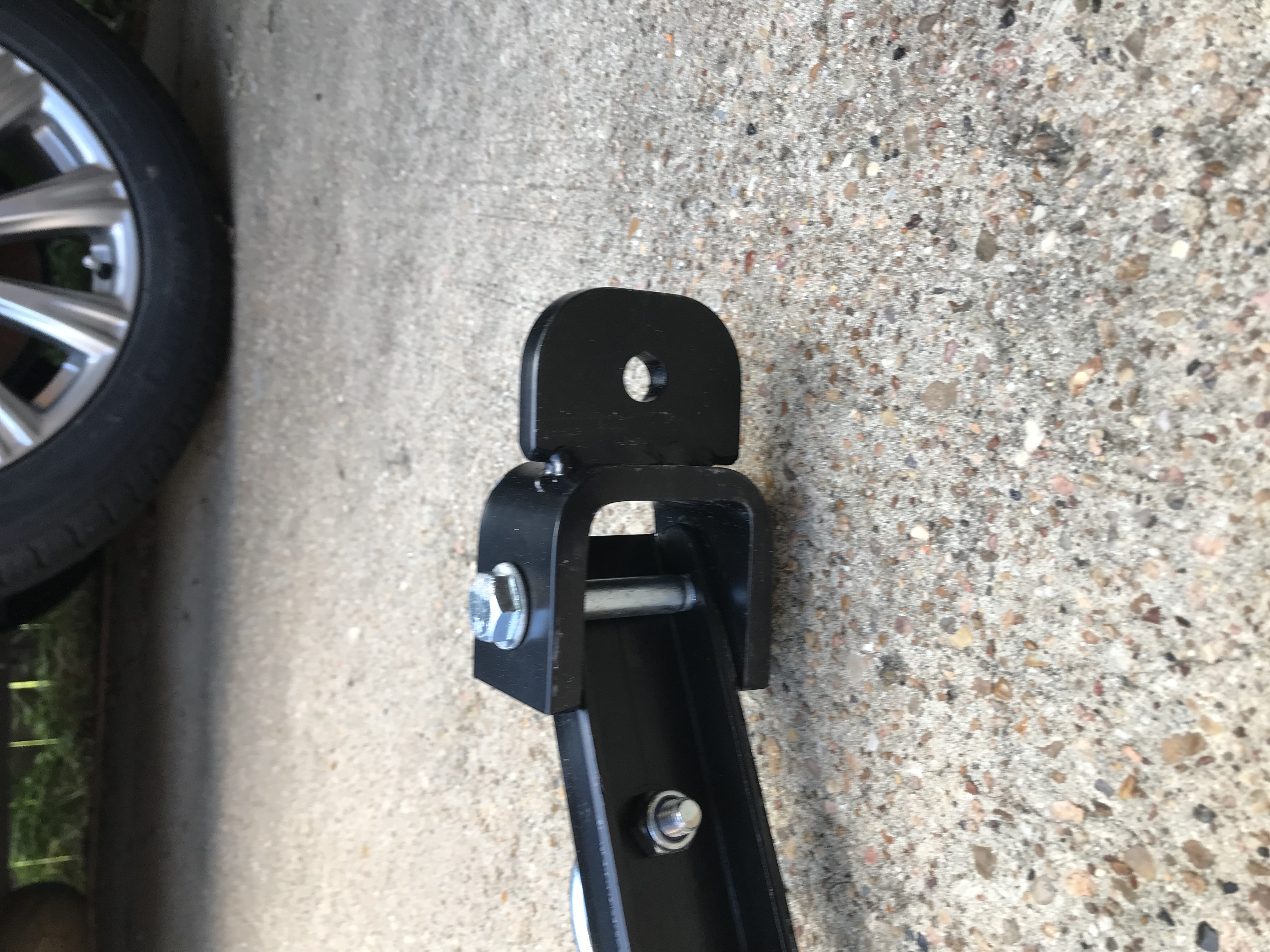

See below picture.
If you have this adapter in your stash, you are good to go.
Otherwise, call 914Rubber or send this picture to them.

Just completed universal tow bar brackets that allow you to use the EMPI bar without them or you can use HF, Walmart towbars with the adapter brackets. You can see how my adapters allow you to simply trade out the originals and that the steel we used was thicker than than the actual tow bar.
The bar with the hardware to mount it is $99 and the adapter brackets are $25
New brackets shown on a Walmart bar.

Mikey914
If you bought my bar you might need the adaptors. You can see the end that I took off that would allow a bolt to go through. The adaptors are shown attached to the Walmart bar.
You should take a look and see what you have as the bars I made were designed for the Empi tow bar. Post up a pic of what you have I can let you know.
Mark
