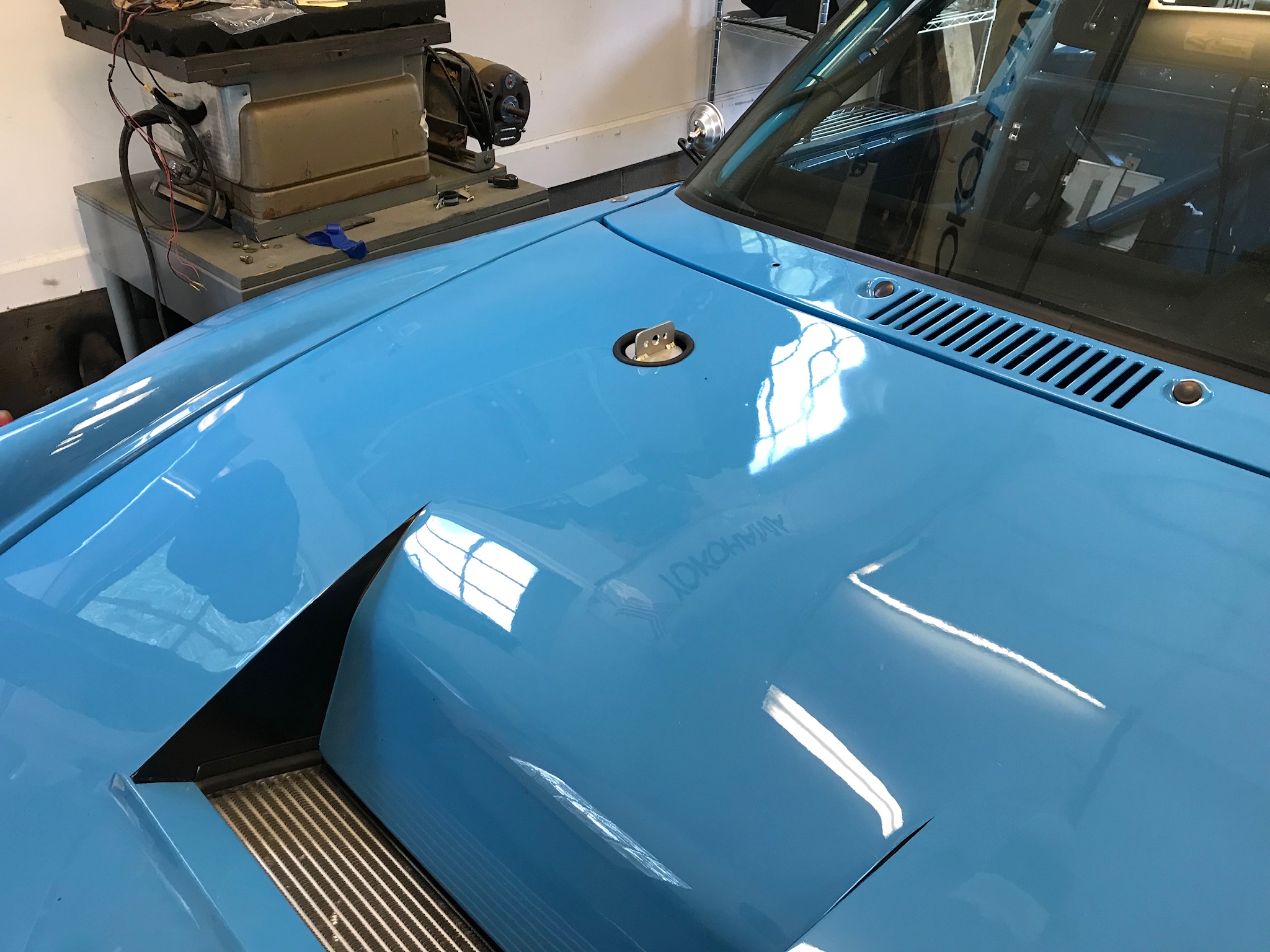

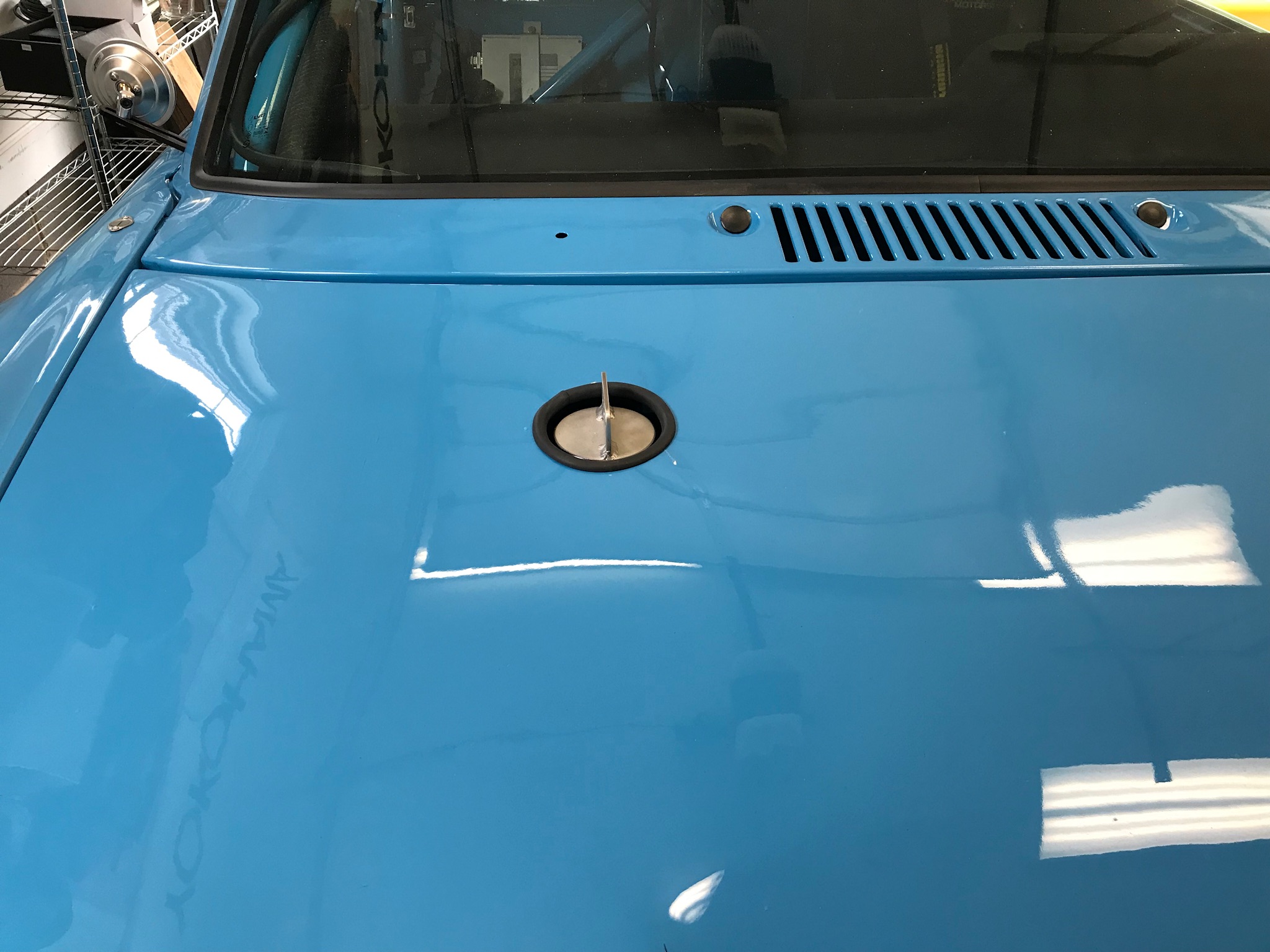

Most of what we did this weekend you can’t really see.
The clutch seemed odd: when you step on it, there was a click or pop sound in the tunnel. I had replaced the stock clutch cable with a Terry Cable version. It’s different. So I put the stock one back in and it seems fine...so now we have 2 Terry Cable clutch cables for sale
Also did some adjusting to the brakes. Again, something seemed “off” turns out I never tightened the lock nut on the rod between the pedal and the master cylinder...there was a fair amount of play when you stepped on the pedal. Better now.
-Made brackets for the fire suppression nozzles.
-Fixed an issue with the GoPro dash mounted on/off button and light (we use that for a rear facing camera)
-Cut and painted screening for the front fender vents and installed screen for the oil cooler intake
-Started making the glove box door (it’s where we keep the log books)
-Spent way too much time trying to figure out how to run the fire suppression lines...(still don’t have an answer)
-Got it corner balanced and aligned last week.
-Oh, and cut a hole in the front hood for fuel fill.

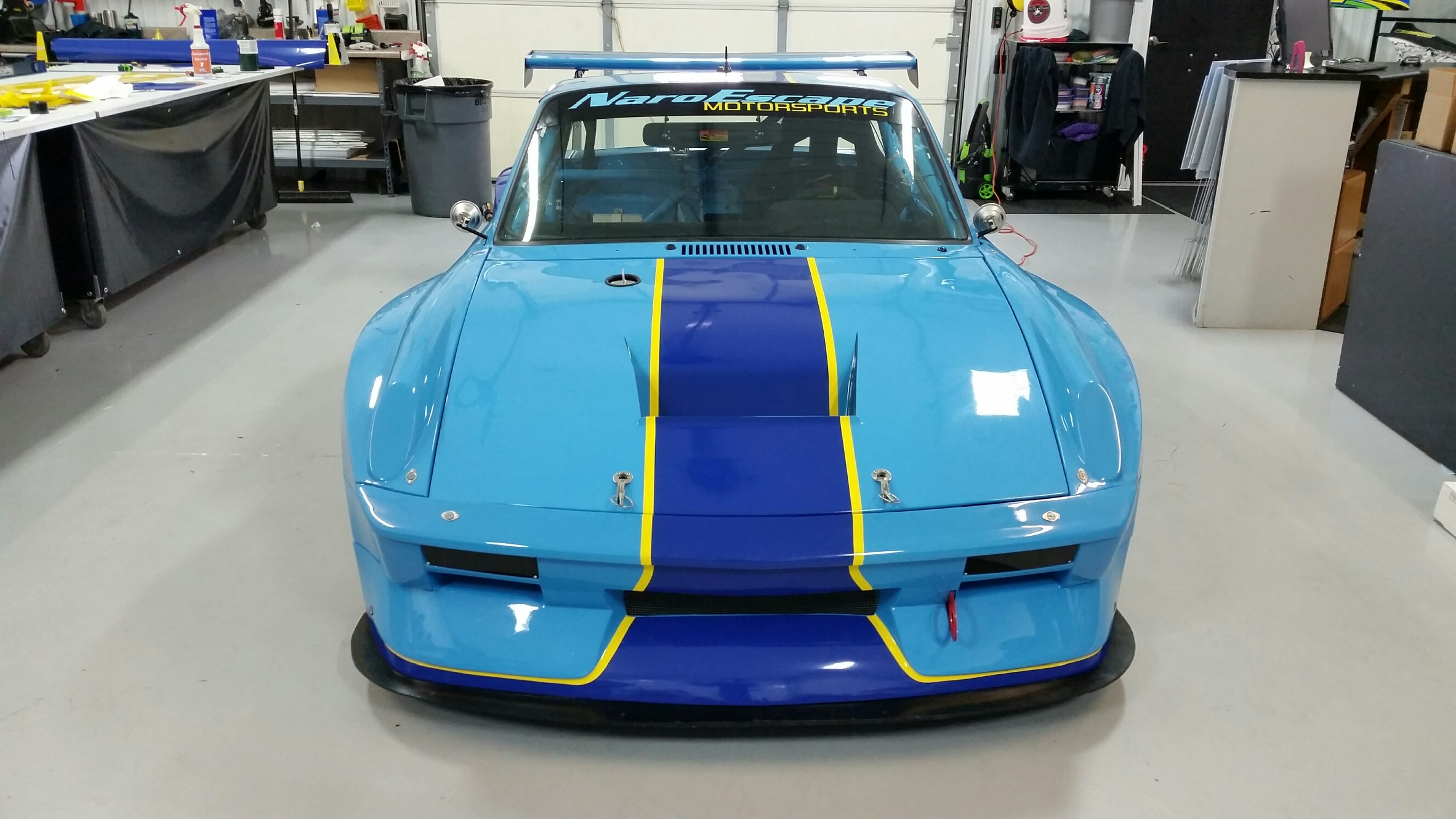

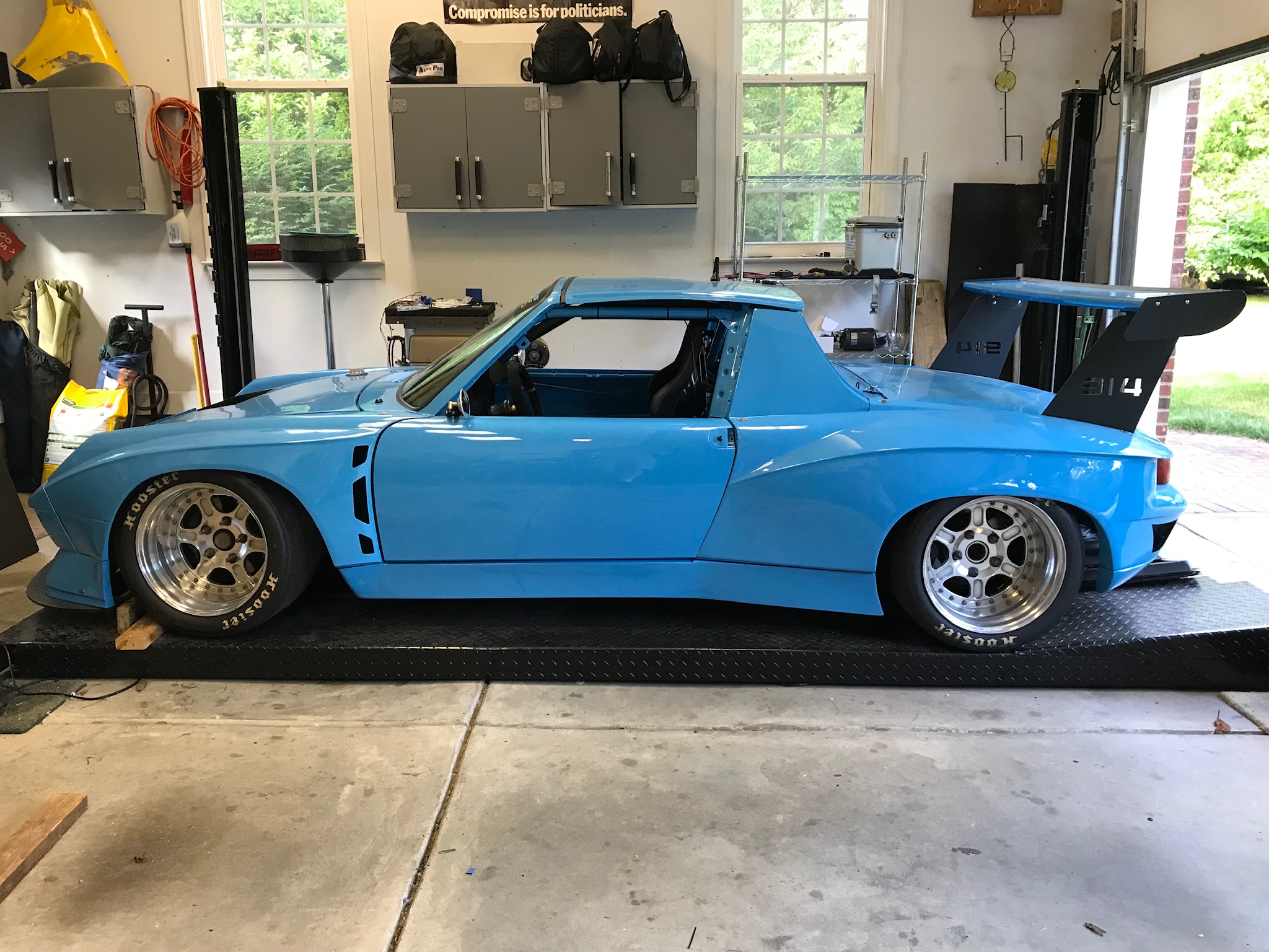

Little change to the color scheme...

Thanks Pete...but we also have some sponsors, or more like companies that gave us free or greatly reduced rates to get this done we have to take care of. And it’s kind of a showcase of what we sell and what you can do in your own race car...
It’s a race car. Personally I don’t like boring single color simple race cars. Heck, even our “street” 914 is way beyond simple...
Plus we need PCA Racing, Vintage Racing, and SCCA decals, classes (VGTO, GT4 and GT2), weight (diff for PCA and SCCA of course),

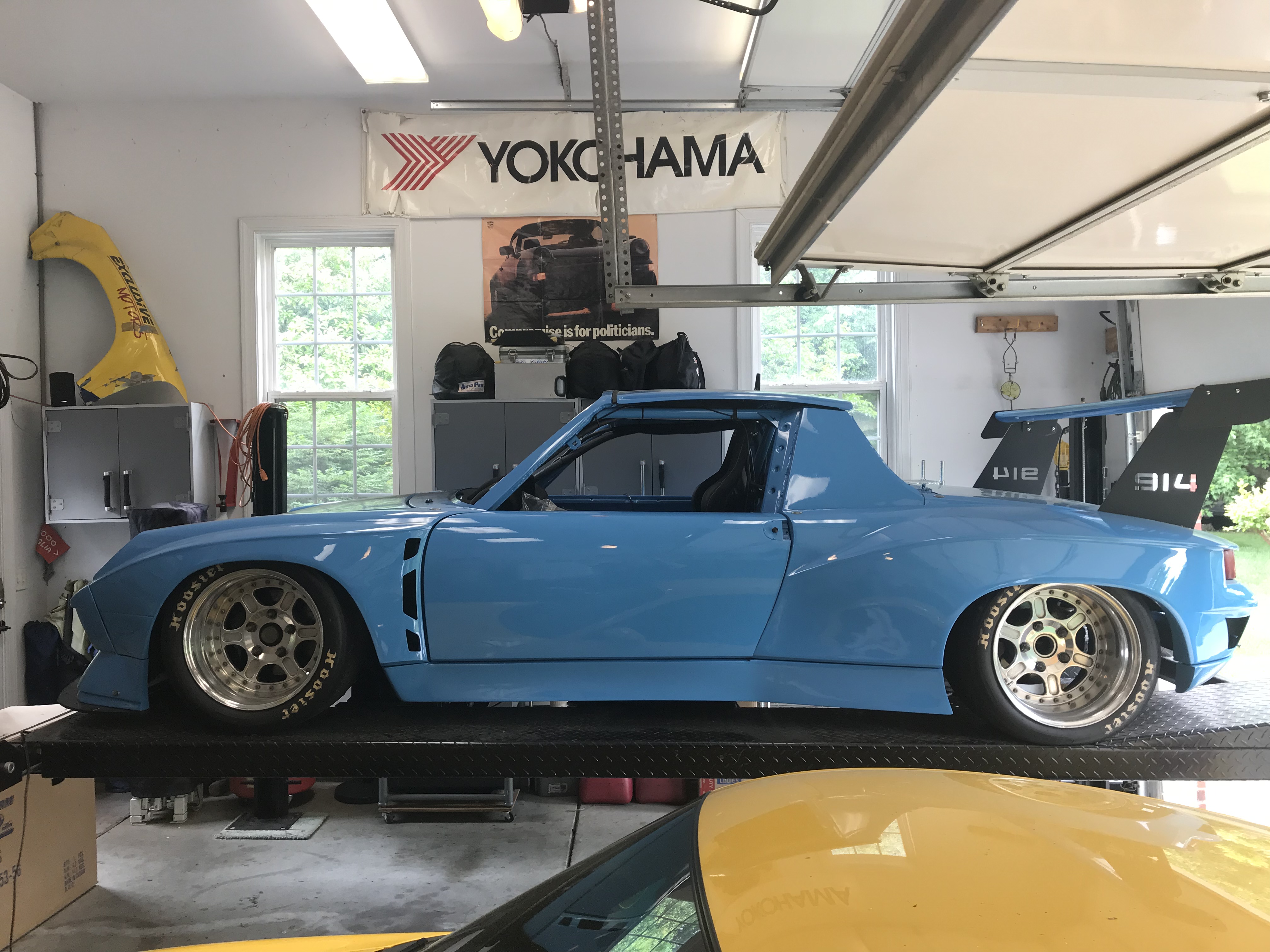

This is our side numbers...pro-ish style

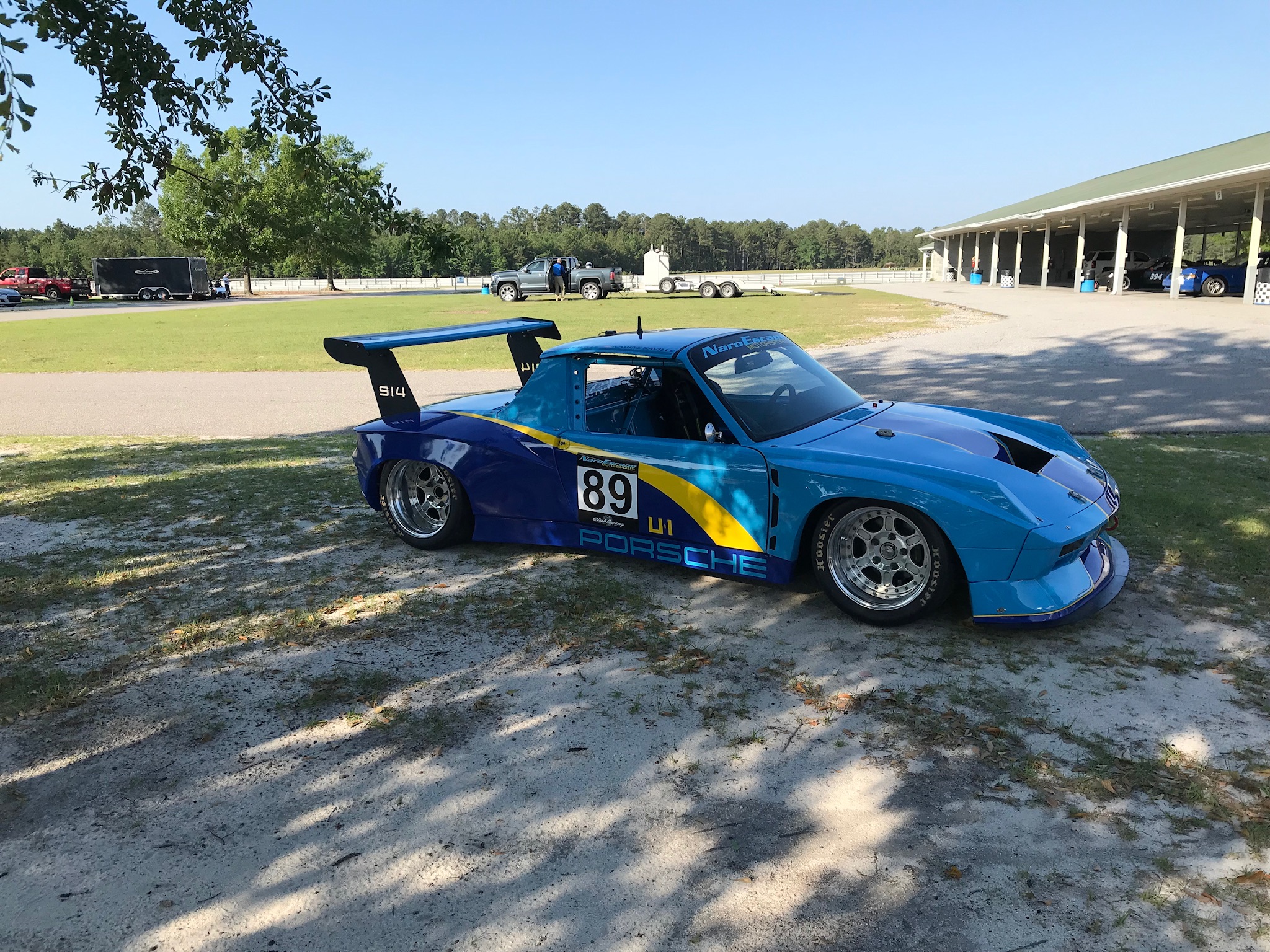

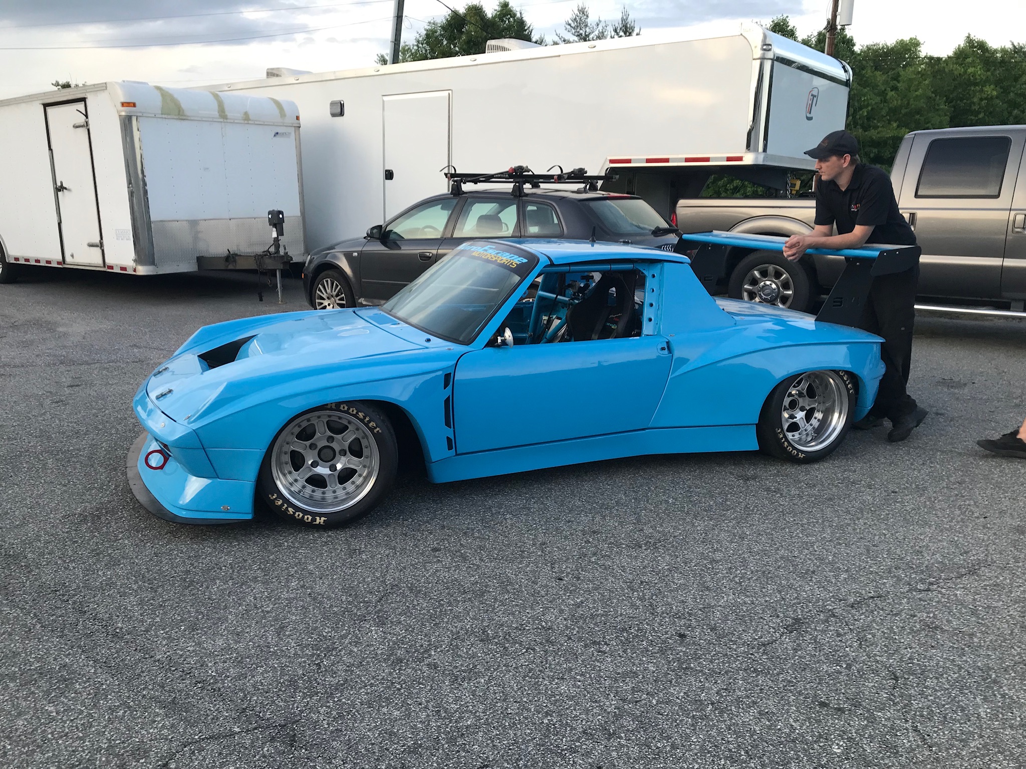

So....update!! As I mentioned above This weekend was the first time out for Papa Smurf. Friday was a testing day, Sat/Sun was the SCCA Time Trials National Tour event.
We had two sets of really old tires...no need to spend a lot of money on new slicks for a test day and just a TT at a track that destroys tires...Friday went very well, only two minor issues:
- in my second session out, I started to smell fuel. When I looked in the rear view mirror, I saw a liquid spitting up onto the rear window...obviously fuel. Not wanting to test out our new Lifeline fire suppression system I shut it down and got towed in. We found a loose AN fuel fitting at the fuel rail. Easy fix.
- Cody Forbes of Black Forest Racing was there to help out with testing. I let him take it out and toward the end of the session he was having an issue shifting into 2nd and 4th. Turns out I never locked down the stops on the Rennshift and one had vibrated itself “in” and stopped the grow from going far enough to engage the gear. Another easy fix.
Otherwise...the tires sucked, but we managed through them and I ended up finishing First Place in the top class U-1!!

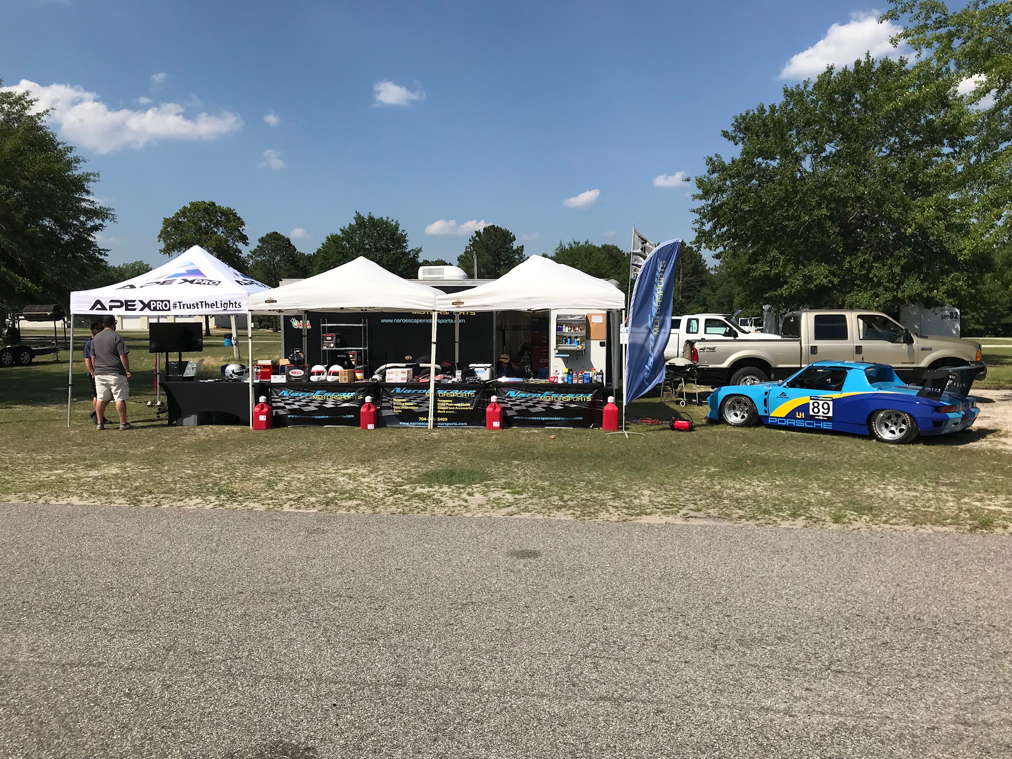

Finally got a chance to do a real race after all this work - PCA Club Race at VIR in Vintage class.
Results:
Fun Race - 1st overall
Sprint 1 - 1st overall
Sprint 2 - DNF (threw an alternator belt)
Sprint 3 - 3rd overall
Not a bad way to celebrate your birthday weekend!!
we accumulate points through the races and I ended up 3rd overall, but most importantly I won the coveted Workers Choice Award!
The only issue - besides the thrown fan belt - was having issues with shifting into 2nd later into the 3rd race...

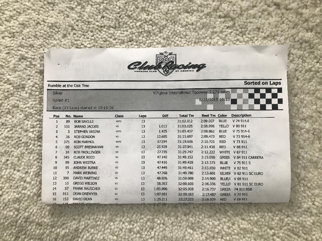

Have at it! And you will see I did multiple 2:07 laps.
The picture of the timing sheet was from Sprint 1 because thats the race I won. Video and my fastest lap was Sprint 3.
Congrats on winning the race.
