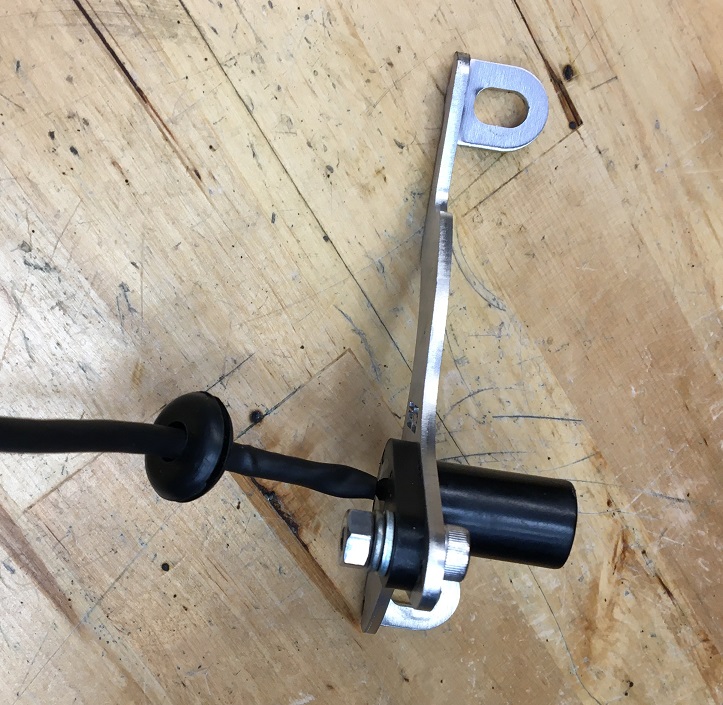

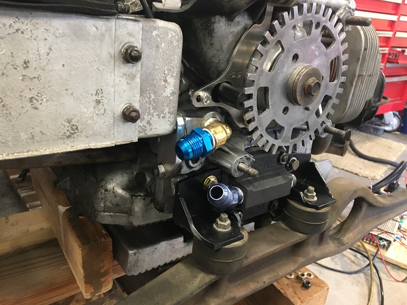

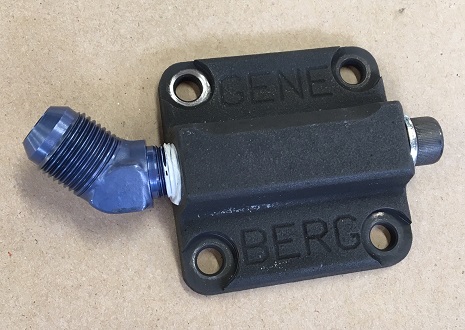

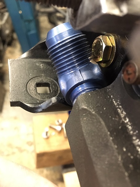

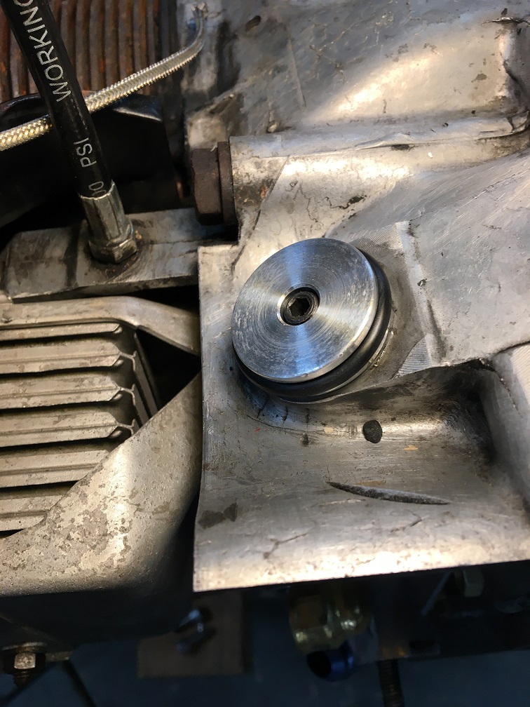

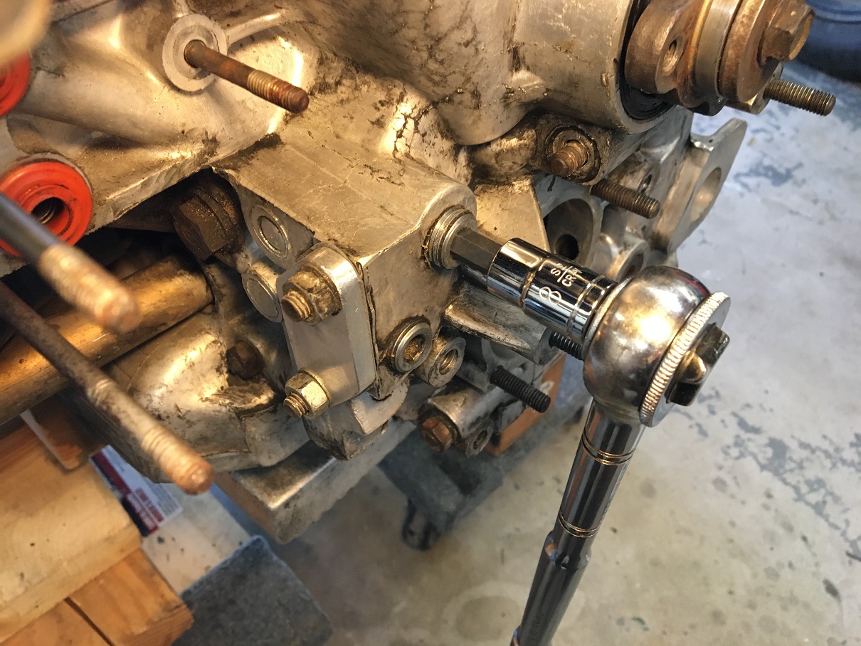

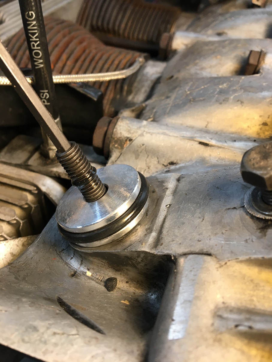

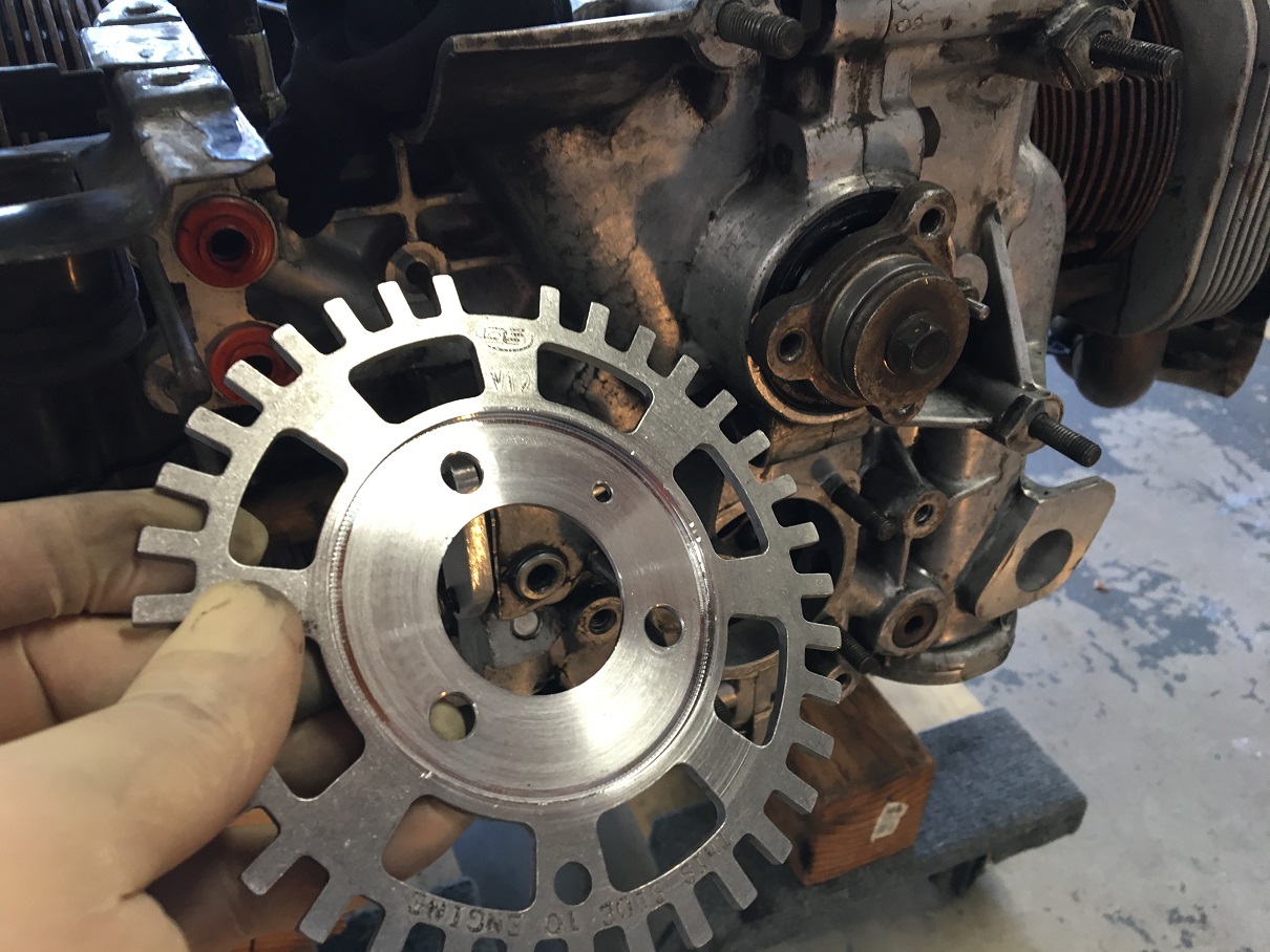

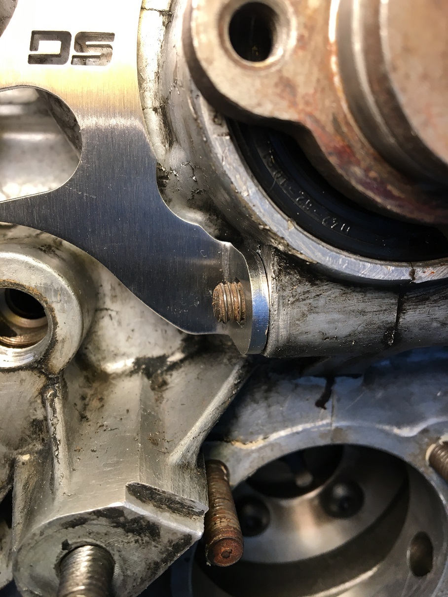

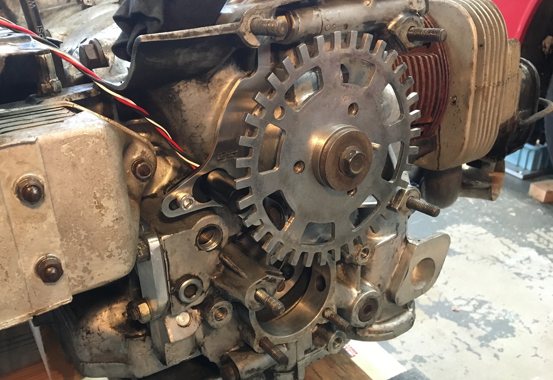

I bought my Microsquirt and crank trigger sensor sensor setup from Mario at the Dubshop. I like the way the trigger is engineered and it allows the installation of remote oil plumbing (full-er flow setup).

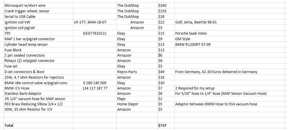

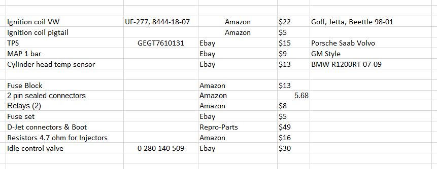

Being on a very tight budget (I know this doesn't rimes with 914 anymore) I bought all my new individual components from ebay with matching pigtail connectors to build my own harness.

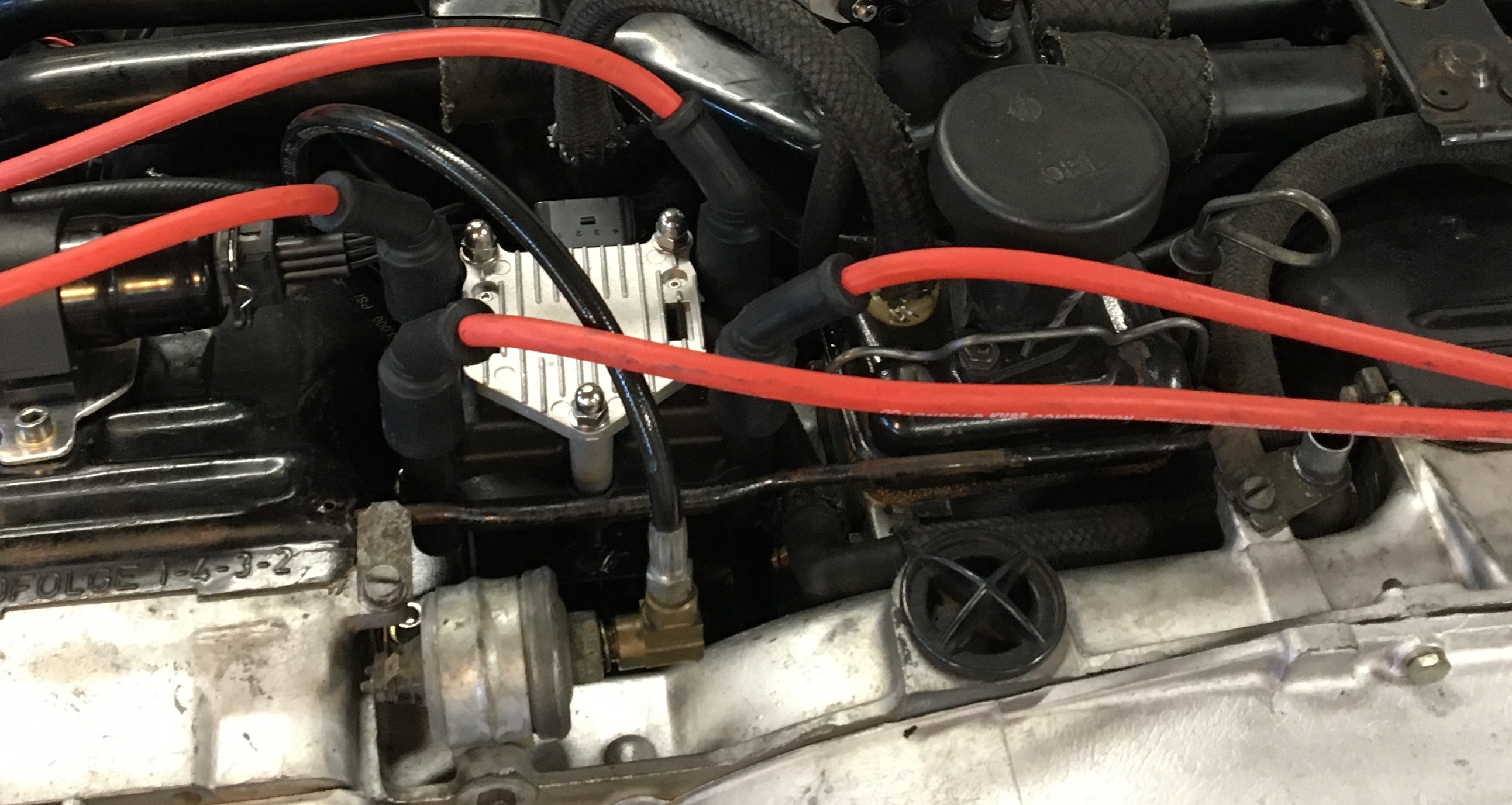

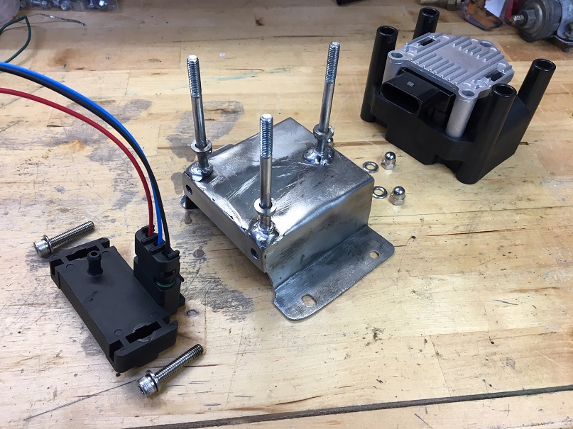

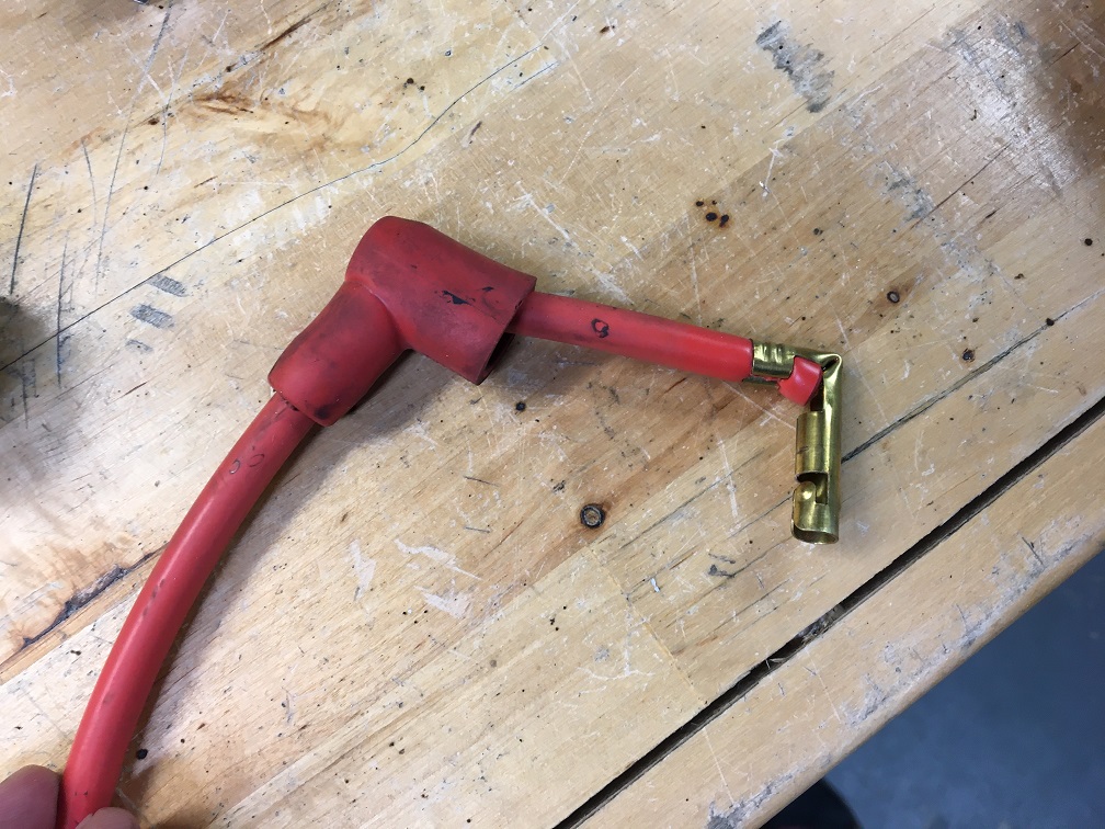

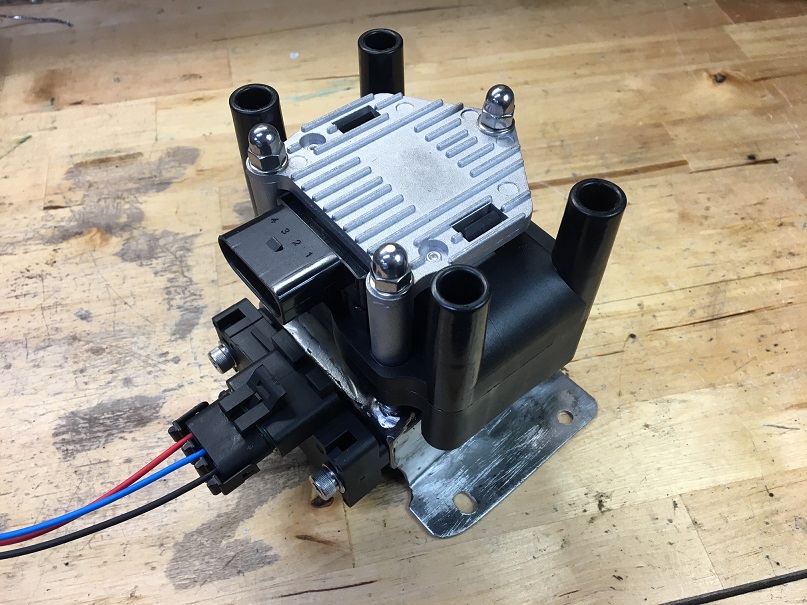

VW waste spark coil pack
GM 1 bar MAP sensor

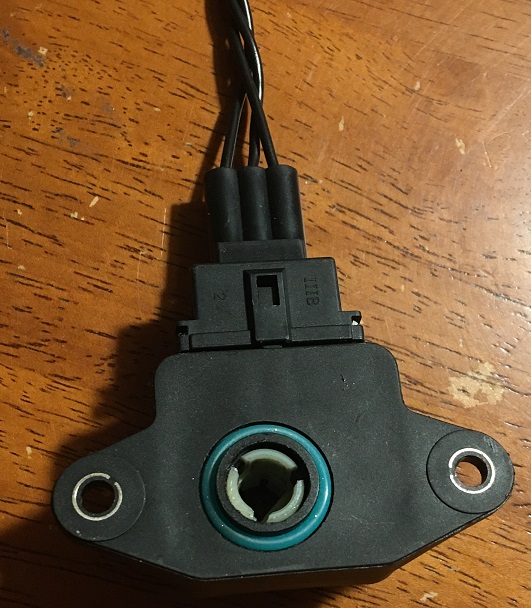

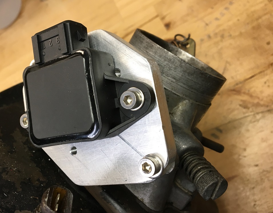

Hyundai (and others) TPS

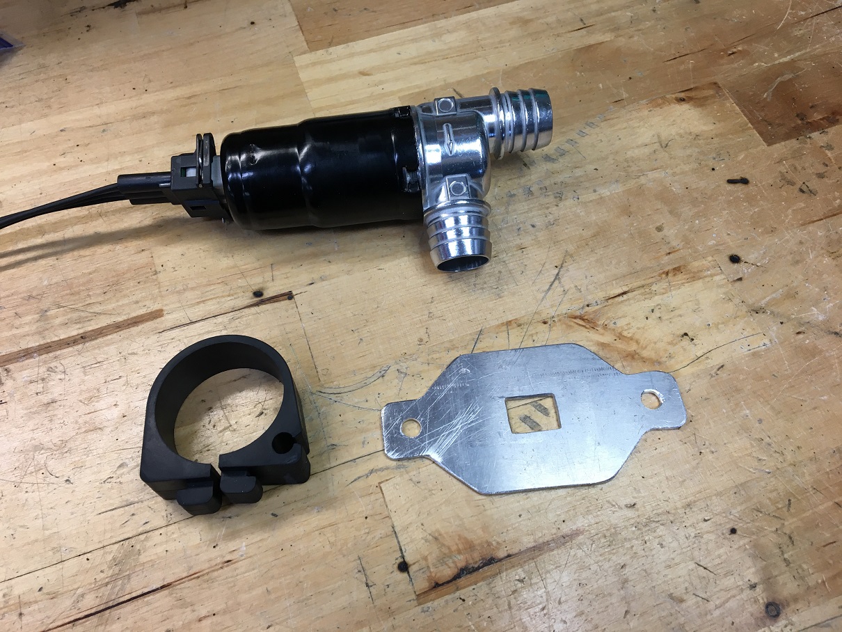

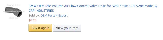

BMW ICV

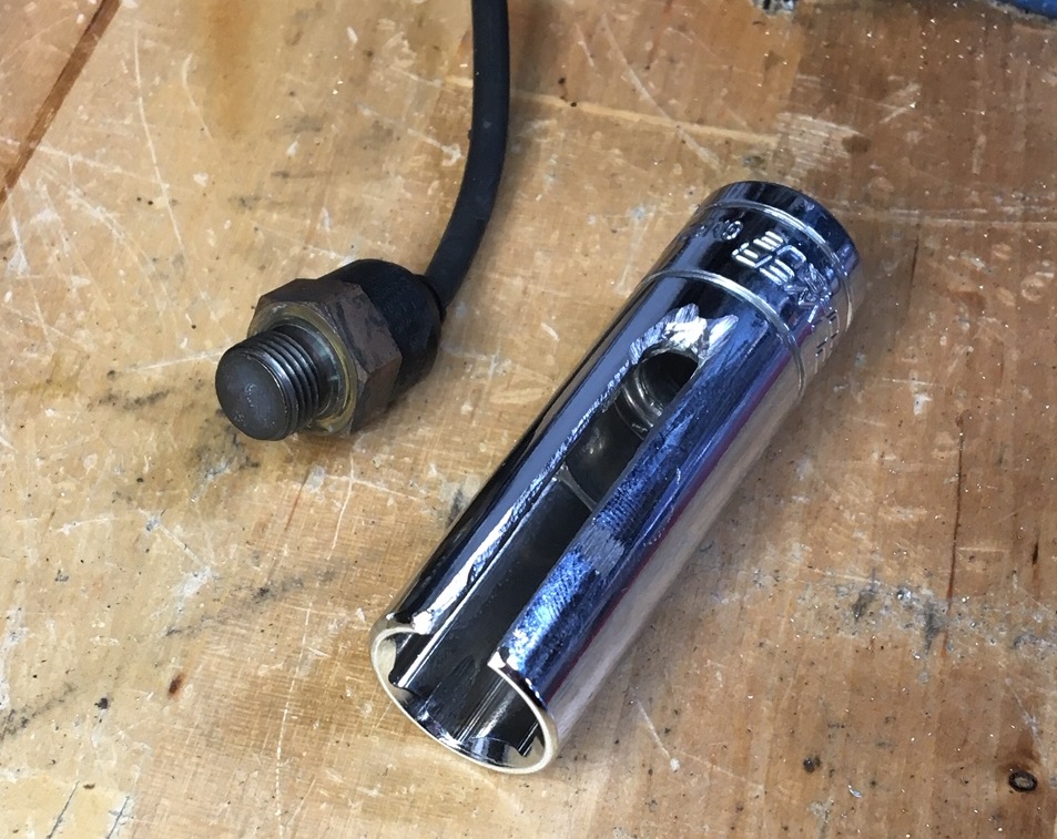

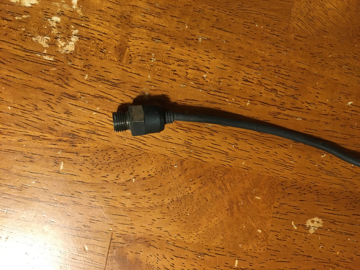

BMW air cooled motorcycle CHT sensor (used). Same M10 thread as the D-Jet CHT.
I will be reusing:
Stock green injectors, with additional resistors
Stock IAT sensor

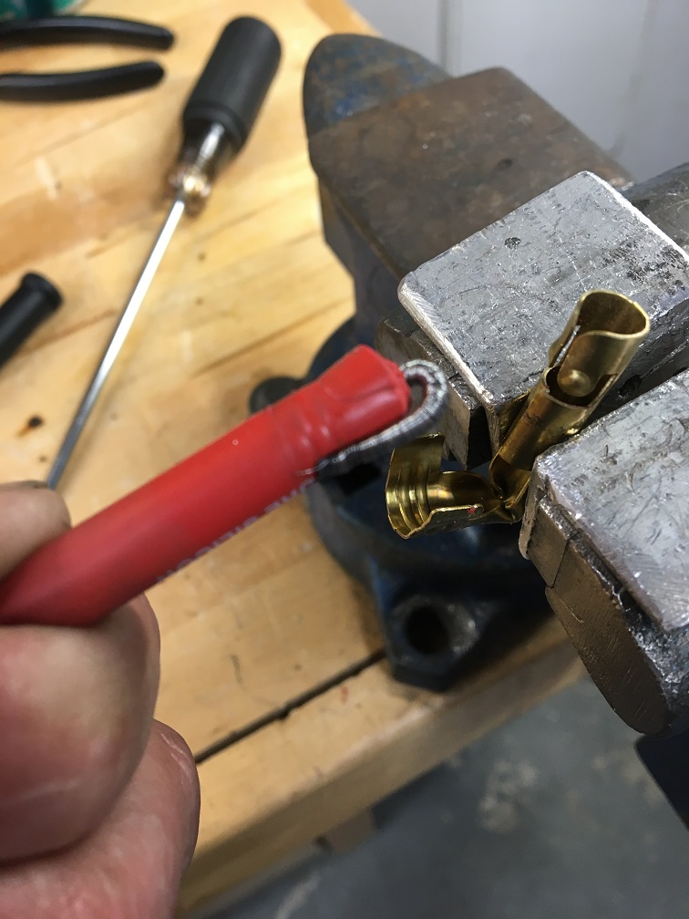

I also bought new connectors and crimp terminals and boots for all reused stock components.

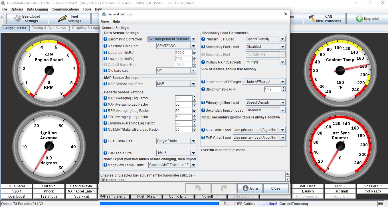

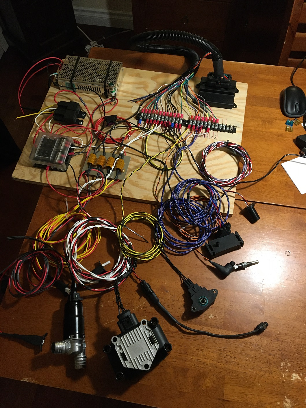

To begin the build, I elected to prepare a development harness with extra wire length and build a bread board setup. This will allow me to make sure that all components are functioning. Once the engine is running, I will rebuild the harness with the proper wire length and sleeves to ensure a clean and reliable installation.
Enough writing... On with what people want! Pictures
Bread Board setup:

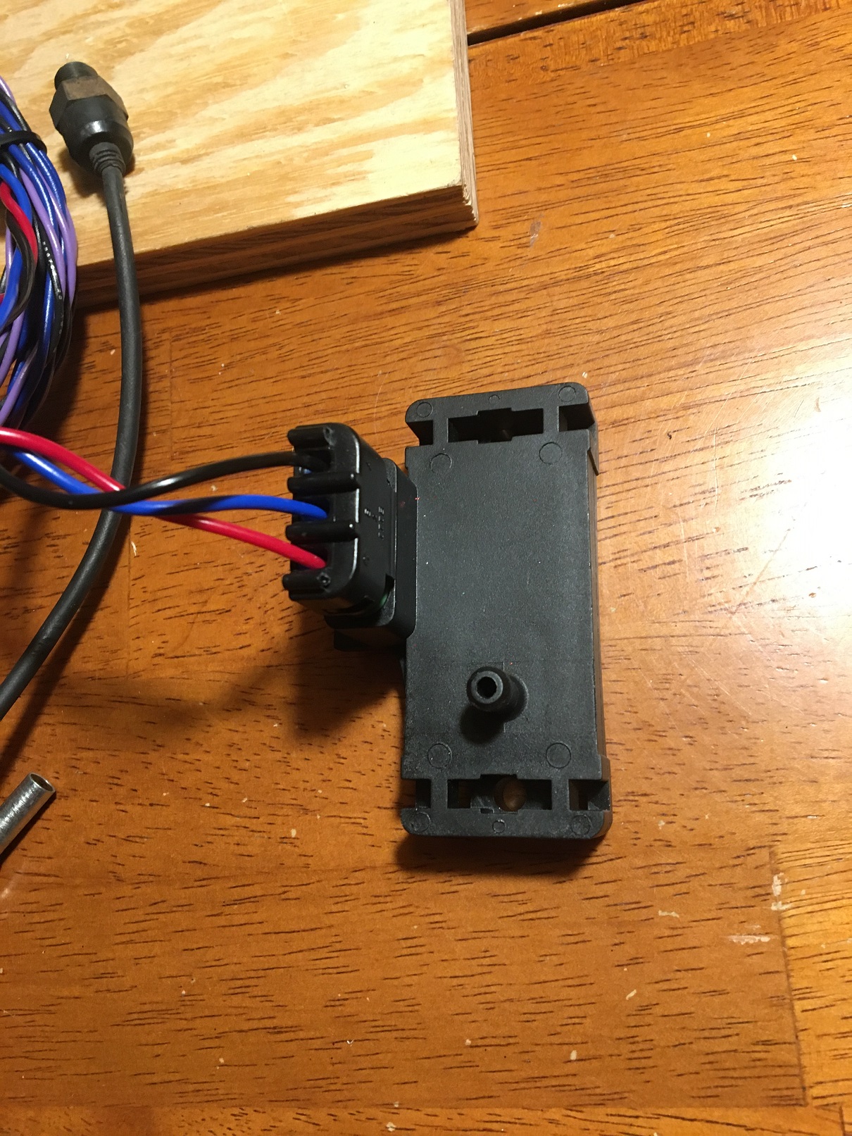

1 Bar GM MAP Sensor:

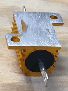

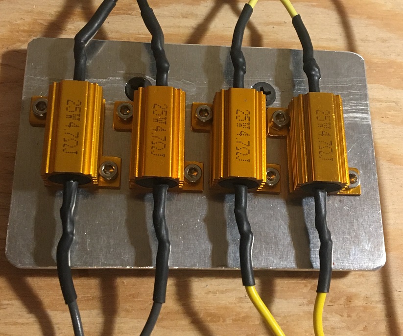

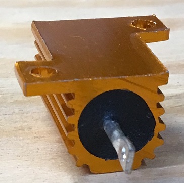

Resistance pack for low impedance green stock injectors. The resistances are not needed if you use modern high impedance injectors.

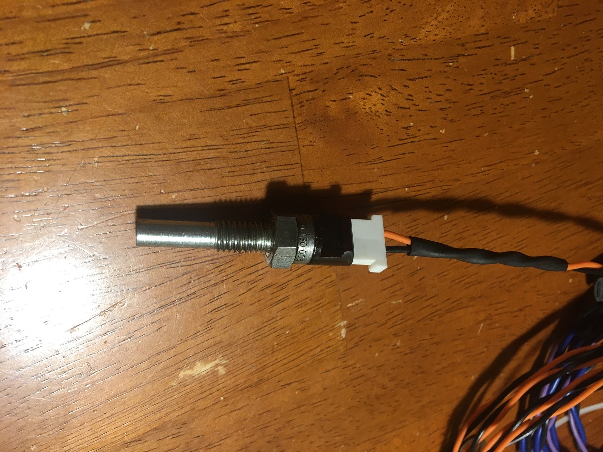

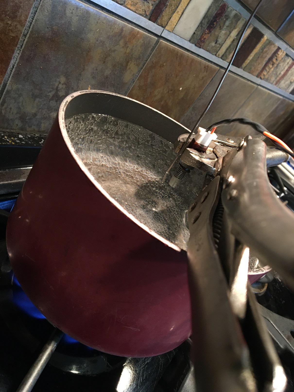

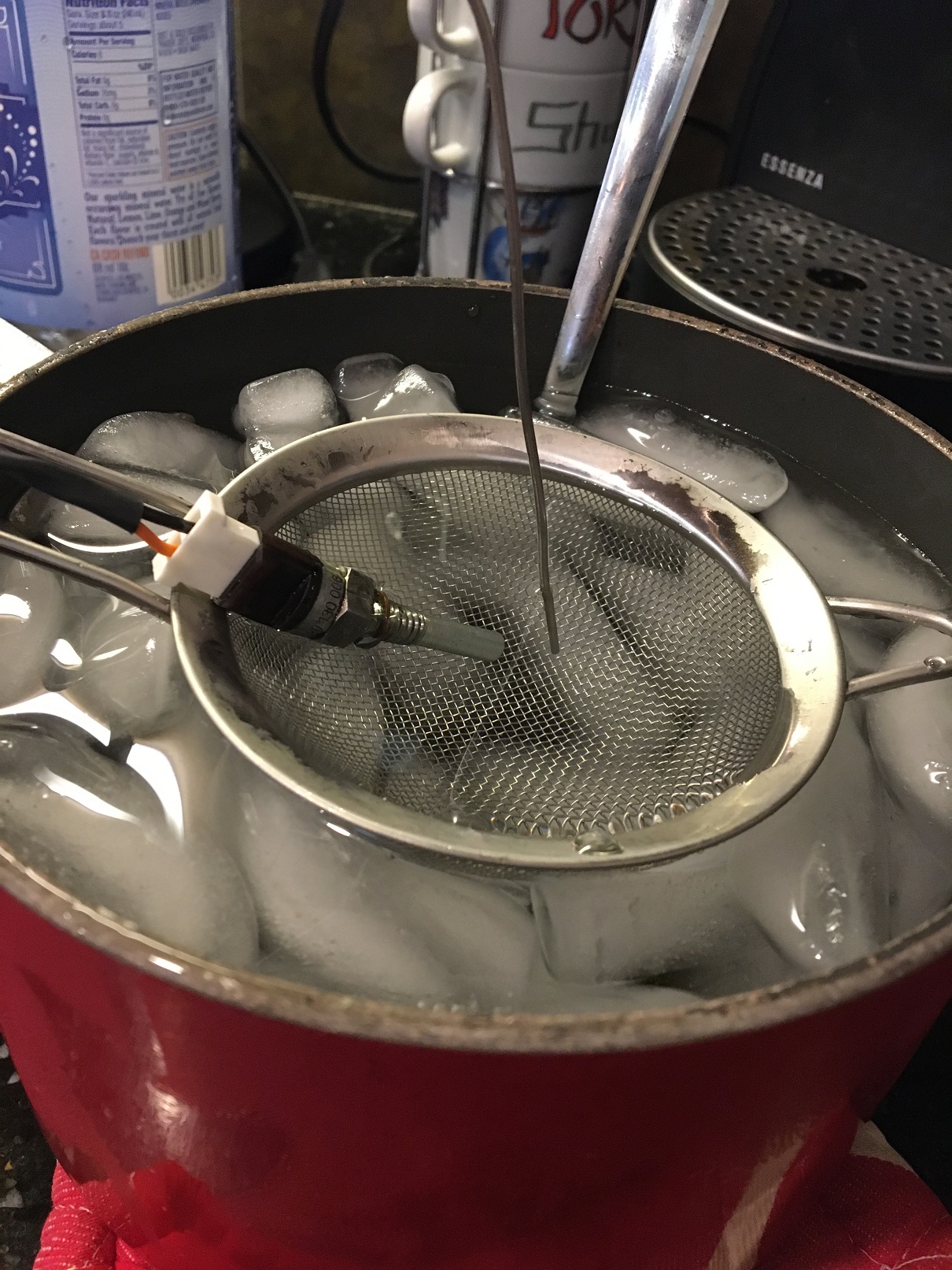

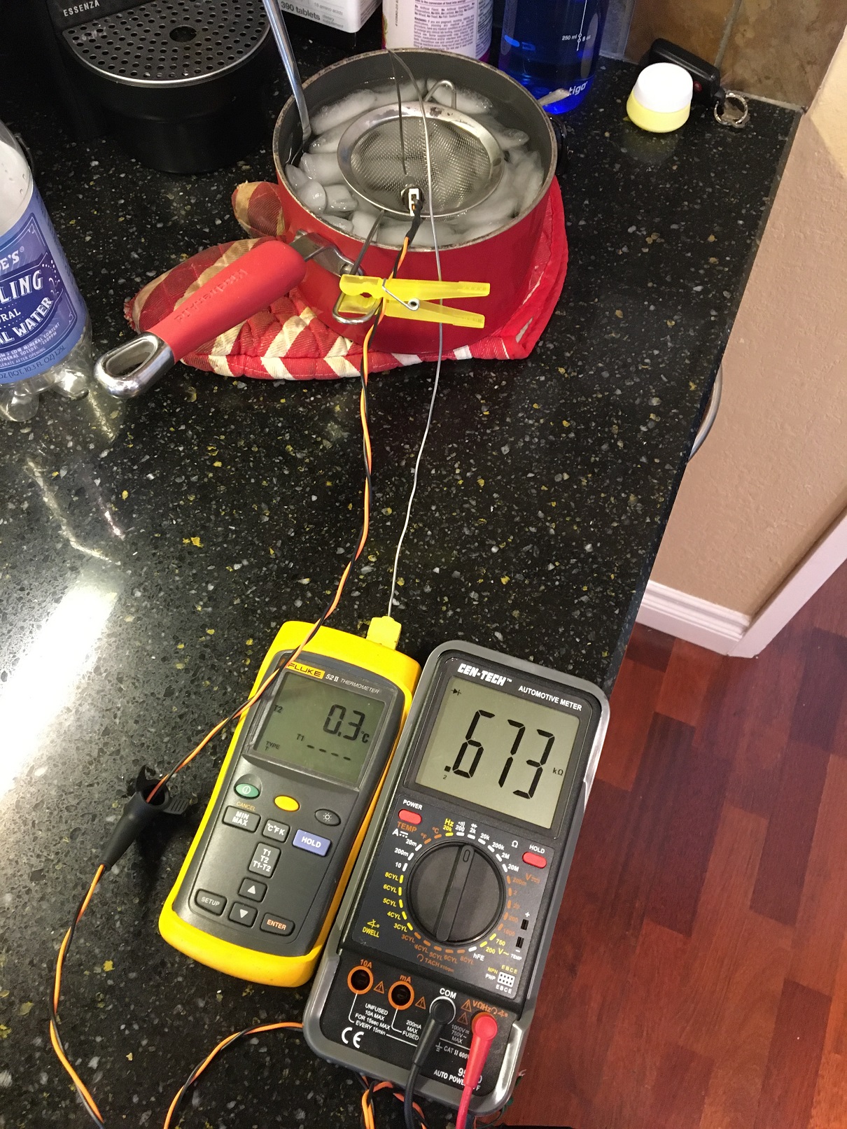

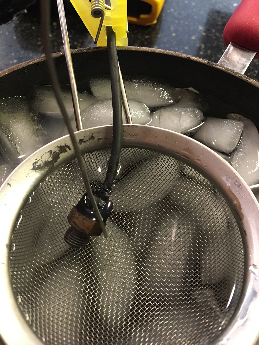

Used BMW Motorcycle Cylinder Head Temp sensor with M10 thread which will screw in the stock 2.0 head CHT location.

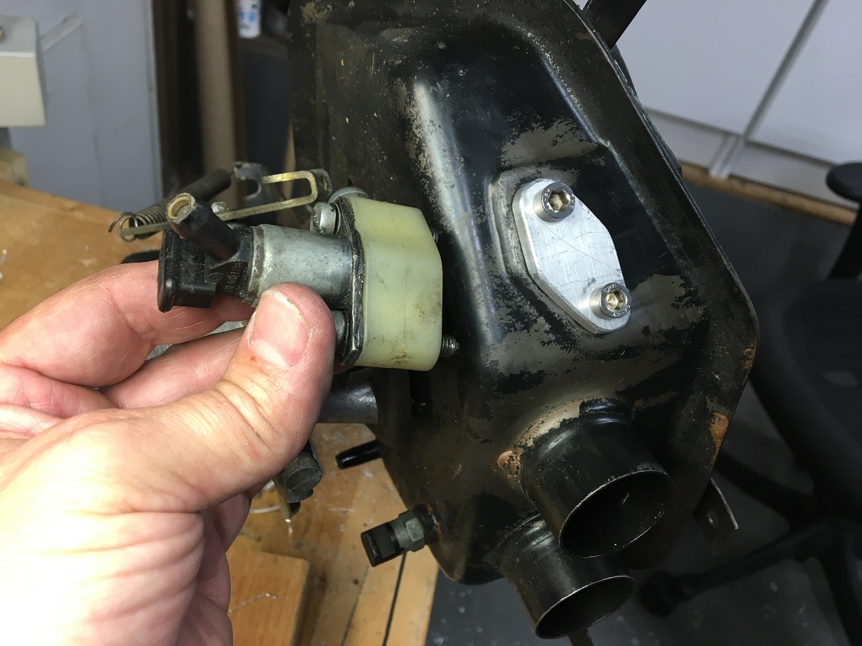

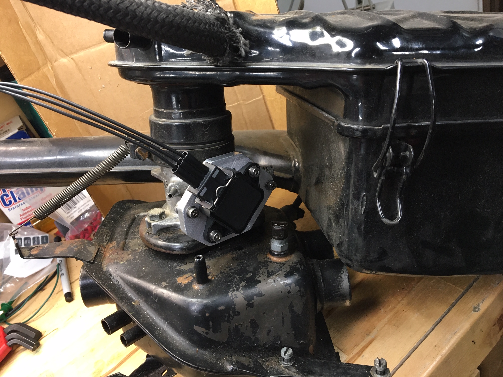

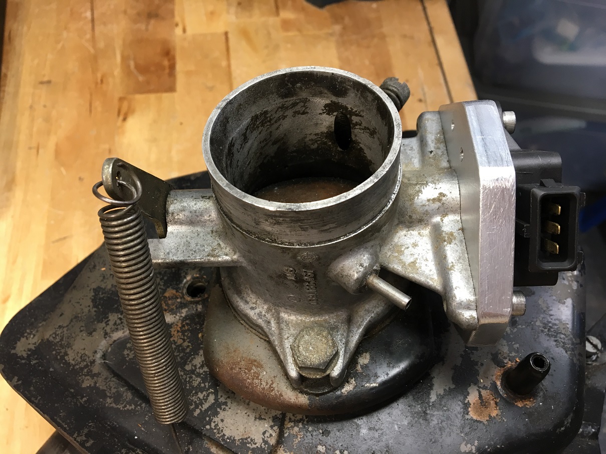

Throttle position switch compatible with the stock 914 throttle body with its 8mm D shape shaft.
