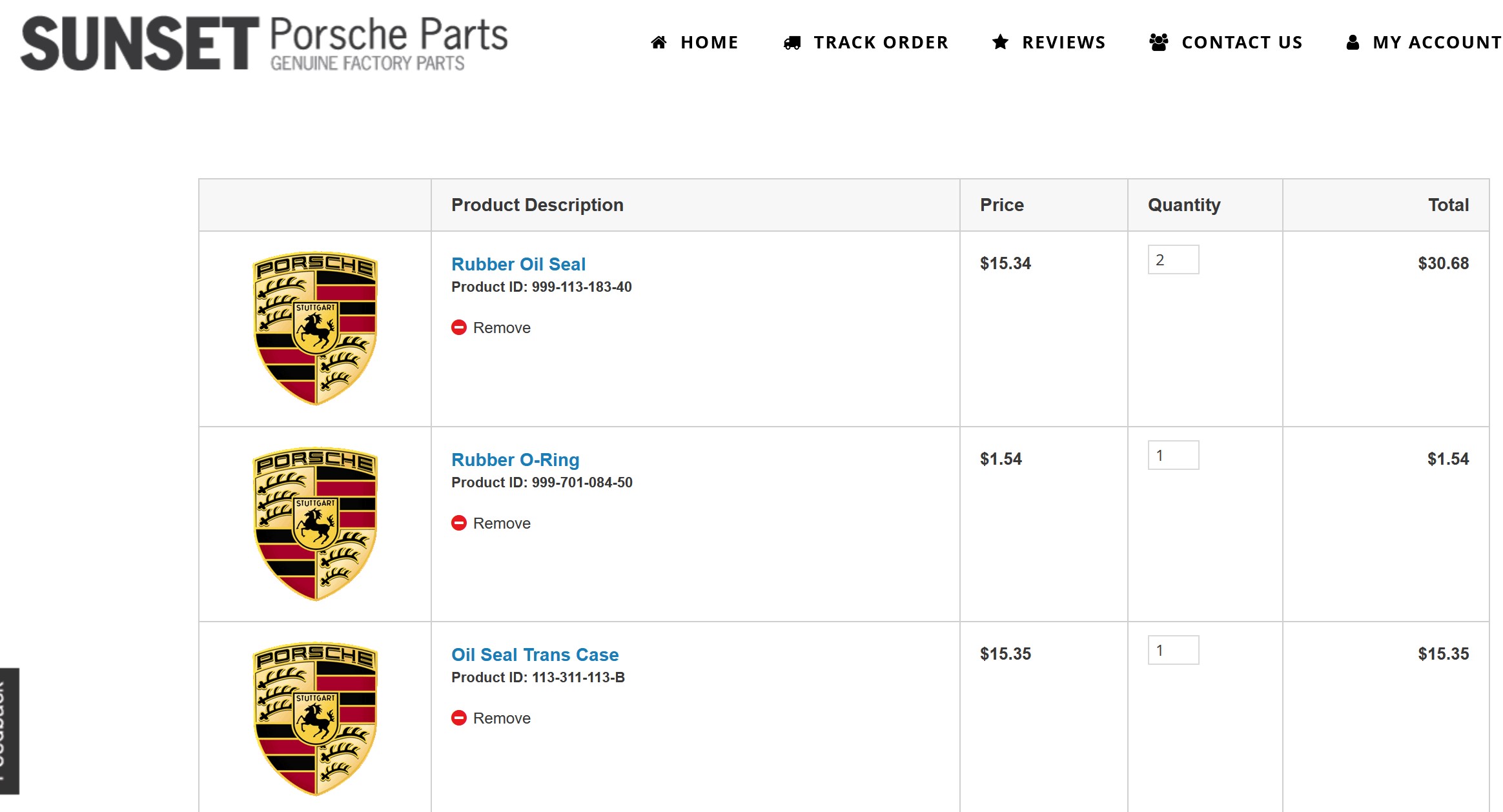

I looked at that Elring kit on the bird. The pic shows a complete gasket set for a complete rebuild. Since I only need the seals, I think I'm going with Genuine Porsche seals from Sunset. It winds up being a couple dollars more than the kit on the bird but doesn't leave me with a bunch of gaskets I'm not likely to use. Don't know if there is much quality difference but about the same $ out of my pocket and no left over parts to store and get ruined before I ever use them. Here's my shopping cart for Sunset with part numbers:
@AZBanks I'm assuming your 71 still has the tail shifter? Mine is side shift so I'm not sure there is a seal to replace, but someone please let me know if that's wrong so I can get that too.
Thanks all!
Thanks all!
