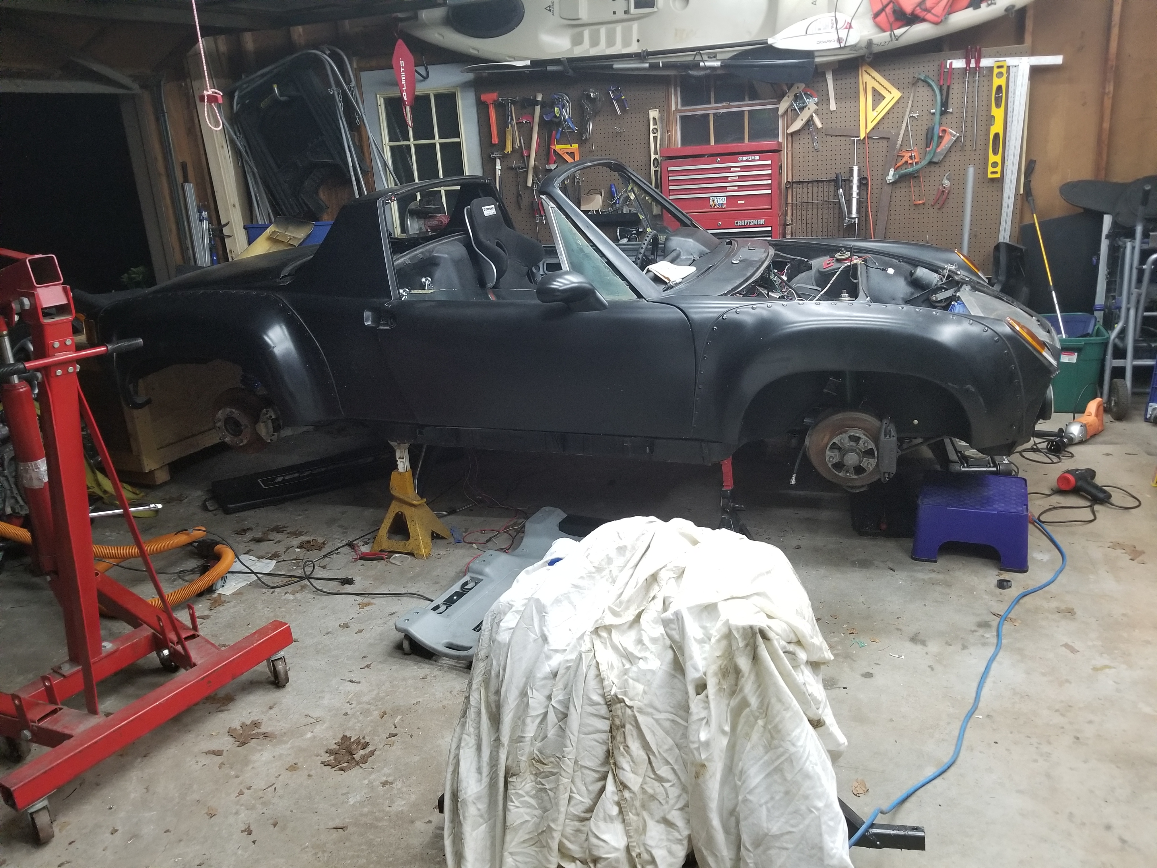

I have been gone for a few years. Transferred back and forth, ATL-OKC-ATL.
4 years in OKC, then a year on the road and then a year off working on fixing up the old homestead ,selling and then buying all over again.
Covid shut us in and somewhere along the line I gathered up my car, put back in my garage and stared at it for awhile.
Then brillance struck!!!! ?????? %^^&&$%^$^%^&%
Pull out the Suby turbo and start over!! Of course... Brillant.
Exorcised the ghosts, fresh plan, new parts, Blank slate.
Found a 4.8l truck motor cheap and rebuilt and customized for 914.
Found a boxster 6 speed and adapter set up here. ValcoOscar, Thank you.
BigKat filled in the blanks with 930 axles..
We have the tech, we can reebuild!!!!
greg d914

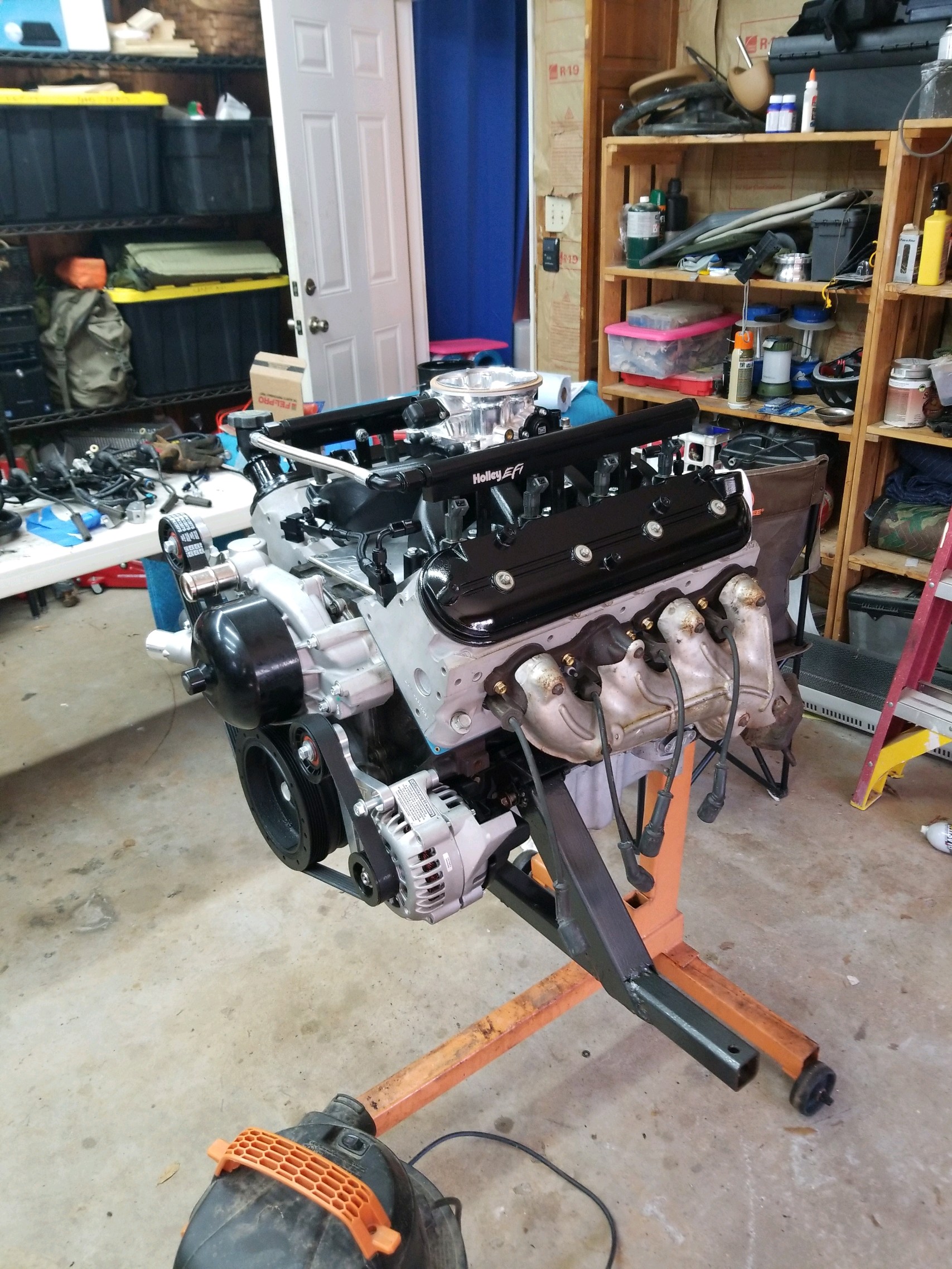

d914

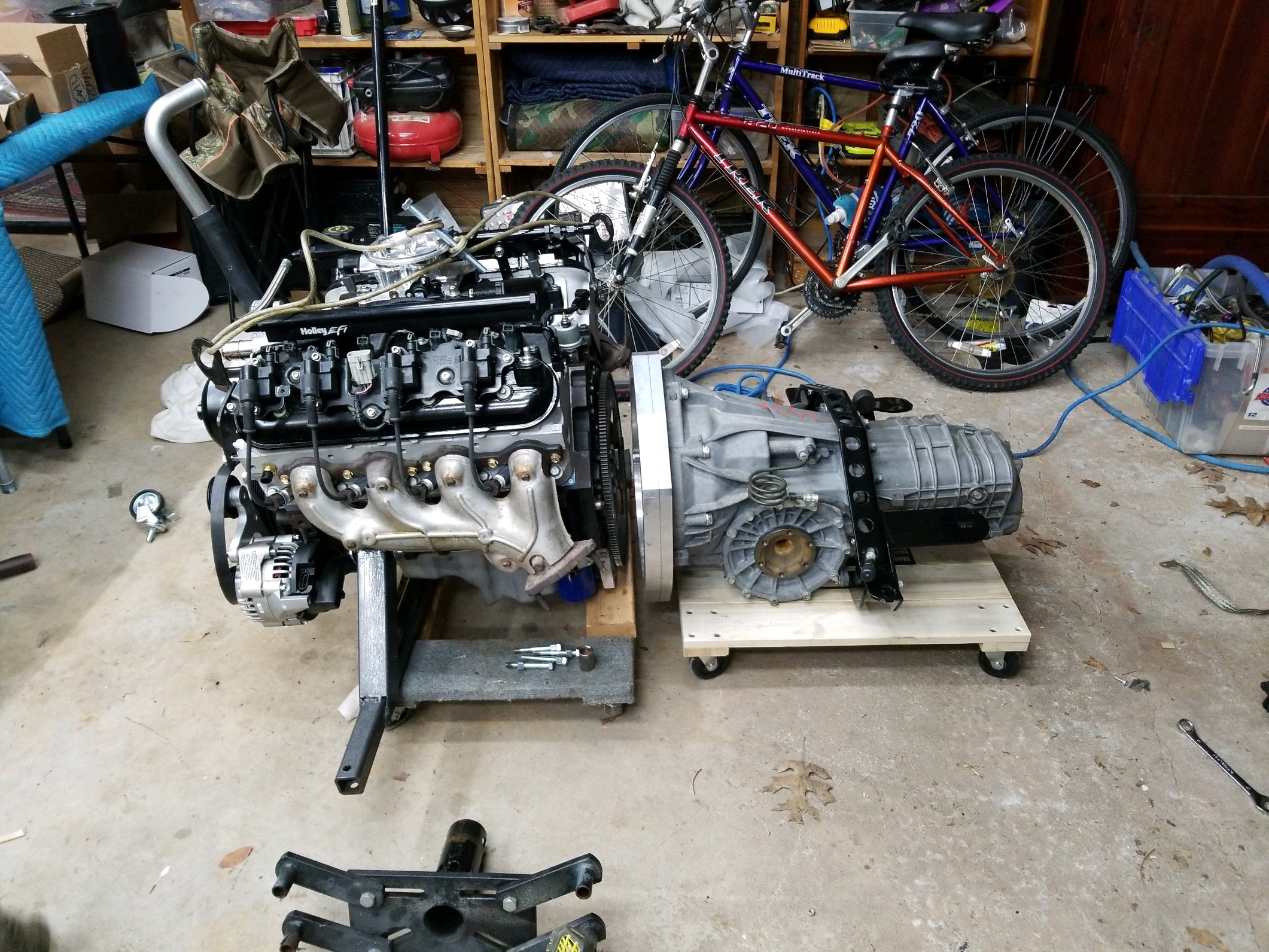

the engine and tranny.
4.8 l ls motor
holly intake, 4150 throttle body
swap oil pan
ict billet pulley sys for corvette
corvette water pump
renegade tranny mount

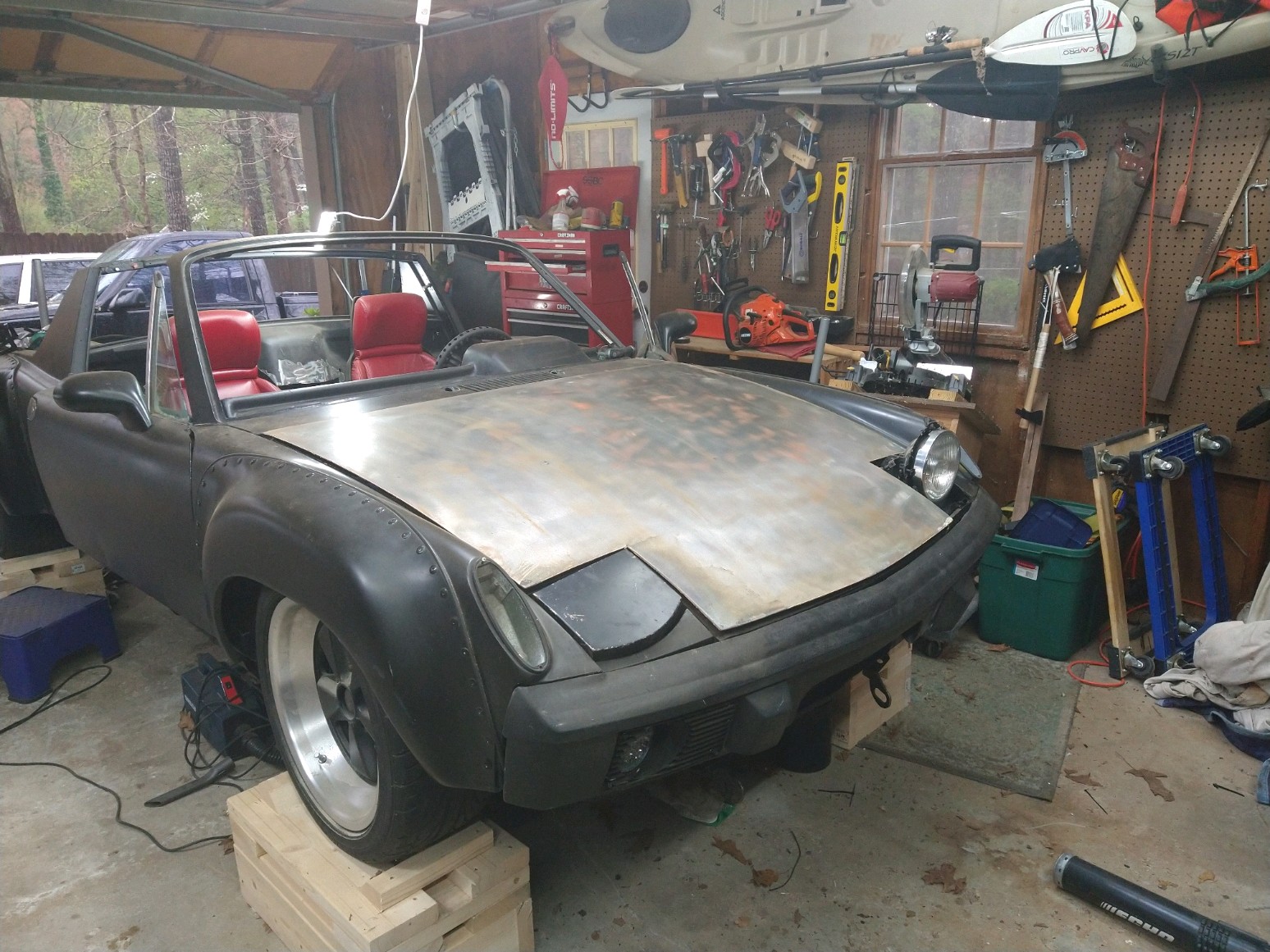

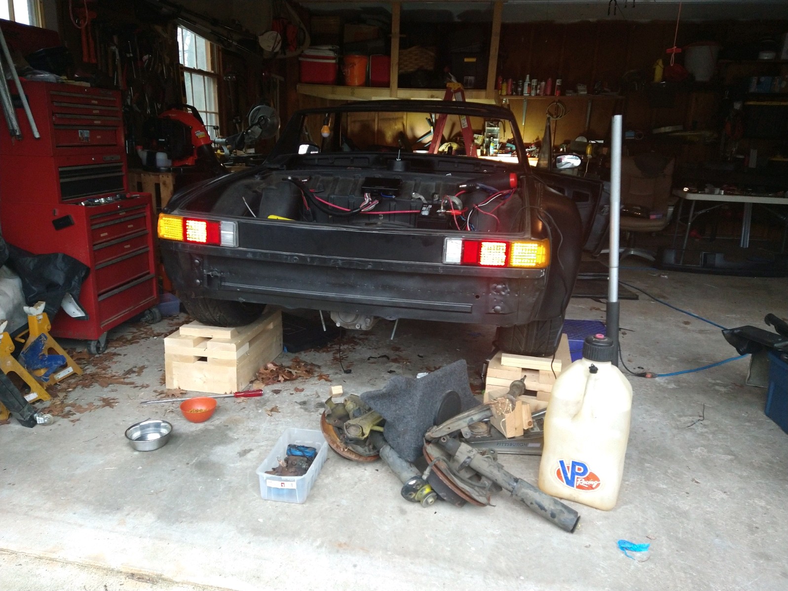

inner longs done
rear console from Tangerine Racing
reinforce suspension ears
raised spindles tangerine racing
elephant racing bearing on swing arm
mono ball on front struts and rear shocks
Delrin bushing from Tangerine
swing arm brackets from tangerine
Wilwood brakes front/911 rear
911 sway bar
for the street, c4 red leather buckets, three point set up.
oh and added a cam to the motor, sloppy 2/ with springs and upgraded rockers

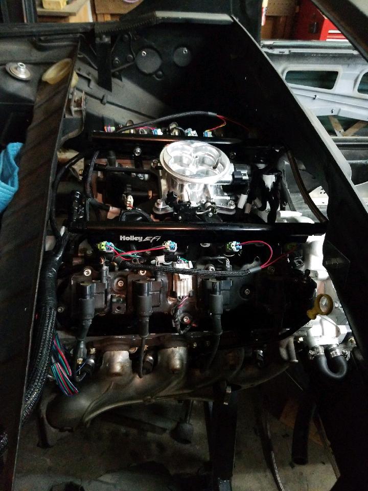

Holly intake, fuel rails and throttle body

Other wise making room for the engine, shifter cables and lots of little stuff. Need to take apart engine and tranny to install tranny pins and tighten up all the conversion plate bolts.

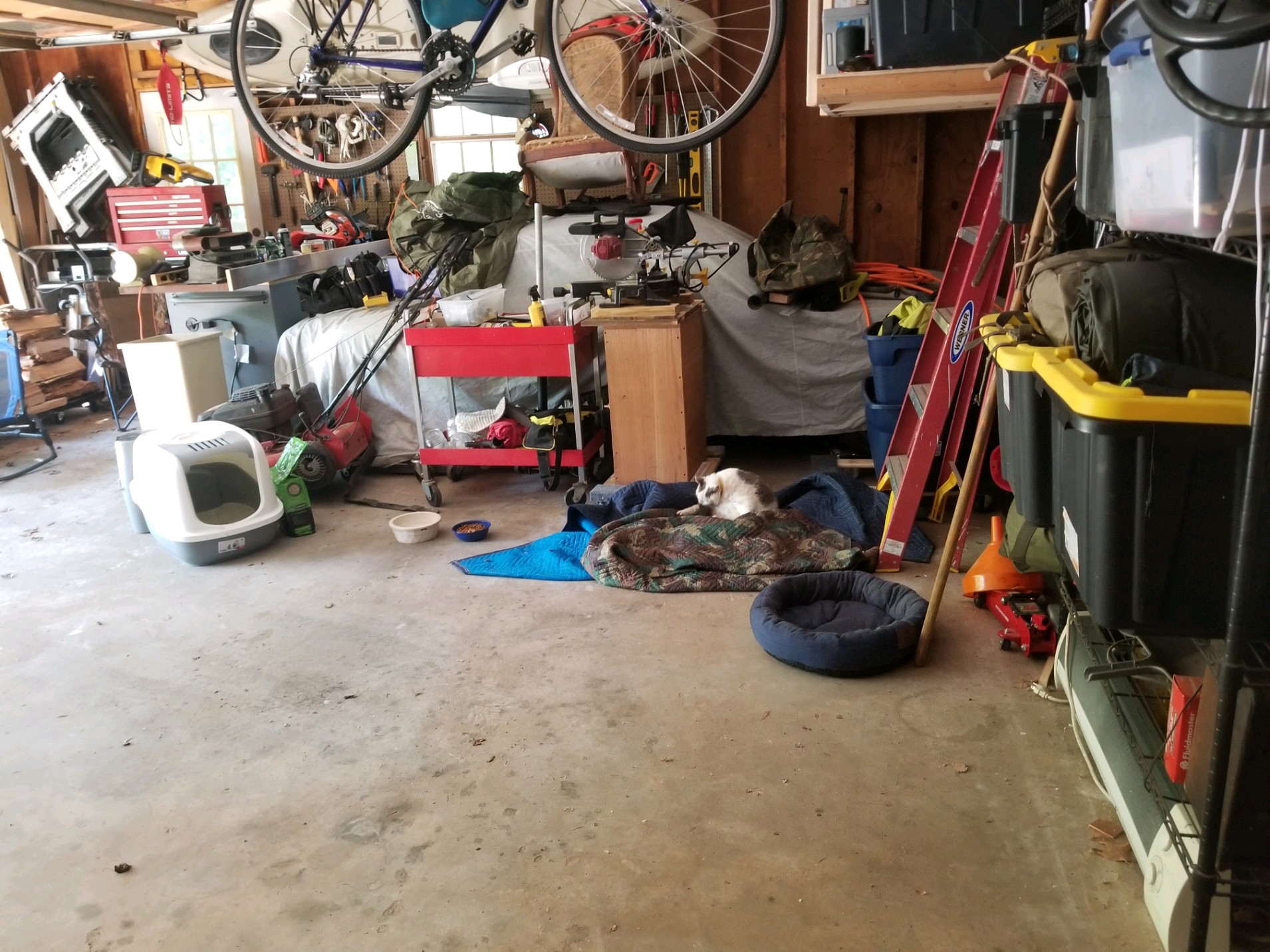

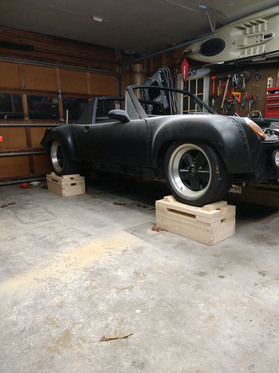

Killed off jack stands and built these
d914
d914
d914
Killed off jack stands and built these. ( sorry for the dups... internet was going crazy and haven figured out how to delete.
d914

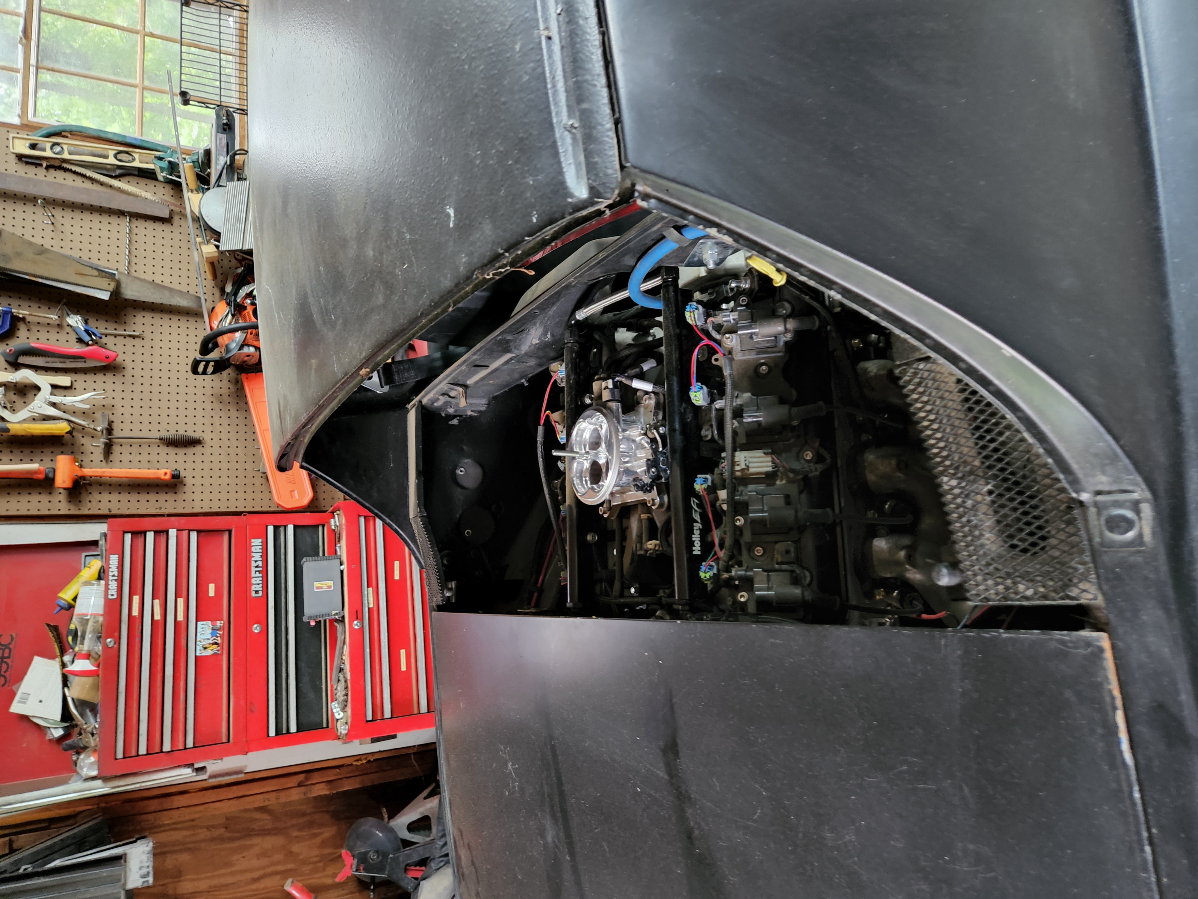

Engine in place
d914
I'm now going through the wiring I had to cut and figure out what wasnt finished from 5yrs ago!!!

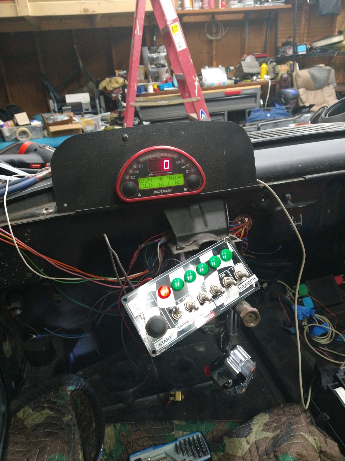

Digidash for my dash

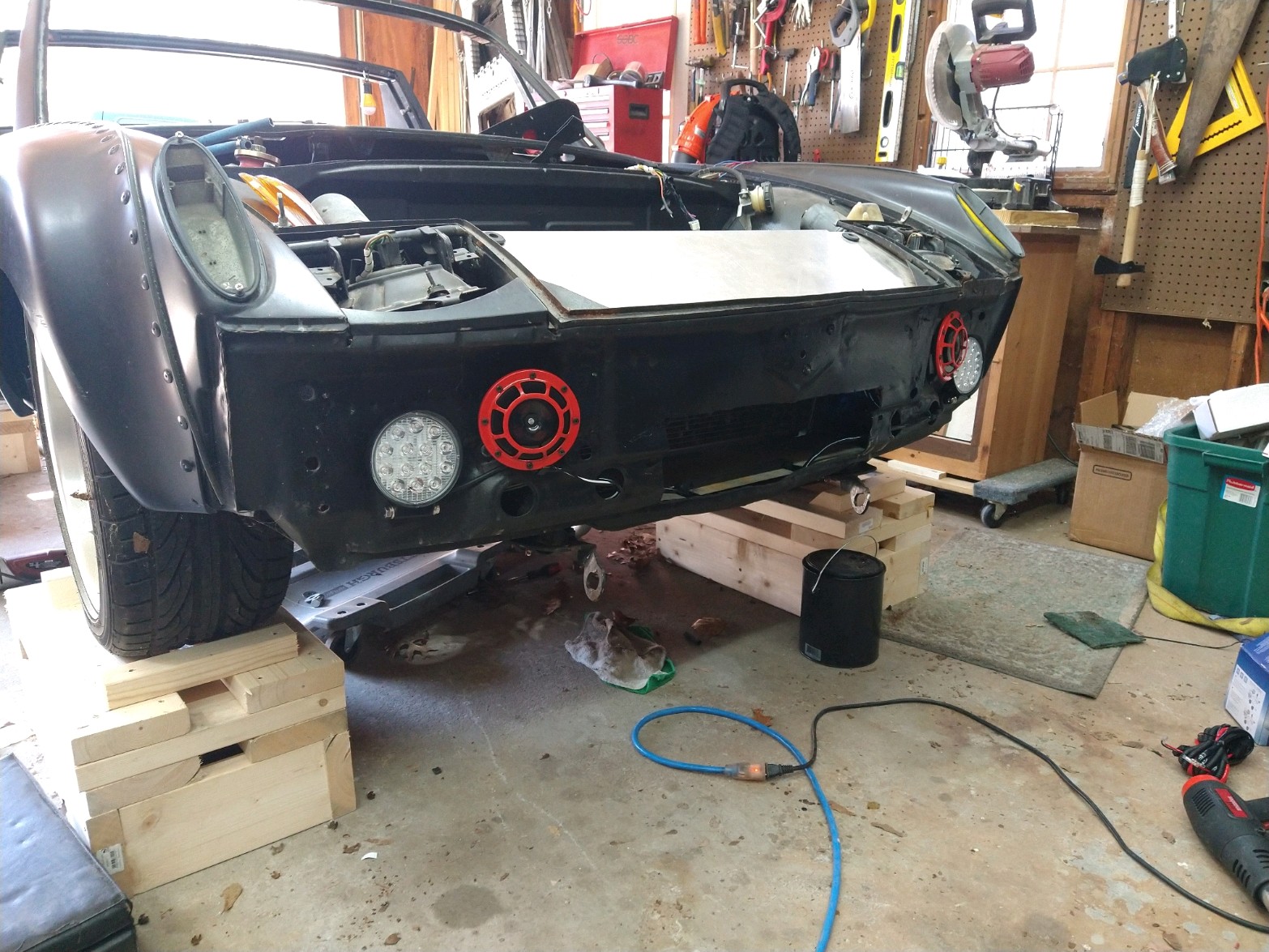

a wiring I will go!! Slowly but surely finishing all the wiring. Added new fog lamps, hella horns for a little protection and Firewall grommets to help with routing. I also need to cover up that hole. That was from my previous tranny!

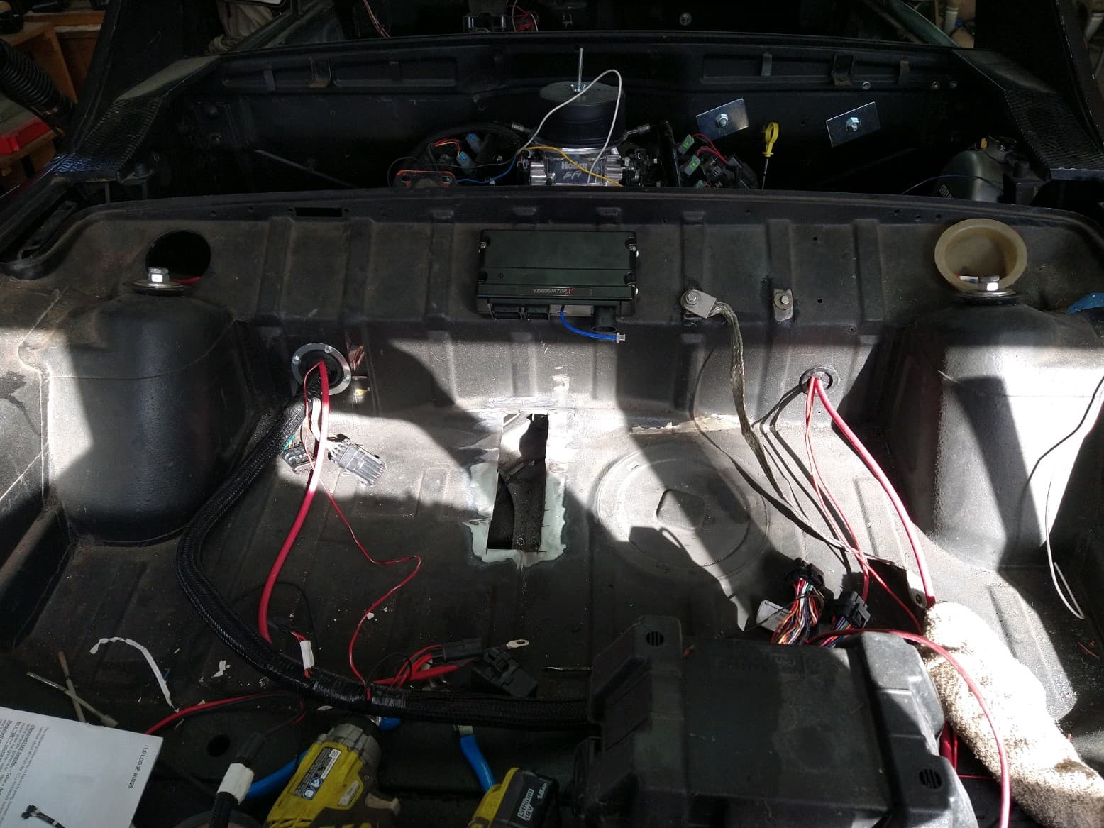

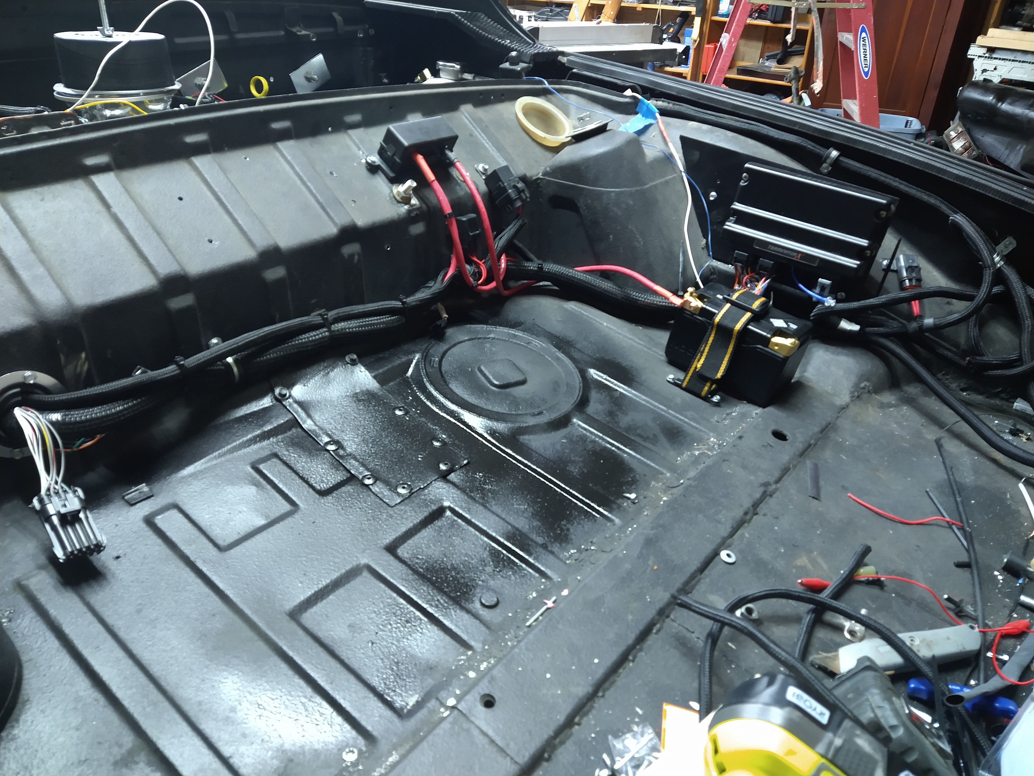

Making sausage! Arranging computer,relays and such as neat and efficient as possible. Making headway. Can't really finish until I fix that hole first.
d914
Cleaned and small re-design. Finished for now waiting final connections.

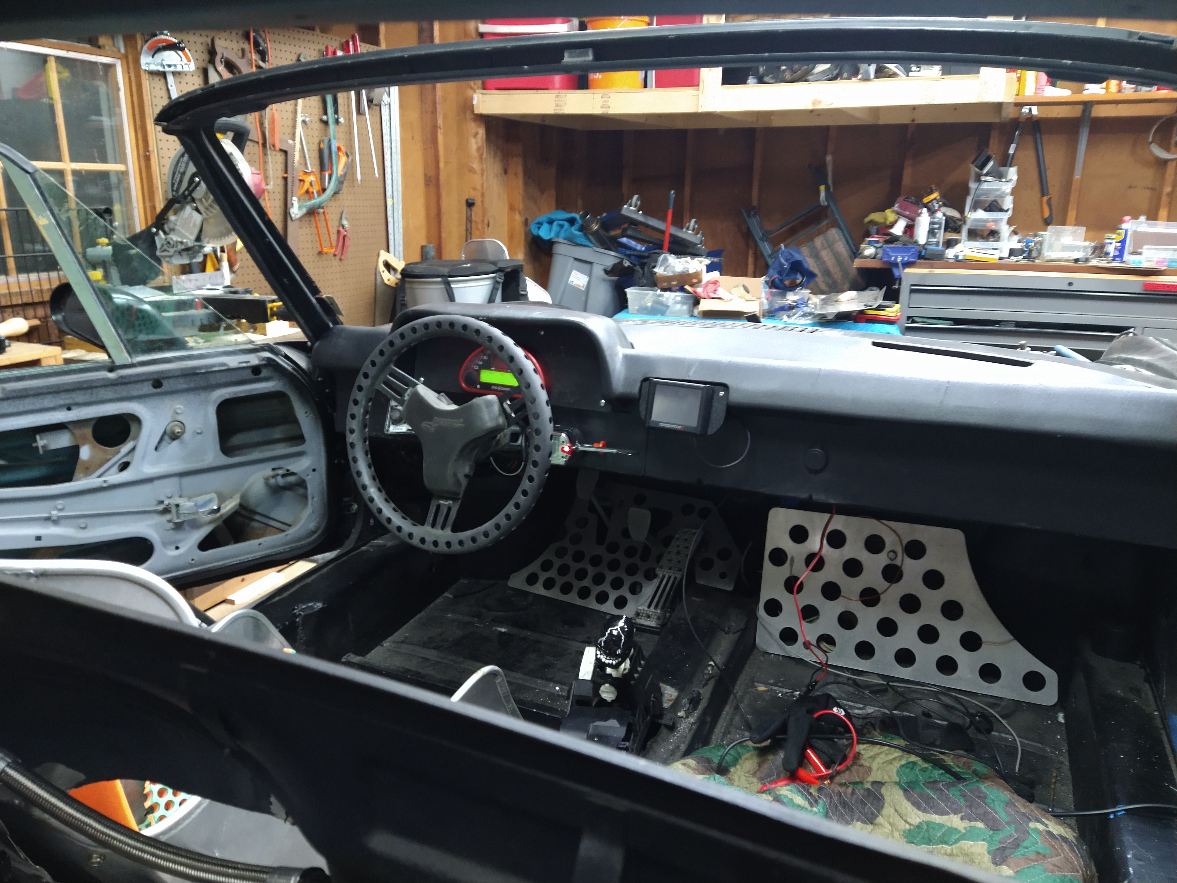

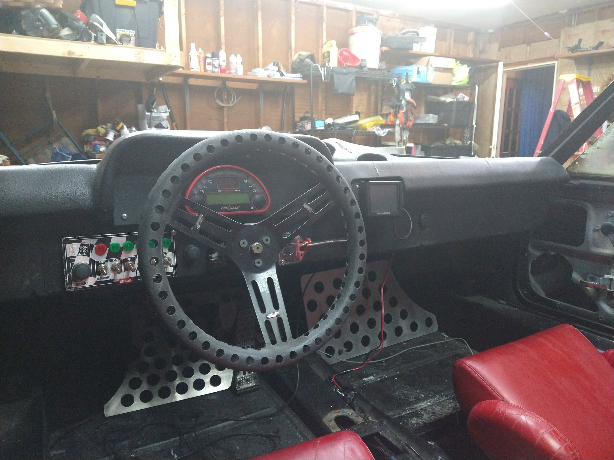

setting up dash.. added in the hand held for the Terminator-x.
The race is on. Retiring in June. It used to be joke on which got here first. Finish the car or retire!!!

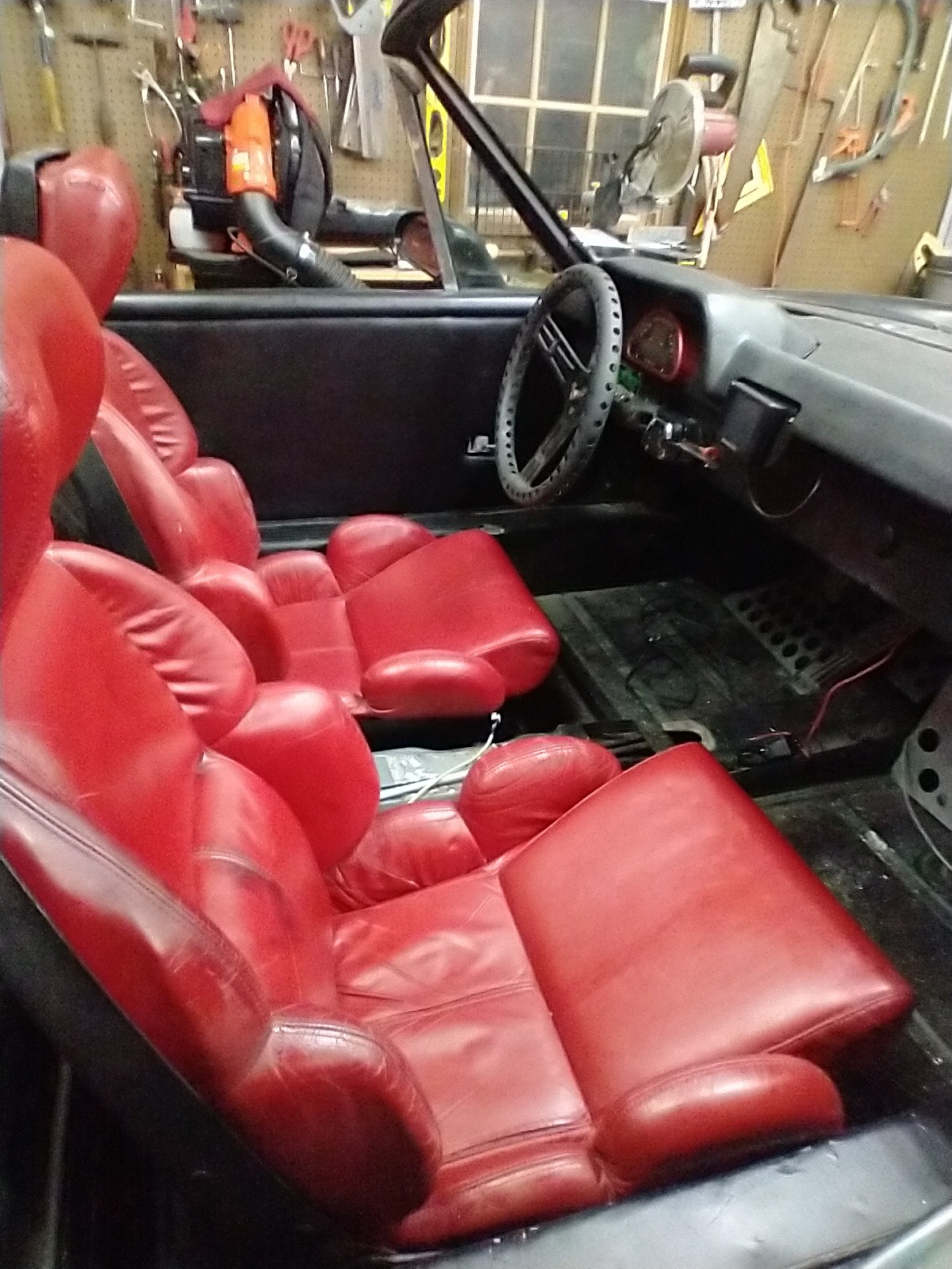

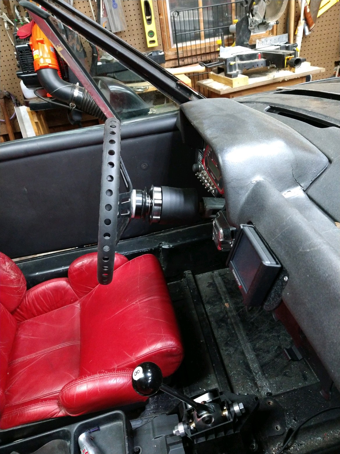

Using some old corvette seats for on the road, Comfy and a bit of flash. Test fitting some things

dash set up

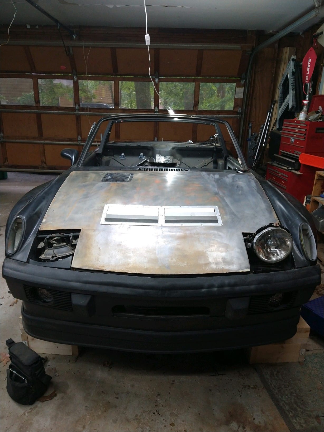

old has t go.. Too warped
d914

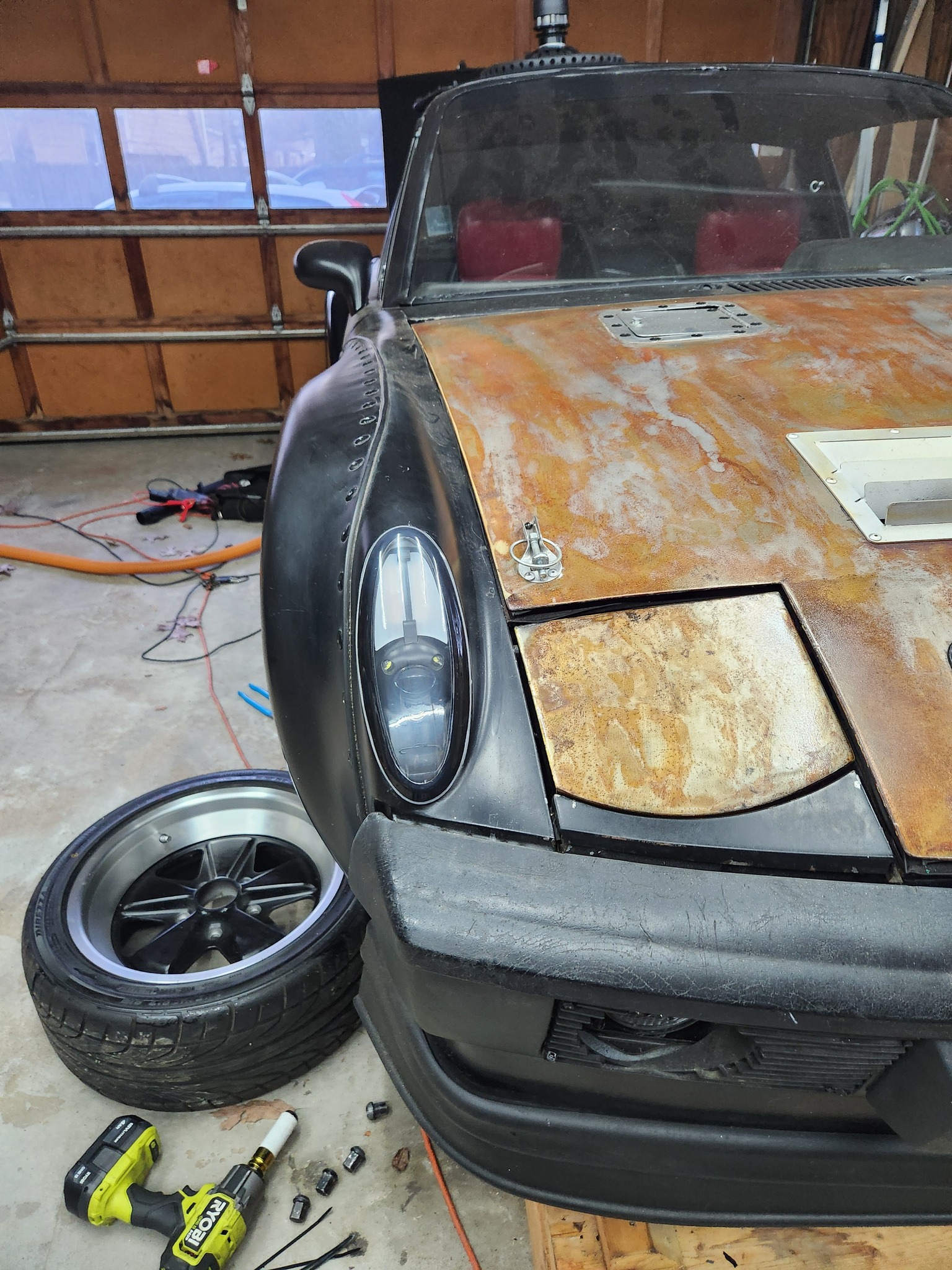

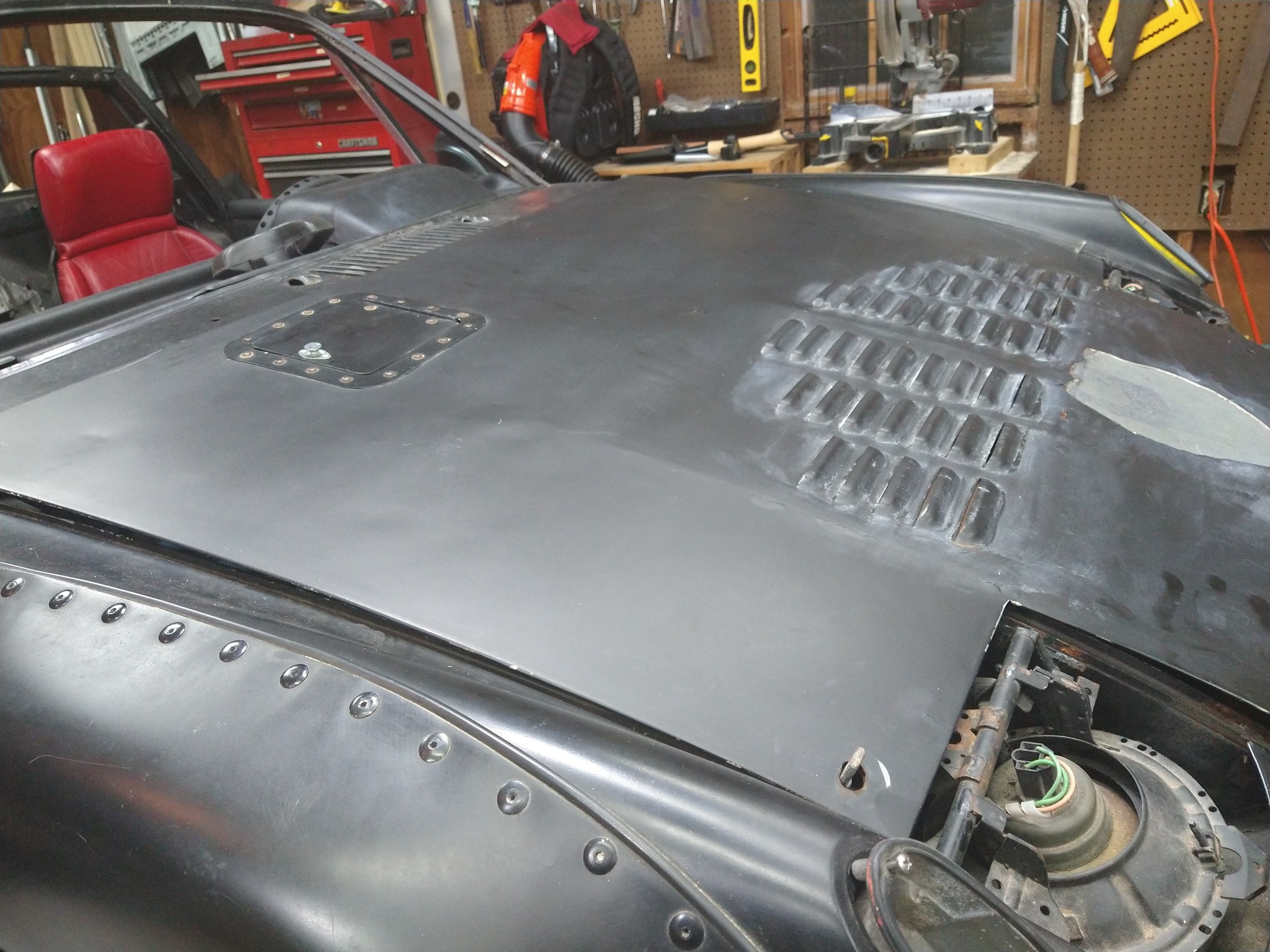

Fleshing out new one. Gas door, riveted louver this time( newer design) flush fit hood pins.
d914

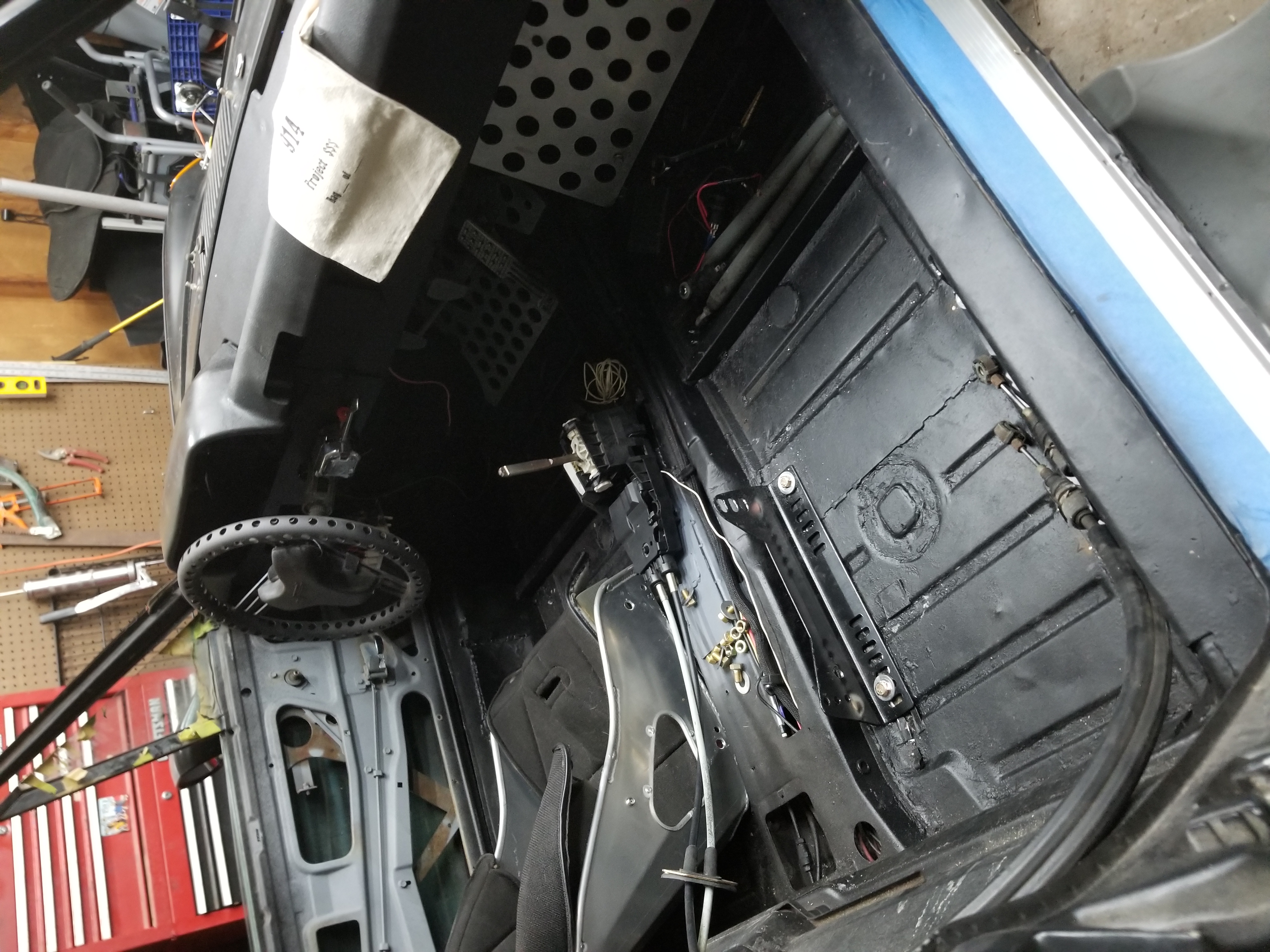

upgraded boxster shifter to ball bearing unit from uniwerks.
d914
new hood with gas door and louvers

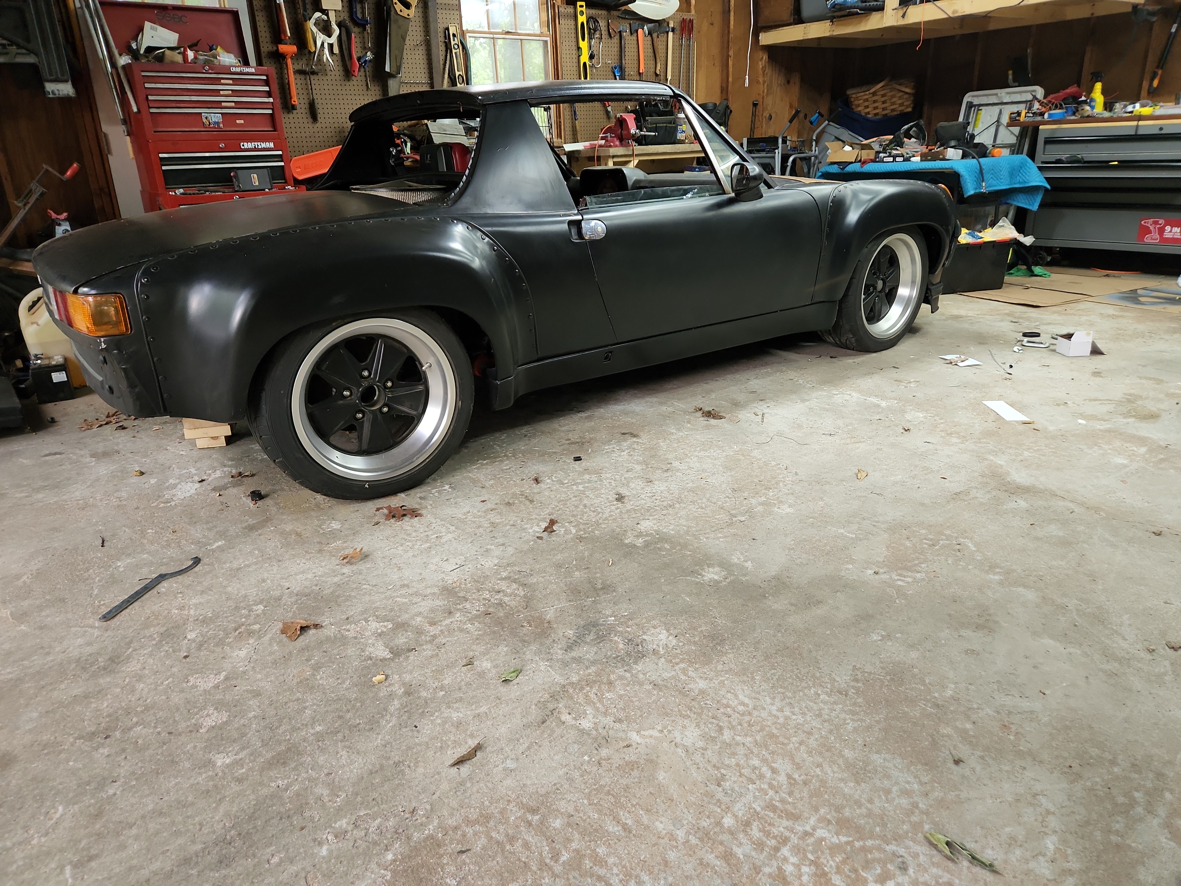

on the ground for a bit , final debugging new wiring. starting on the exhaust and final brake work.
d914
gratuitous shots and playing w patina for a bit.
mgp4591
[quote name='d914' date='Mar 2 2022, 05:58 PM' post='2985329']

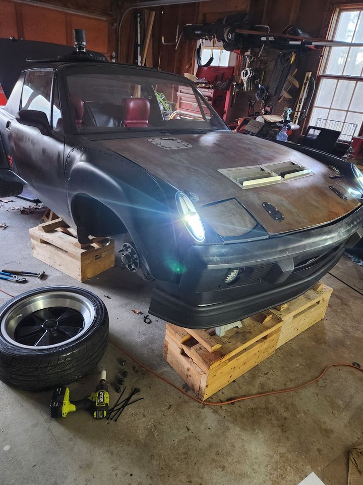

upgraded to full led lights.... fronts by 3dgauto!

Nice build! With Bigkat as a co-conspirator, you're in good hands.
Can you please share the source for the hood vent; i.e. source, part number, steel or aluminum?

https://racelouvers.com/center-hood-louver-...-rt-track-trim/

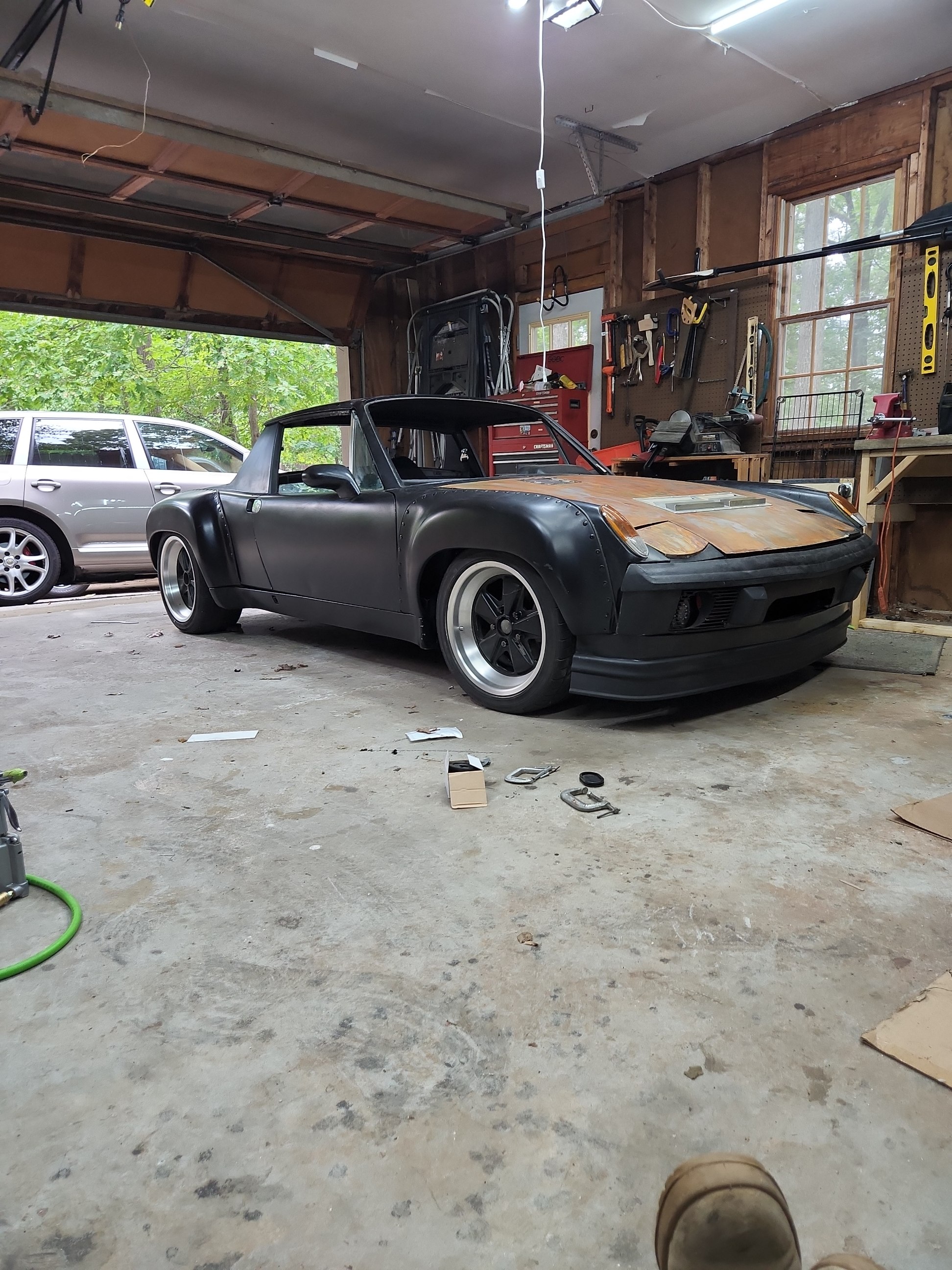

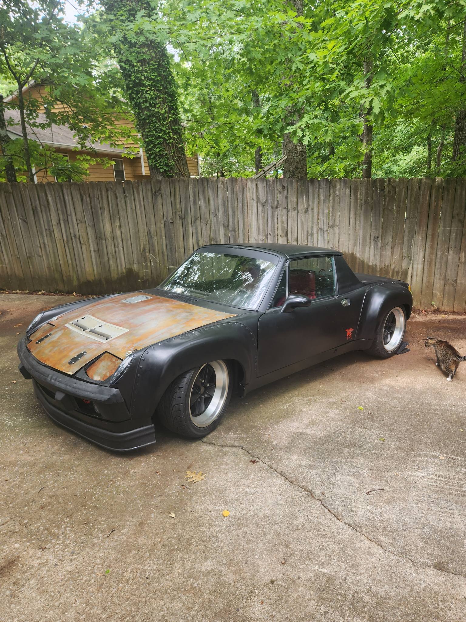

Finally got the car moving... Took it off to tuning.. 325 at rear wheels..
Now going through and fixing all the ugh ohs that I find from 18 years of building and various levels of skills. On my third pressure switch for brake lights!!! finally figured out how to test before new one goes in.
Bunch of little electrical issues.. I pulled a bunch of the looming re-doing things. Of course with the hand looming is a time consuming process!
Also nut and bolting make sure everything is tight and out of the way. Had to replace the boxster tranny, issues going into reverse. We are going to see what we might be able to do to fix????
Now thats it on the ground after all these years I need a hard hat!! I keep running my head into the open hood!!
Got to take it around the block a few times!! lots of fun.
