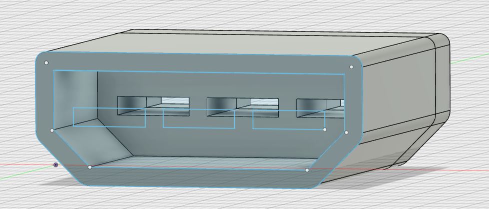

I began a 3D prototype drawing this evening
IPB Image
I continue tomorrow
I need some male pins items that I could put in the connector please

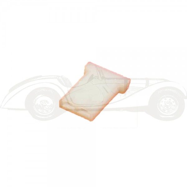

Male inserts here!

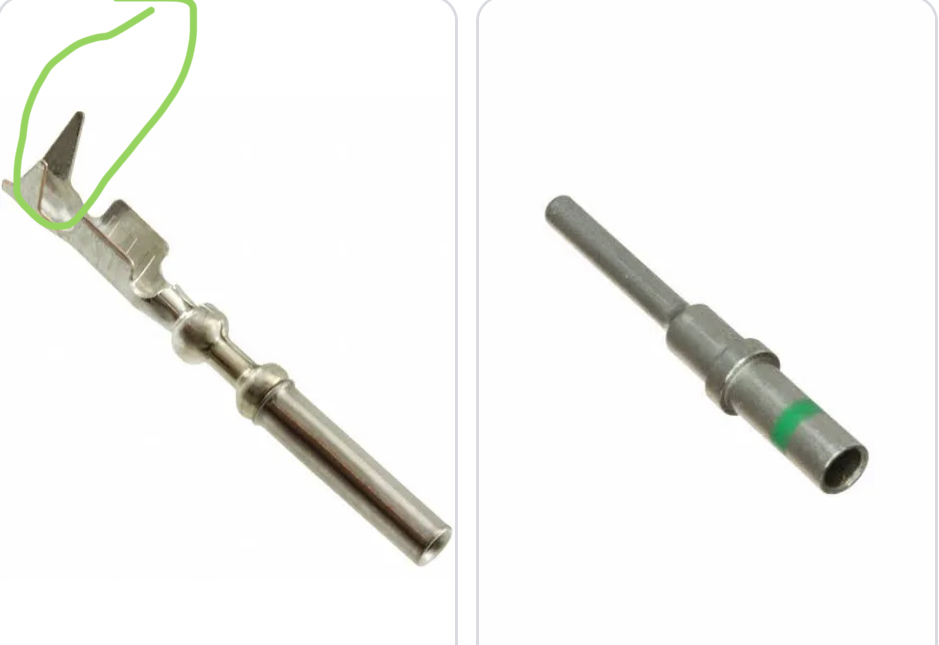

Superhawk996
Strain relief for individual pin circled in green.
the other style of Deutche cannon plug connector pin shown on right. These style pins have no strain relief but will be supported by the connector and/or a strain relief boot as it exits the multi-wire body (usually 25+ wires). These style “mil-spec” connectors are stupid expensive and still are not without their own problems.

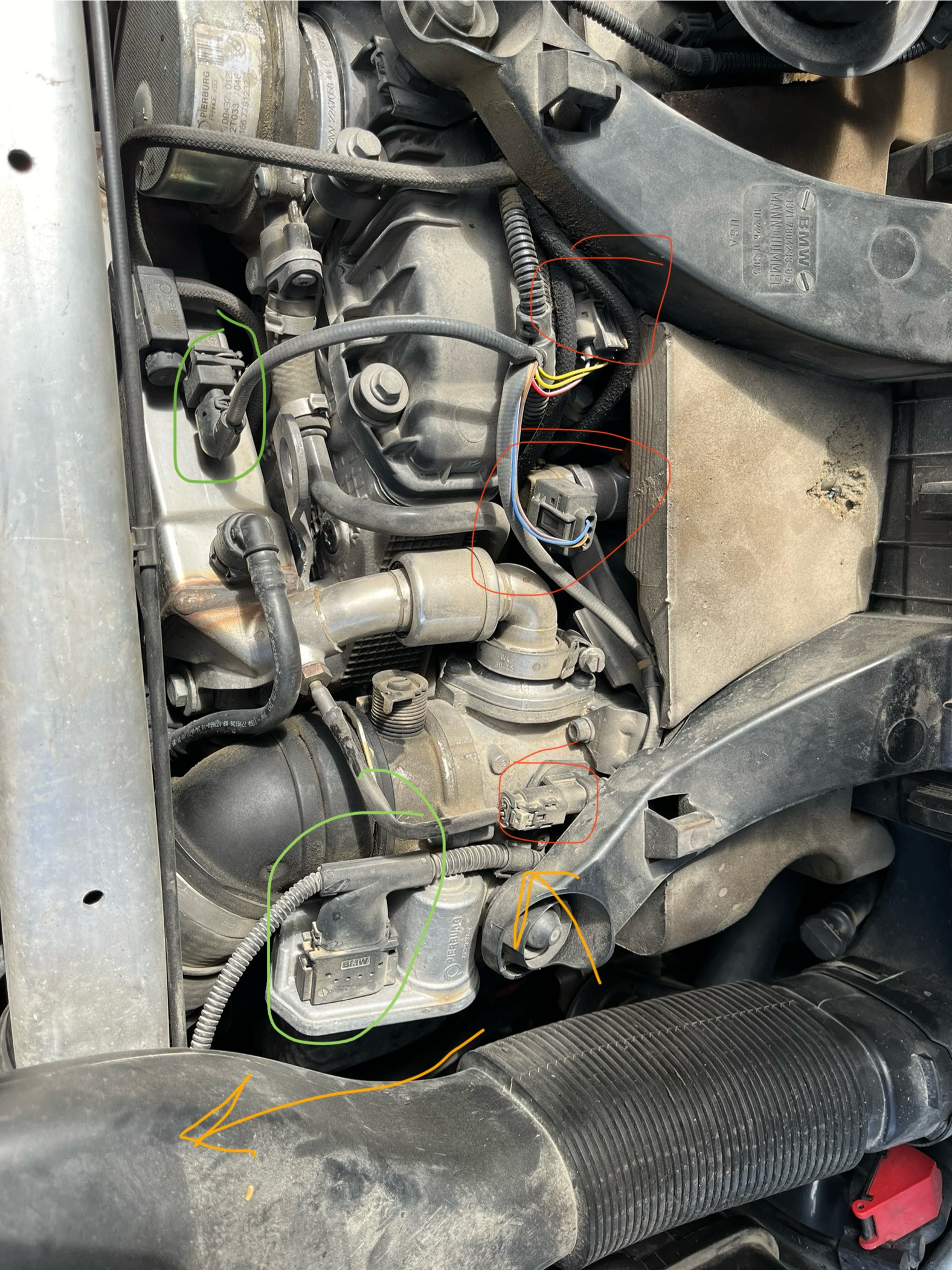

I’m going to post some under hood photos from four different OEMs varying across 20 years of production and with one vehicle that is 30+ years on-road and without issues related to wiring harness or this style of connectors. All these connections are exposed to high temps and potential fluid contamination.
I will also post a couple photos where a full boot is used as you propose. In the cases where a full boot is used, I’ll point out why it was used and the caveats that go with that execution.

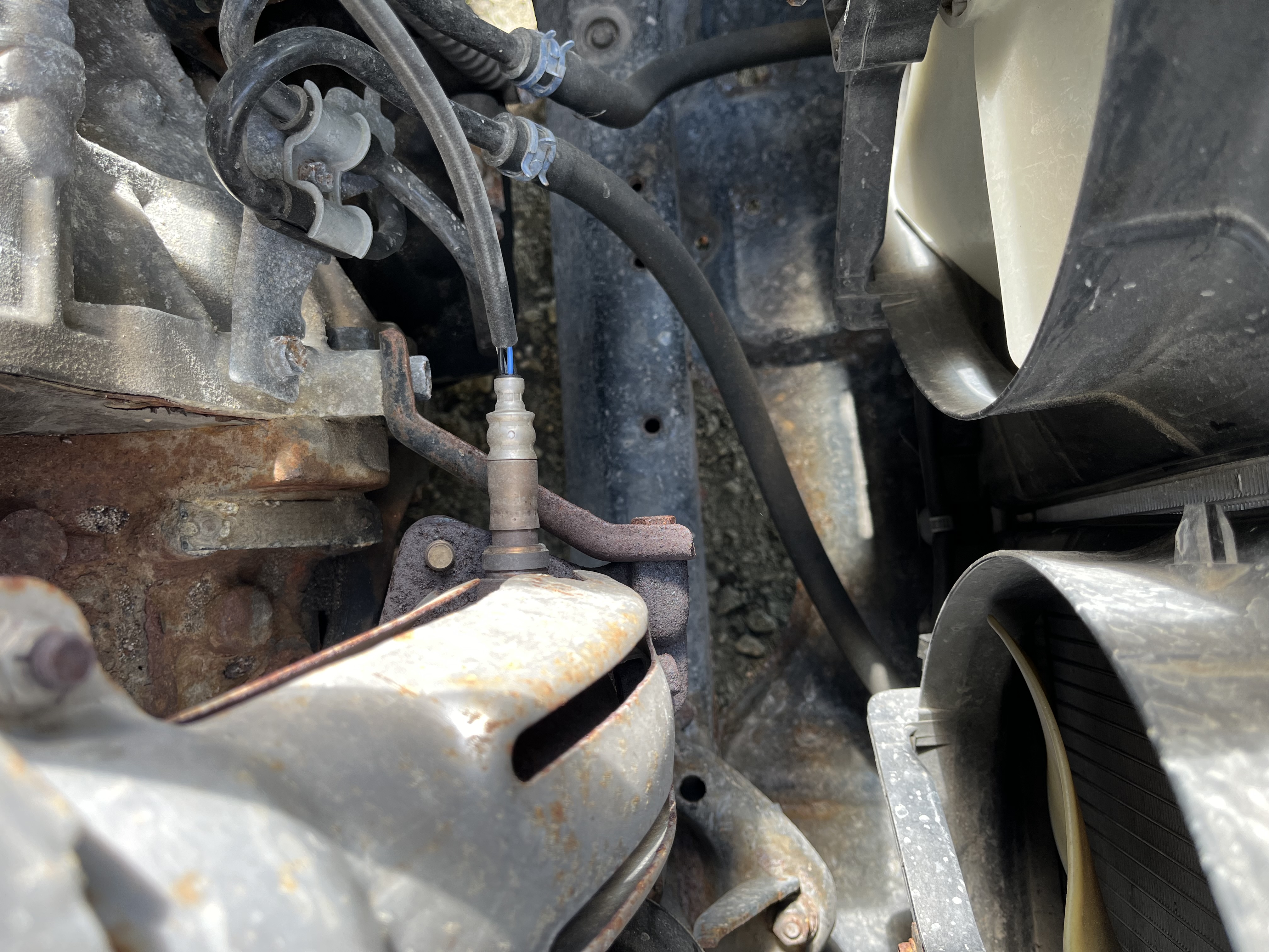

Superhawk996
Oxygen sensor - wires potted in sensor but no boot or strain relief required.
Note: emissions systems are mandated to be warranted by OEM 10 years, 100k miles. Emissions systems are not places that OEMs scrimp on due to the warranty risk as well as risk of widespread compliance recalls.

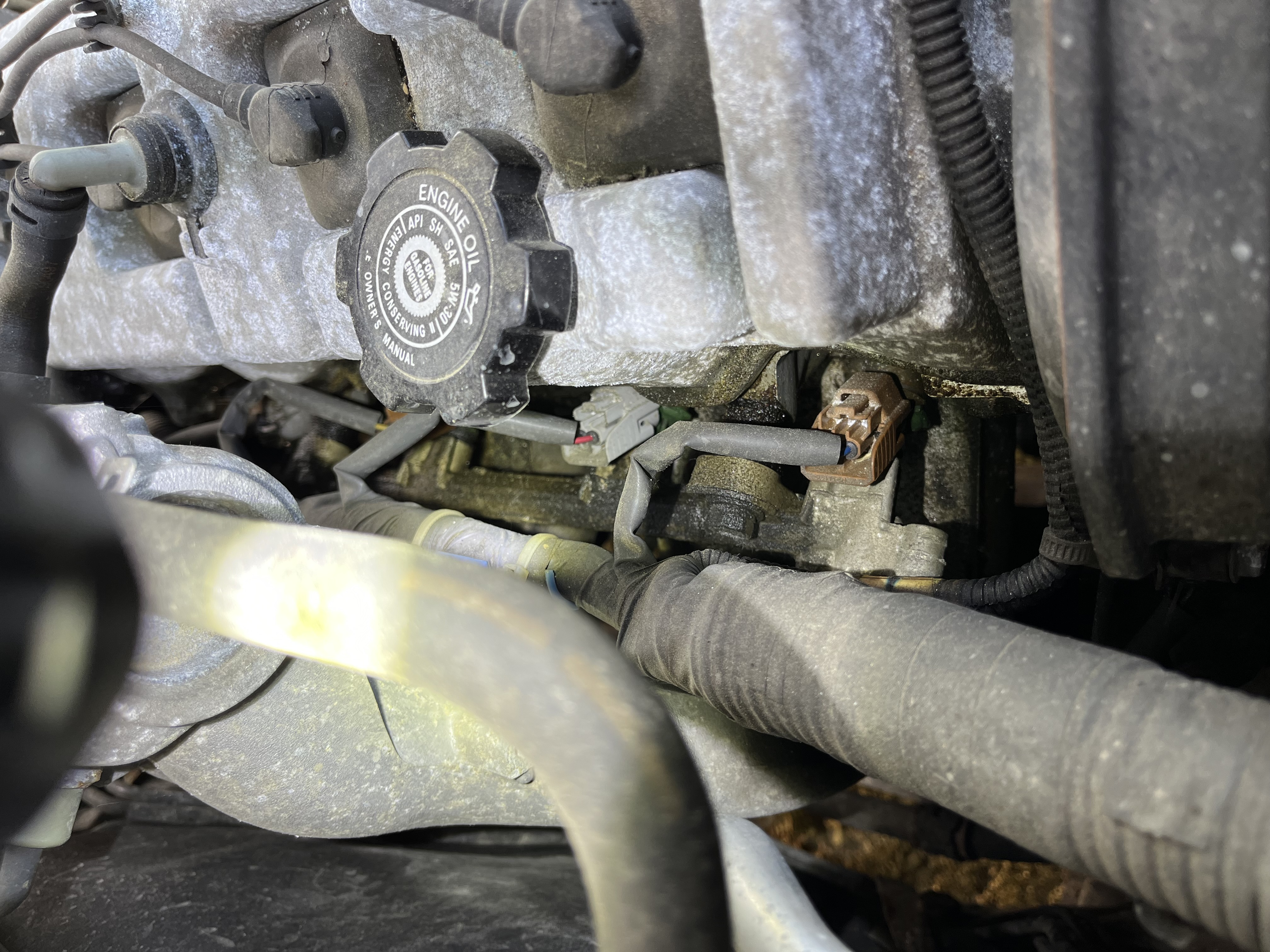

Superhawk996
2012 BMW - 138k miles
Note the varying use - standard connections on non-emissions, non safety components.
There is a boot used on the EGR cooler. An emissions related component. The throttle stepper motor also has a boot because the throttle motor is a safety component. When a boot like this is used, the wiring must be secured nearby to ensure the boot isn’t supporting the wiring which will tend to cause intermittent connectivity issues and/or pin pullout. The wiring for the throttle motor is secured at the locations of the orange arrows to help mitigate those risks.

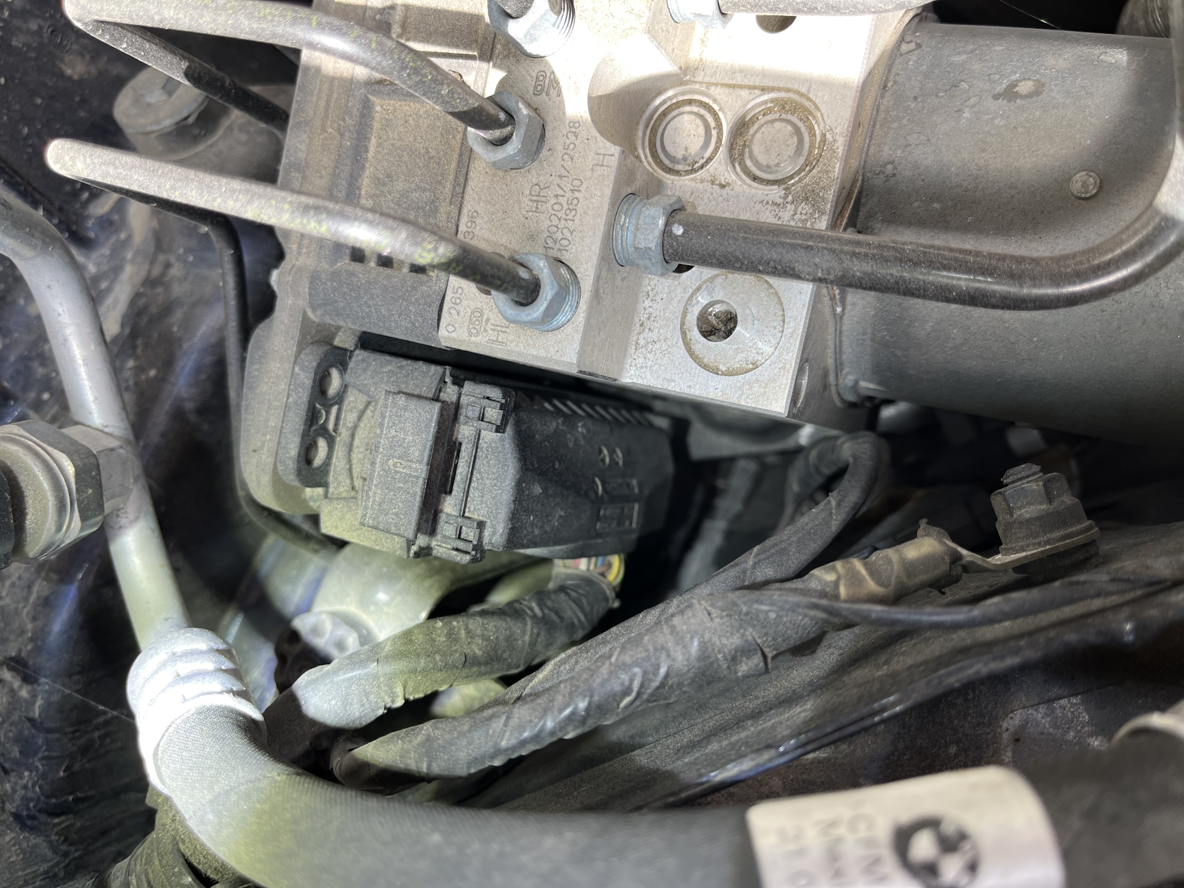

2012 BMW ABS module - safety component
Gets a hard back shell due to tight bend radius on a large bundle of wires that could otherwise not make that bend without stressing the pins.

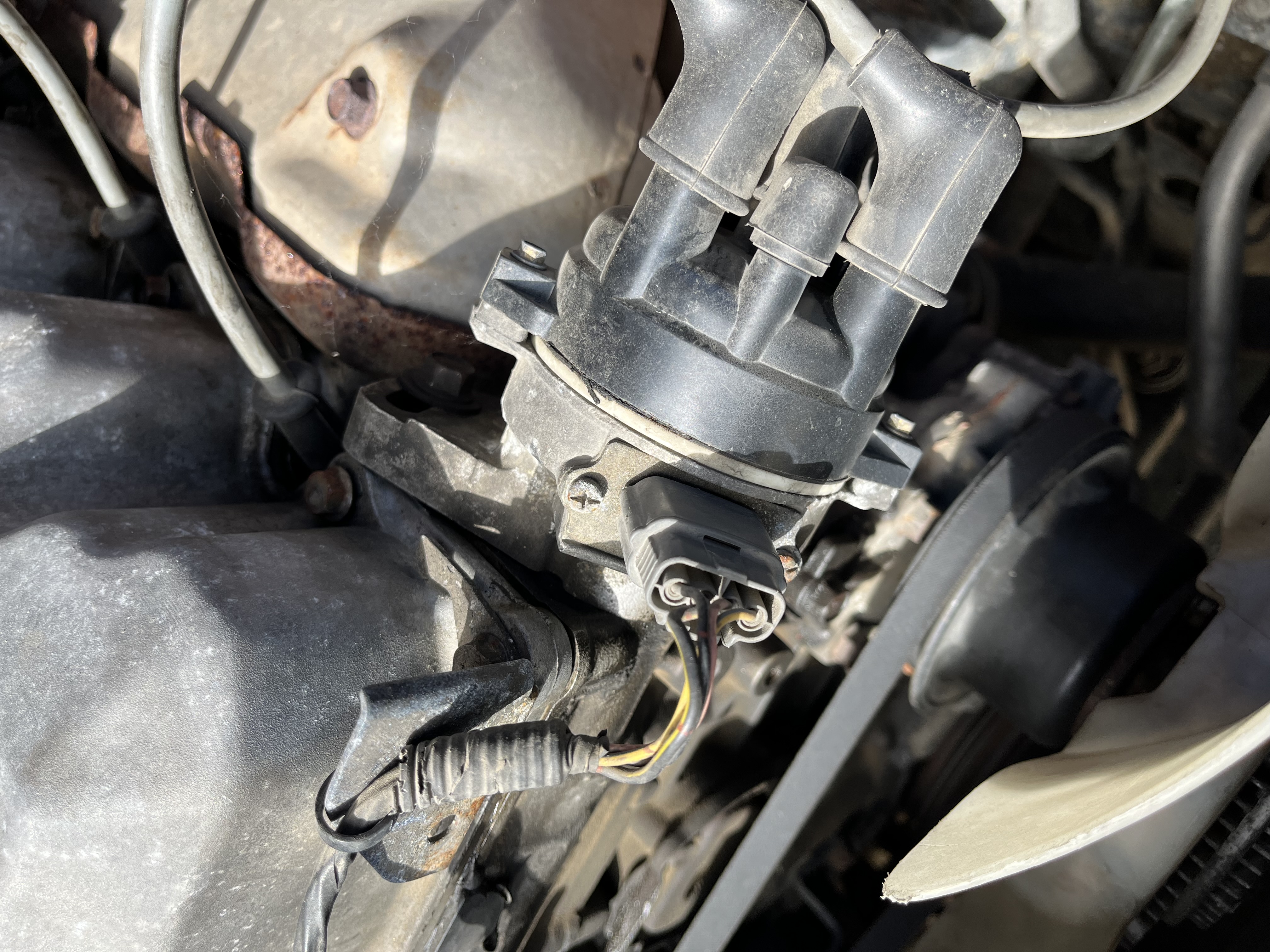

1992 Mazda B2600 - 178k miles
Distributor - no work, no go. You can be sure the Japanese would have used a more robust connector if it was necessary. Click to view attachment

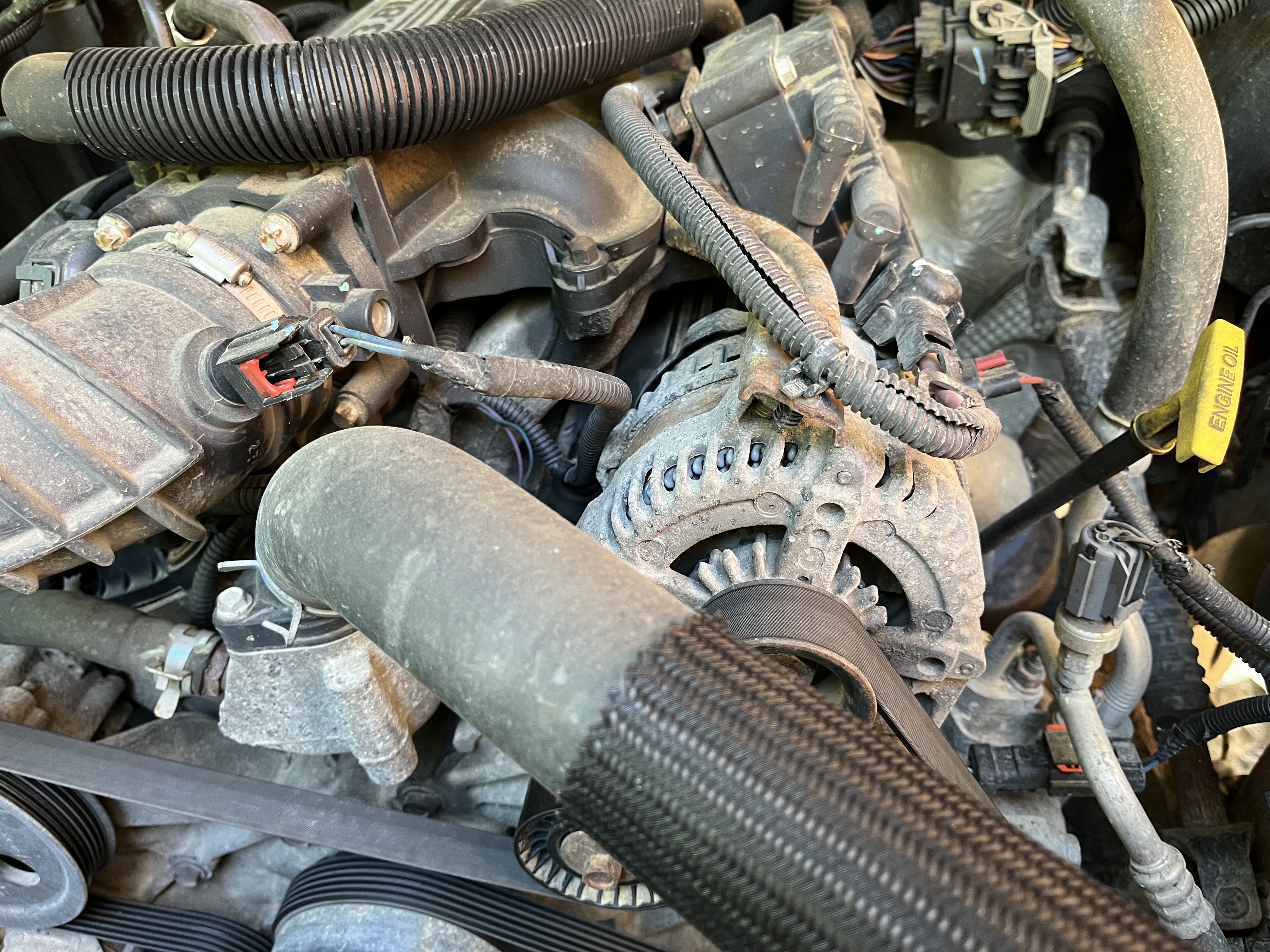

2009 Jeep Wranger. 90k miles.
Again - plastic cap used over alternator B+ for short protection
Lots of connectors including large multipin that use standard weather pack, Deutche type connectors.
These are all under hood but the same connectors are also used in the underbody in wet locations subject to water fording requirements

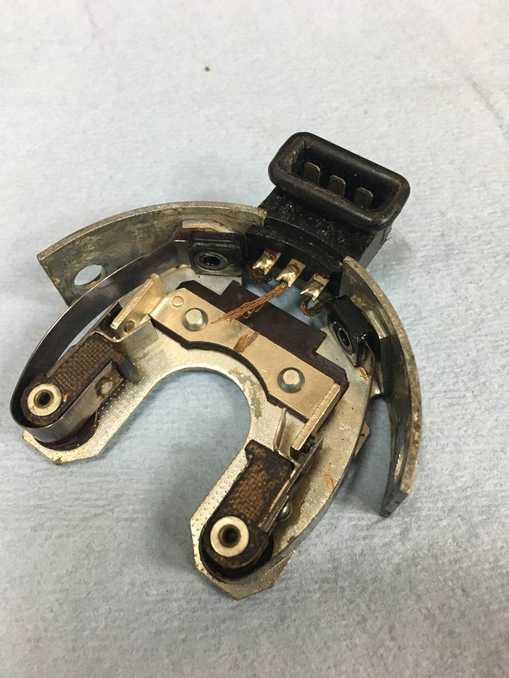

ClayPerrine
Seems to be LOTS of replies to this thread, but no one seems to see the forest for the trees.
That connector is on the old D-Jet trigger points. It would seem that salvaging the connector off a junk set of trigger points would be a simple solution.
Or am I missing something here?????
FlacaProductions
Correct - but it's molded funny, no? Strange angle...

ClayPerrine
QUOTE(Superhawk996 @ Jun 21 2024, 07:38 AM) *
QUOTE(ClayPerrine @ Jun 20 2024, 03:47 PM) *
Seems reasonable . . . But
Pulling this connector off a set of triggger points, soldering 123 dizzy leads to it, and then having non-locking spade connections and rubber boot on this isn’t going to be anywhere near as robust as converting to a Deutche connector.
I don't have a 123 distributor, but I could see taking it apart and adding this to the side of it instead of just having wires come out of it.

QUOTE(JeffBowlsby @ Jun 26 2024, 08:53 PM) *
The parts I ordered arrived, see mockup below.
The new housing and male wire terminals are standard items and available.
The 3-pole male housing on all D-Jet FI harnesses for the trigger points, simply inserts into this new female housing with its retention clips, which will attach to the 123. The boot on the FI harness slips over the mating joint to make a relatively weathertight connection. Plug N Play.
I figure the 2 wires on the 123 could be individually wrapped with heat shrink for 2 inches where they enter the new housing on the side of the connection facing the 123, and then combined into a slightly larger single casing piece for the few inches the branch needs to get back into the 123. This casing provides protection from heat, fluids and added strain relief (in addition to the strain relief located at the terminals).
The metal fitting on the 123 where the two wires emanate, appears to be a compression fitting with a rubber gasket around the wires but someone please confirm. If that's true it may be possible to insert the outer casing under this compression nut (or possibly on the outside of it with a heat shrink collar) for a secure connection. To minimize fracturing this short branch at the compression fitting, maybe the branch gets wrapped in an outer stainless steel braided sleeve to up under that compression nut (or over it with a heat shrink collar) to make it more durable.
Comments?
That looks like an elegant solution! I'm happy to bring you my NIB 123 distributor to try this out on if you don't already have one to play with.
JeffBowlsby
Sounds good Broheen, contact me directly and we'll work something out.
Anyone else interested in this solution?
gonzo54
QUOTE(JeffBowlsby @ Jun 27 2024, 03:09 PM) *
Jeff, when you come up with the tried and tested connector I would like to purchase one for my 123 Bluetooth
Thanks for your R&D

JeffBowlsby
Rick, Brian, Jim,
Ill be meeting with Fiacra to do a prototype build then will reach out to you for yours. Thanks for your interest. This wiring connection seems to be a significant issue with the 123s, but is resolvable.

Quinn Moore
QUOTE(JeffBowlsby @ Jul 1 2024, 12:32 PM) *
Rick, Brian, Jim,
@gonzo54
@FlacaProductions
@Jim C
I'm interested as well, been thinking about swapping to the 123.

JamesM
QUOTE(JeffBowlsby @ Jun 26 2024, 07:53 PM) *
Comments?
Part numbers? Source?
