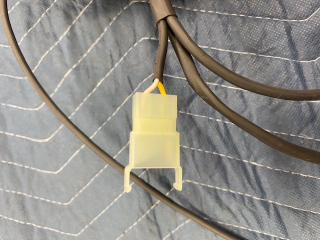

Been trying to figure out what the best way to proceed is, to keep the total cost to you a minimum. The connector parts are not expensive and I have a 5 sets in my possession, can easily get more. The work involves cutting the wires to length, mounting the wire terminals, wrapping the wires with heat shrink (3 pieces). Which means you need a crimper and heat gun, tools you may not have. The tools probably cost $50-75$ together.
Unless you have better ideas I think the options are below, none of which I see as particularly cost efficient all things considered:
1. You send me your dist, I mount the plug, heat shrink the wires and ship it back to you. Parts & labor is probably $25., plus shipping costs both ways which is expensive these days.
2. I post the part numbers and sources, and you buy the parts, do the work your self. You need the tools and incur shipping charge minimums for small order parts. You also need 3 short lengths of heat shrink, which no one sells in that quantity, meaning you would need to buy a larger quantity that you may not need.
3. I assemble kits of the parts and sell them to you ($10. shipped) but you will need the tools.
What is the preference? Maybe options 1 and 3? Both a kit for those with tools and a 'I'll send my dist to you and you send it back complete' approach for those that do not have the tools?

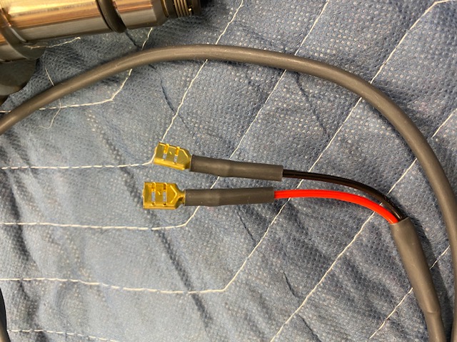

You need to crimp open barrel wire terminals onto the 2 wires on the 123 dizzy for the trigger points. The male terminals in the photo below, which insert into the cavities of the new female housing I am sending you, which mates to the male 3 pole housing on the FI wire harness.
So you need an "open barrel wire terminal crimper tool". You will also need a wire stripper to remove the wire insulation to expose the wire, to install the wire terminal.

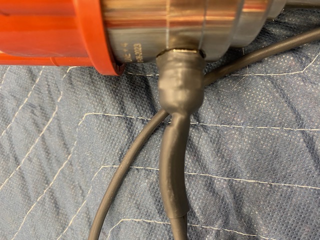

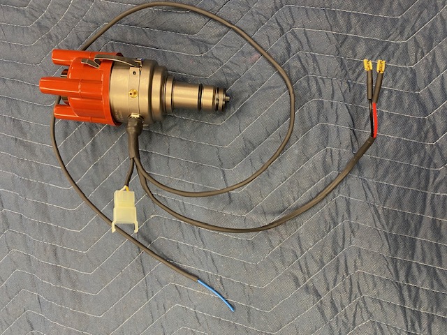

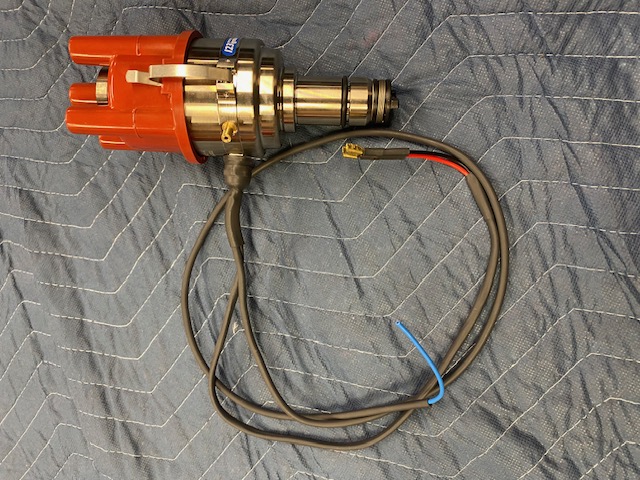

I met up with @jeffbowlsby two days ago and he installed his upgrade on both of my 123's. I have one D-Jet and one L-Jet car (1974 2.0 and 1975 1.8) and both distributors are tune +. Obviously the trigger point connections are not an issue on the L-Jet, but protection of the wires, with strain relief and extra protection from heat, are shared potential problems. I'll let Jeff further comment on his technique if he wishes, but at branch points and at the compression nut there are double layers of shrink wrap. For example, both coil wires run together through a length of shrink wrap but at the branch point there is a short length of shrink wrap under the longer length that serves to add extra strain protection. I haven't yet put on ring terminals for the grounds so I left them at the provided length. Instructions say to ground to the battery, but are any of you grounding to another location that you think is cleaner/better? I can trim this later and add the ring terminals. Here are pictures of both distributors:
D-Jet

JeffBowlsby
Thx Broheen, glad you like how it turned out and I think we made a great product even better.
fiacra
QUOTE(JeffBowlsby @ Aug 11 2024, 05:17 PM) *
It looks fantastic and even more importantly the wiring and connections are better protected and hopefully will give longer, trouble free service. Thank you again for doing this, and as always it was good to see you.
