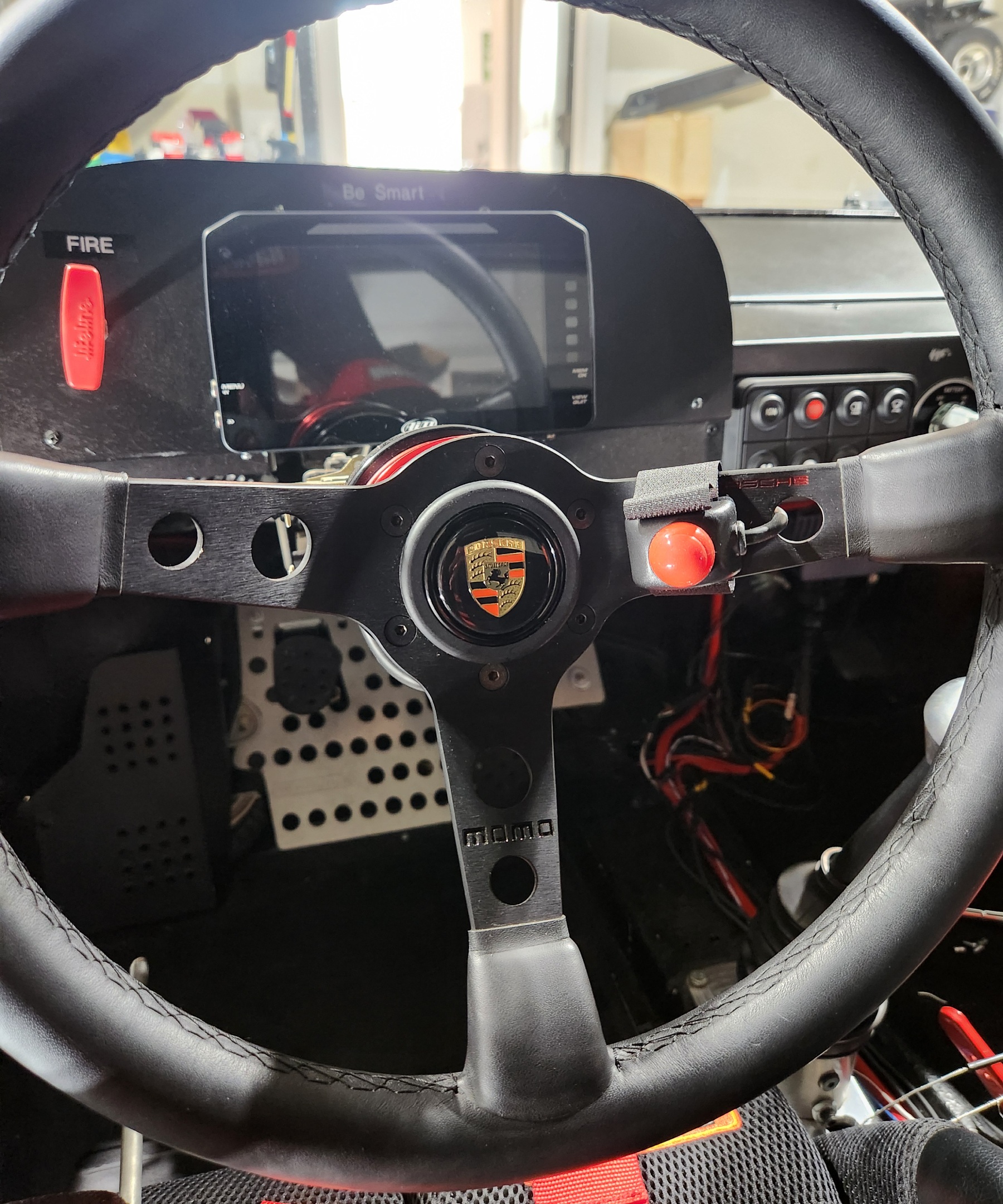

So on to more updates now!
As a track car I want to have the ability to communicate back to the crew and to get information from them as well. As I had mentioned before, I bought a radio set to make just that happen. First step is to plan out wiring and radio box in the car. After that will update with the external antenna install

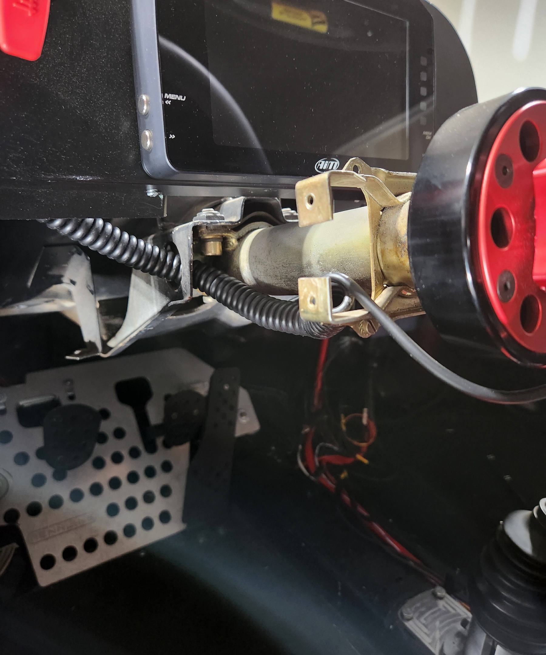

Here is how wiring is roughly routed as of today. Any suggestions are welcome!
Steering wheel push to talk

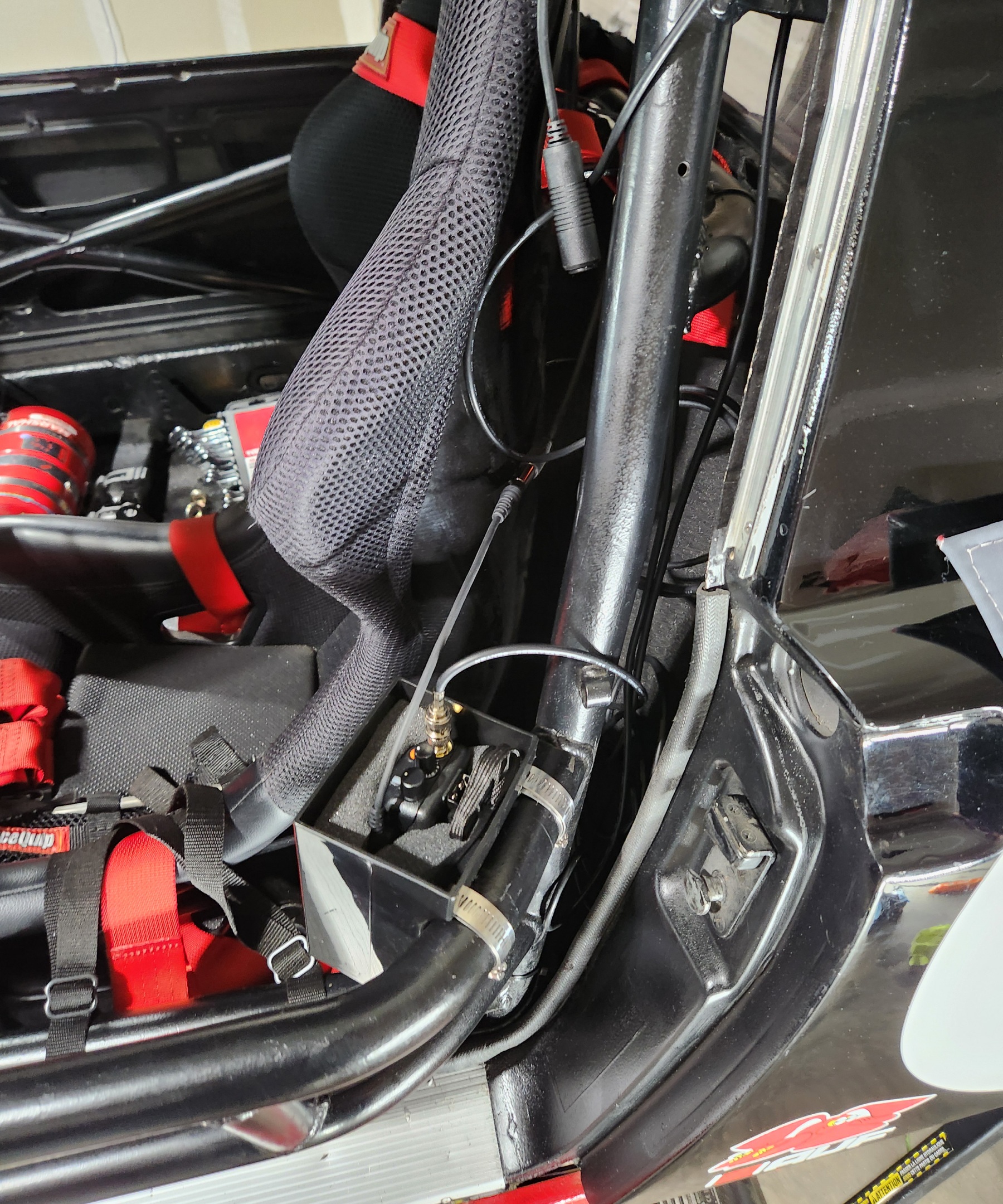

Click to view attachmentDown steering column

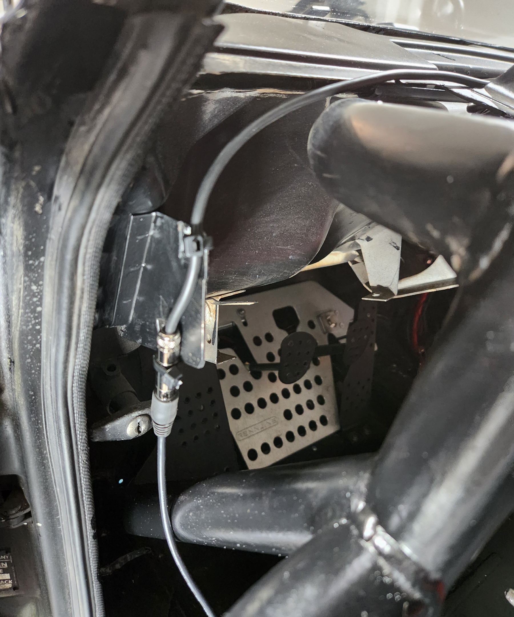

Click to view attachmentDown cage to floorboard
Click to view attachmentOver to radio box. Antenna and helmet plug (my roux helmet has a jack and speakers/mic built in) off of radio as well

I like your wheel for sure, but paid a small fortune for the porsche wheel so I am staying put lol. The AIM system I have logs everything automatically and starts the camera at 25mph to boot.
The only thing I am worried about is the cord at the steering wheel. How have others mounted to stay free and clear of binding?
