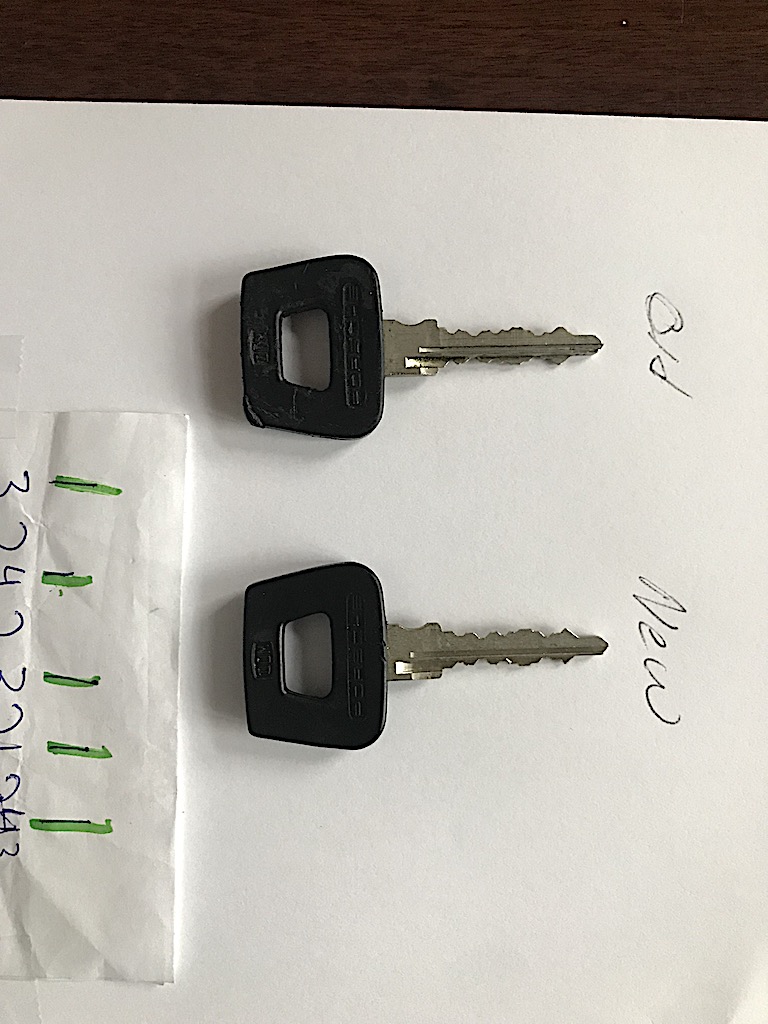

Well Curt has really done it....Keys by code, how about Keys by picture. I only have one key, told Curt I would send it to him this fall after Wisconsin driving weather to have two duplicates made. He said, why don't you send me a good picture and I'll see what I can do. Results, BRAND NEW key that works as good as the 45 year old original. That is really neat Curt. What a service to our little 914world community. Thanks, MarkClick to view attachment
