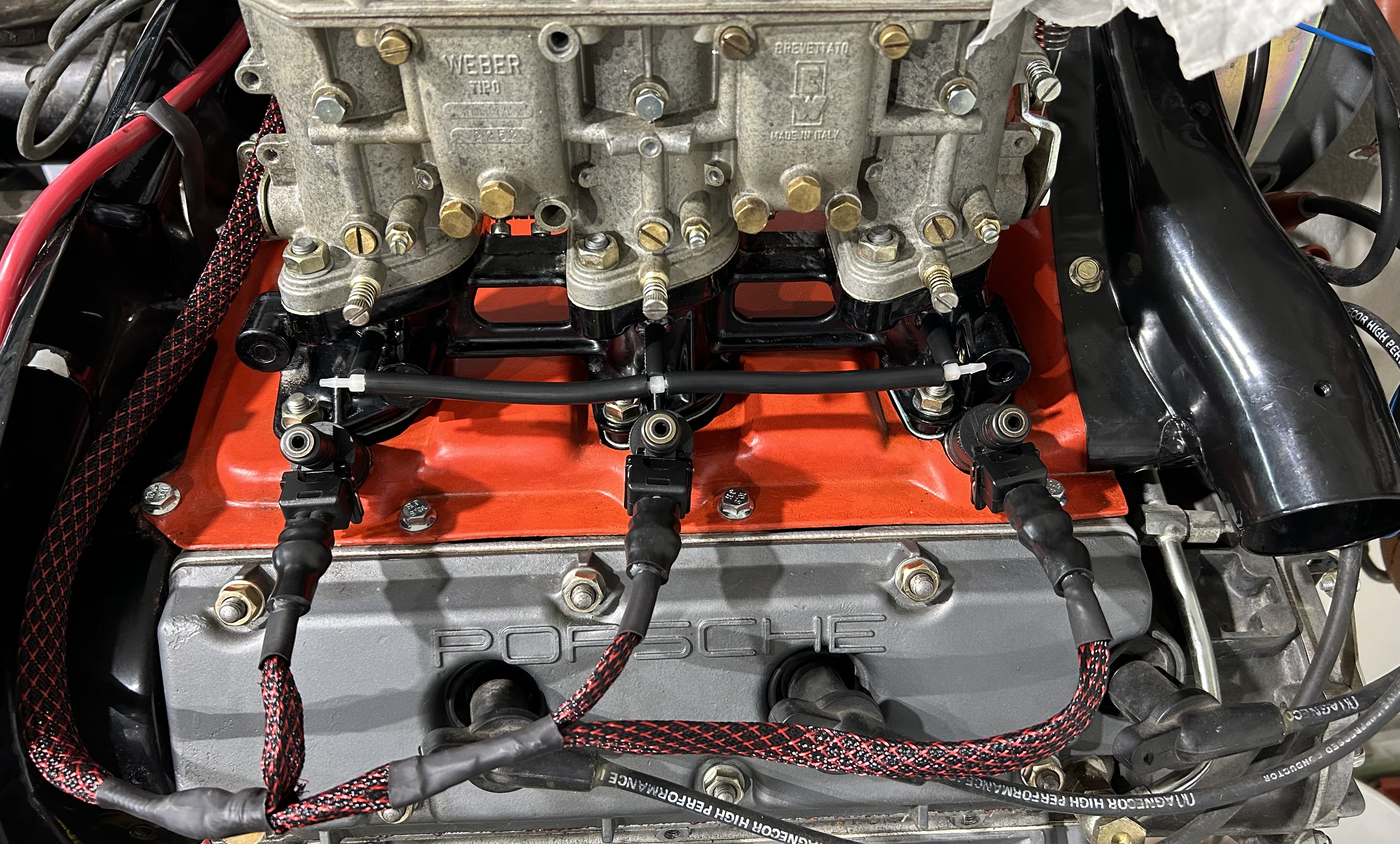

Just a quick update. MFI to EFI bungs are in and will be using the carbs will just be throttle bodies and port injection.
Have at those questionsClick to view attachment

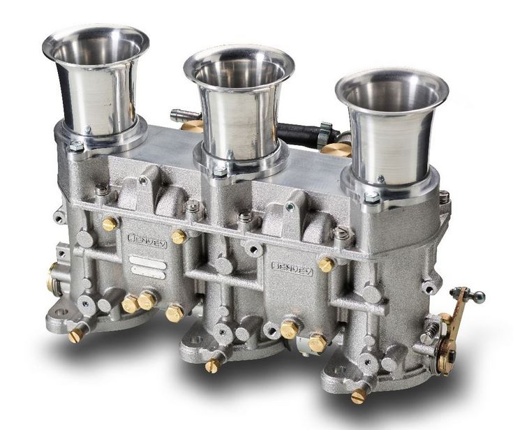

Why not use these?
https://store.jenvey.co.uk/heritage/heritag...ottle-body-42mm
They are a bolt on replacement for Weber IDA3C carbs. All of the EFI stuff is inside the throttle bodies.
The thing I don’t get with the Jenvey’s Is where the injectors are spraying to? The angle of the injectors seems to be that they spray into a passage like a carb jet instead of directly into the air stream? Maybe I’m just not seeing it correctly but Google doesn’t seem to reveal details of their fuel flow path?
The potential to use a common set of carbs as throttle bodies and to repurpose the MFI / CIS ports on some of the early engines is what makes this proposal that Ben is showing unique vs a set of PMO ITB’s, Jenvey’s, or any number of other high(er) cost EFI solutions were you have to ditch the carbs and buy all new ITB’s drooley.gif

These are designed for a stealth EFI installation. They look like carbs, and unless you find the wires coming out the bottom, nobody would notice. For a factory six, this would be perfect. Hide a microsquirt ECU under the air cleaner, and nobody would notice the EFI.

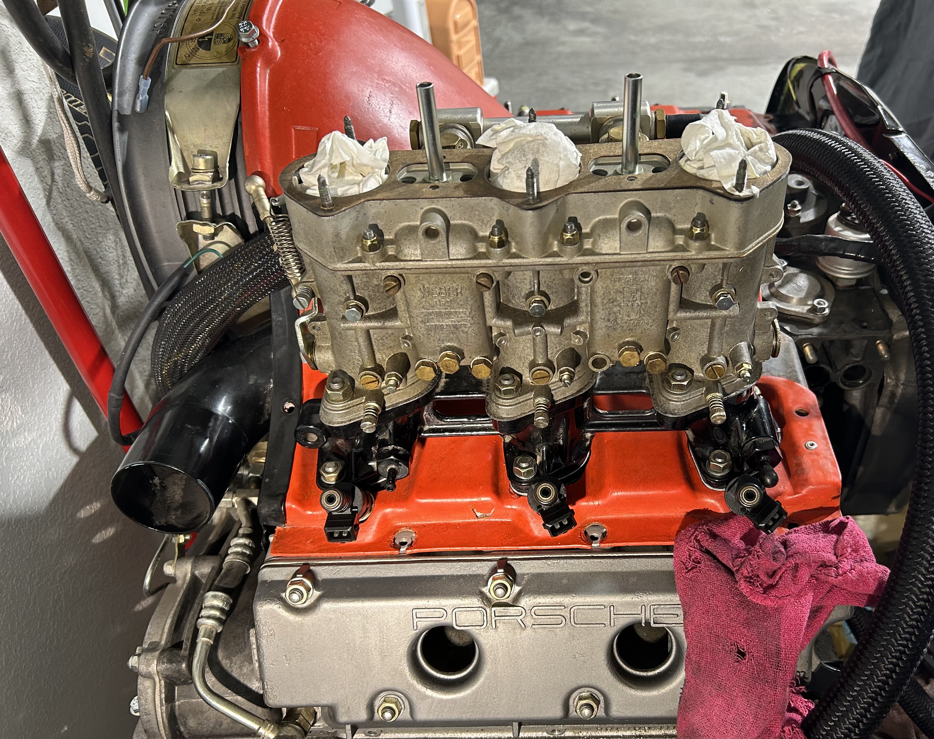

mb911
For you viewing pleasure Click to view attachment

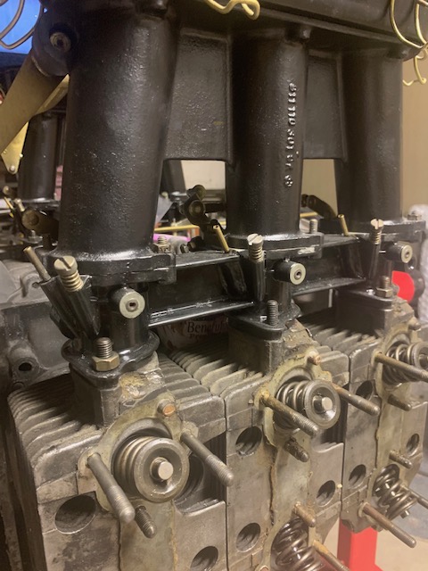

Ben. On your motor, what was covering/plugging the injector port prior to installing the injector adaptors??
mb911
QUOTE(gereed75 @ Jan 13 2023, 07:34 AM) *
Plugs that were a kit I remember be sold through automotion back in the day.

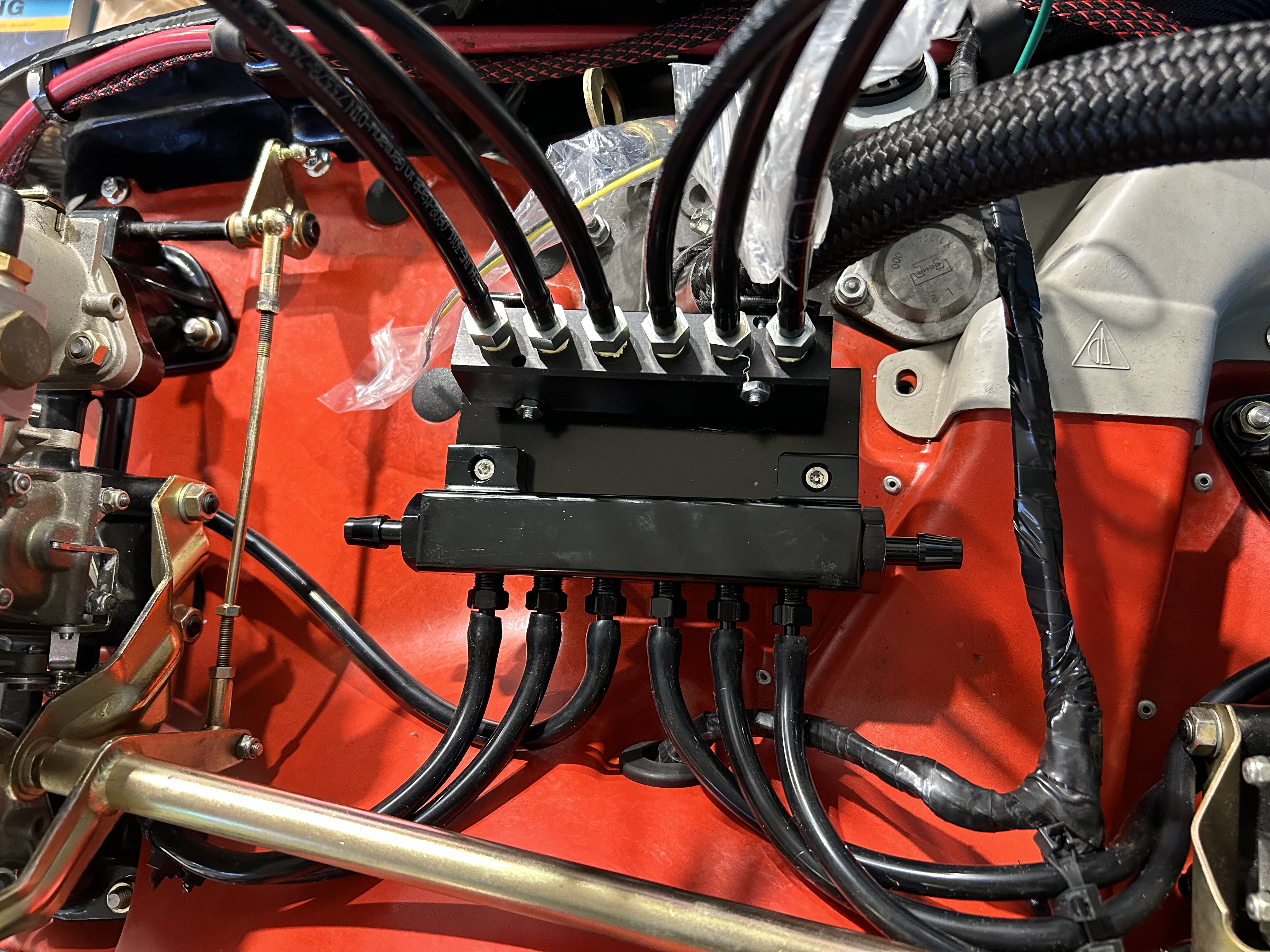

Vacuum fittings selected. I will have to drill and tap each manifold to get a good signal for the MAP sensor Click to view attachment

What becomes of float bowls and other carb related items? Does everything other than the vac ports you’re putting in get plugged? Do the triple Webers have progression circuits?

QUOTE(rhodyguy @ Jan 14 2023, 03:04 PM) *
Just plugging the fuel inlets. I might remove the floats just so they don’t rattle.

Went a different route on vacuum tubes. Drill .100 hole and used 3/32 brass sleeved inside 1/8 brass and used loctite 638 cylindrical bonding and pushed them in the holes and for good measure so epoxy on the outside. Then connect the 1/8 vacuum tubing only to realize that I need to run individual lines to a manifold to ensure no reversion. I did also start on the injector harness as well. Click to view attachment

Equal length vacuum lines and manifold for a clean signal. Making headway Click to view attachment
technicalninja
You will need to check the map signal you get off of that block.
All ITB F.I. setups that I have played with required a TPS sensor as we had to run Alpha N below 12-1500 rpm as the map signal looks like an ignition signal at slow speeds.
This FI strategy is called blended alpha N/speed density.
More compression and big cam profiles made this MAP instability worse.
Most systems that I have worked on have 6 and 8 cylinders.
The more cylinders you have the smoother the MAP is at low speed.
You might be able to run an IAC valve (idle air control) off the block. I usually go with 3/16-1/4" vacuum lines from each runner to gain enough flow for computer controlled idle aspects.
Below the smooth signal threshold, the map sensor is not in use, but the IAC valve is, and above the threshold vise-versus.
I will commonly run the MAP off of one end of the block and the IAC off the other.
Another solution is to enclose both air filters in plenums and add MAF sensors in the entrance to the plenums, but you will significantly reduce the howl that we all love to hear from an ITB set up.

I saw the Jenvey Heritage ITB for the 4 cylinders that hide the injectors and the TPS inside the unit. The injectors are firing into the intake just below the throttle blades at an angle. These are WAY cool but Jenvey themselves show compatibility with up to E20 which is a deal breaker for me. The little 350 cc injectors are too small IMO as well.
On PMBs website the normal Jenvey IDF (non-hidden injectors) are far more affordable.
https://pmbperformance.com/products/jenvey-...r-porsche-914-4
My big 4 cylinder with have those, 1050 cc injectors (Injector Dynamics), and run E85.
I'm betting the six-cylinder stuff is similar.

Or Jenvey heritage. I just like to be different
