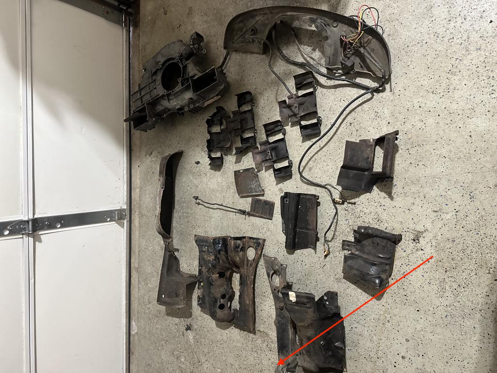

While I am trying to sort this issue out I am also in the process of rebuilding a 1975 2.0L engine with D-Jet to upgrade my 1.8L currently in my 1974 914. I am at the stage of doing the valve train and was looking for my engine tins #4 and 5. I found also the decel valve still attached to the end piece engine tin. So can that decel valve be used to replace the bad one in the 1.8LClick to view attachment

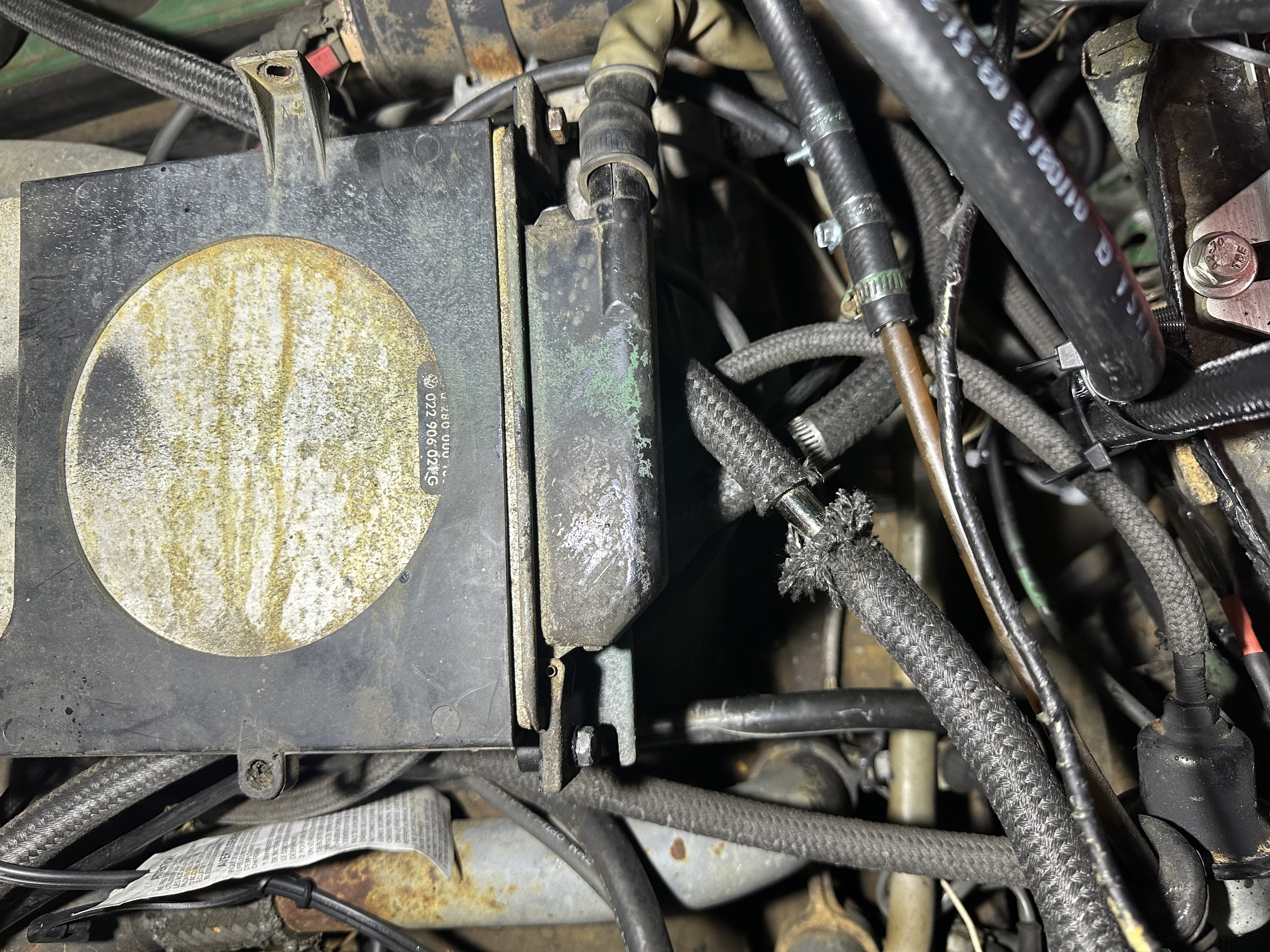

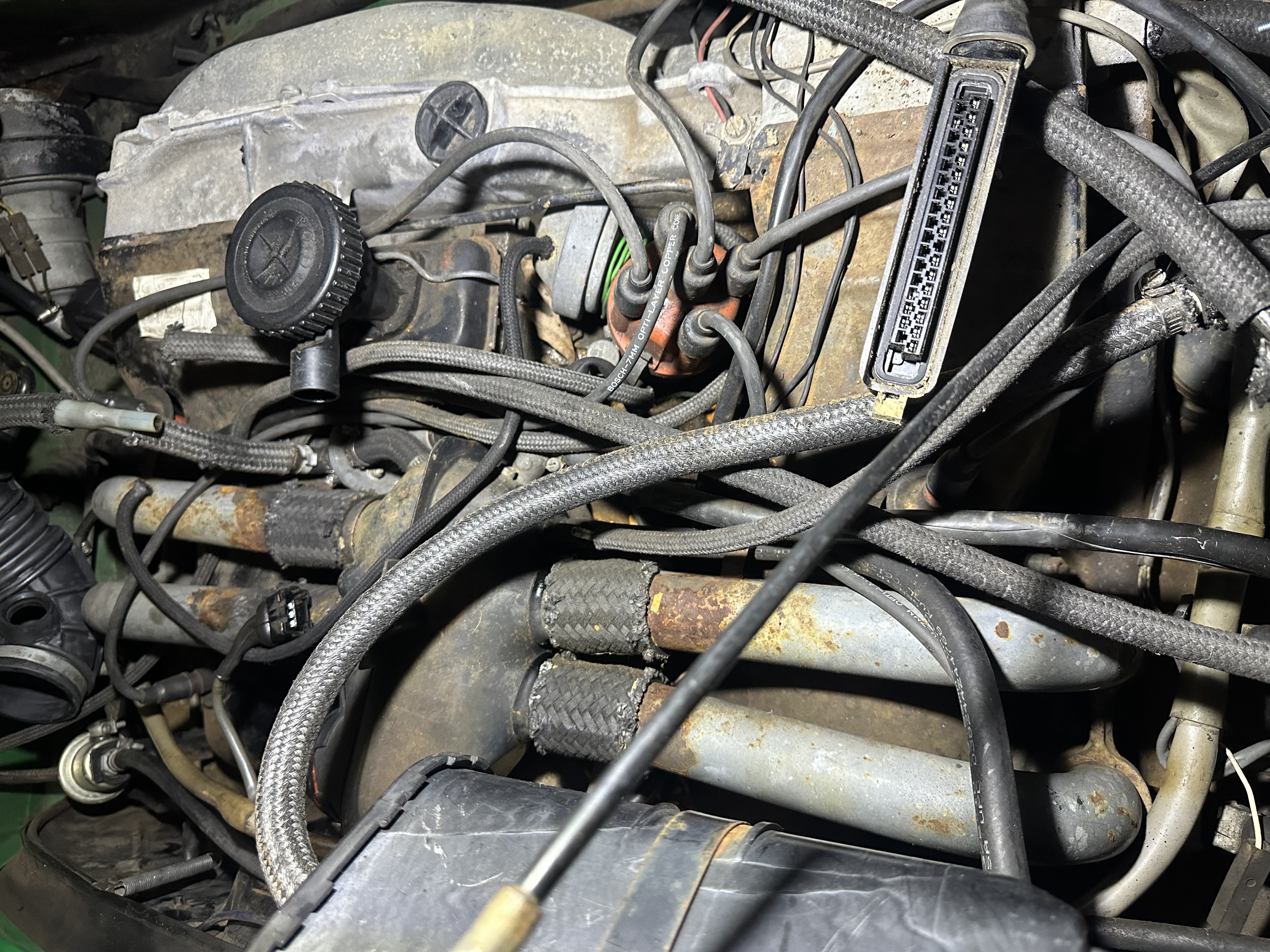

the decel valve will not be attached to engine tin.
its in all cases mounted off the inner engine bay bodywork on rhs of car.
whats mounted off the engine tin is the fuel pressure regulator.
thats probably what you are looking at.
looks very similar to a decel valve.
esp the f p regulator on a D jet. it has an adjusting nut on it i believe that can make you think its a decel. the f p regulator on the L jet has no adjustment nut but is mounted on same place off engine tin on lhs like a d jet. its just a mounting nut on a L Jet.

wonkipop
if this is what you are talking about @tshih914 then its a fuel pressure regulator for a D jet not a decel.

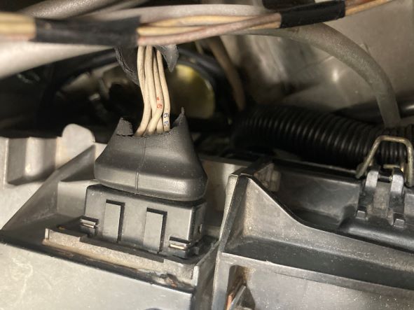

nuts do not release harness plug.
this is how you do it.
press down on the little spring clip.
this will release the bottom of the plug.
pull + swing it out from there, it will pivot on its upper hook connection.
once swung out far enough pull downwards off the hook.
all this is described in factory workshop manual.
have you downloaded it from the links i gave you back on page 1?
it will tell you how to do all these things without breaking anything.
the nuts hold the ECU into its support sleeve.
which should be fixed on to the edge of battery tray.
this does not seem to be the case with yours?
the ECU is just laying around in there?
the nuts have probably stripped the thread in the support sleeve.
the sleeve is made of plastic and is delicate.
EDIT, its been a while since i had my ECU out to clean around in that area.
i got the ECU out of that sleeve and i seem to remember those bolts are captured.
once you undo them a certain amount the ECU just slides out of sleeve.
i could be wrong, its been a while. but irrelevant to releasing the plug connector.

take a photo of the ECU pins and harness plug when you have them apart and post it.
be delicate with it all. it looks like it might not have been off for a long time maybe.
so just go easy at it.

i'll have a look later and see if i can find the pin diagram for the ECU and post it.
with a bit of luck someone else might post it for you before i get hold of it.
bob164
Jeff Bowlsby's excellent website has a "914 Tech Notebook " section.
https://bowlsby.net/914/Classic/TechNotebook.htm
The ECU Connector pin-out is on page 22 of the "Technical Manual L-Jetronic Fuel Injection System".
Hope this helps,
Bob

tshih914
@wonkipop
The ECU was not left dangling loose in the engine bay. It was securely mounted to the rubber mat on the firewall by a long screw into the firewall so I believe it is not damaged.
I did notice the CHT was very rusty and probably needs to be replaced. I think it is a thermocouple resistor that register about 300 ohms when cold and resistance goes down when hot. Checking it is just a matter of measuring the resistance at the two ends (head of the part that screws into the cylinder head and tail of the wire leading to the ECU harness)
I have received the hose kit and am in the process of removing the AAR and cold start valves for testing and cleaning. That hose kit does not seem to have the right number of hoses or some of which are too short to replaced those currently in my car.
wonkipop
QUOTE(tshih914 @ Mar 10 2023, 08:54 PM) *
@wonkipop
ok thats good about the ECU.
sounds like you got a bit of momentum up now.
good luck with testing and checking all the bits.
did the hose kit come with a guide drawing for each hose?
would be unlike AA to have that wrong i think.
list up anything specific you encounter with a photo and perhaps we can check it against what should be there and where they go.
you will find my hand drawn hose diagram is accurate, its off an original cond car. beerchug.gif

StarBear
Van B
The ECU is very obviously not mounted to a rubber mat, on a firewall, with long screws.

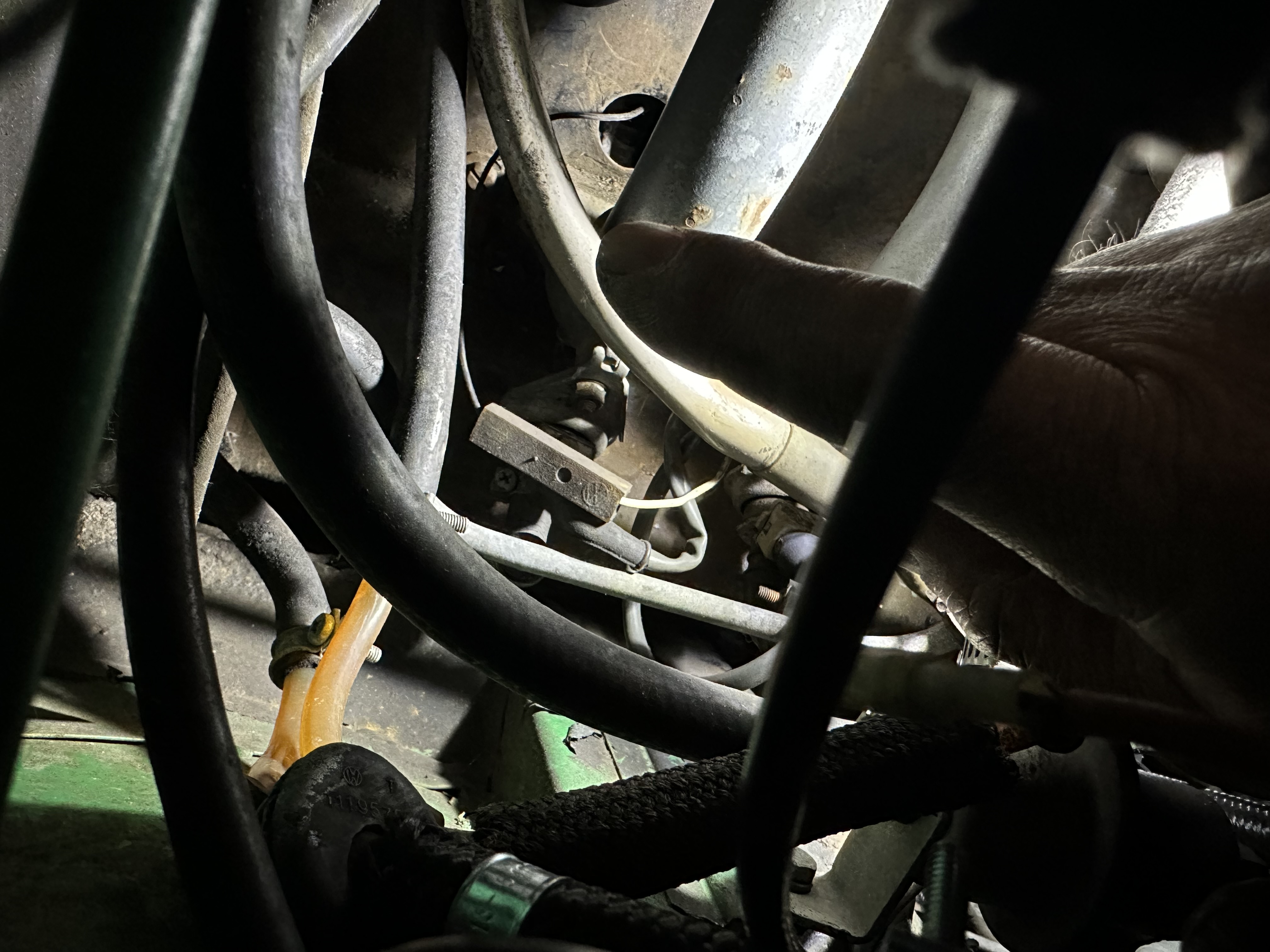

I went to check the CHT sensor (which is really difficult to get to buried under engine tin near spark plug #3) Just measured the resistance from the connector rectangular plastic piece to engine ground and it read 1.77kohm. I don't know what that means as I expected around 300 ohms cold. Will check once the new part comes in from Amazon.
The next thing I did was to remove the AAR and sure enough the valve is open when cold. However when I connected 12V to the 2 pins at the connector after 13-20 min the valve felt warm to the touch but the opening did not close so that valve is broken.
Also in looking at the valve there appears to be a post for grounding wire/connector? that was not attached to anything.
StarBear
Might want to squirt a few drops of silicone spray in there just in case that loosens things up a bit. Worked on mine which was mostly working but needed a little encouragement to behave. biggrin.gif
