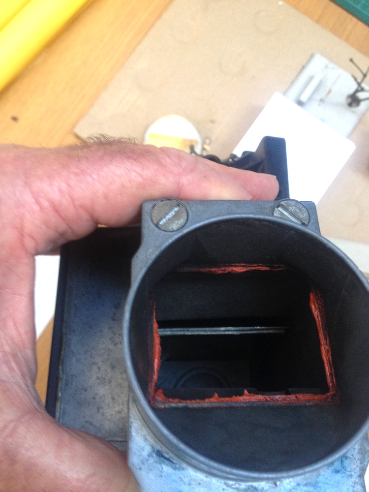

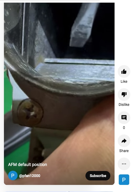

wonkipop
@tshih914
you were asking about rest position of AFM thousands of pages back.
yep thats how it should be.
(or we are both stuffed biggrin.gif)
note the orange 3 bond sealant.
the work of my old german mechanic from must be 30 years ago.
still holding up.
he was fanatical about ze hair leekz in ze luft-troneek as he used to call it. biggrin.gif
and the other end since i had it out.

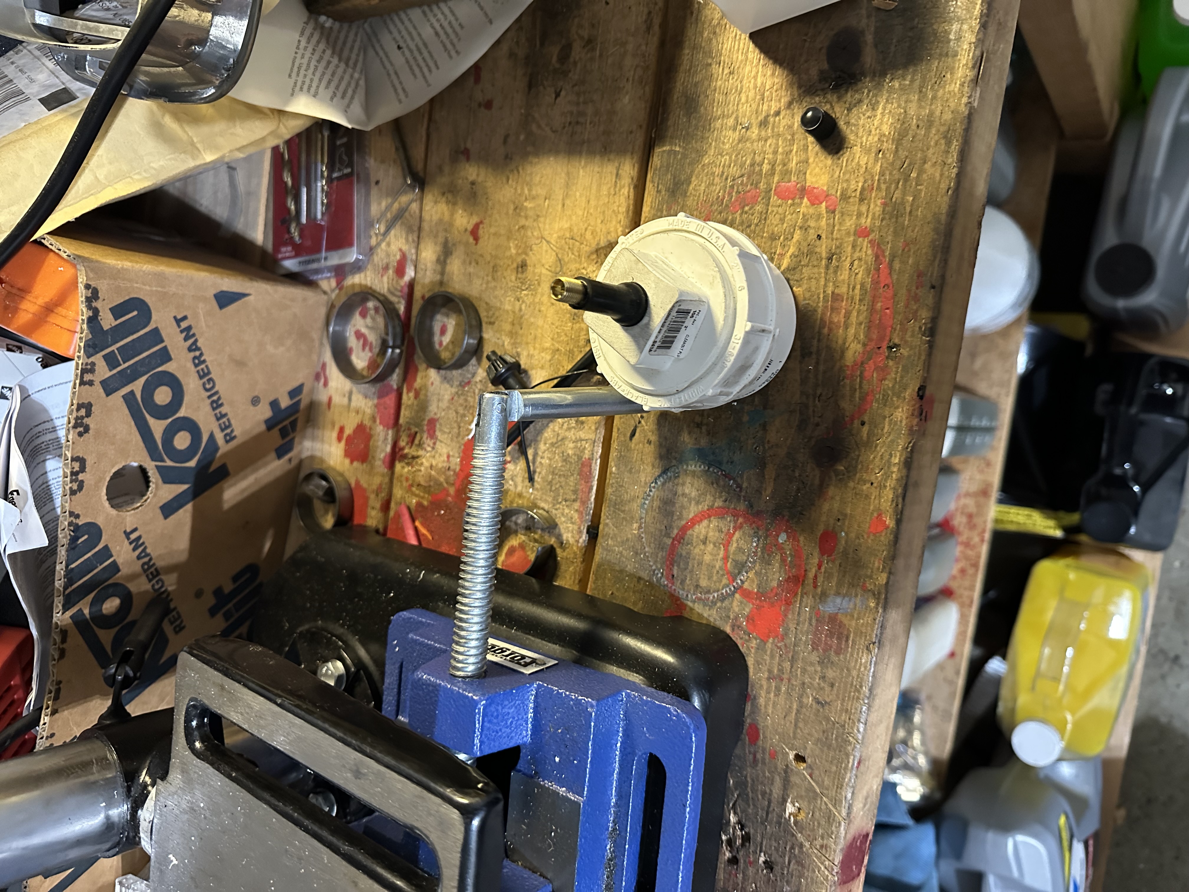

Attached tire valve stem.Click to view attachment
tshih914
QUOTE(tshih914 @ Apr 1 2023, 06:09 PM) *
My youTube short video shows minor leaks at the intake runner seals and at the idle adjustment screw at the base of the throttle (expected). Will need help from another person to check again after new seals are installed.
