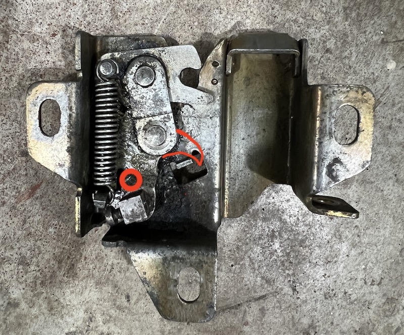

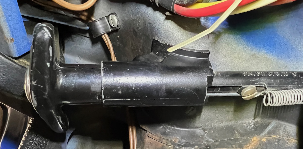

Is this the correct attachment point for the frunk handle spring? It doesn't look right to me, but I can't see where else it would go. confused24.gif
Thanks.
tygaboy
That's not it. There is no spring related to the handle. The spring action is handed within the latch itself. If yours isn't returning, you've got an issue with the latch and/or the cable routing and housing getting from the handle to the latch.

QUOTE(tygaboy @ Aug 19 2023, 09:37 AM) *
Thanks for the info and offer to visit.
huh.gif I wonder what that spring is for then. Wish I had taken a better photo when I was still with the car.
Superhawk996
QUOTE(DennisV @ Aug 19 2023, 01:55 PM) *
Tygaboy nailed it, Just another typical DAPO “improvement” to band-aid a sticky cable or latch mechanism rather than addressing root cause.

Try lubricating the latch mechanism. It really makes a lot of difference.

@Seattle_914 It's almost always that the latch is super sticky and a good cleaning/lube takes care of it. I did have one latch that was worn to the point that the movement of the components was compromised and no amount of cleaning would have fixed it - so it was replacement time.

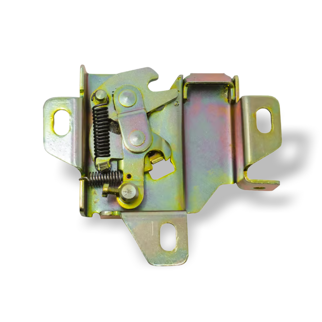

5. While the latch assembly is out of the car, carefully clean and inspect it for damage and affect repairs as appropriate. Confirm that the (2) springs installed on the latch are in good condition. Apply grease to the moving parts of the latch. Set aside.
You mention there being two springs. Ours only has one. Is that a model year difference, or is something missing from ours?

QUOTE(Shivers @ Sep 3 2023, 08:46 AM) *
Thanks for that comparison photo. I fiddled with ours to position it the same as your example. I wonder if there are some design evolutions. There are some subtle distinctions to the metal pieces, beyond the spring. Or maybe one is aftermarket?
