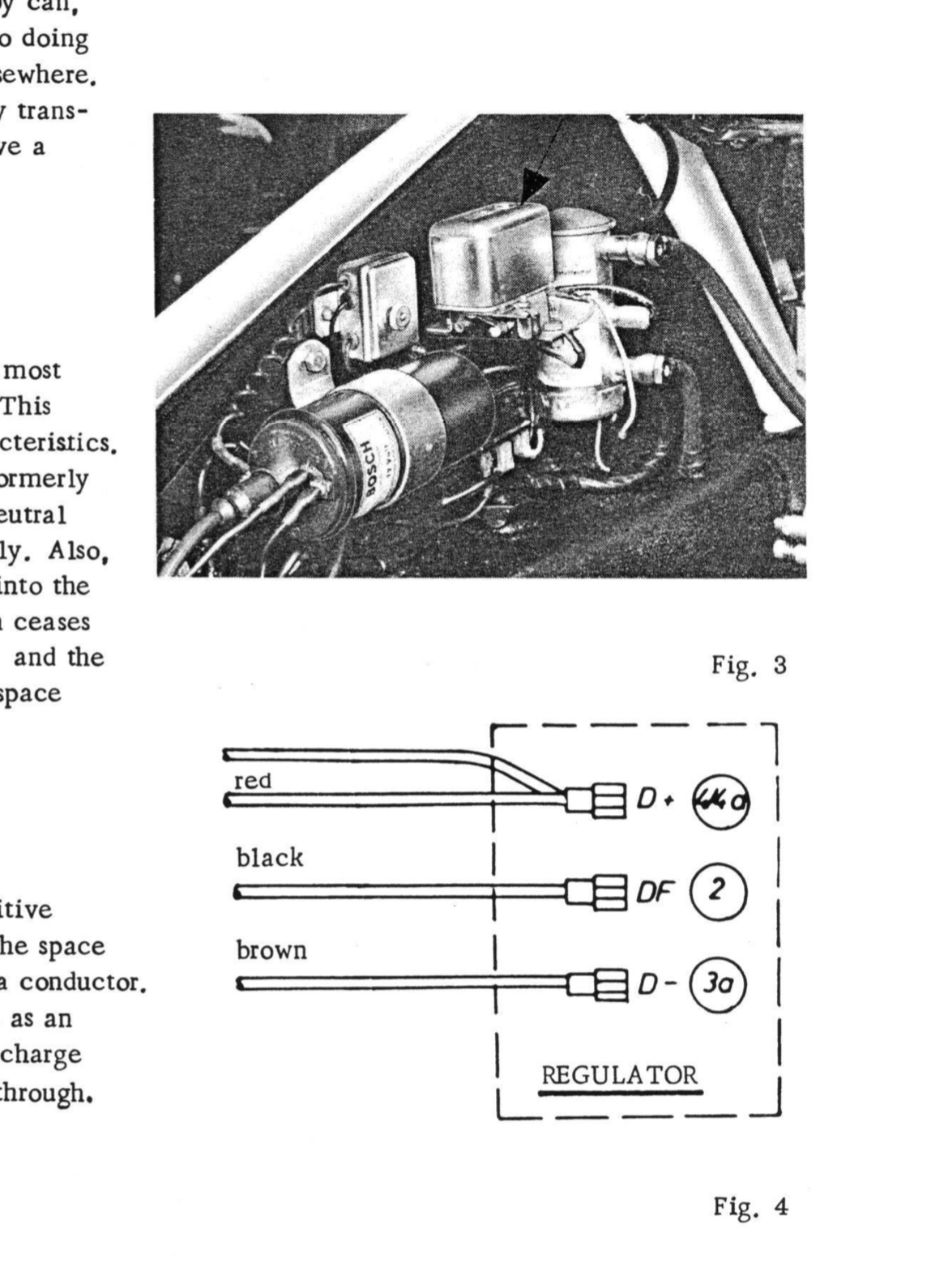

Assuming you’re running a 3 pin mechanical regulator here’s the 911 factory manual diagram / color code
Not at all uncommon to get some corrosion on the regulator contacts that can inhibit charging. In the past I’ve hit them with 400 grit and revived an in-op regulator.
Your regulator appears to have the cover riveted on unlike the Bosch /4 regulators there just have a taped on cover
One last thing to keep in mind is the charging voltage is dependent on battery state of charge. So if your battery is fully charged, you’re not going to develop 14v of charging voltage.

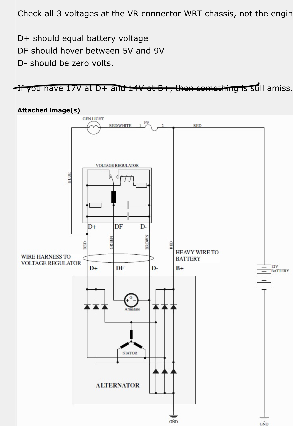

I’m going to post one more which is Spoke’s simplified schematic for an alternator and 3 pin regulator
I did a strike through on a line that has no bearing to your issue.
As previously noted the voltage on the field (DF) will vary based on battery state of charge and the electrical load the system is seeing. A higher voltage on DF indicates the system is “pushing” the alternator harder and trying to increase alternator output.
Note: color codes on this reflect the /4 914 regulator wiring. The other illustration is from a 911 factory manual and 911 wiring, thus the difference in color of wires.
Note 2: the voltage measurement of DF is referenced with the regulator plugged in and functioning by rapidly energizing and de-energizing the solenoid coil within the regulator.

mb911
QUOTE(Superhawk996 @ Jun 17 2024, 03:48 PM) *
Thanks that will help me track it down

Spoke
QUOTE(mb911 @ Jun 18 2024, 05:39 PM) *
dF is weird as I get different values depending on what 12 pin connection I check.
What does the 12 pin connection have to do with DF? In the 914/4, DF goes between the alternator and the VR and goes through the 3 pin connector between them. That's it.
Did you do some tests on the 3 VR voltages while running? This can tell a lot about your system.
When running, measure these voltages at the VR:
D+ should be 13-14V
DF should vary between 5-10V depending on electrical load.
D- should be 0V
Also measure the battery voltage:
B+ should be 13-14V and follow D+
Measure all voltages with respect to a chassis lug, not the engine case.
For the field test, remove the VR and short DF to D+ then start the engine. This should force maximum voltage of about 16V on D+ and B+. Do this for a short burst as it's hard on the battery and alternator.
As an aside, my '86 930 was showing low battery voltage (12V) and slow starting. I bought a new battery and immediately got 13.5V steady. You mentioned you were going to replace your 10 year old battery. Did you replace it and did it make a difference?
