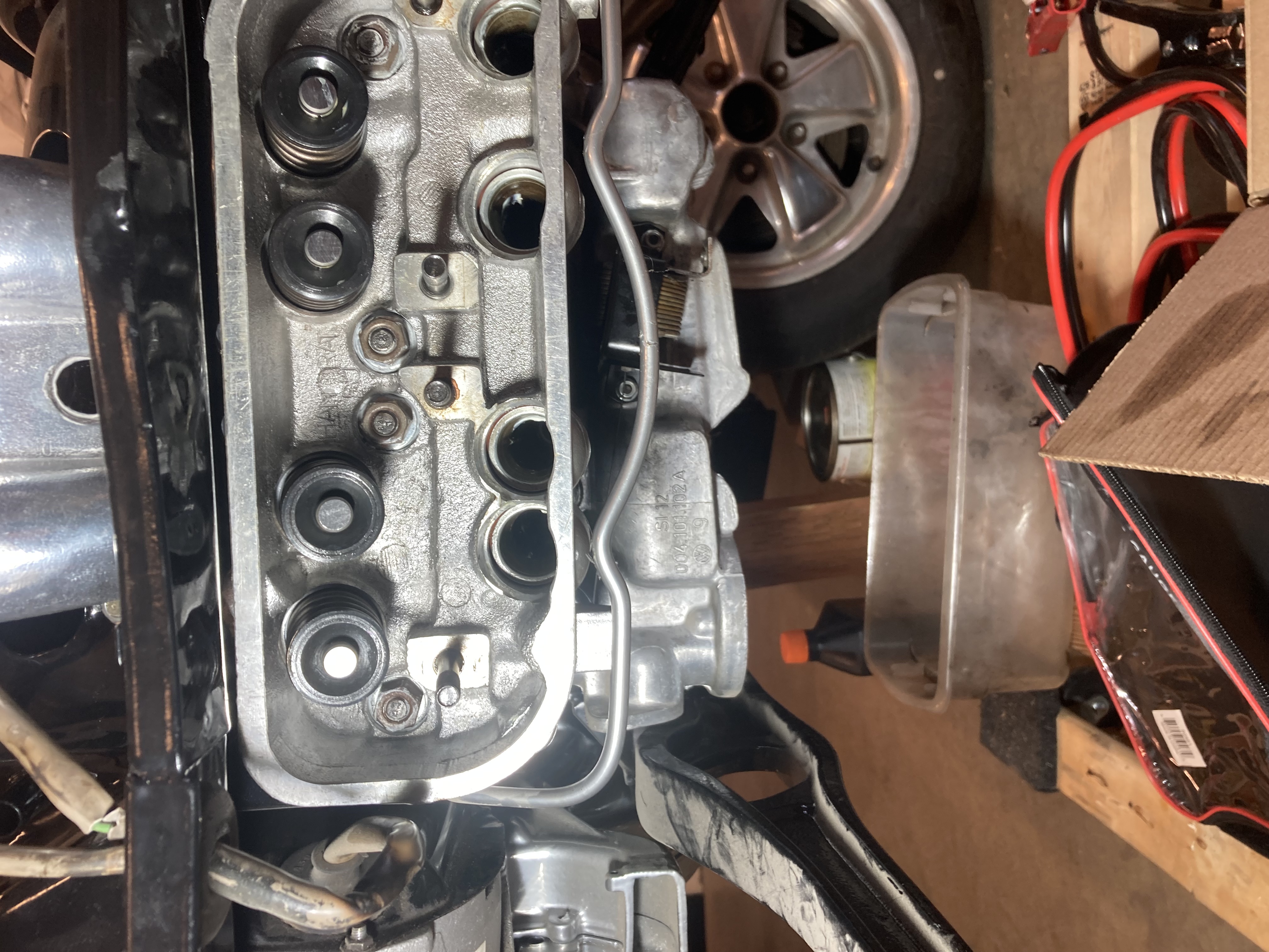

Removed the rockers and push rods. Could turn the engine by hand by gripping the fan. I’m considering cranking the starter with the rockers and push rods removed to see if it builds enough oil pressure to turn off the oil warning light. If I get that far, then was considering reinstalling the push rods and rockers and adjust the valve clearance very loose and try to turn it over again by hand. With luck, there will be no valve/piston interference and I can turn the crank by hand. Not sure what valve springs I have. They are doubles but that’s all I know. I assume the springs can be heavy enough to make it harder to turn by hand. But sounds like it should be turntable by hand unless there is clearance issue. Going very slow and cautious. Thanks for your thoughts. Please keep your suggestions coming! I might just get an endoscope camera to look inside. I can see numbers on the pistons through the spark plug holes but can’t read the numbers.
emerygt350
I wouldn't worry about oil pressure yet but it couldn't hurt with the rockers off.

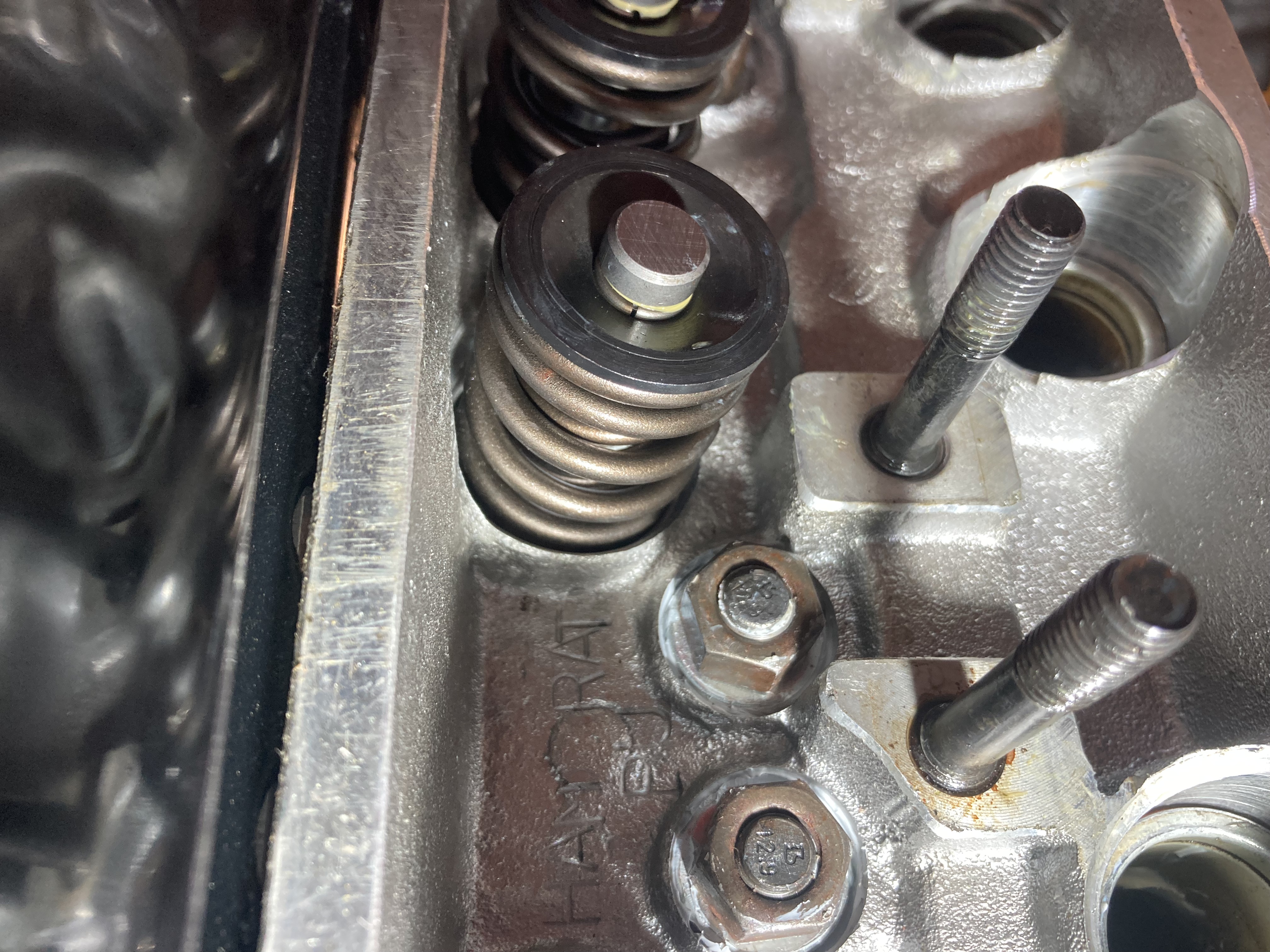

The springs are a little worrisome to me. I know they are used but I wonder if that means there is some radical cam in there. Do you have a micrometer? Measuring the lift on the cam might be interesting. You should be able to ballpark it with the pushrod travel.
To determine if it's the valve springs you could put them back on one intake valve and try turning it by hand. If that works add another and keep going. If it gets progressively more difficult but the engine keeps turning...

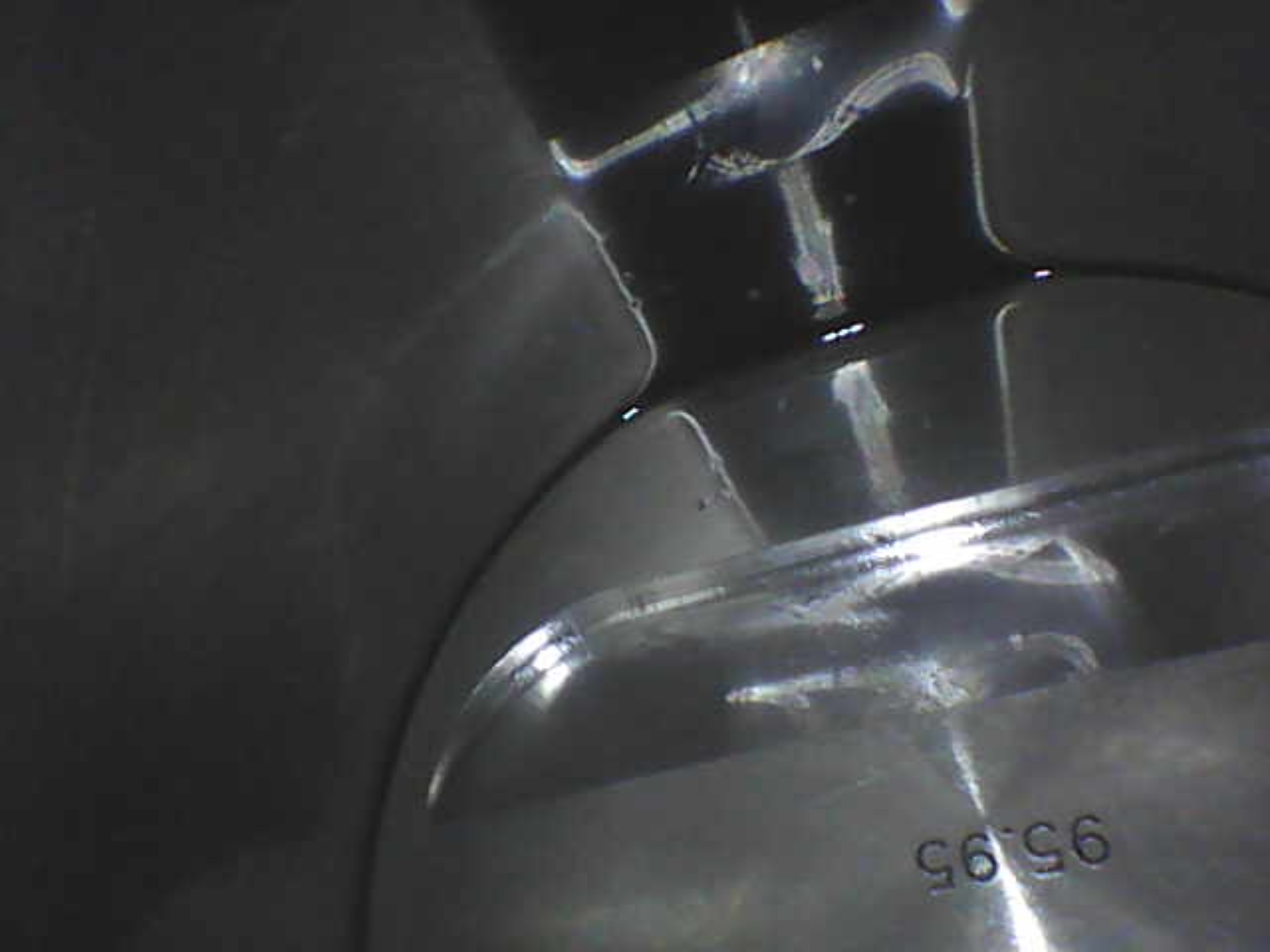

Ordered borescope today to look inside cylinders through spark plug holes. Hope to learn more about which pistons were installed (part numbers from tops) and better idea of valves and heads. From there I hope to decide whether to pull the heads for a better look. I”ll probably try to measure piston travel and valve lift too. Would be nice to know a bit more about what I’ve got before trying to start.
The fan is very close to the case. Seems like it might be touching a little as I spin the motor by hand. It’s so pretty with the tin and case powder coated. Hope I don’t have to tear it down too far if at all.
Will post what I find with the scope. Might even figure out how to take pictures.

Boroscope just showed up. Pistons are marked 95.95 on top. They are flat with valve relief cuts. Any idea what pistons these are?
emerygt350
They look like my 96mm pistons. If that thing is as big as it seems I hope they are forged....
Superhawk996
With respect to stroke - you’re neglecting that the spark plug isn’t perpendicular to the piston. What you’re measuring isn’t 1:1
Given that none of this is stock 1.7L I’d be taking that apart to figure out exactly what is in there and how it was built.
There are plenty of stroker cranks that require clearance work be done to the case.
Likewise those relief cuts in pistons may not be clearing valves properly.

I DON"T like the raised 95.95.
I want the tops of my pistons smooth as a "baby's ass"
The valve reliefs look rough too.
Look like inexpensive forged to me.
I'd fully tear down.

Click to view attachment Click to view attachment
Sorry about the multiple posts of the same photo. Learning how to use the site.
technicalninja
THAT LOOKS PROMISING!
You might have hit a home run...
Fancy retainers/springs, RAT etched in.
Show MORE!

Those are nice heads - this is why it’s important to disassemble & understand if anything is not clearanced properly.
Those are expensive heads - you don’t want to damage them
technicalninja
You couldn't have any better markings than that!!!!!

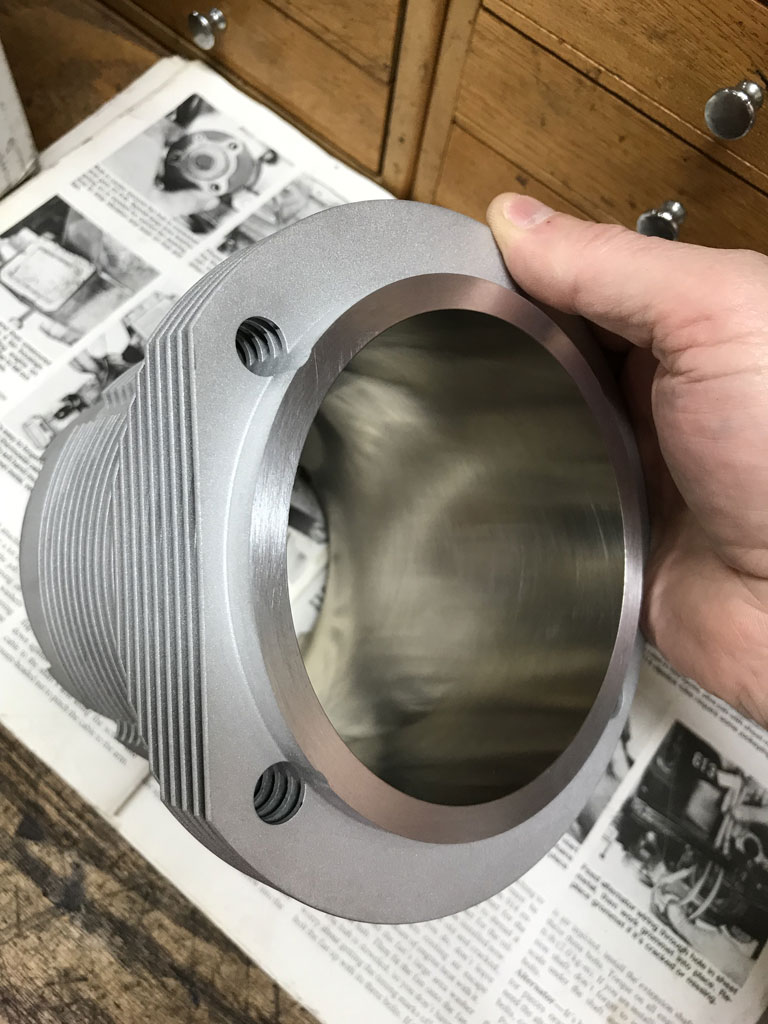

You want to look at the jugs. If they are "Nickies" you hit the home run.
They will look 911 "like". not VW finned. Aluminum with denser machined fins.

For OP - Nickies cyclinders are billet aluminum - very distinctive. Here’s a set of 100mm cylinders I have slated for a build as example of what they look like Click to view attachment
