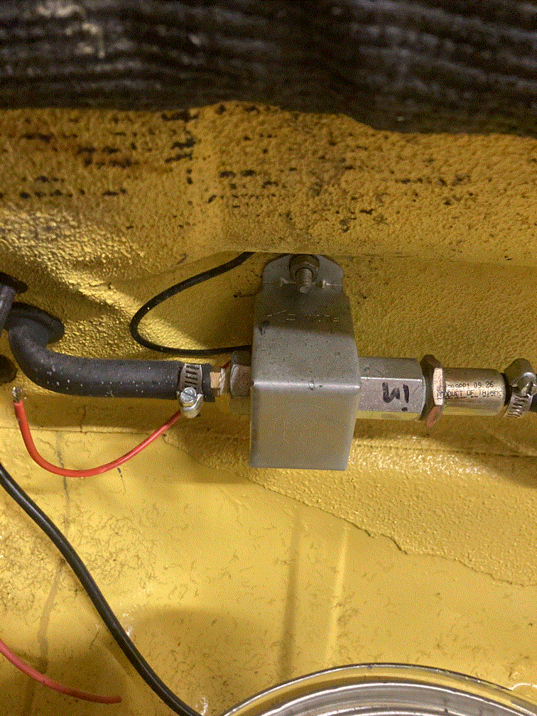

Fuel supply, you need to be able to deliver at least 200hp worth of fuel at all times.
At this level of engine, I'd be running a 7-8psi pump under the tank and a fuel pressure regulator to reduce this to 3 psi right before the carbs.

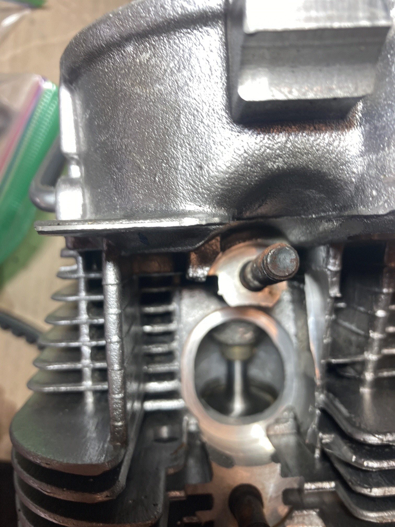

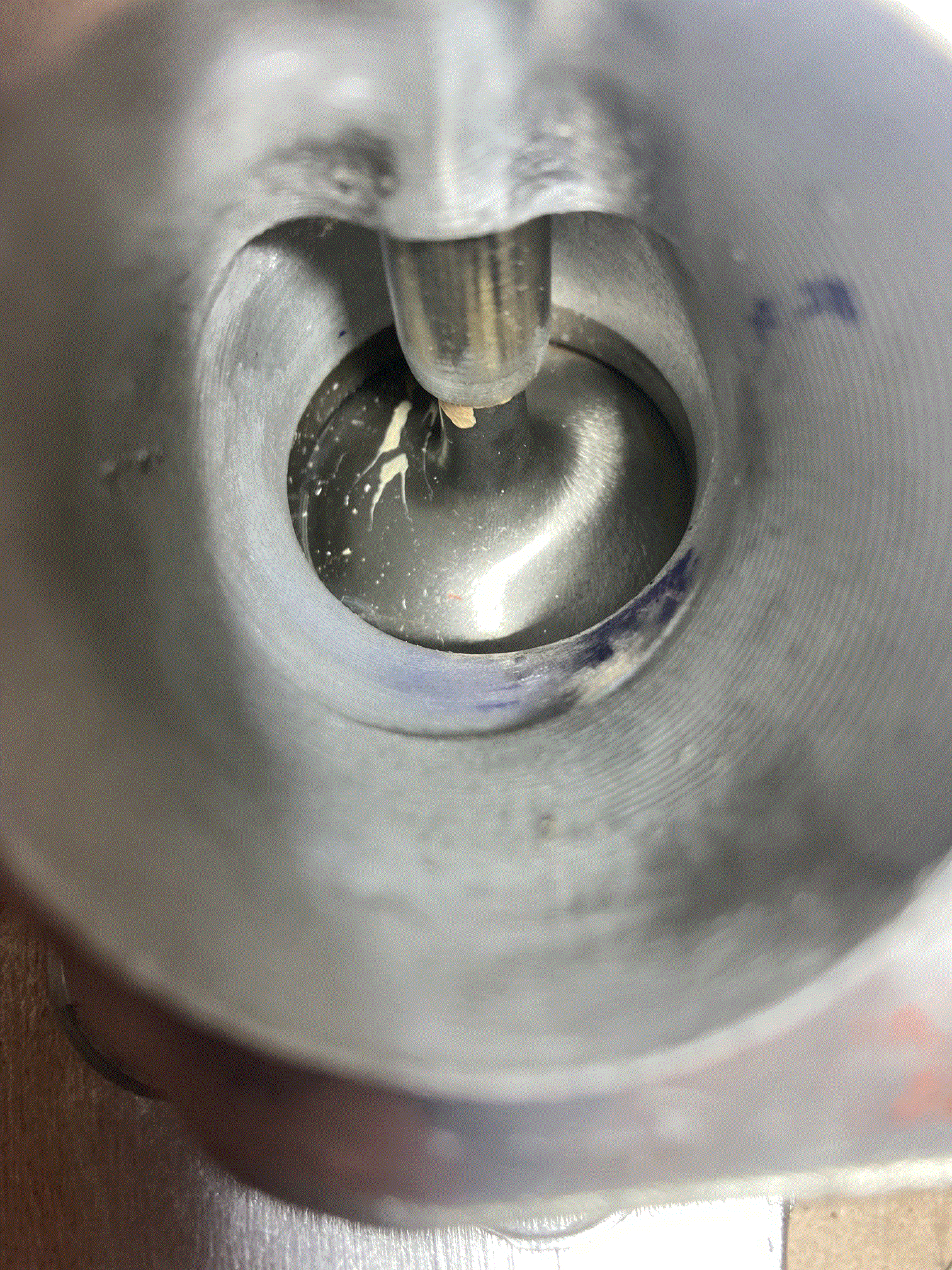

Head porting photos. Just ordered AA 2 arm bench mount yoke. Looks pretty solid but will weld additional material if it looks questionable.
Click to view attachment Click to view attachment

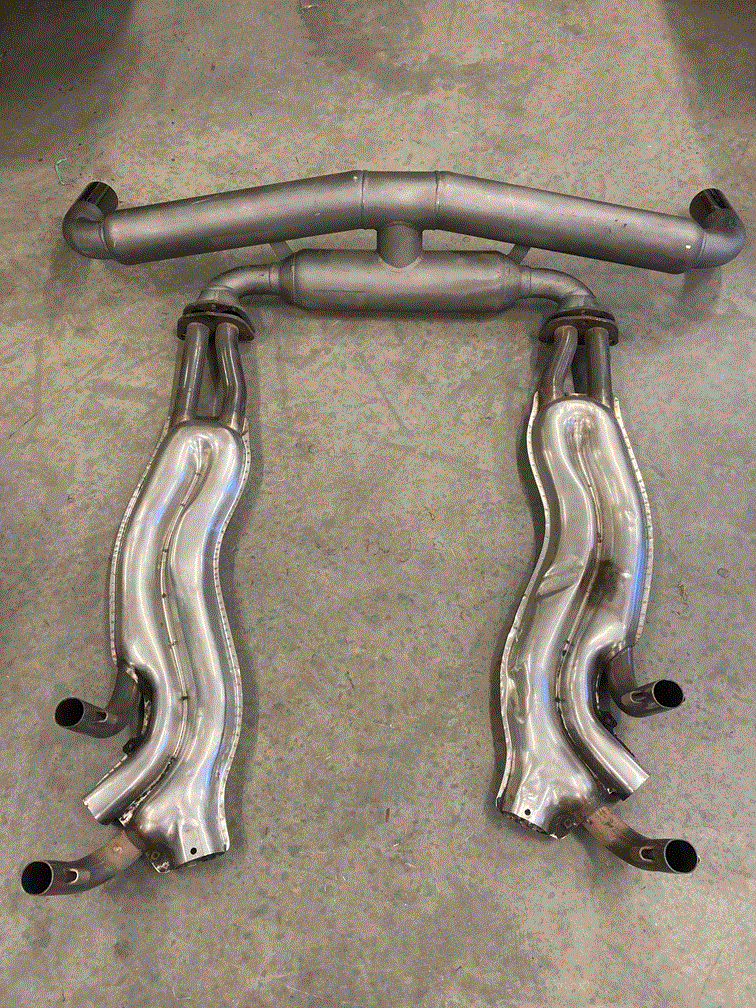

Facet fuel pump mounted under fuel tank in Frunk and Exhaust. 2.0 stainless heat exchangers

Stock or SSI heat exchanger is going to limit your HP as Ninja already pointed out. Inability to quickly & efficiently move hot exhaust gasses out of the engine will lead to increased engine temperature as well.
