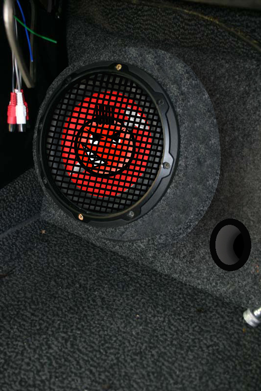

Actually, I was amazed at how good it sounds and I have not even installed the tweeters which are going on the panel behind the front windshield (have to take it out to do the install). Since I asked about 10 times and no one ever showed a pic of the install, I will get up and go get my camera and take one for you guys. As I said, I thought it looked much better with the carpet under and behind it. I don't want to take a chance that my passenger braces his or her foot on that subwoofer...
It is very snug. It doesn't need Velcro but that is not a bad idea for the overkill crowd.
Sorry about the wires hanging down. Install isn't totally complete...

looks good. this is the new style box.
we attempted to re work the box, for a bigger woofer.
but decided to keep it simple.this is the kit we will start promoting now.
brownaar
James,
What is the carpeted ring shown in the picture?
Aaron

It spaces the sub so it doesn't contact the back of the box. Perhaps a really low profile sub wouldn't need it. Oh, I'm sorry... I'm not James. biggrin.gif

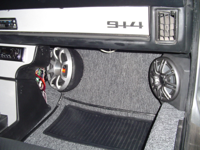

Maybe I didn't explain it well. This was what I meant:
I absolutely do not mean to knock the enclosures that Morph sells and I have no interest in selling these.

messix
QUOTE(East coaster @ Jun 10 2008, 04:20 AM) *
this one won't work with stock style console

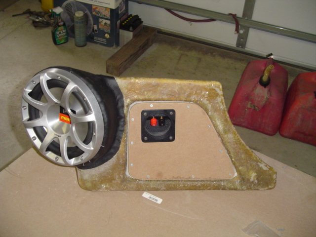

I made my own box about 2 years ago that was almost indentical to the one that is being made here. Check it our here
http://www.914world.com/bbs2/index.php?sho...ic=47247&hl

QUOTE(wilchek @ Jun 10 2008, 10:16 PM) *
I measured the volume with a displacement method and it was perfect for a 8in sub. The 10 needed way too much volume. I bought the JL 8in audio speaker and have way more bass than I need (this fit in my box as I designed it to fit, but may not fit in other check the specs before you buy it). The car interior volume is very small also. It is very clear and has the right sound. If you want to just piss off your neighbors or show off for the ladies go with the 10 but it will not do much as the volume of the box is too small to allow the speaker to move in and out properly. In regards to speaker location, trust me it only works on the left side due to the contour of the body. If you get the JL audio speaker you will need to order the grills on their web site, about 8 dollars if I remember (link to buy the grills) http://store.jlaudio.com/home.php?cat=255. They are strong enough to stand on, really you could stand on top of these things and they will hold it. So get a grill and you should not have a problem with putting your feet thru it. I actually have my floor mats covering the speaker as well. Bass is non-directions unlike trebal and does not need to be in your face or even be seen. The sound waves go in all directions and will reach your ear, even if the speaker in hidden. I love the sound and would totally recommend this set up.
What kind of JL Audio sub is that? W1? W3? I went to the JL Audio website and the specs for an 8W3 work with the dimensions Morph posted up above (0.30 ft2 volume and 4.63" mounting depth). I had a pair of 12W3v2's in my last car in a sealed box. Was very impressed with the sound quality and clarity, I'd like to stick with W3's if possible.
