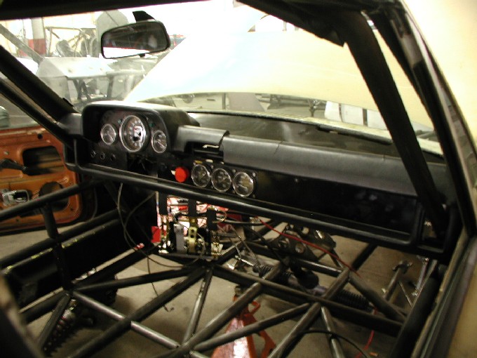

Man, looking back at those wreck photos reminds me why the floor in my racecar looks like this! Hard to see in this shot but I have two 2" diam cross tubes (one at my feet, one at the rear firewall), then two 1-3/4" tubes that cross right at the front and rear of the seats. If I hit something it will hurt, but hopefully whatever I hit won't make it all the way to my body.
Click to view attachmentThe Baja Shop guys that built it told me I was crazy to have so much cross bar in a car, then I explained to them how cement retaining walls and 150mph top speeds don't go together well should I decide to perform some sort of anal-cranial inversion on the track.
