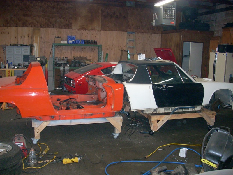

Picking up the second car: (IMG:style_emoticons/default/cheer.gif)
![]() The two cars, before the cutting: ![]() |

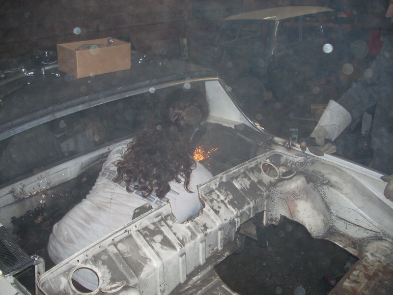

More cutting. The longs on the later cars have a double walled inner reinforcement that took quite a bit of work to cut through.

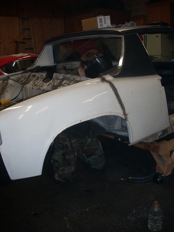

Second car, front end ready to be cut: (IMG:style_emoticons/default/sawzall-smiley.gif)
![]() ![]() We're saving the windshield hoop for later: ![]() |

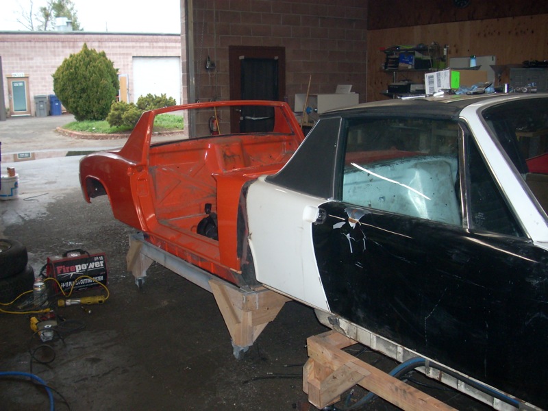

Voila! (IMG:style_emoticons/default/smilie_pokal.gif) (IMG:style_emoticons/default/cheer.gif)
This gives you a rough idea of the dimensions although we'll be cutting off another 1 1/2 feet or so. Basically, the front door jamb of the red car will be right at the firewall of the white car. ![]() ![]() |
