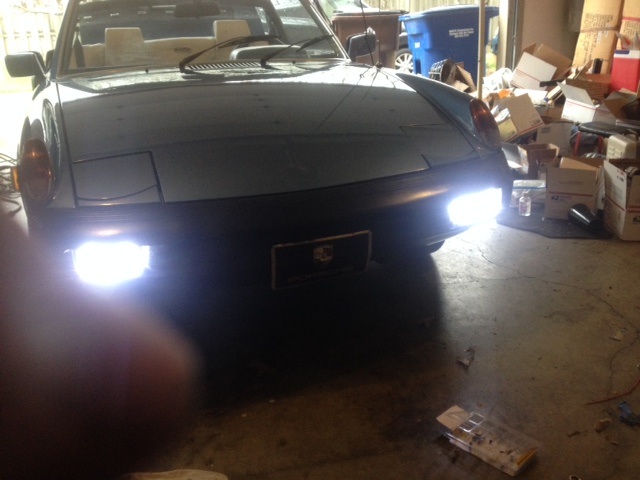

I have been toying with adding some daytime running lights. I got some 14cm LED driving lights for about $14.
Was going try and mount them inside the fog lights but I am not sure that would work. So I thought I might be able to insert them under the glass lens of the fog light. Just mocked up for now.
Seems to work pretty well. These things are damn bright!
Thoughts?

Mblizzard
post Mar 29 2014, 12:11 PM
Posts: 3,033
Joined: 28-January 13
From: Knoxville Tn
Member No.: 15,438
Well I went with my orginal plan and it seems to be pretty nice.
Bright enough to be noticed but not overpowering.
