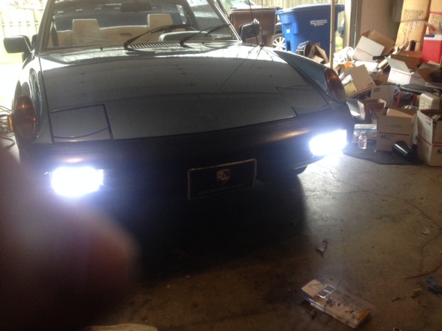

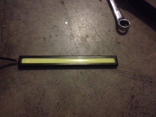

I have been toying with adding some daytime running lights. I got some 14cm LED driving lights for about $14.

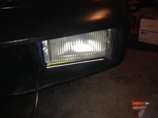

Was going try and mount them inside the fog lights but I am not sure that would work. So I thought I might be able to insert them under the glass lens of the fog light. Just mocked up for now.
Seems to work pretty well. These things are damn bright!
Thoughts?

Really like your driving lights but as mine are the late style I can't go with the cat eye option. I am going to remove the fogs today and see about just replacing the existing bulbs with the LED strip.

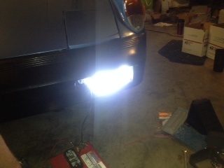

Well I went with my orginal plan and it seems to be pretty nice.
Bright enough to be noticed but not overpowering.
