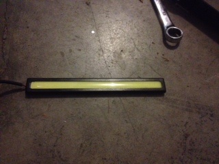

I have been toying with adding some daytime running lights. I got some 14cm LED driving lights for about $14.

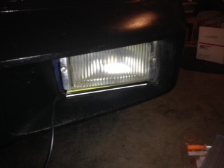

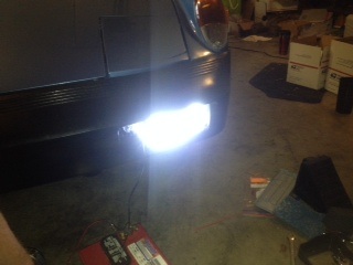

Was going try and mount them inside the fog lights but I am not sure that would work. So I thought I might be able to insert them under the glass lens of the fog light. Just mocked up for now.
Seems to work pretty well. These things are damn bright!
Thoughts?

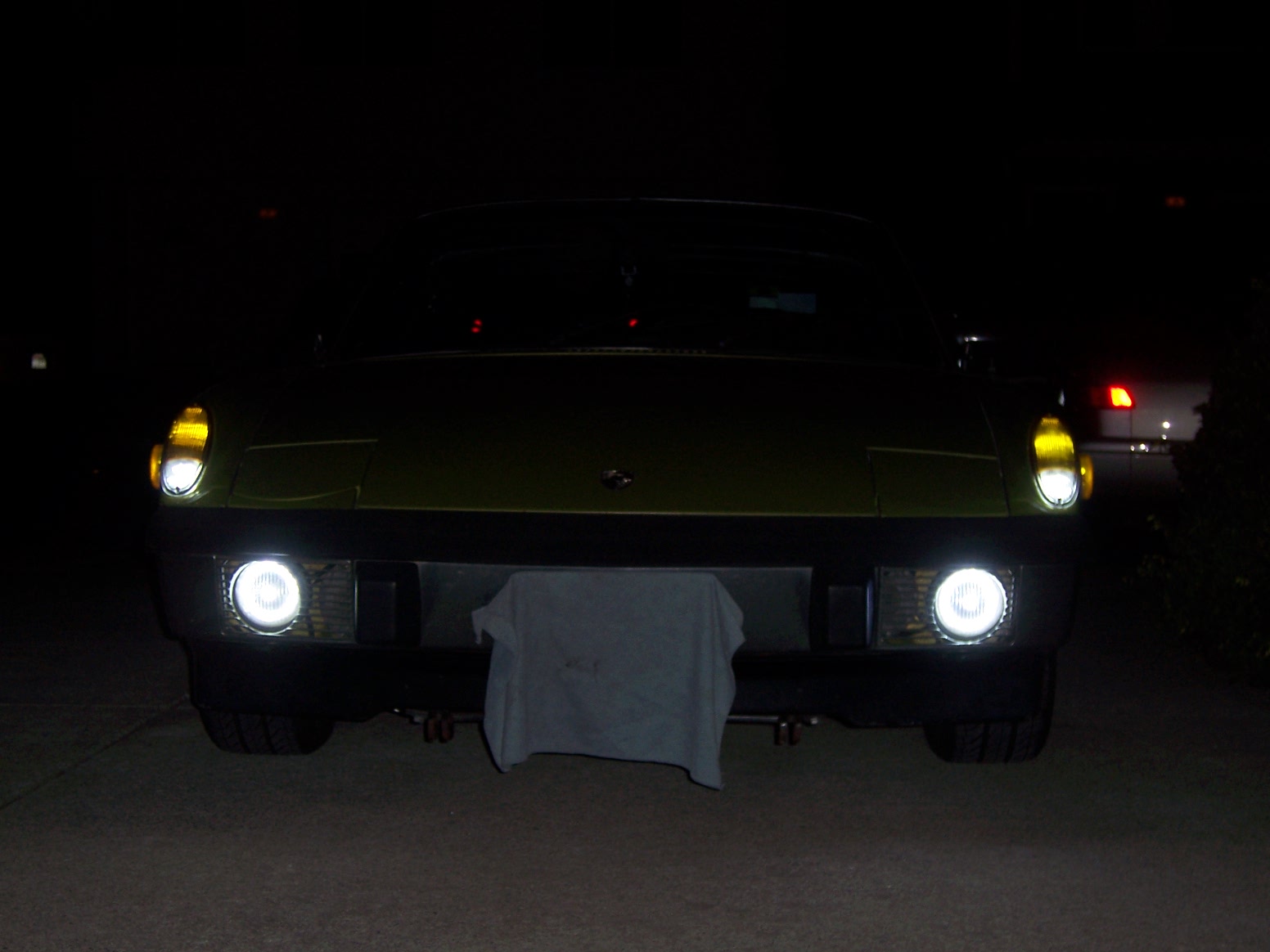

I use my foglight switch to actuate my DRLs; that what I did my '74; I changed out the internals of my foglight with SMD LEDs and because of the wavelength of the SMDs, they are much more visible than incandescent foglights.

here is the thread on the turn signal bucket conversion; the lower light is driven off a separate fused circuit which turns whenever the igntion is on
http://www.914world.com/bbs2/index.php?showtopic=229725
here is my thread on the fog light conversion to DRL; the "DRLs" switch on when the fogs are switched on. If high beams go, on, then they go off as in OEM operation.

Well I went with my orginal plan and it seems to be pretty nice.
Bright enough to be noticed but not overpowering.
