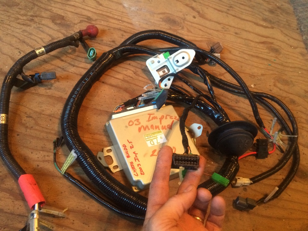

Electronics: Wiring Harness simplified by Small Car Performance

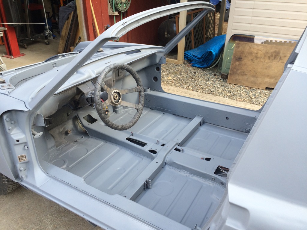

Current Look:
(IMG:http://www.914world.com/bbs2/uploads_offsite/www.imgur.com-17072-1607919164.1.jpg)
(IMG:http://www.914world.com/bbs2/uploads_offsite/www.imgur.com-17072-1607919164.2.jpg)
(IMG:http://www.914world.com/bbs2/uploads_offsite/www.imgur.com-17072-1607919165.3.jpg)
(IMG:http://www.914world.com/bbs2/uploads_offsite/i1301.photobucket.com-17072-1459666779.1.jpg)

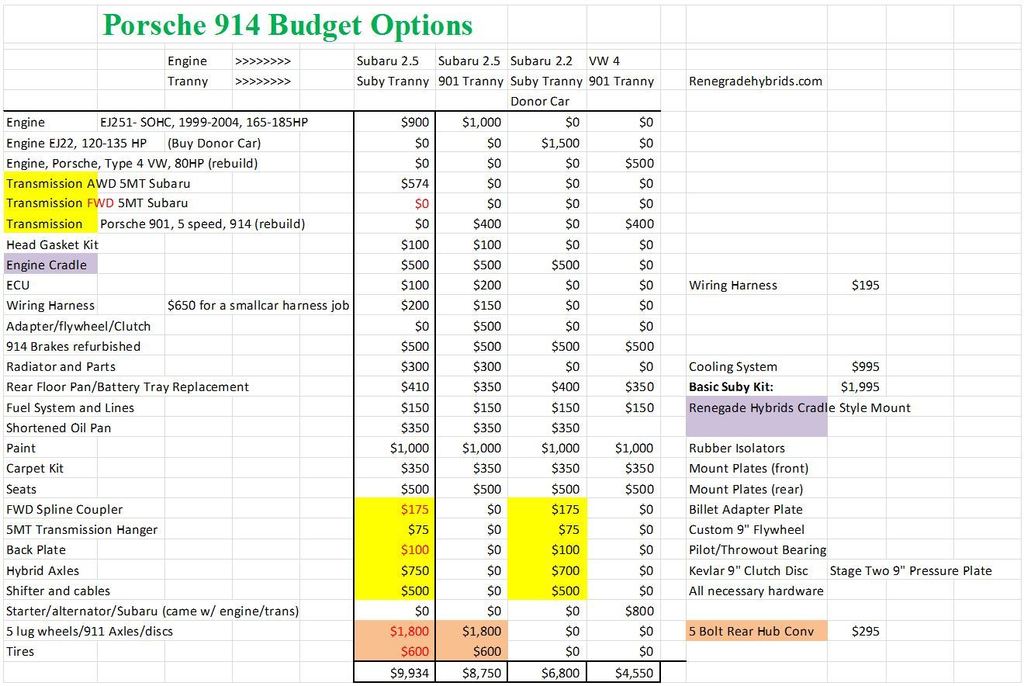

Budget Planning 2015 costs
A good friend told me not to add up the costs. That was good advice. I think the cost is inversely proportional to a couple of things. Do you want a show car- probably not if your are converting to a suby? How much can you do yourself? How much time do you have, or how quick do you want it. Because, I find myself skipping some of the more difficult processes and farming them out, but that's expensive. I had my wiring harness done by the pro's. That's one I don't have the time, or is too important to get wrong. The other is paining. I want the paint and body work to look right, so that's going to the pros as well. Also, the brakes and electronics- I'm going to get help with those. Here's a spreadsheet that I put together with most costs I anticipate at this point. My path is in the left column, but depending on the transmission and engine, costs vary. These are not completely accurate, ie the engine rebuild would be more expensive. But, I wanted to do a relative comparison, so the numbers compare within the various systems chosen. Also, this is not a show car, just something that will be reliable, fun and look nice.
Edit 2017: I'm now $16,000 into this project and still have not started the car. Soon though. Just goes to prove the theory about doubling your budget to get the real cost over the expected cost.
(IMG:http://www.914world.com/bbs2/uploads_offsite/i1301.photobucket.com-17072-1437941843.1.jpg)

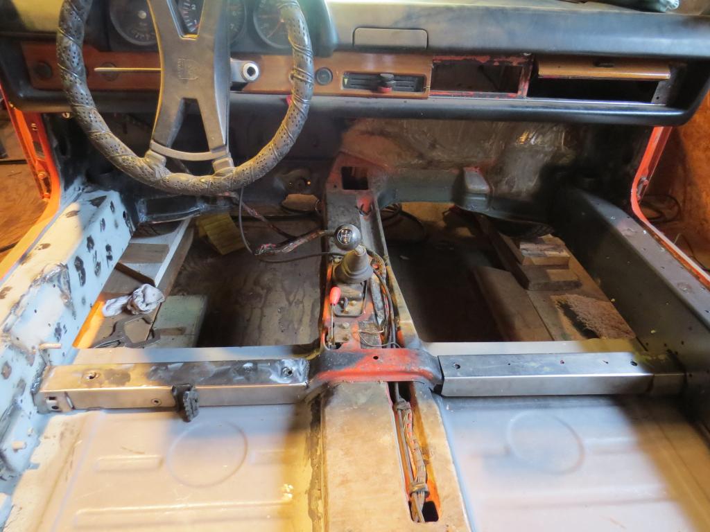

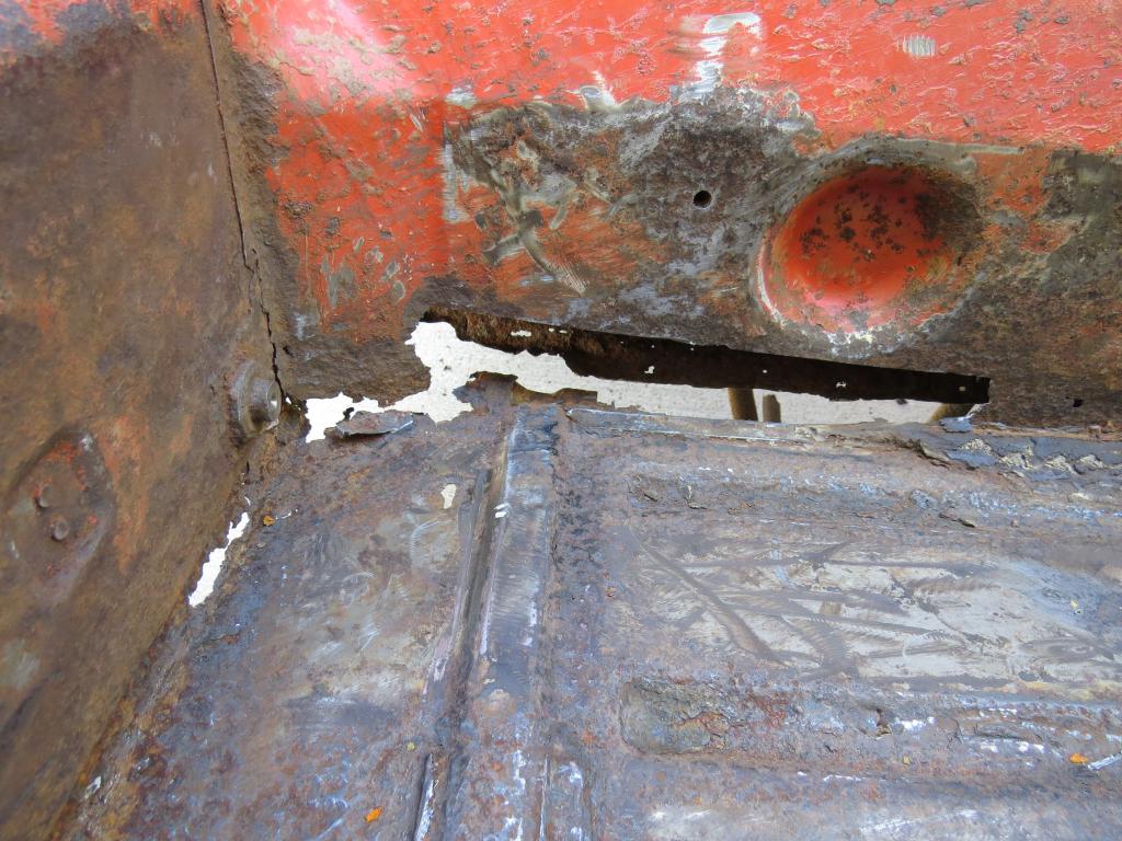

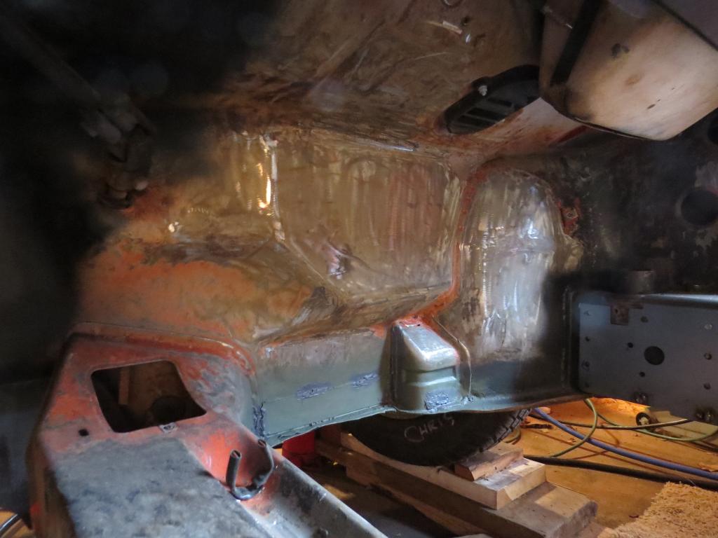

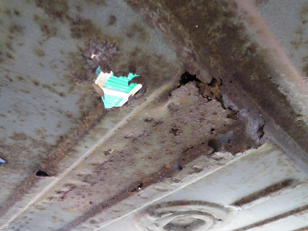

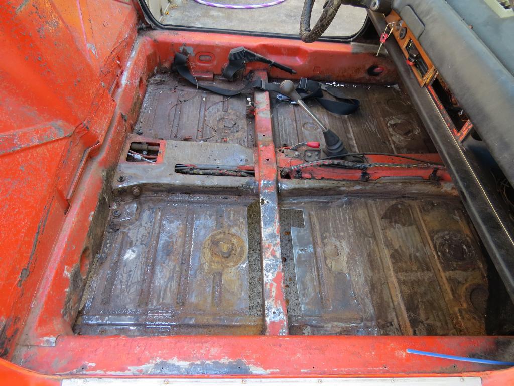

Floor Pans

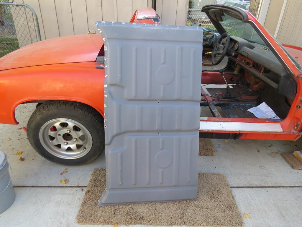

One of the first tasks was to replace the floor pans. I tried to save the old ones, but they were just too far gone. Some of the parts were usable, like the pedal cluster support and the jack stand supports. Those were removed and welded to the new floor pans. This was all done on my back underneath floor jacks, not recommended. If you want to dive right in and build your car without building a rotisserie, you are saving time now but will work much harder and lose time in the end...
(IMG:http://www.914world.com/bbs2/uploads_offsite/i1301.photobucket.com-17072-1437945676.1.jpg)
The left side- worst part
(IMG:http://www.914world.com/bbs2/uploads_offsite/i1301.photobucket.com-17072-1437945676.2.jpg)
The cabin. Tried cutting out portions, but the cancer kept showing up in pinholes everywhere. Sound familiar?
(IMG:http://www.914world.com/bbs2/uploads_offsite/i1301.photobucket.com-17072-1437945676.3.jpg)

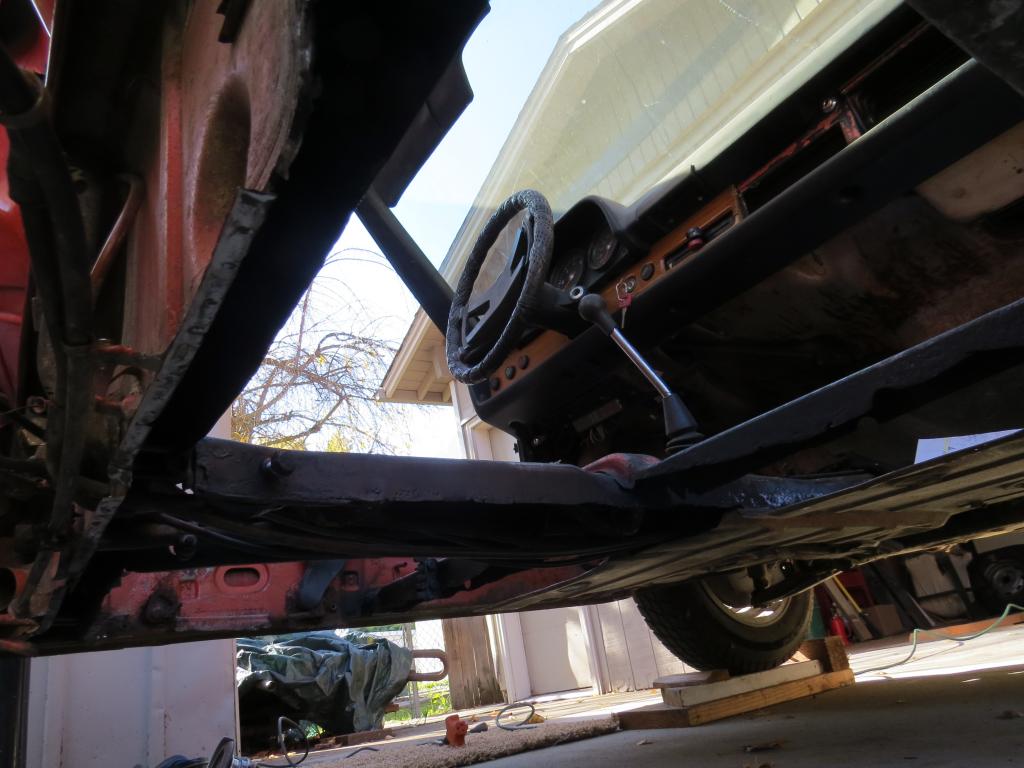

View from below:
(IMG:http://www.914world.com/bbs2/uploads_offsite/i1301.photobucket.com-17072-1437945676.4.jpg)

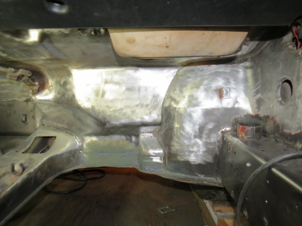

I sprayed the floor pans with epoxy paint. They were purchased in front and back halves because I had trouble finding a single piece and I thought it would be easier to install- not having a rotisserie. Not a bad move looking back, but more welding.
(IMG:http://www.914world.com/bbs2/uploads_offsite/i1301.photobucket.com-17072-1437945676.5.jpg)

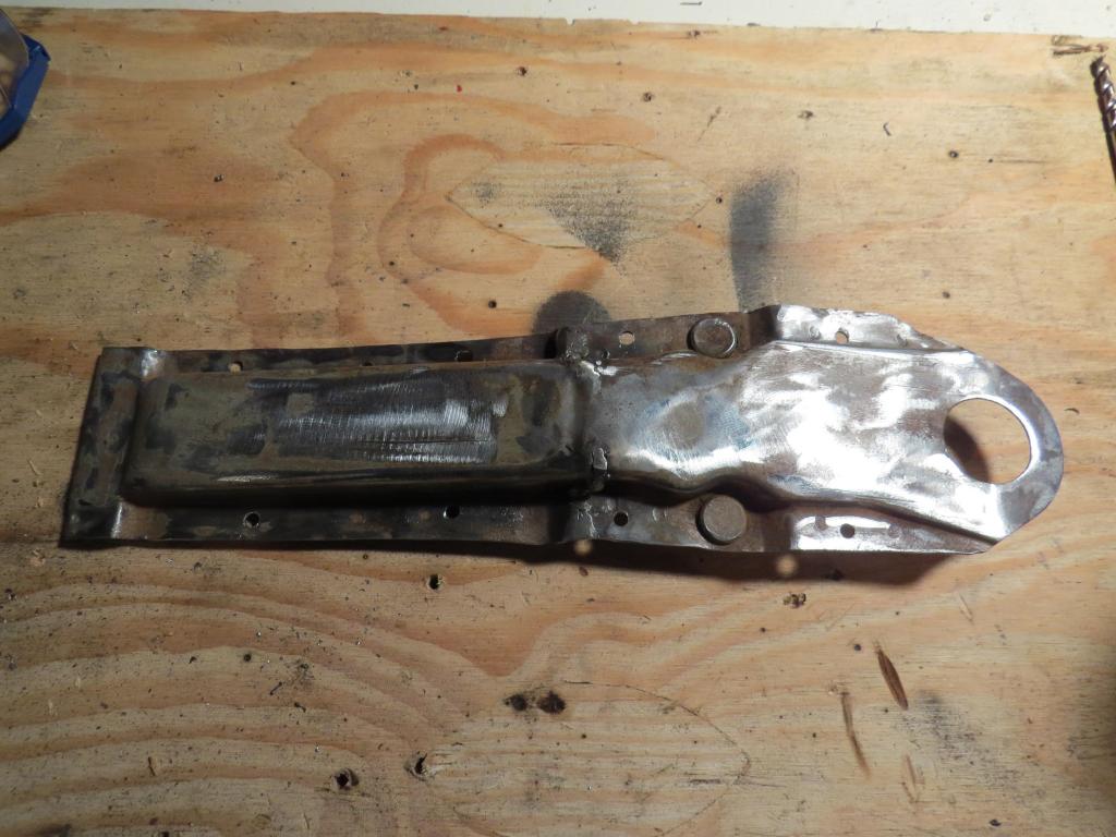

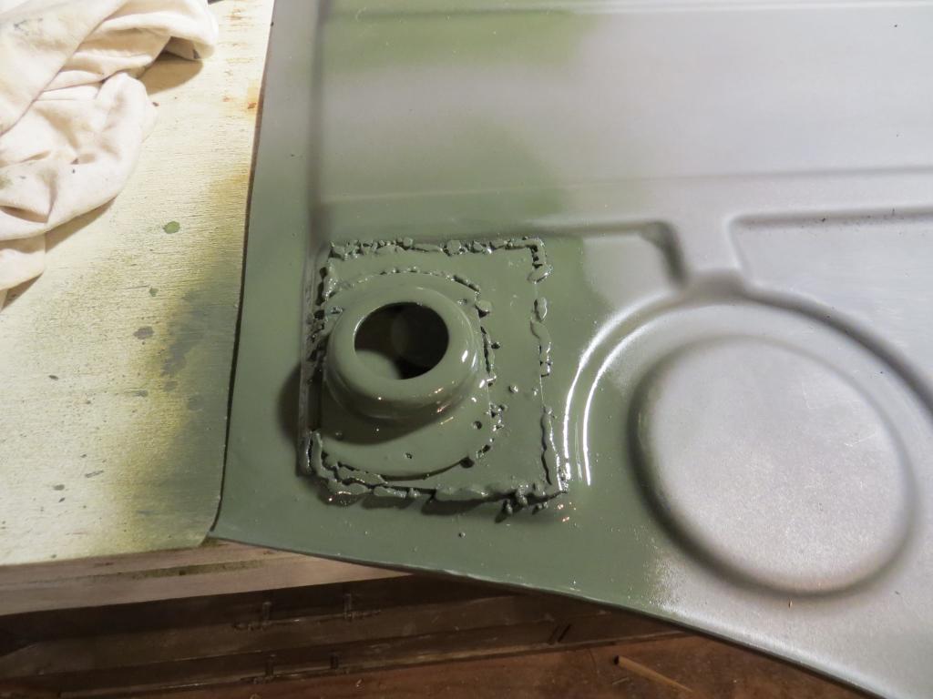

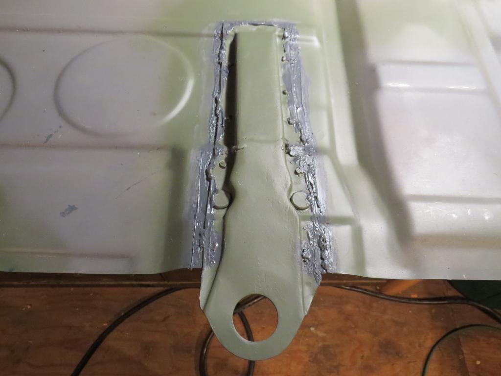

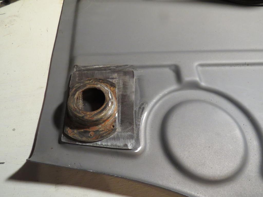

Saved some old parts and strengthened with extra metal.
(IMG:http://www.914world.com/bbs2/uploads_offsite/i1301.photobucket.com-17072-1437945676.6.jpg)
Looking back, these welds are so embarrassing. Not hot enough. I have learned a lot since.
(IMG:http://www.914world.com/bbs2/uploads_offsite/i1301.photobucket.com-17072-1437945676.7.jpg)
This piece keeps you from punching through the floor with your foot
(IMG:http://www.914world.com/bbs2/uploads_offsite/i1301.photobucket.com-17072-1437945676.8.jpg)

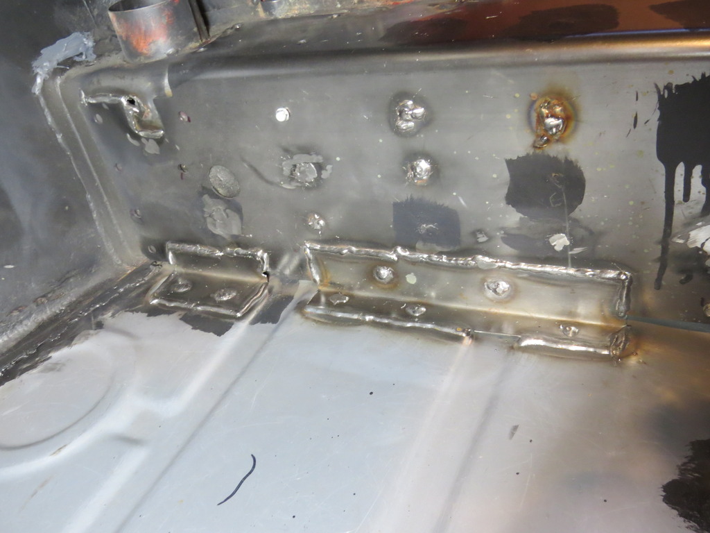

Ugly welds, I know. I thought about an ugly weld thread contest. Who makes the ugliest welds. Getting better though.
Epoxy primer, etching primer, and seem sealer oh my! Incidently, I had to grind this back off, redrill the holes and weld it back because I was off just enough that the pedal cluster did not line up correctly. Recommend welding this on after the floor pans are welded to the car. Measure thrice, cut once.
(IMG:http://www.914world.com/bbs2/uploads_offsite/i1301.photobucket.com-17072-1437945676.9.jpg)
Rear panel in and Engman Kit with new metal braces sleeved over the old ones. Hope the seats still fit.
(IMG:http://www.914world.com/bbs2/uploads_offsite/i1301.photobucket.com-17072-1437945676.10.jpg)

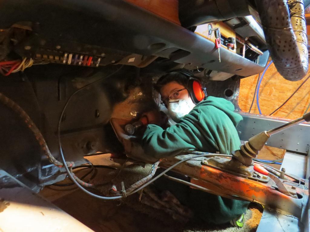

It helps to have small helpers.
(IMG:http://www.914world.com/bbs2/uploads_offsite/i1301.photobucket.com-17072-1437945676.11.jpg)
And he does good work:
(IMG:http://www.914world.com/bbs2/uploads_offsite/i1301.photobucket.com-17072-1437945676.12.jpg)
(IMG:http://www.914world.com/bbs2/uploads_offsite/i1301.photobucket.com-17072-1455413294.1.jpg)

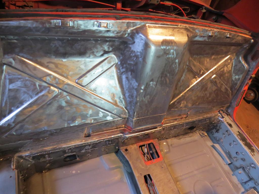

The firewall behind the seat was a chore with the gummy glue adhering the sound barrier. Bead blasting is the way to go- cheap, great results, fast...
(IMG:http://www.914world.com/bbs2/uploads_offsite/i1301.photobucket.com-17072-1437945676.13.jpg)
A few extra brackets to tie the Engman kit to the floor pan for added strength. Already much better welds although I did not need to weld the entire length of those brackets. It's better to leave open spots for flexing. Otherwise, the metal can crack.
(IMG:http://www.914world.com/bbs2/uploads_offsite/i1301.photobucket.com-17072-1437945676.14.jpg)
(IMG:http://www.914world.com/bbs2/uploads_offsite/i1301.photobucket.com-17072-1455411952.1.jpg)
Jumping ahead a few months, the finished floor pans with car torn down for painting after bead blasting and first coat of epoxy primer, but we'll get to that.
(IMG:http://www.914world.com/bbs2/uploads_offsite/i1301.photobucket.com-17072-1437945676.15.jpeg)

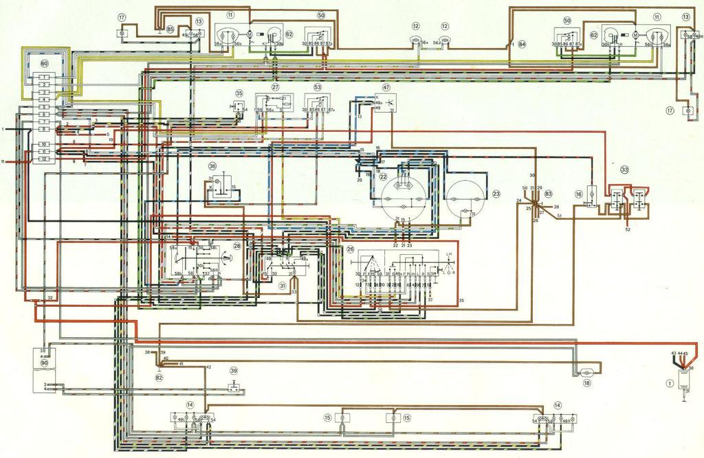

 it's pretty crazy to mate two wiring harnesses together to try to make the 914 work.
People keep telling me it's not that hard when you get the wiring diagrams together and separate the fuel injection and ecu from the 914 wiring.
We will see. At this point I have collected the wiring diagrams from the 914 and the Chilton's guides from each car.
(IMG:http://www.914world.com/bbs2/uploads_offsite/i1301.photobucket.com-17072-1437974914.1.jpg)

I researched types of ECU's and decided to go with the stock ECU for my engine, a 2003 Impreza TS.
This ECU is programmable and can plug into a computer (term).

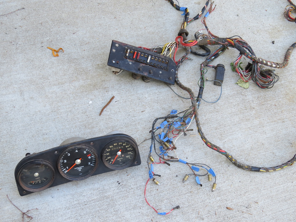

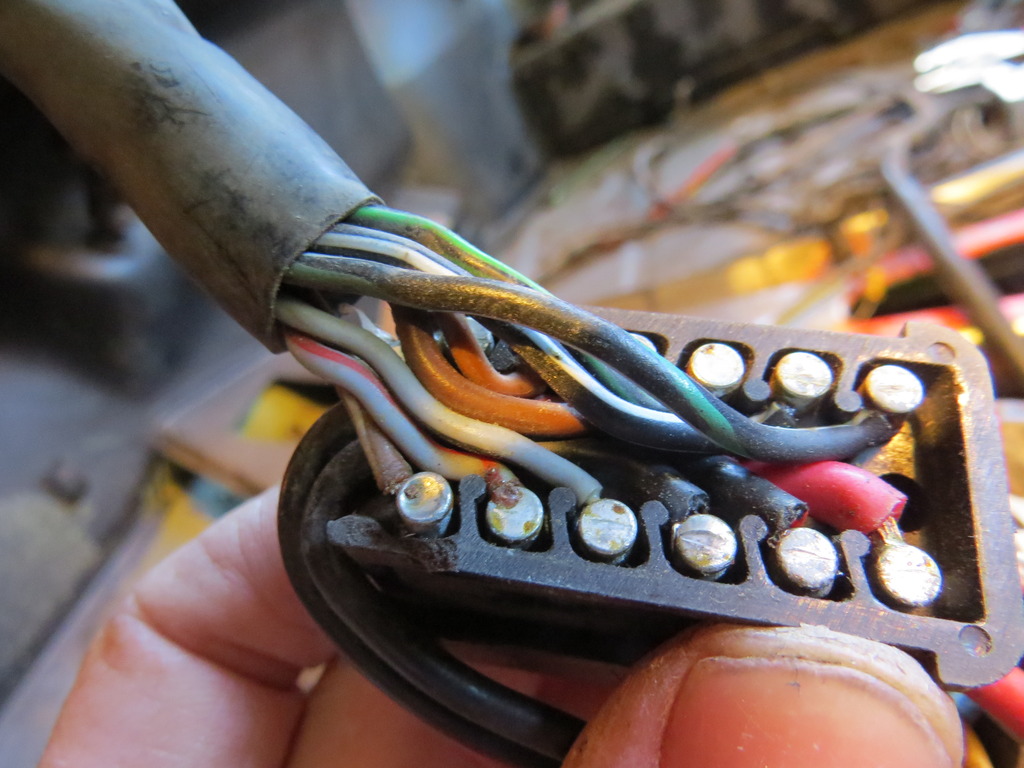

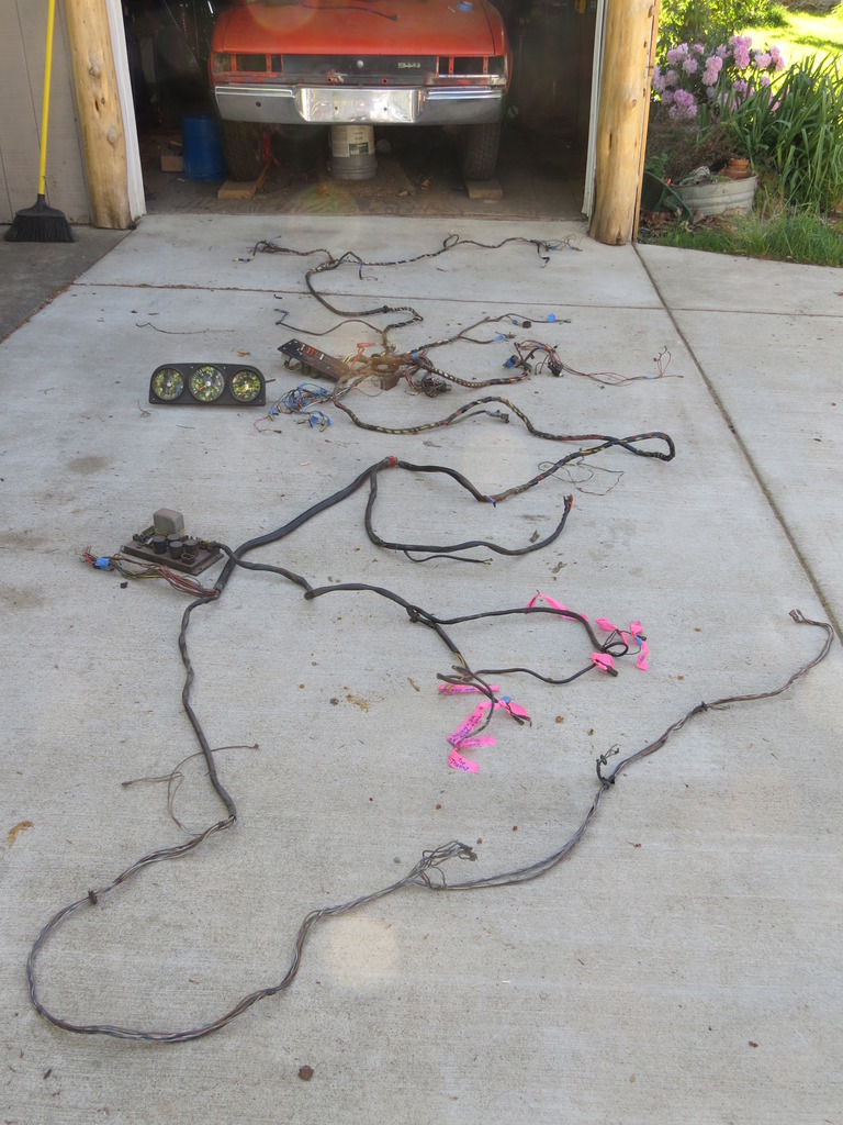

Here's some pictures of my wiring stripped out of the Porsche.
At the time, I had no idea how much of this I would be using
with the Subaru harness. Beside the 914 ECU and wires to the
engine, I will be using most of this wiring with the stripped down
Suby harness.

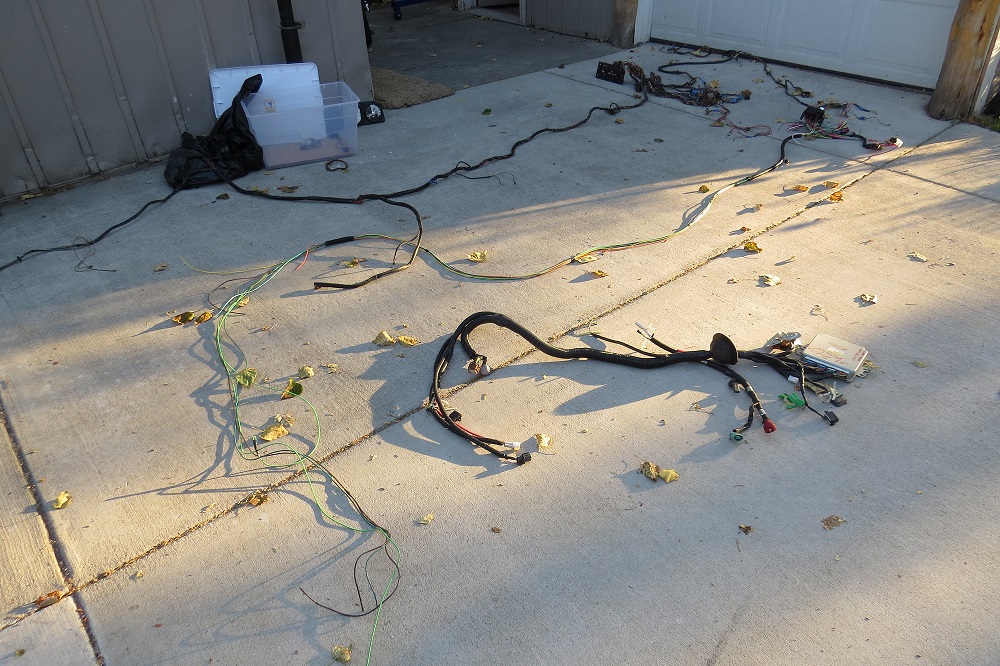

Subaru Harness. I wonder how many feet of wires go into this?
(IMG:http://www.914world.com/bbs2/uploads_offsite/i1301.photobucket.com-17072-1437974914.2.jpg)

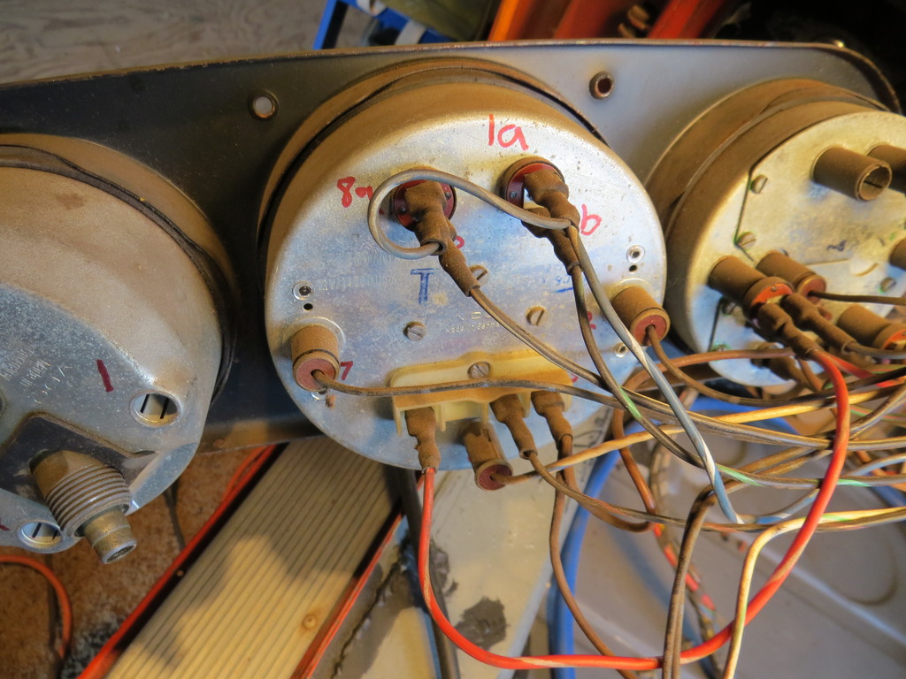

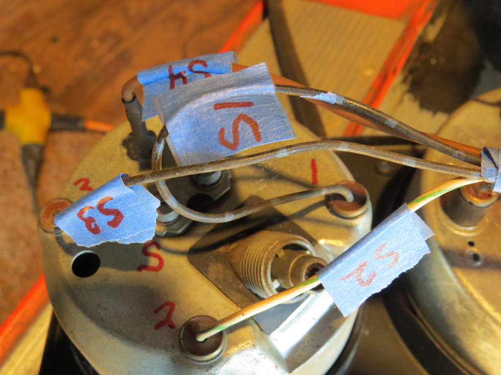

Speedo labeled. Unfortunately, using the Suby tranny, I won't be able to reuse the classic speedometer, although there is a guy who converts these to use the Subaru.
(Look for Link)
(IMG:http://www.914world.com/bbs2/uploads_offsite/i1301.photobucket.com-17072-1437974914.3.jpg)
Another Speedo Pic. Look for Jeff Bowlsby's Tech notes linked above
for some sketches of the wiring diagrams for this.
(IMG:http://www.914world.com/bbs2/uploads_offsite/i1301.photobucket.com-17072-1437974914.4.jpg)

I worked with Mao of Small Car Performance for the Subaru wiring harness.
First I ordered the harness from Ebay, which came in a large box, weighing
about 40 pounds. It was shipped to Small Car in Washington State and returned
in about a week, weighing maybe 10 pounds, and everything labeled. I had shipped
them the ECU with the harness.
