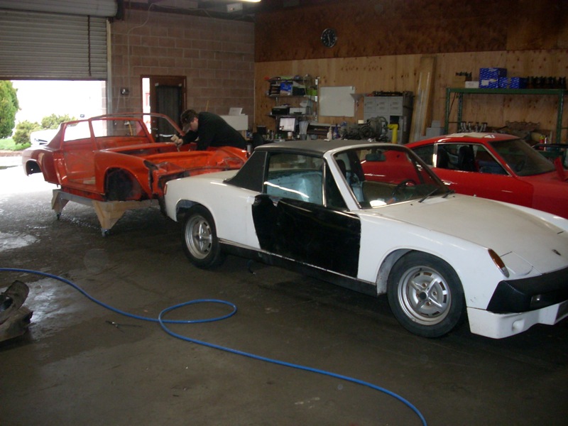

Today work has begun on the 914World exclusive "914 Limousine" project!
After years of tossing the idea around, McMark, RobW and i decided a few weeks back that it was time that someone actually build such a monstrosity.
RobW had a bare shell with front end damage so all we needed was another donor to make the front of the Limo.

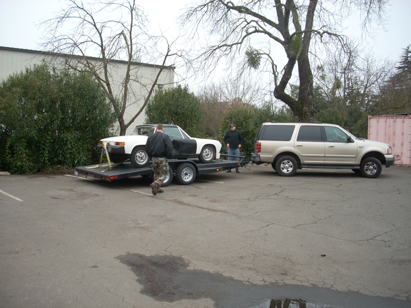

I bought a '75 roller from Chris Hamilton and Rob and i went to pick it up this morning.
Once at McMark's shop in Sonoma, we started stripping the car, built a second dolly to be able to roll the shell around and started to cut off the rear of the white car and the front of the red car.
Both cuts are rough cuts at this point. Next weekend, we'll start with the more detailed cutting and test fitting.
The final result will be a 4-door, 4 (maybe 5) seater with at least one removable top (maybe two) and all the usual bling one would find in a Limousine.

Picking up the second car: (IMG:style_emoticons/default/cheer.gif)
The two cars, before the cutting:
