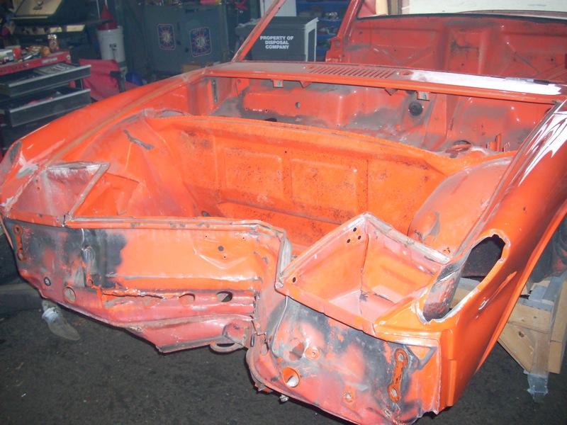

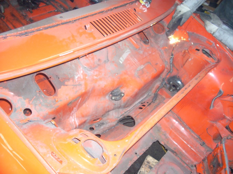

Second car, front end ready to be cut: (IMG:style_emoticons/default/sawzall-smiley.gif)
We're saving the windshield hoop for later:
