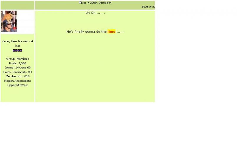

Looks like my prediction was right.......
http://www.914world.com/bbs2/index.php?sho...939&hl=limo
Hmmm..... mebbe I ought to use that crystal ball more......
O crystal ball, where's my next Job???
"Limo Driver"? that can't be right.....

kwales   Looks like my prediction was right....... http://...   Jan 10 2010, 01:08 PM
