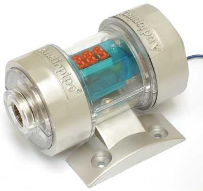

I like the concept & that looks really clean, however why not use just one of these:
http://www.vteworld.com/content/electromec...anl/anlfuse.php
They even have them with integral voltmeters:
(IMG:http://www.914world.com/bbs2/uploads_offsite/site.unbeatablesale.com-10819-1317063725.1.gif)
http://www.sears.com/shc/s/p_10153_12605_S...u=SPM5039089501

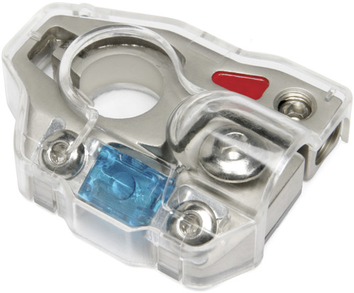

oohhh:
(IMG:http://www.914world.com/bbs2/uploads_offsite/www.parts-express.com-10819-1317064677.1.jpg)
http://www.parts-express.com/pe/showdetl.c...tnumber=263-624
I would run one wire directly to the starter, then put a 50 Amp fuse for the rest of the car.
