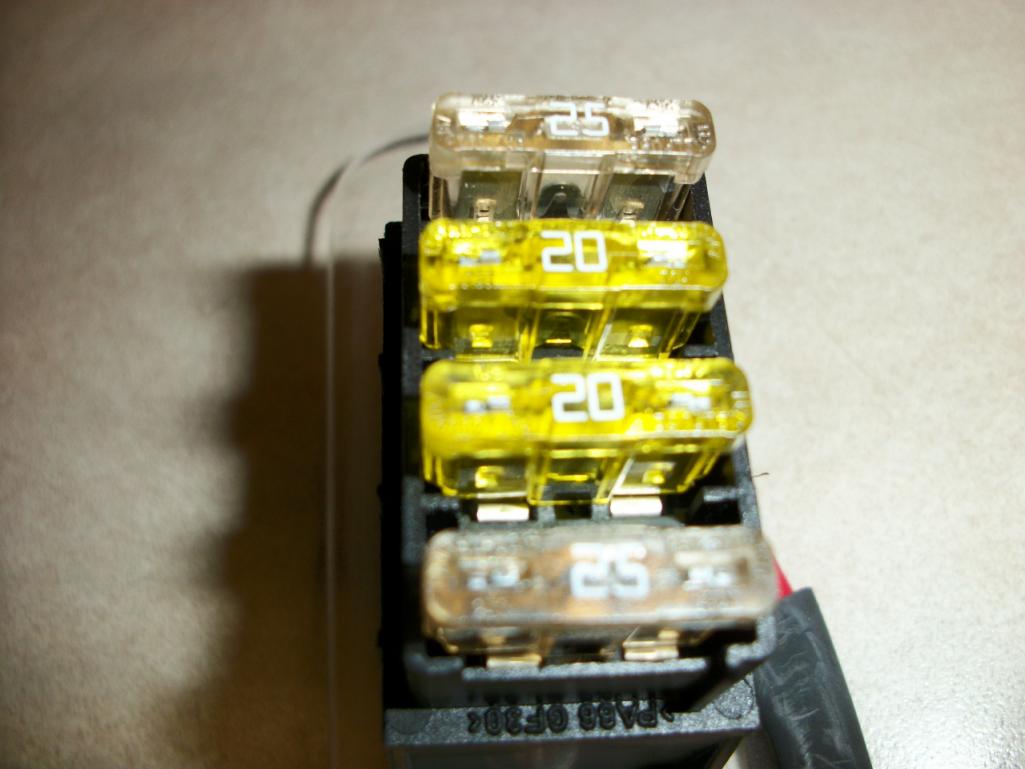

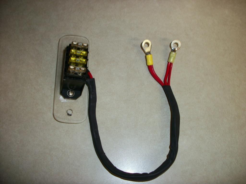

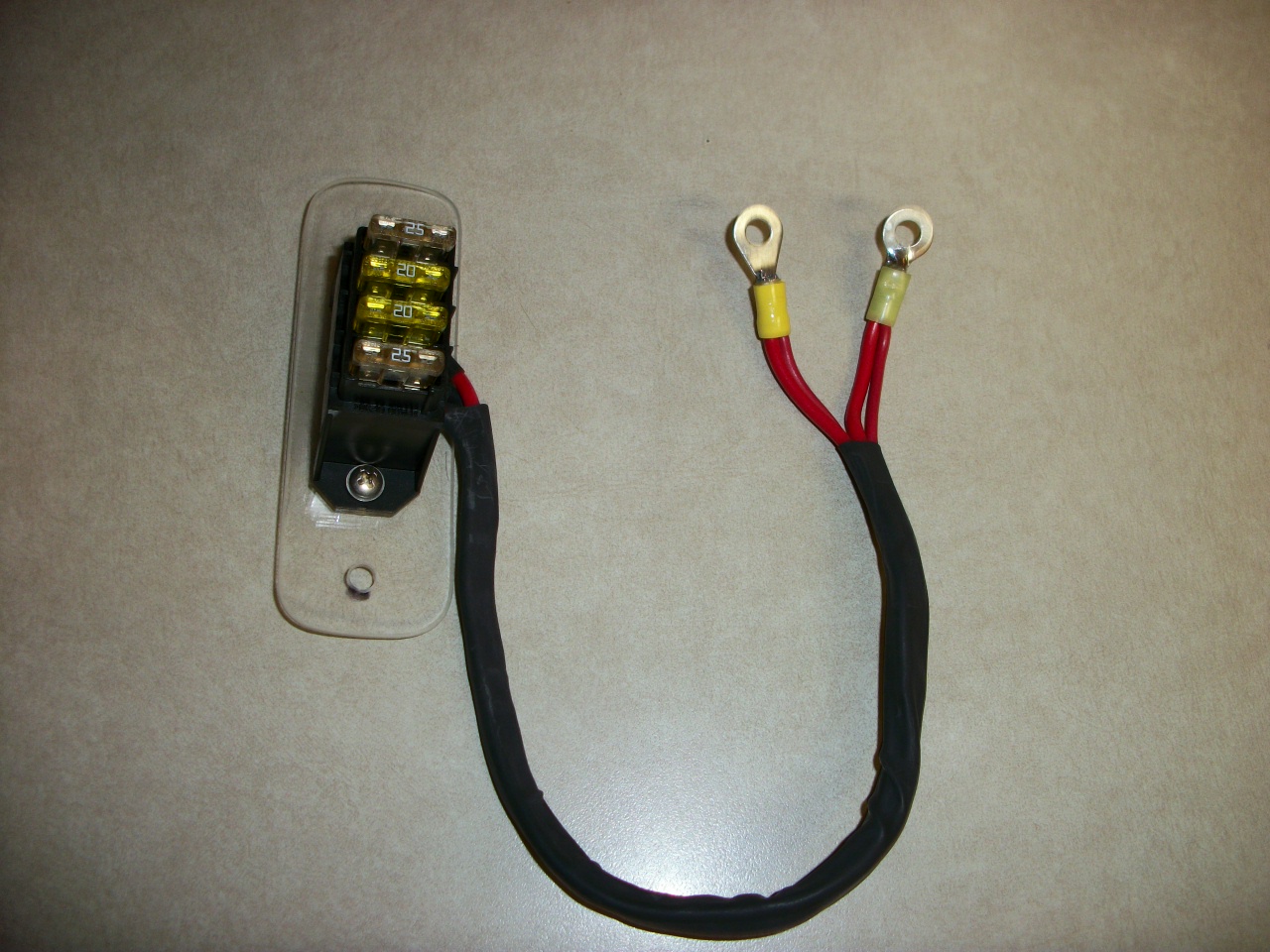

I won't be providing these kits any longer. I apologize to the members who have been waiting. Please feel free to use any info in the thread to help you come up with a fuse solution that meets your individual needs. Parts list on last page.
Tom
NEW INFO FOR EARLY CARS. THEY CAME WITH ONLY THREE RED WIRES!! Two 4.0mm and a much larger wire running forward to the dash area. Please check before ordering.
Last round this summer. Maybe next winter I will do this again if there is a demand.

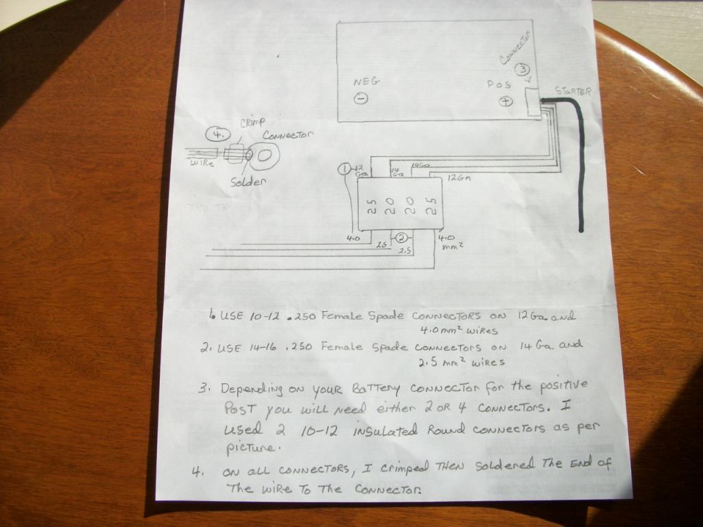

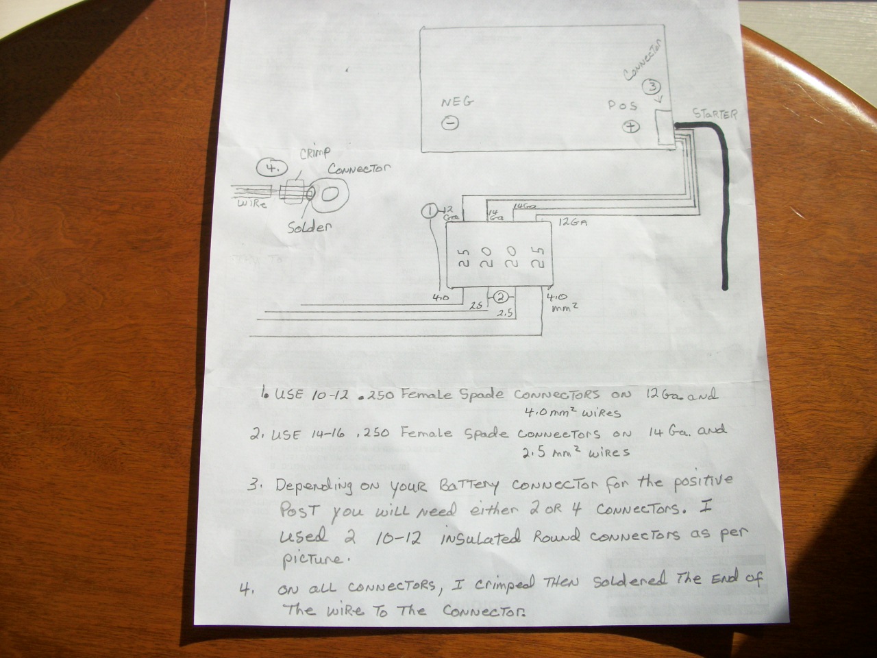

See pics of the new 4-way and 6-way kits, and the completed install of mine. Kits are designed to go on the outer edge of the battery box, however some have mounted elsewhere. If you have need for longer wires so you can mount yours differently, let me know and we can make that work for you.
Also, please see the two pages of info below. You should be able to print copies.
From the supplier: 4/6 individually fused circuits with connections that enter and exit from the bottom allow this fuse block to be mounted in narrow locations. Clear plastic dust cover is included. Max load capacity for all circuits combined is 50 amps, 65 amps for the 6-way. Connections are made using 1/4" female push-on connectors.
I will open round four as I already have 3 folks who want one. There will be two models, a 4-way and a 6-way, and three stages; 1-basic, 2-connections on and soldered, 3 - with new battery connector.

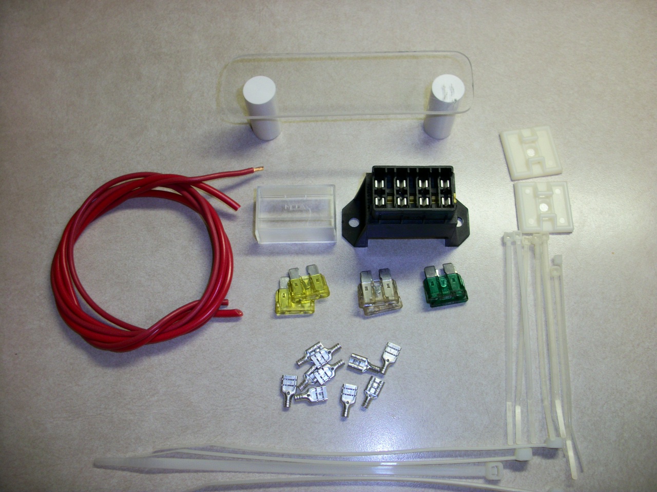

At this time all of the kits have been spoken for. After some questions, I realized I never put up a pic of what the kit contains. There have benn a few design changes; the plexiglass plate is dark grey and thicker, the female lugs are 4 14-16 lugs and 4 10-12 lugs, and the two stand-offs will be pvc pipe at about 1/2" diameter. Oh, and I'm adding a 15 amp fuse for a total of 7 fuses.
Kit doesn't show the heat shrink or two cable clamps, but they will be there.
Here are a couple of pics:
